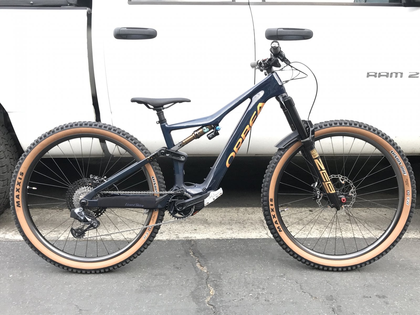

Just got my m-team built today and have a few questions. First off I won’t be able to properly ride it on a trail for a week or 2 but...
1. I was able to connect to e-tube project app and update the firmware of the motor and tcu and I was able to actually get the ST-ride app working which shows battery % and mode among many other things. Just curious if any of you are straight up just using an iPhone attached to your bars as opposed to the garmin 520/530? I bought the garmin but might return it because I can get the samestuff in this app.
2. my lbs was in a rush so they never really explained how they set up the rebound (HSR/LSR) in the fork or shock. What have most of you set the rebound up for these? I’m only 150 lbs.

One more random thing, after adding a 2.4” DHR and 2.5” DHF...as well as swapping the rotors to 203mm/180mm XT ice-tek and adding pedals, my m-team weighed in at 41.6lbs....a little more than I wanted but whatever lol

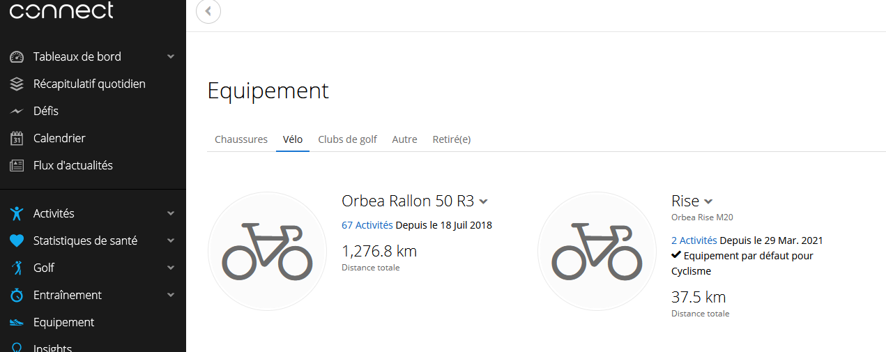

I have the Garmin app on my watch so can see battery % etc. and also sync to Strava but want to see the actual totals for the motor, not just tracking. I think that on the Shimano EP8 with the little screen, you can see this. I think maybe only way may be to ask dealer to plug in.
If you use the Garmin Connect website to follow your activities, you can had an equipment and link it to your activities (even the past one) and Garmin will count the km/miles for this equipment. It's just based on the GPS data from your watch but can be useful anyway...

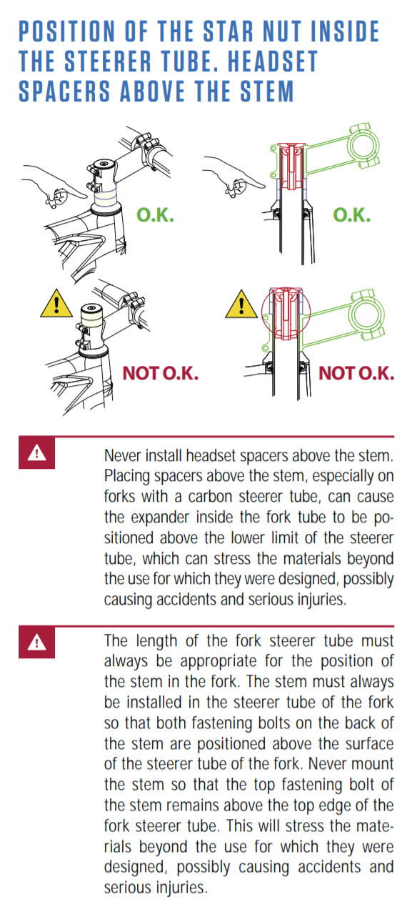

I’ve taken out one of the spacers and put it above the stem, is that dodgy and if so why are they there at all ? Thanks for flagging this
Honestly can't see why putting a spacer on top would be a problem , I've done the same with one or two spacers for years rather than cut the steerer . It's usually the other way around , too many spacers under the stem , that's a problem .
Chicane
Nov 11, 2020
375
325
SoCal
I am thinking this could be an error in the instructions. I may send an email to Orbea to confirm this.
What this diagram is showing is, it's okay if the star nut is below the bottom of the stem and not okay if the star nut is in the middle portion of the stem. This makes zero since because the standard depth of a star nut is 10-15mm below the top of the steering tube and stem stack height is 35-40mm usually, so the star nut will NEVER be below the bottom of the stem like pictured as okay.
Many thanks, I can now see my total distance since getting the new bike and with a rough average of 10kph I can see I have done about 35hrs since I got the bike i.e. getting close to needing to do my lower leg service.
