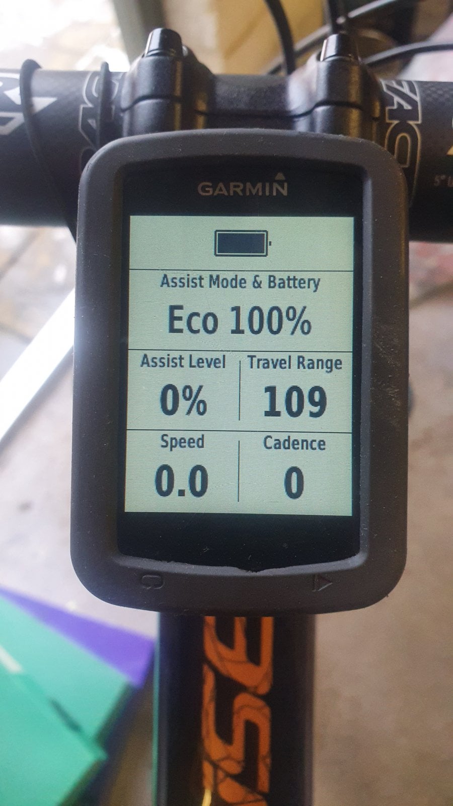

The issue is really with Garmin add-on architecture, not Orbea. The Orbea Rise toolbox is what Garmin calls a "data field", not an app. As such, you need to add the "data field" to one of the "activity" displays on your Garmin watch/device. Once you get that sorted, you'll be good to go. Just remember NOT to configure any other data fields or apps that connect to the bike.
Yeah, I’m all hooked up now.

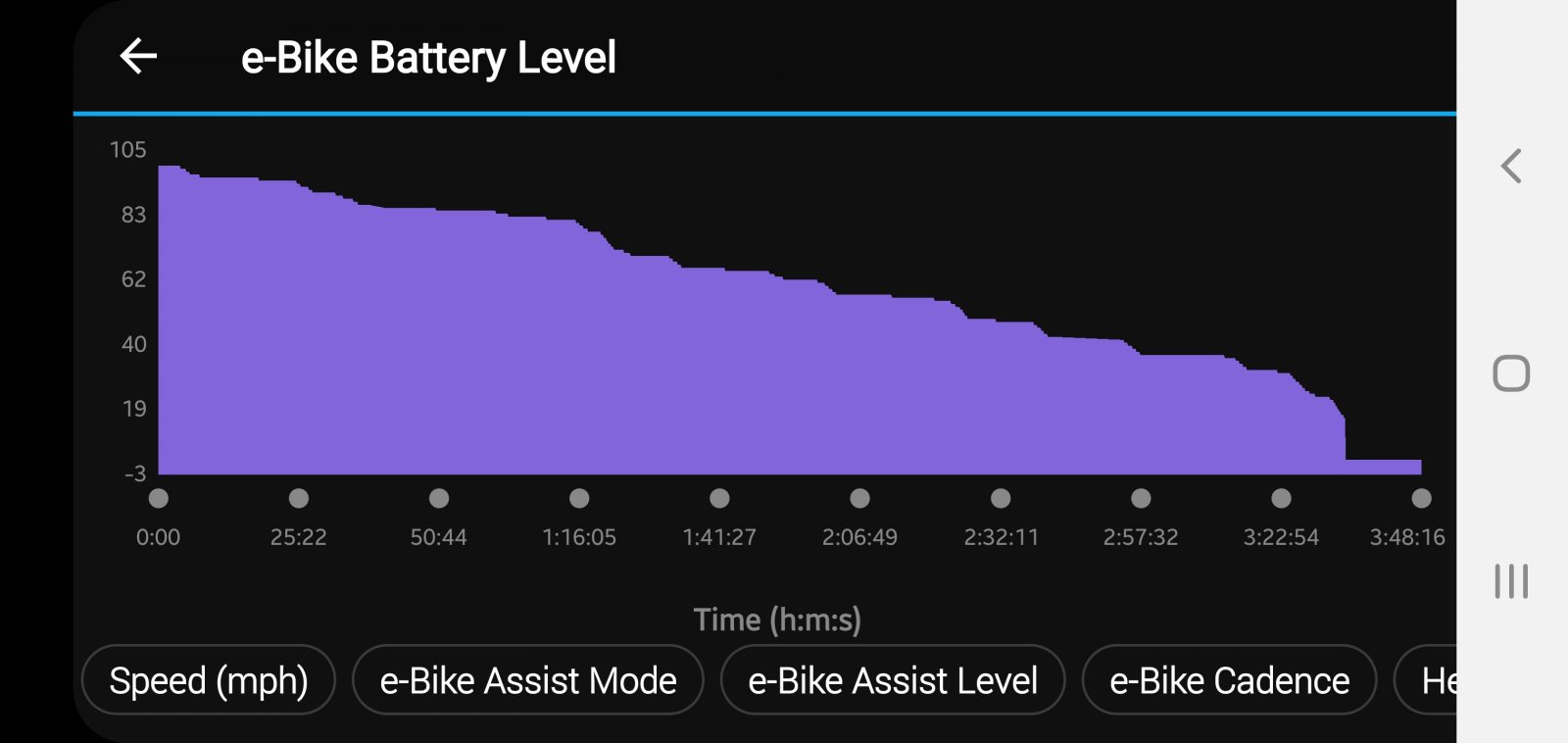

Took the Rise out yesterday for some winch and plummet type riding with the shockwiz on the rear. Used mainly eco and trail for the climb back up. Going by the figures on my Garmin it was looking like I could get nearly 5000ft of climbing but all of a sudden after reaching the top of a climb the battery had dropped from about 18% down to 1%. Still managed just over 4000ft so pretty impressed with that but not sure what happened with the battery? Maybe just a communication error between the bike and Garmin?

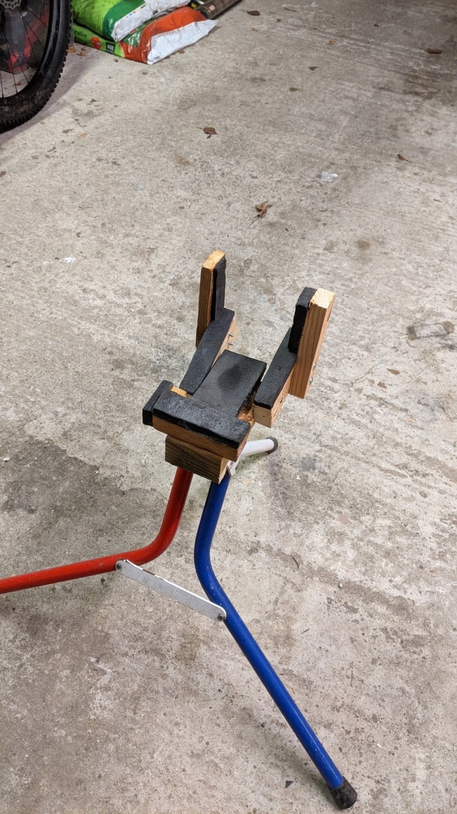

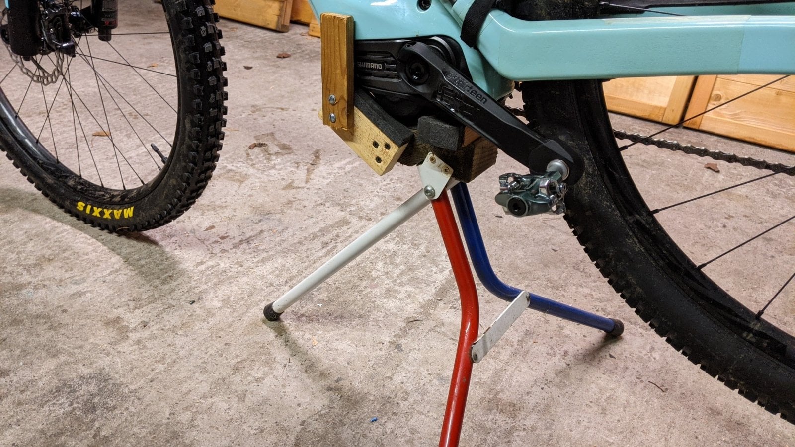

Adapted my Odpod stand today . Taking my Rise anywhere in the car requires both wheels out and I found it difficult putting the back wheel in whilst holding the extra weight of an ebike and making sure I don't scratch the frame . My current elbow injury doesn't help but got me thinking it would be alot easier to support the bike , can use it for washing too , and I can spin the pedals . Its a bit rough around the edges and needs a bit of smoothing off but it does the job

Took the Rise out yesterday for some winch and plummet type riding with the shockwiz on the rear. Used mainly eco and trail for the climb back up. Going by the figures on my Garmin it was looking like I could get nearly 5000ft of climbing but all of a sudden after reaching the top of a climb the battery had dropped from about 18% down to 1%. Still managed just over 4000ft so pretty impressed with that but not sure what happened with the battery? Maybe just a communication error between the bike and Garmin? View attachment 49618
What distance, how many kilometers?
