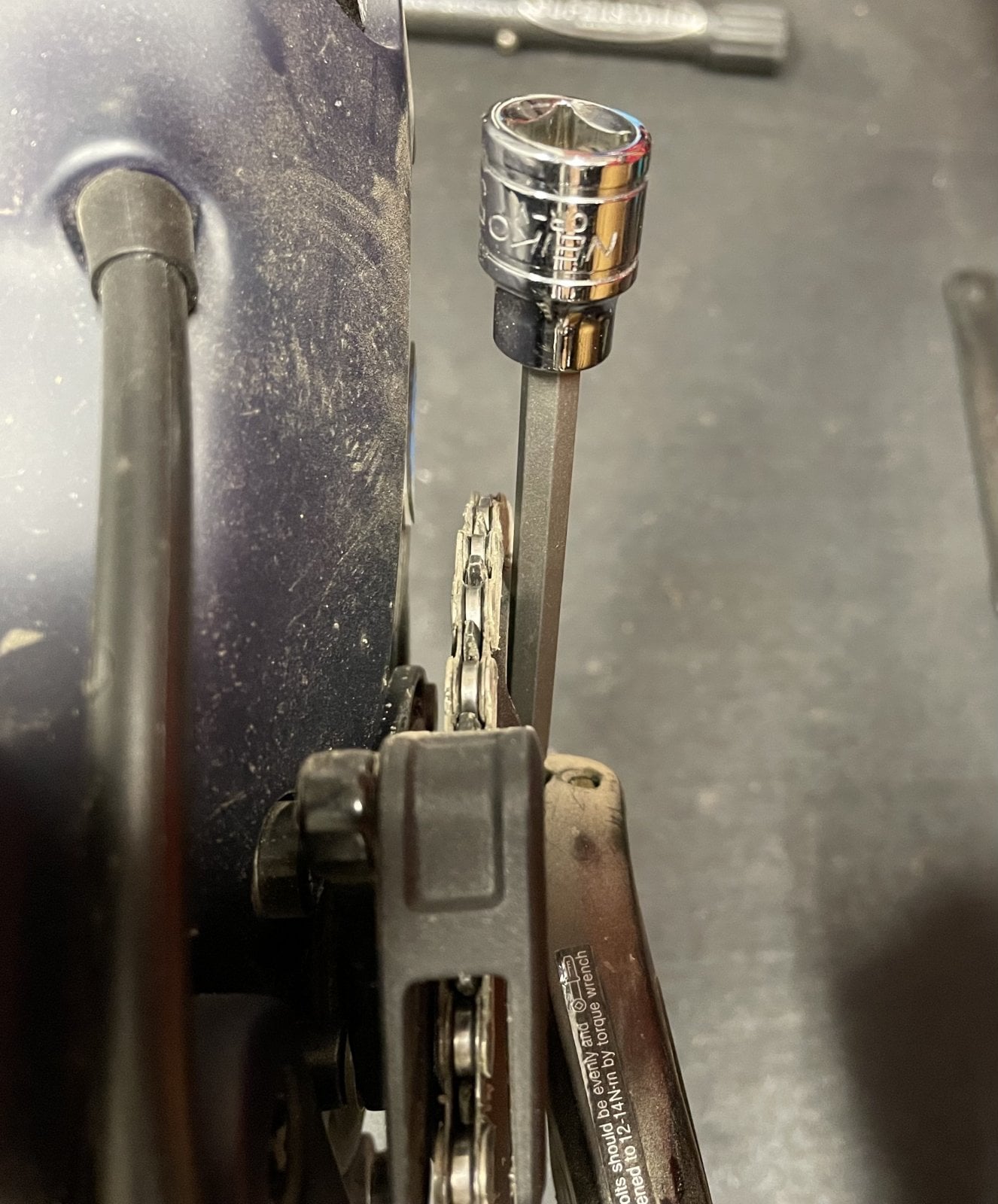

Just finally got around to pulling off the e*13 alloys (which I never actually had a problem with) and installing the FC-EM900 arms. For anyone else yet to do this, one thing I noticed that I have not seen mentioned here yet is that there is not sufficient clearance to get a hex drive socket and torque wrench on the inner-most of the two pinch bolts on the right (drive) side arm. The chainring prevents anything longer than the short end of an allen key going straight into the head of the bolt when the crank arm is fully seated on the spindle. Proper torque on these bolts is important, but on that one the only option is to go by feel.

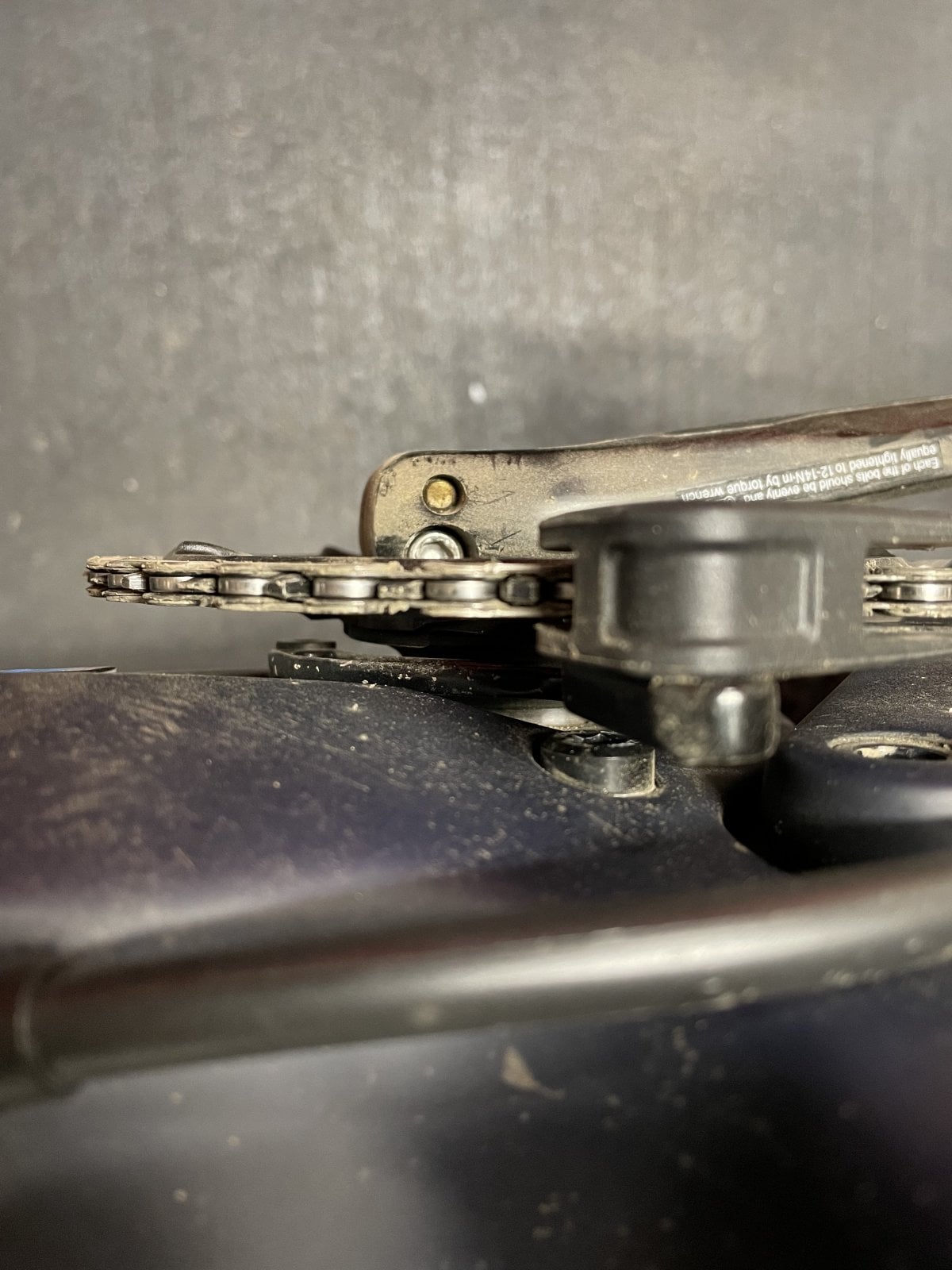

Can you post an image of what you are thinking? The problem is that the inner pinch bolt is essentially on the same plane as the chainring, so the only space to get straight down into the head of the bolt is to use a short key and approach it from the space between the 'spokes' of the chain ring. The chainring itself is slightly dished (convex), and the head of the inner pinch bolt sits basically on the chainline of the chainring, so there is no way to get a longer hex bit straight onto the bolt...

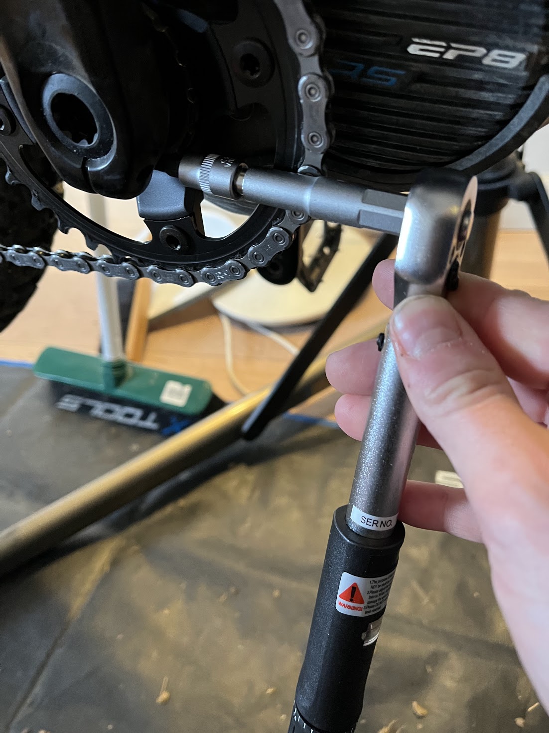

@volts Is that a Shimano spider/chainring? If so, I wonder if the chainline is slightly different (more inboard) than that of the original e*13 ring. Here is a pic looking straight down onto the inner pinch bolt on my bike; the chainring overlaps about half of the bolt head. Even using a socket with a long hex bit (i.e. a smaller diameter against the chainring than the extension you are using) and with the chain off, it's not possible to get straight enough onto the bolt, especially at the torque required.

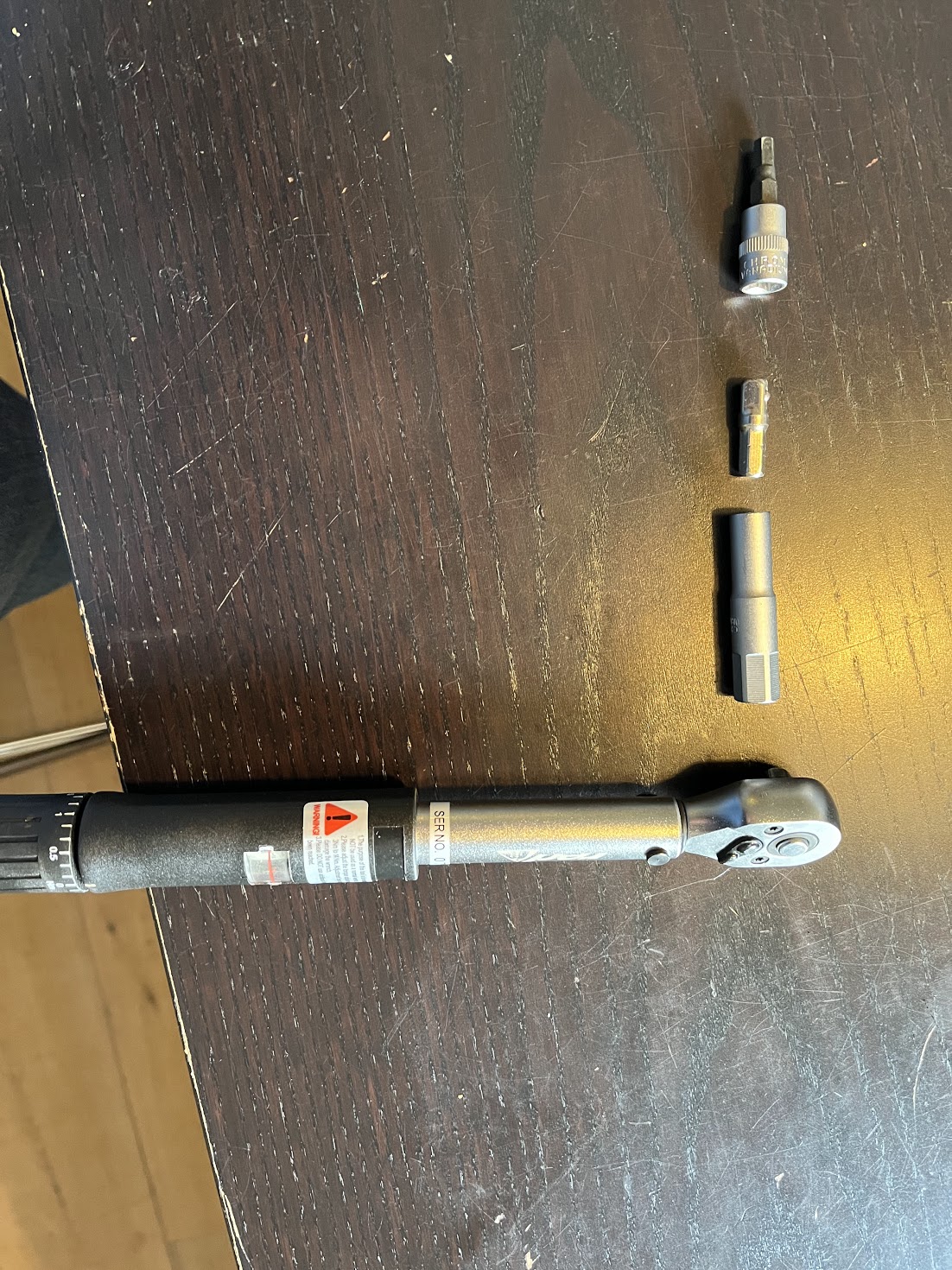

My tourque wrench set came with this and I did not even have to remove the chain

@BobR Thanks. I'm using the same kind of hex driver. Yes the hex can be made to go into the head of the bolt, but not straight on, and because of the angle, the hex does not go in far enough to seat fully in the head of the bolt. You can see the angle of the tool relative to the chain guide for reference. Applying 14nm of torque like this is a good way to round off the bolt head hex...

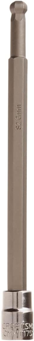

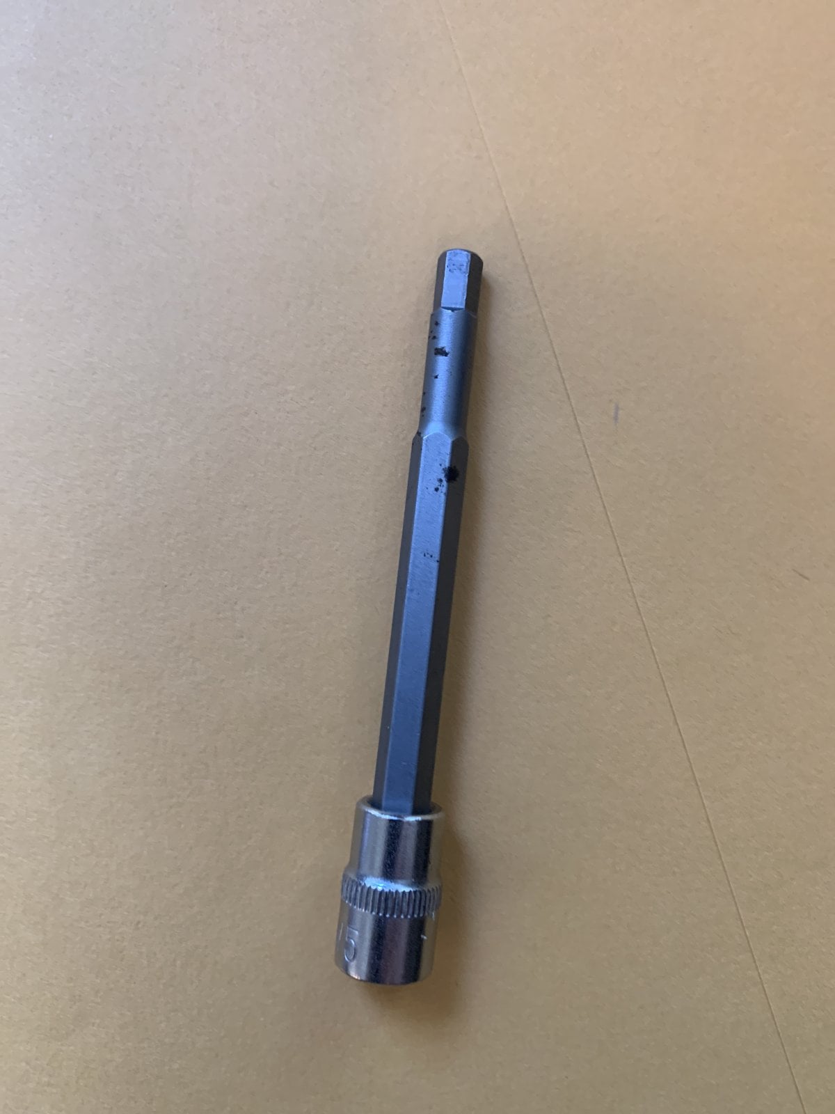

Here's another possible option that seems to work pretty well, given the angle of approach to tighten/loosen the crank bolt closest to the chainring -
