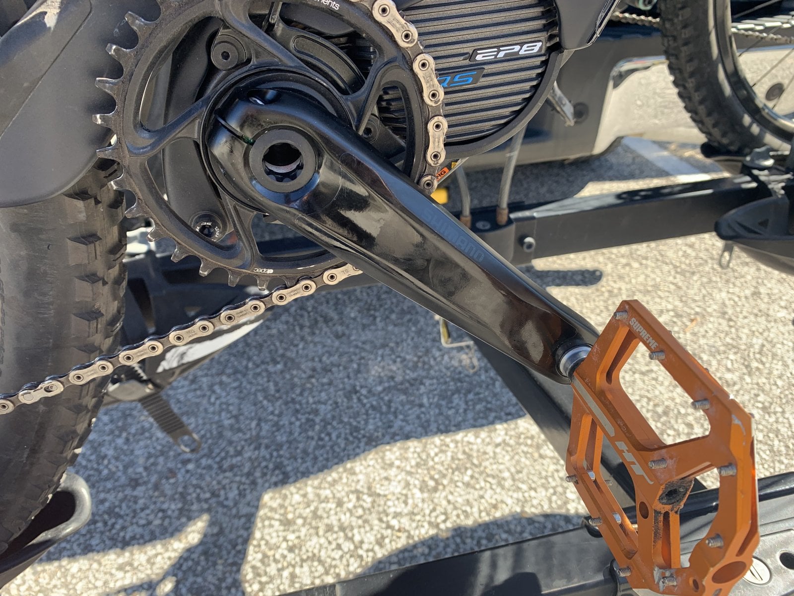

I completed the replacement w/Shimano cranks on my wife’s M Team a few weeks back but she in injured at the moment so no miles in them yet. I did notice that when you back pedal now the from sprocket rotates with it where as on my M10 w/the e-13 it free spins. What am I going to use $100 on their web site as they have almost no parts for the rise… not even a Rise T-shirt… I suppose I could buy a couple pairs of socks
Snowrydr01
Dec 15, 2021
79
35
Jeeptj01!
Thats interesting new cranks shouldnt fundamentally change how it works. Is there any contact between the arm and the chainring.
BobR
Apr 14, 2021
167
74
Florida
Honestly it might have been that way before the crank change as it is my wife’s bike and I don’t pay that much attention… will have to look in detail after work

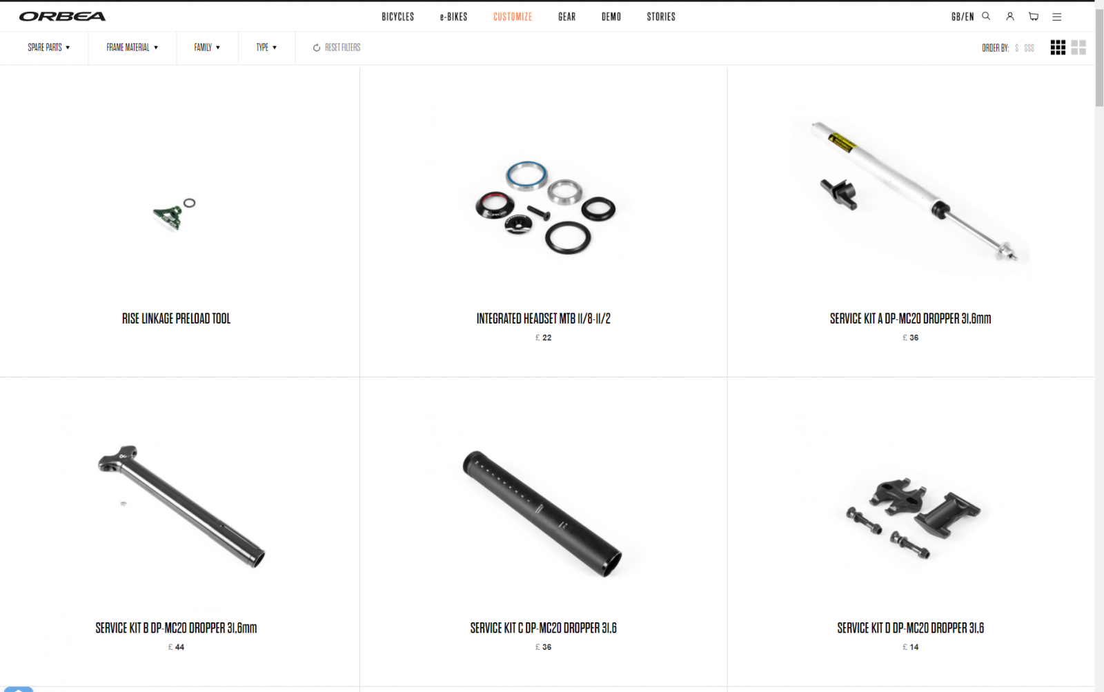

Have you registered the bike on the Orbea website?
If you do that and click on the "Find replacement parts" link, then there are pages of items:

Spares seem to come and go from stock but
- mech hanger
- service kit for seat post
would be where I'd start.
The sprockets should not turn when back pedaling with either. I suspect you may have installed them incorrectly if your chain ring turns when you back pedal.
BobR
Apr 14, 2021
167
74
Florida
The shop installed them and they are 90 minutes away… is there a YouTube video you can refer me to and I will re-install them myself.
volts
May 15, 2018
343
266
DK
Hmm I don't know of a yt vid, but it's not hard.
1) unscrew the bolts (i blieve it's a 4mm hex key)
2) take out the outer most screw completely (you will see why later)
3) undo and remove the inner plastic preload thing. You need a somewhat special tool for this.
4) flip the little black plastic tap up, the one that sits at the crank in the little crack. You won't be able to do this unless you completely remove the outer most screw.
5) take off the crank arm. Inspect for damage, clean and grease.
6) put on crank arm
7) flip the plastic thing down again
8) insert screw, but do not tighten
9) preload the arm with the round plastic thing that needs a special tool. finger tighten it.
10) tighten the 2 4mm hex key bolts alternately to 14 nm, revisit each bolt a few times alternately.
