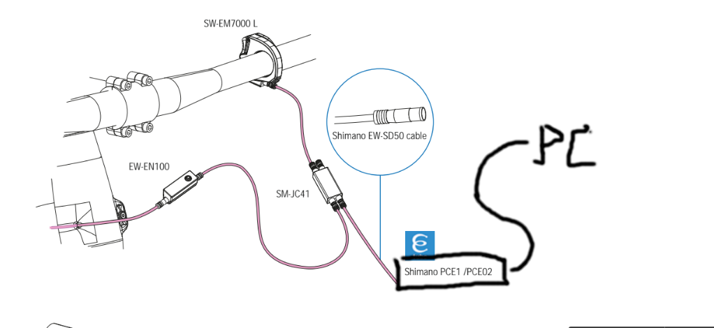

I ordered a junction box, so I cound connect my SM-PCE1 box and then use eTubeProject to access the bike settings.
Junction box arrived today, but the eTubeProject told me that my PCE1 was not supported.
The Rise manual said it was supported....but I then had to use the old eTubeProject v4....
So I uninstalled v5 and installed v4 of eTubeProject, and it was supported.
Connected the bike, and all is good.
Then I used another Windows program to change the region (I am moving to US soon), and I now has 32kmh assist limiter., which suit me very good.

Hi 2 questions , where did you attach the junction box - can you post a pic? how did you uninstall ver 5 and install v 4 of etube project?
aarfeldt
May 25, 2019
713
634
Denmark, Danstrup
1: Junction box was connected as the manual describes:
The "wrong" sodtware was uninstalled via Windows Control Panel.
Version 4 of eTubeProject can be downloaded at the same site.....just look for WindowsXP/WIndows 7 (and actually Windows 10)

I've not done it on the Orbea Rise, I 'may' it on both my Hecklers - an E8000 and EP8 - both with the most up to date firmware.
The Orbea Rise has a EW-EN100 juntion box on it - this is a pain because it means you don't have an easily accessible free port to connect the PCE1 to. But there is still one - it's on the motor, all you'll have to do is remove the plastic covers and you should see the spare Di2 port.
Failing that you'll need the Shimano E-Tube Di2 Junction Box. This allows you to un-plug one end of the EN100 and connect this. Then you can plug in the PCE1 to the Di2 junction box and your PC.
It's sounds way more complicated than it actually is - everything just used the standard Di2 cables/ports. (except the USB into your desktop or laptop).
Then you open e-tube on your desktop to create the connection and lastly STUnlocker on the desktop (you'll need a paid for licence).
Then you can swap it to US spec. Once it is swapped over you can use STUnlocker on your phone to control assistance levels.
The pain of it is you need a sympathetic shop with the PCE1 and the Di2 junction box or you buy them for about £200.
It takes no more than 10 mins to do start to finish.
If you are in the UK/South East I'm happy to meet up and help out, I've obviously got the PC connection box and know what I'm doing with it now!

Hi,
I just did the region switch as 25 km/h was just too slow for me:
- I bought the Shimano SM-PCE2 linkage box and connected it to my SM-E7000 display
- Installed the latest version of eTube software for Windows v5.0.3 to have the drivers for PCE2 installed
- Installed the latest version of Stunlocker for Windows
- turned on the Orbea Rise
- then started up Stunlocker for Windows, which reads all the info of my bike ('Get Settings')
- then just change the Destination to USA (=32km/h) and saved this settings ('Update Settings')
5 minute job, the most difficult part was to find out how to 'purchase' the premium version, but got very quick response from the developer on that !
You do not need the old SM-PCE1 box as this is very difficult to find and very expensive if you do find it.
PCE2 is the replacement and is cheaper.
For your information, I can still use current eTube app v5.0.3 on my iPhone 13 mini to change the Profile 1 / Profile 2 settings.
A happy mountainbiker now ;-)

If you use the PCE-1 or PCE-2 to connect directyl to the bike, you do not need to downgrade the firmware to make any changes.
If you try and go the phone route, it involves downgrading the firmware, and its now only possible on an Android phone, not an iPhone (because the older version of apps are not available in the Apple App store, and the current version prevents downgrading of firmware )
