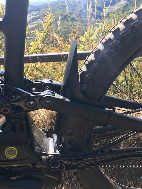

Has anyone put a Mudhugger Front shorty on the rear of a Kenevo? (Asking for a friend ??)
If so, does it fit ok or move about? I’ve seen them on Levos, but the Levo has a bar across to zip tie the mudguard too. The Kenevo doesn’t have the bar and I wondered if it would just keep sliding down.
Thought it might protect the frame/bearings in winter.
I've tried (with a mudhugger front race) but wasn't pleased with it. The mudhugger came to close to the tyre and i had an issue with the suspension - when compressed, the mudhugger touched the motor housing. This is because the "front race" mudhugger is a long version - it might work better with the short. I think i will give it another try and cut it, so i also can get more space between the tyre and the mudhugger.
I had another cheap mudguard lying around so i used that instead, but i'm also not so happy with it. First, the looks. Second - there's too much space left on the bottom, it helps a good bit, but still allows the dirt to get into that sneaky hole in the motor housing. The stability is oookay... it's not a super tight installation and it can move a bit, but that's not that bad.

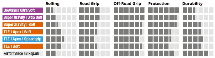

I think at £36 a tyre its not too much bother to replace if the wear rate is higher than others.
That's true, but the protection is very close together on the soft and ultra soft, the grip as well - the difference isn't huge, but surely depends on the riding style. For pro's or really agressive riders, i would definitely vote for maximum grip (ultra soft compound), not thinking twice about durability.
My own experience with the ultra soft tyres on the rear (on my non-e bike) is, that they wear out pretty fast, but that's also because i'm 100kg - a tyre will last much longer for lighter riders (a friend of mine has 55kg and rides his soft racing ralph tyres for years).
The following is the chart of the Eddy Current - grip & protection looks fine to me and the durability should be outstanding (really looking forward to them as my next set):

Yes, the DH offers the best protection and because it's the ultra soft compound it has the best grip as well - but the durability (on the rear wheel) will not be the best. Check out this Schwalbe MM chart:
