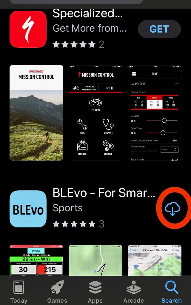

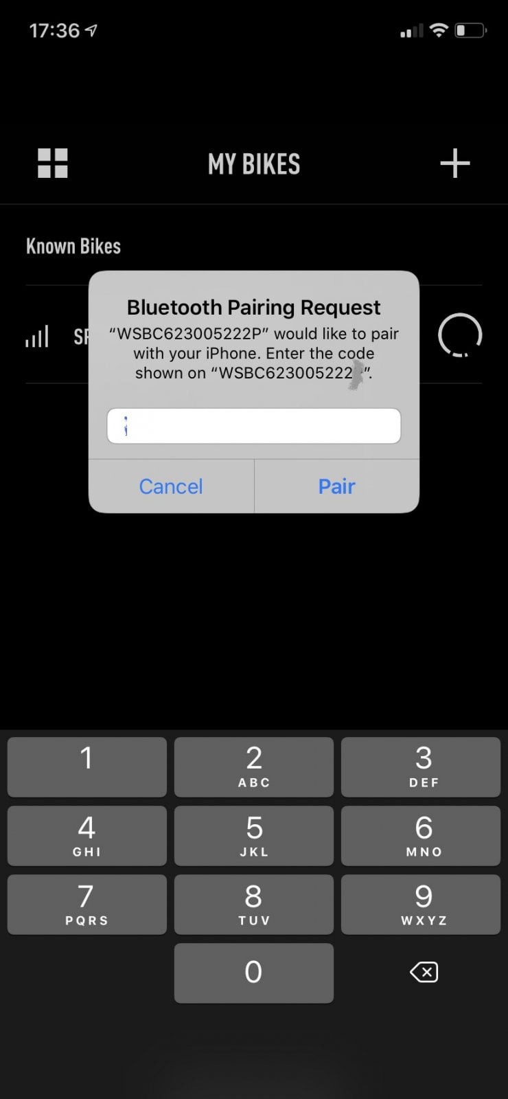

I had problems pairing with mission control, so I deleted it and tried to repair I now get enter this code. But I can’t change keypad to letters, I’ve entered it as a number and still can’t connect! Any ideas?
What about trying this button?

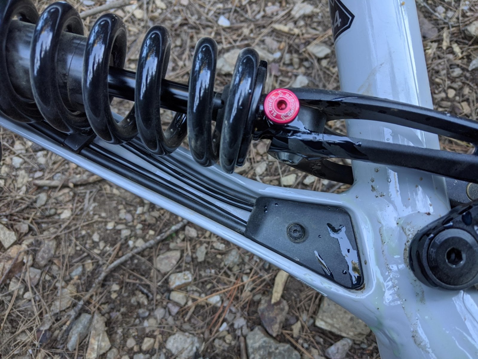

I have ordered a comp from my lbs, however, expected delivery date is December. Apparently specialized have them in stock but there is an issue with the rear shock that needs to be sorted before they will release the stock they have... Anyone heard of issues with the comps shock?
? I’ve noticed that the paints rubbed of inside the shock, thought it unusual, will post a pic later!
Looks like I might have yet another return to bike shop coming up, also the motor kept cutting out yesterday
Unscrew the TCU from the top tube. Flip it and you will see a six digit code, numbers only! It is just numbers what you are supposed to enter, this is why the app does not let you enter letters.

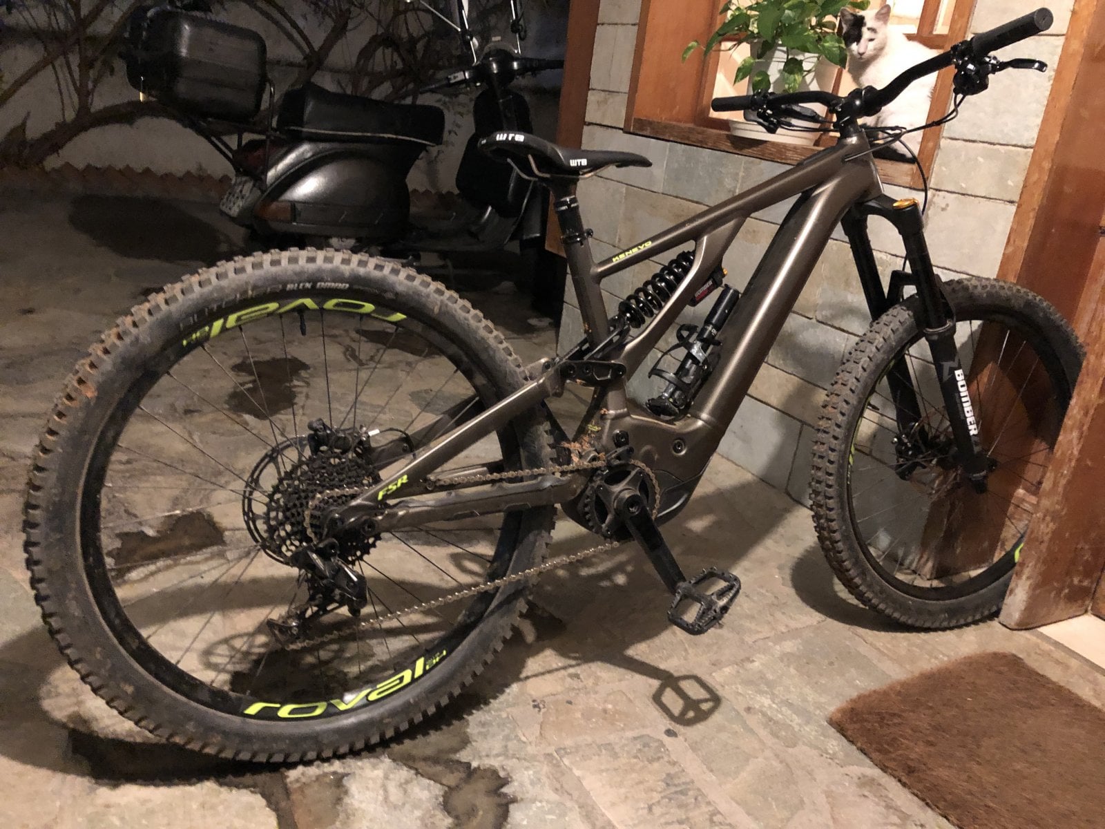

1. Reliability. My shock failed 3rd November. On the 4th it was already given to Fox for repairs under warranty, on the 9th I was on the trails again. It didn't cost me anything since the dealer is very close to where I live and work. The shock is currently working perfectly, I don't know if it will fail again soon, remains to be confirmed. The shock's failure is not the reason I want to replace it.
2. Performance. Wade Simmons, the "Godfather of Freeride" seems to be running exactly the same suspension front and rear on his Rocky Mountain Powerplay. Please see the following photo:
If the "Godfather of Freeride" is satisfied with the Marzocchi performance, so should I, right? The truth is that I am. Performance is excellent. After a few laps on the bike both Marzocchi parts was perfectly dialled. The shocks are performing brilliantly and this is not the reason I want to replace them.
So what is the reason?
Well, in my opinion, upgrading is a great part of mountain-biking. If I can sell the fork and shock and fund partly another set of suspension, why not do it? Also, I recently found out that you can sell almost everything. I sold my 2009 SX Trail bike in 2018! In 2019, I also sold my 2012 Knolly Chilcotin (that I bought second hand at some time). I am still selling parts. For example, I already sold the 11 speed drivetrain of my Kenevo and the 12 speed GX eagle coming off my 2018 Moxie is getting on the ebike tomorrow. Working on the bike, exchanging parts, doing mistakes, is all part of mountainbiking.
Brgds/Nikolaos Tsivis

All I ever wanted was a eDH bike.
I wanted 200mm travel back and front and I already had the fork from my last Kenevo so that was an easy swap. I think from memory it was a 46mm offset?
With this fork and a 29er front it slackens out to around 62 degree HA. Defiantly noticeable but still climbs no problems.
For the rear shock I wanted to keep it ohlins, they had a 242/76 so I had them reduce that by 6mm to give me 236/70. This gave me 201mm travel at the back and I initially ran two offset bushes to give me a 230 overall eye to eye measurement.
As the bush was solid without the thin outer bush it had no movement and the top bolt was always loosening itself. I decided to go back to a centre bush with the outer bush which raised my bottom bracket. No big deal as the bikes so long and slack it’s fine. Works out the same measurement as flipping the chip in the original shock.
I also checked by removing the spring and cycling the suspension to make sure there was clearance in the frame which there was.
As for the ride? Well it’s fine, I’ve taken it down some sketchy trails and take a few decent hits, drops and it loves it.
Not one problem so far, just lots of fun and I finally have my eDH.
