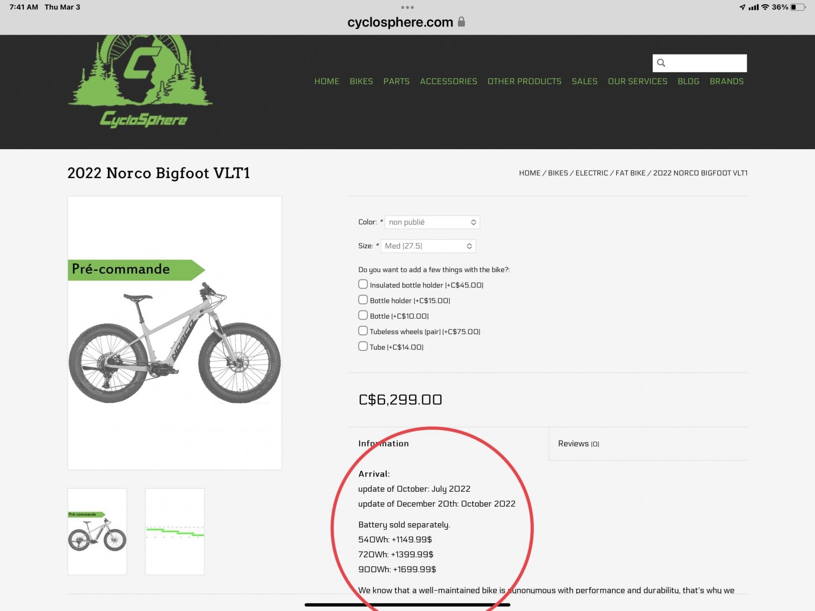

Bigfoot will get 900wh battery option and 27.5 fat tires.
seems that everything is a bit of a secret on this new machine but maybe slowly evolving from rumour/speculation to actually a misprint?/rumour/speculation….it would be great to see an improvement on what may be the biggest oversight in the previous years
jbrown15
May 27, 2020
815
686
Chilliwack, Canada
Wow, is that $6299 plus the battery or battery included?
If it's not included that's pretty crazy that a hardtail emtb would cost basically $7450 plus tax with the cheapest battery option.

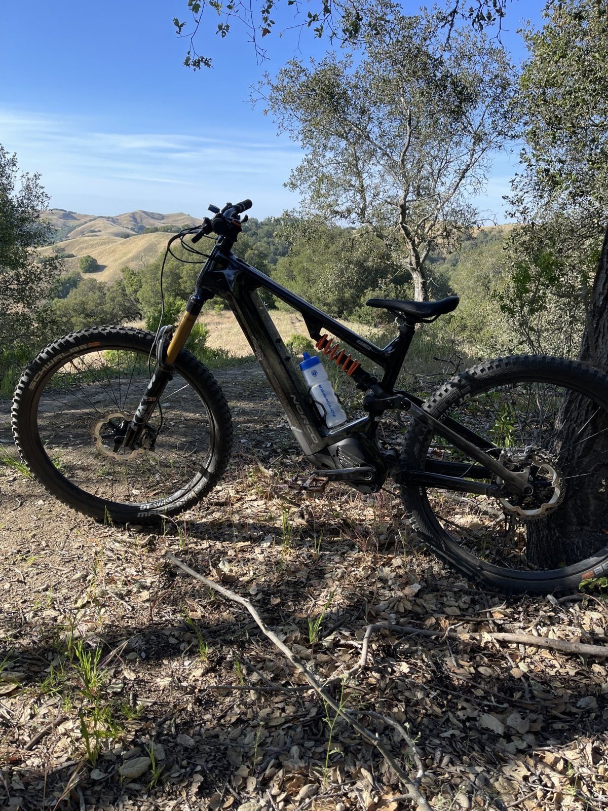

Great looking Range! Did you swap out the stock tires? Got my Range (first e-bike) in November and have just over 1300 kilometers on it now. It has been great.
i did change the tires and add cushcore to the rear. I found the Assegai’s had more rolling resistance than the Schwalbe’s.
This is my 6th Ebike, my last being a Trek Rail. I sure miss that Bosch motor, it would absolutely destroy this EP8.
BowenTheSheep
Dec 14, 2021
24
