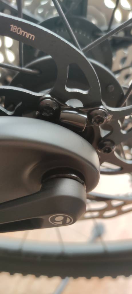

What's the part you're waiting on?
Gordon
The part arrived yesterday but it doesn't work.
To be clear, I upgraded my wheelset, and brakes, so the rotors I have are the same set that come on the E-Caliber 9.8, not the 9.6, which is what I have.
The slight difference in the rotor may be the difference in this magnet sensor fitting, but it would make sense for the two E-Calibers to have similar magnets and sensors. No?

ifcbikerpro
Jul 7, 2021
12
ES
Nor do I take the original discs and I changed the original position and everything worked perfectly .. previously I put a photo of how it was.

I would put the original magnet on you as Trek tells you in the last recall .. I see that you put another magnet and it goes very close to the sensor .. that is the problem. Surely, if you put it as I wear it, it will go perfectly with you.
I did put the original magnet back on it and am actually on my way out to ride right now!

you have to ride it backwards from how it came mounted of origin .. as seen in my photo .. you will see the mount that is very separated from the sensor. That way the bug in my e caliber was solved.
I understand that. I'm the person who posted the Trek Service Bulletin ;)
