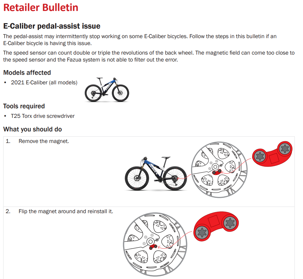

Fazua NA is saying that it may(emphasis on "may") be the position of the magnet sensor which could be giving the drive pack some inconsistent information. They are sending me a 6-bolt magnet that will position the magnet just like the Domane centerlock rotor.
If this doesn't do the trick, we'll dig deeper on the trouble shooting.
Ahhh.... My eZesty still has a spoke based magnet. This is why I don't seem to have this issue. I just line the magnet up and ride. The sensor is fairly picky about where it like the magnet to be though.

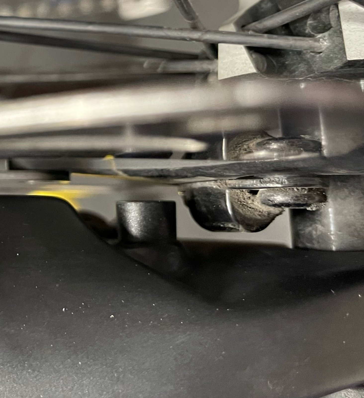

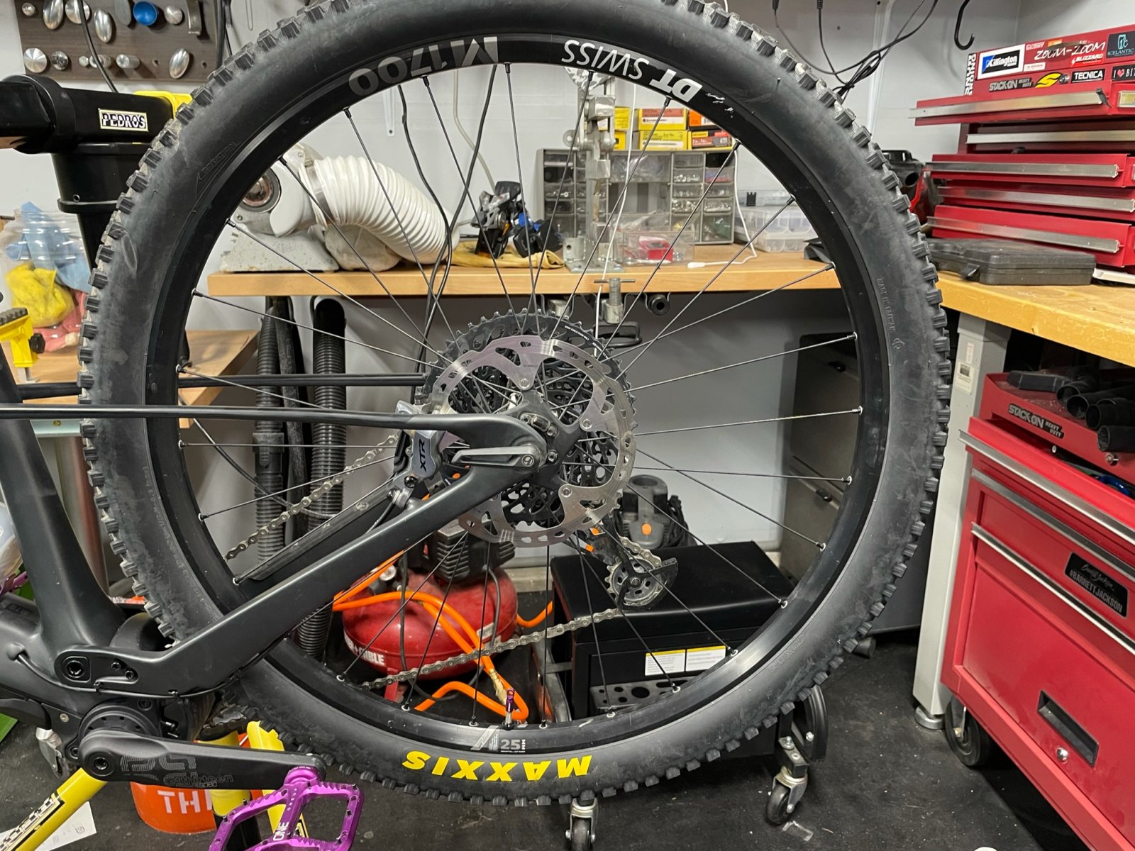

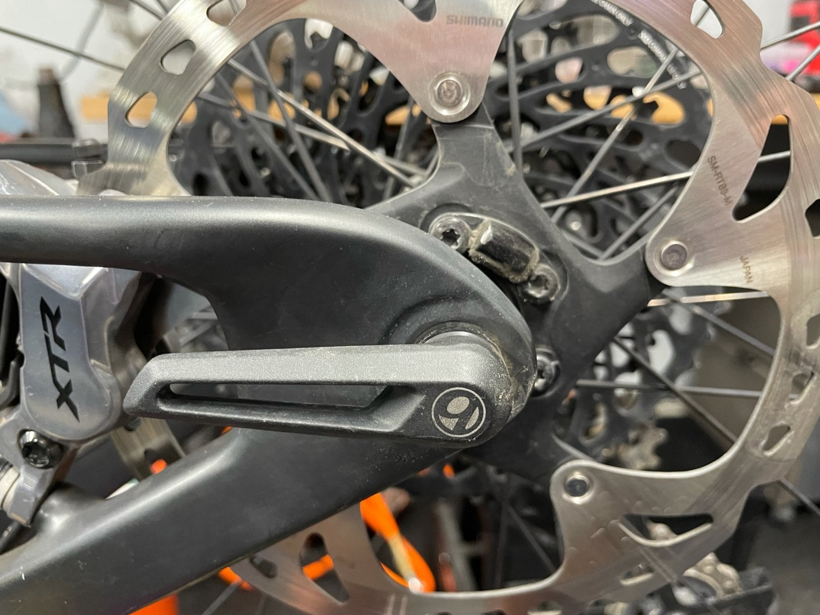

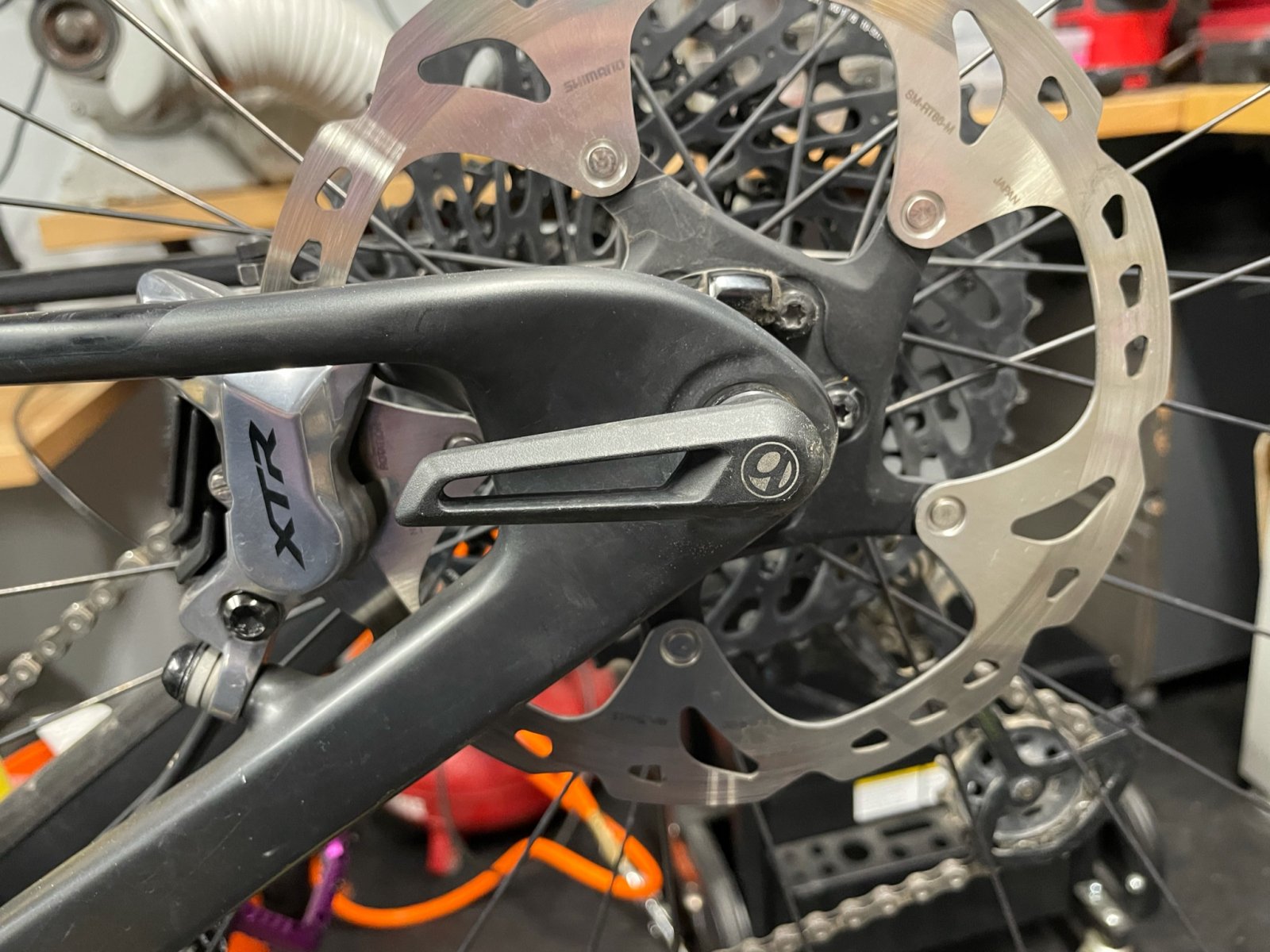

Here is a close up of where the sensor is on my bike
Here is a closer up of where it is when it passes the sensor.
I'm not totally convinced that this is all about the position of the sensor. Hmmmm.
Full disclosure, I have an upgrade in wheelset and brakes.
This was done at a Trek dealer so there is an assumption that it was done within spec

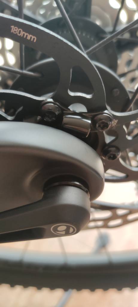

I also changed the brakes and discs..the wheels are the same, the sensor magnet when going screwdriver to the disc always maintains the same position..the only difference may be the thickness of the disc and that it varies some mm in approaching the sensor but within the same position..the sensor always detects it..other thing is that you separate it and it does not detect it but it is not the case .. the error has to be more of the sensor that reads data that does not correspond..in my The bike will mark you 8 to 16 in a second of difference and more speed than the real one.

Thanks for the information .. tomorrow I will change the position to verify if the error is solved and I will comment on it here.

That's interesting and novel in the solution, might be applicable to some other bikes with similar issues .. Have you tried it ?
I have flipped it but haven't ridden. Not sure when I will be riding again as the wildfires just west of where we live have blown horrible smoke into the area.

I have already turned the magnet and tested, it already marks the real speed without offset, therefore it cuts the speed at its programmed speed. This weekend I will try 3n the mountain.
