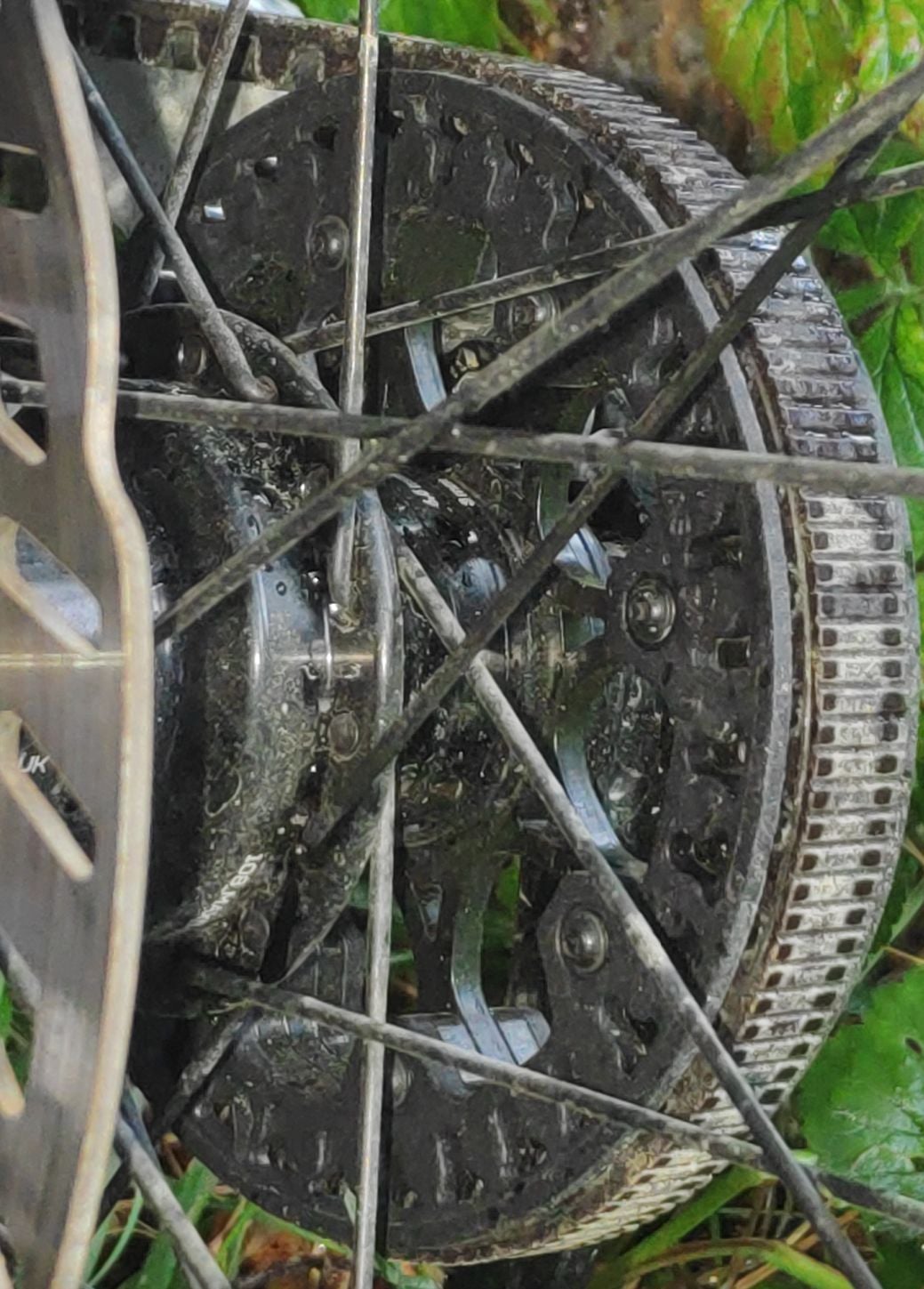

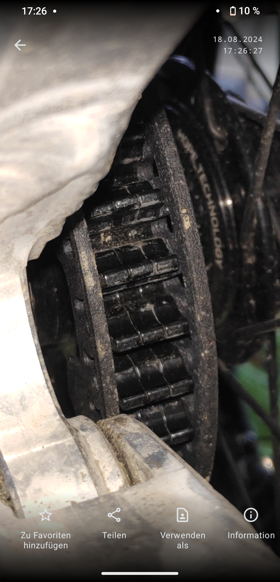

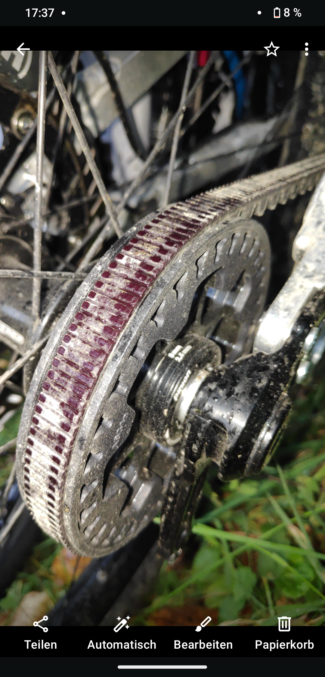

Could kindly take more detailed pictures please? I am interested in seeing how Nicolai designed the rear sprocket to go without the stubber.
I think they call it "snubber", See here
The new rear sprocket contains "side guidance" instead of "middle guidance" compared to the old one. The belt is the same, I guess. The pictures show that the belt still has the nut in the middle, because the front sprocket still uses the "middle guidance".
Some pictures:
Screenshot_20240818-172915_Galerie.jpg Screenshot_20240818-172653_Galerie.png Screenshot_20240818-173728_Gallery.png Screenshot_20240818-175555_Galerie.png Screenshot_20240818-175749_Galerie.png

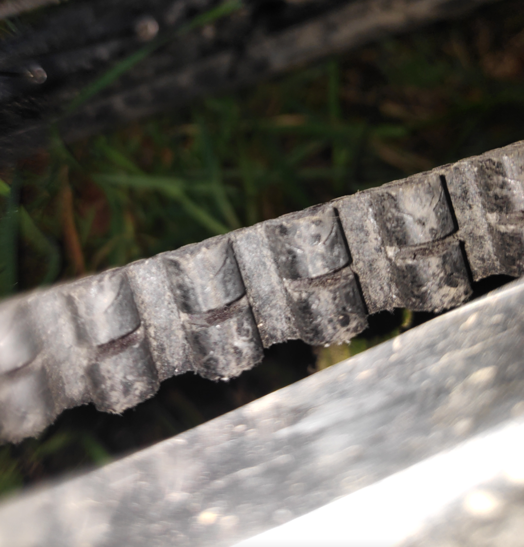

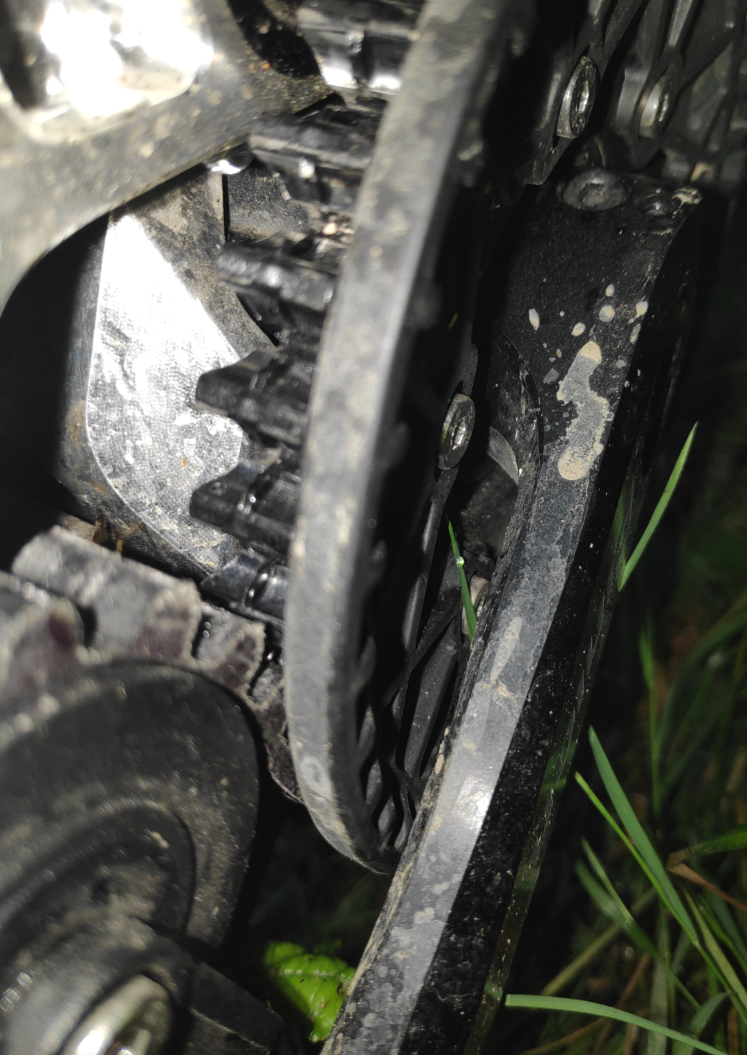

Some pictures:
View attachment 145497 View attachment 145498 View attachment 145499 View attachment 145500 View attachment 145501
Some pictures:
That the rear sprocket has end ridges would not change the requirement to obviate a snubber. I think the reason why the ridges are there is for strength reasons, as the sprocket appears to be synthetic. The most likely reason there is no snubber is because the rear sprocket is pretty large (can you count the teeth back there?), where there is enough teeth to keep the the belt from skipping and the moment arm is increased as well, which requires less belt force to achieve sthe same torque.
The snubber really grew out of usage from Rohloff geared hubs, due to torque constraints and the location position of the 1:1 gear, the largest Gates sprocket allowed is 22T, and is small enough to require a snubber to keep the belt from jumping, especially with dual suspension rigs.
I wonder where Nicolai sourced this sprocket or if they home-grew it or subcontracted it out (perhaps to Universal Transmissions?). Does anyone know what gear is 1:1 on the Pinion MGU?

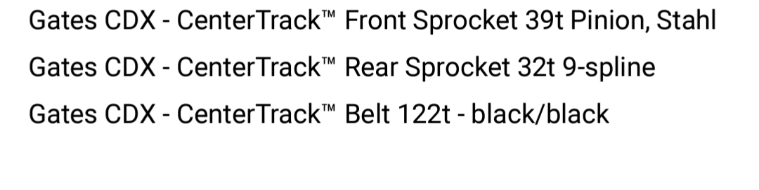

Nicolai calls it "ANTISKIP".
See official letter attached - sorry I own it only in german language.
The number of teeth are mentioned in the bill of material, screendump attached.

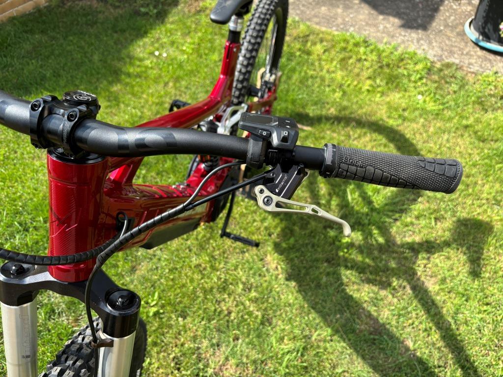

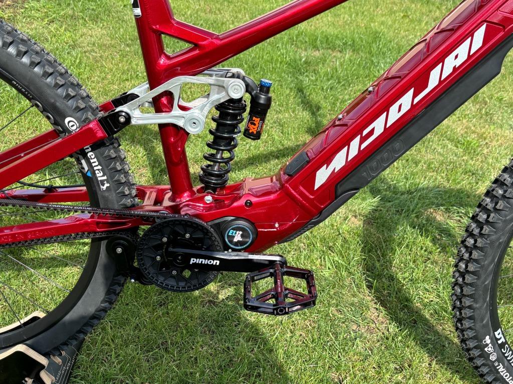

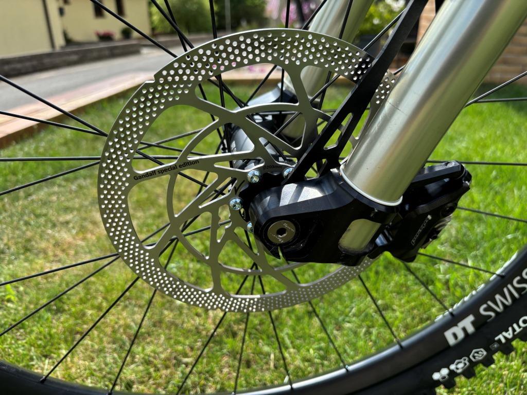

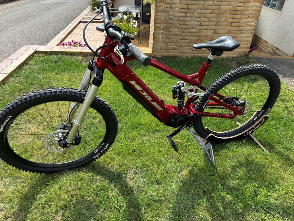

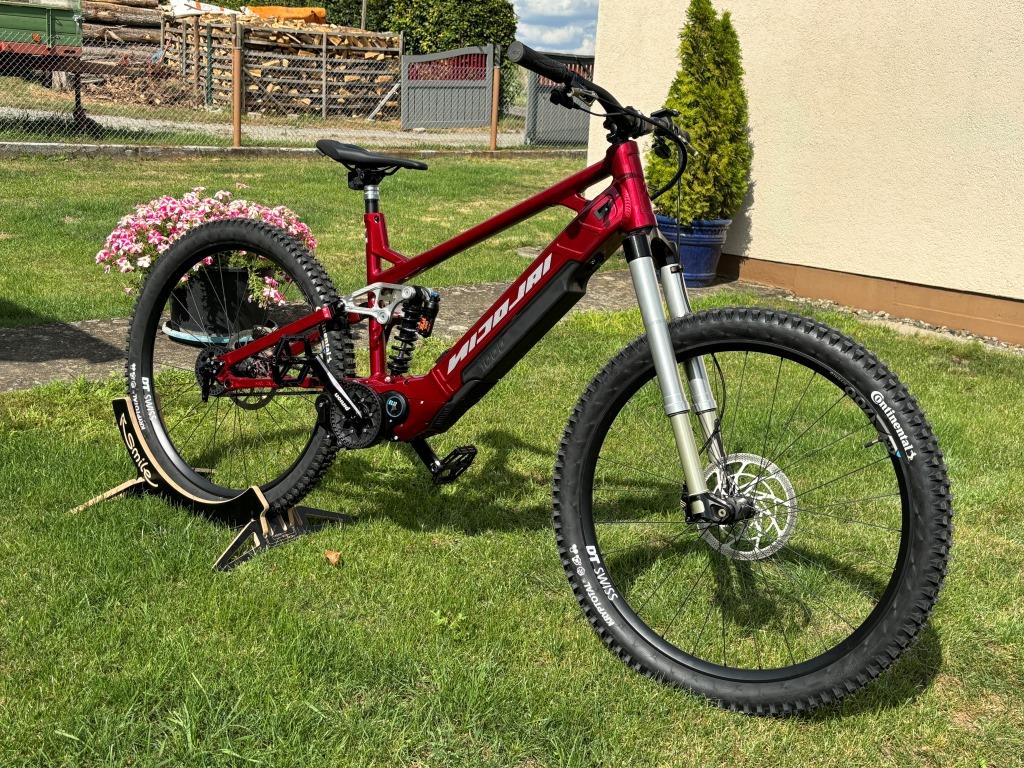

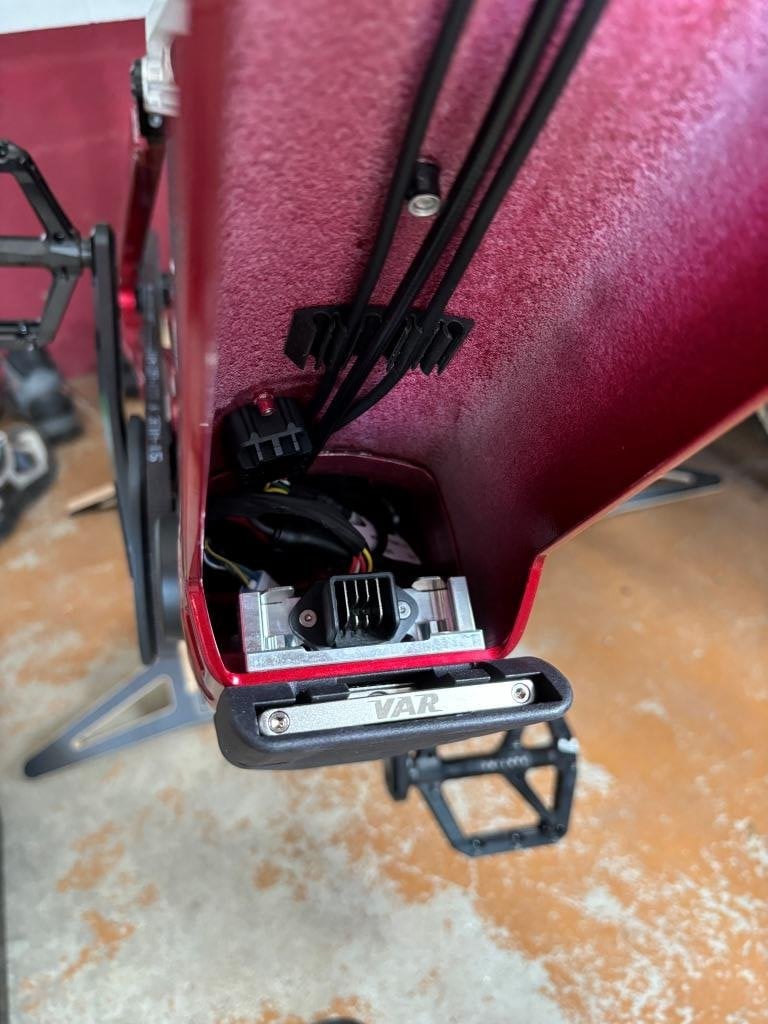

My new customized Nicolai Saturn 16 MGU in candy red
Intend Edge
Intend Trinity
Rockshox reverb AXS
Punchdisk brake discs
Airtime pedals
Info from the test ride with Vincent in June
Super quiet downhill, no rattling, no chain slap, not audible
Gear changes are very smooth and very fast, shifting under load and when stationary is no problem.
Uphill at high cadence you can hear the gearbox and the motor in gears 1-4
The Saturn 16 MGU is perfect for long tours as well as uphill and downhill single trails, even a visit to a bike park or trail park should work very well. (will catch up 😊 )
I was out on a few trails in Schweinfurt Forest today and have to say that the bike goes over roots really quickly. In tight bends up and down you notice the length of the bike, but if you're used to it like I am with the Voima or the EBOXX, it works great. There is nothing to criticise about the built-in suspension (FOX), 160 at the front and 160 at the rear. It absorbed the small jumps like nothing. You also notice that there is less moving mass on the rear wheel.
The right way forward!
Conclusion:
Not a light eMTB with its >27 kg, but perfect for long tours and singletrails
Unfortunately still a little noisy in the lower gears with a high cadence
The sprocket is made of steel.
I tested it with a magnet.
Only the sprocket cover with the mentioned "end ridges" is made of hard-plastic.
All Gates sprockets seem to be made of "stainless steel", at least the CDX ones which I have found on the Gates webpage
But the new one, which I have on my bike, seems not to be listed there yet.

So what hub is used in the rear wheel and what standard is used to connect the sprocket? Shimano Surefit or Inter 5E or something else?
The new Hope Pro 5 hubs are installed there, in the rear in the powerful version for e-bikes. This means 54 engagement points instead of 108, but the locking blades are more robustly dimensioned.
The complete rear wheelset setup, taken from BOM:
"HOPE Rear - FORTUS 30W 29 - Pro 5 E-BIKE 32H - 148mm - HG STEEL"
It is Shimano HG freehub standard, 9-spline.

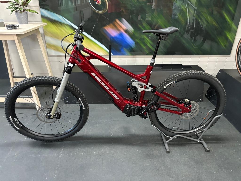

Am i the only one tempted to get one with the explorer kit, then hit some jumps in a bikepark with the bags on the bike just because that would look so wrong? :)
Dec 18, 2019
115
53

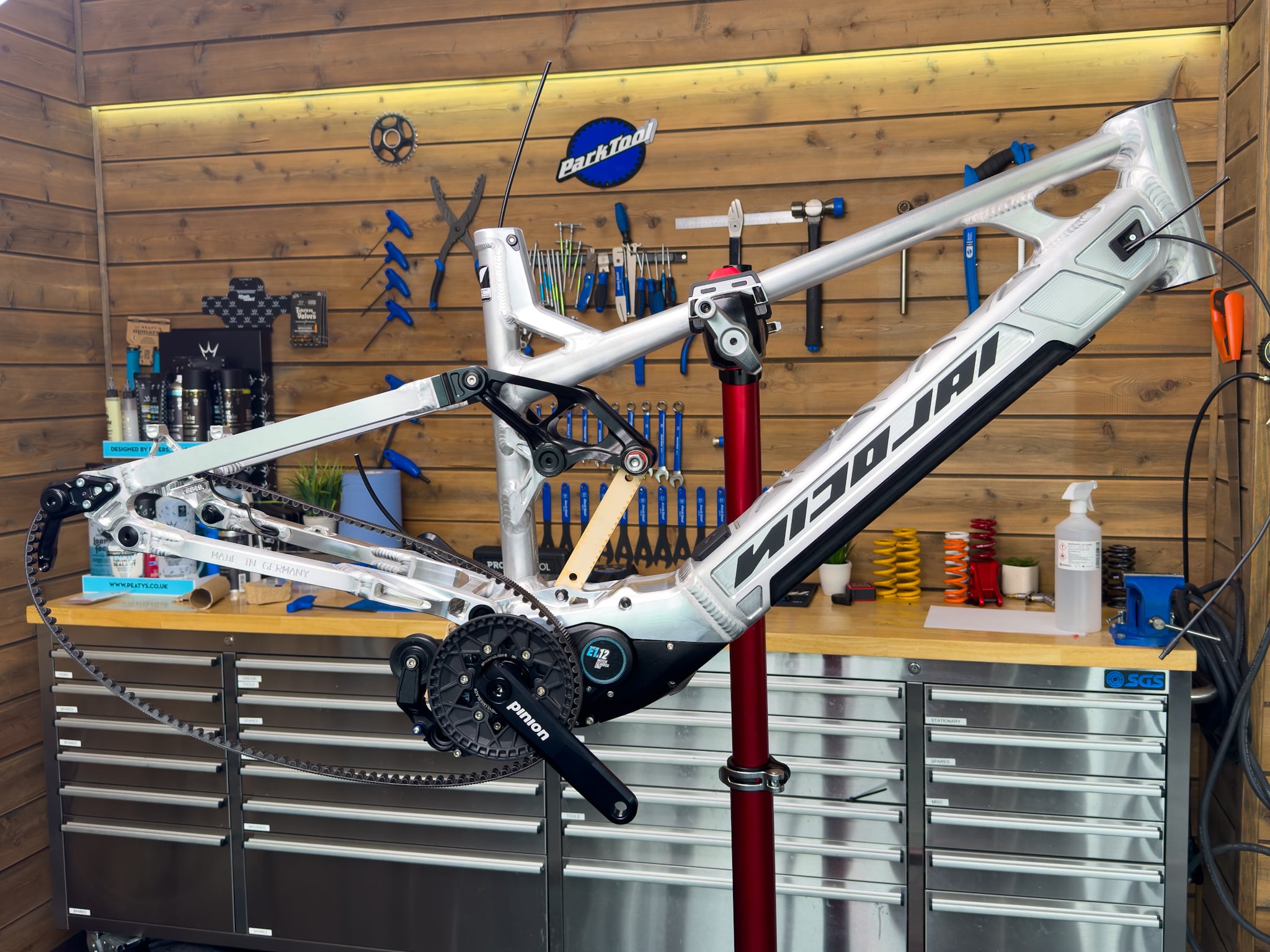

I questioned Sarah about the available finishes on the bike, but she wasn't able to answer my question with a reasonable level of confidence, so i'll ask it here.
Regarding the £400 upgrade to an Anodised Finish, does anyone know if this is a Hard Anodised Finish or the less hard wearing Decorative Finish?
Sarah only mentioned that the extra hard parts were decorative, but was unable to confirm what finish was on the frame if you order it anodised.
Rob Rides EMTB
Administrator
Staff member
Jan 14, 2018
6,292
13,850
Surrey, UK
Nice :)
Is that clear coated or bare alloy reason i ask is future corrosion issues .
Raw.
From Nicolai:
“You get your frame without coating (also no clear lacquer). Over time, an oxide layer/patina forms on the frame, causing the shine of the raw aluminium to fade slightly. With the help of a polishing fleece, however, the old shine can be restored in a few easy steps. In addition to the unmistakable look, the “factory raw” look best reveals the manufacturing quality and technical charm of the frame.”

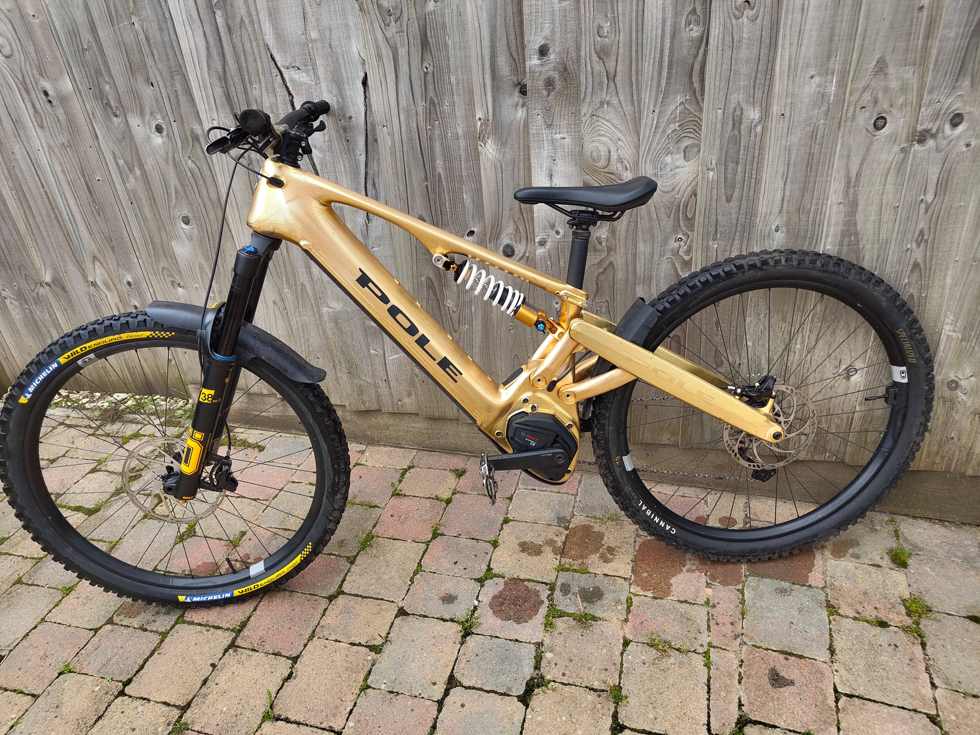

Think this will be my POLE Voima replacement...only thing that worries me a bit is the 160mm rear travel coming from 190.?
Pic for reference
