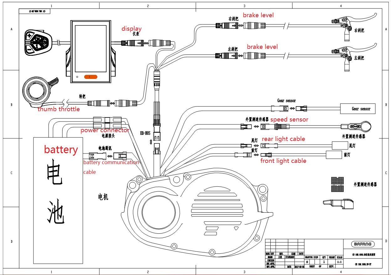

I assume you bought from Dengfu. Did you get cable-connection to support brake sensors? Do I need brake sensors? A fair amount of my tracks cover roads with common traffic so I use a flashing taillight for security. I knew there is a special cable for connecting lights but do I need some kind of splitter cable to connect a tail-light?

Yes, I bought from Dengfu, and no, You don’t need brake sensors in my opinion. Tail and head light, no idea, sorry! Please check the official wiring harness drawing from bafang.

Here You are..

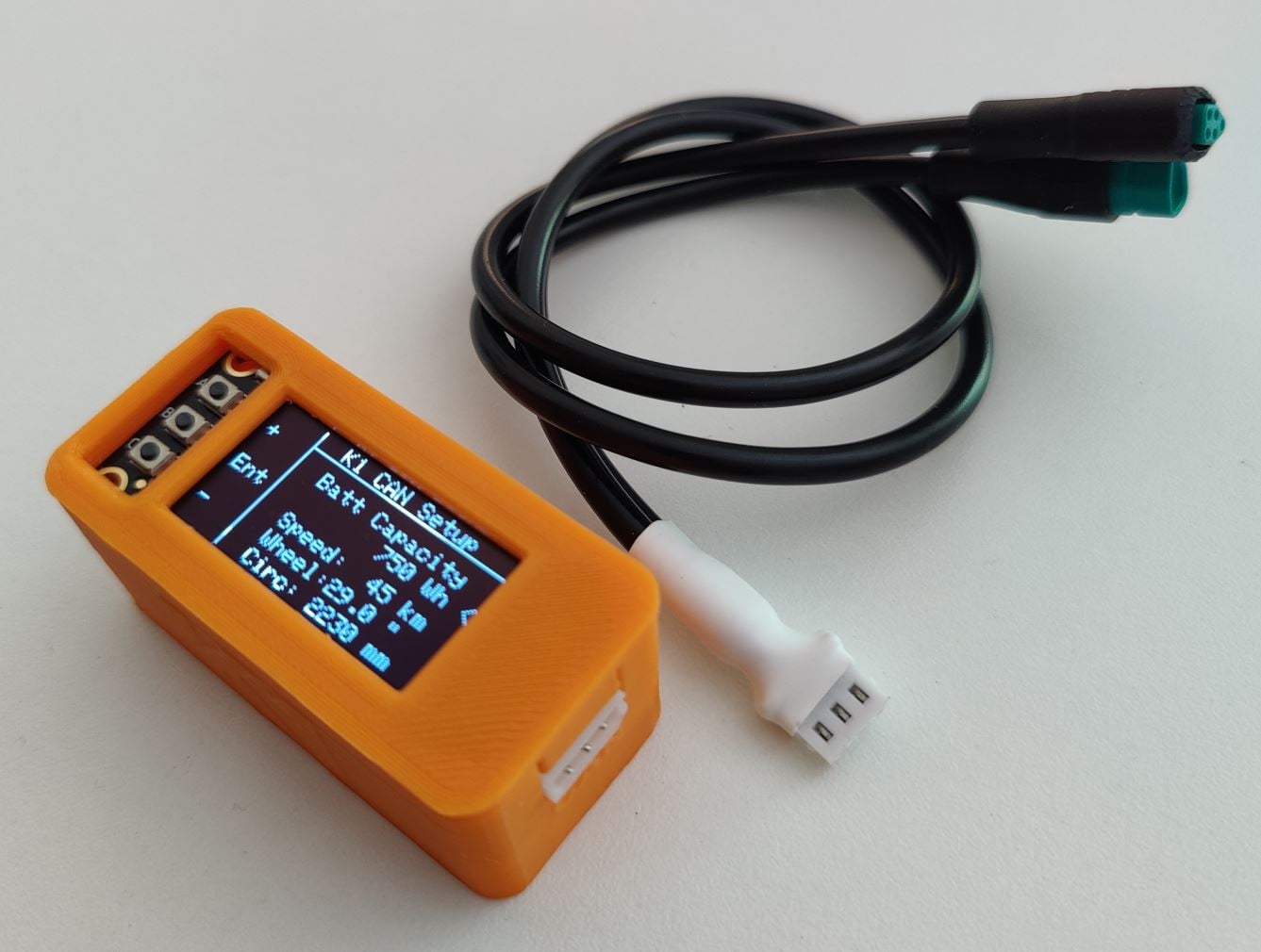

Hello ebikers.
K1 eBikes has designed small, portable and simple K1 CAN Monitor & Speed Unlocker - no need computer or mess with BESST. Works ONLY with Bafang motors with CAN bus (green connector to display with "house" shape 5 pin connector).
For more info check the following link:
https://endless-sphere.com/forums/viewtopic.php?f=31...
How to unlock speed:
https://youtu.be/6z3TzEqNWsQ
If you interested, send an email to [email protected], will answer any questions and will send user manual.
K1 CAN Monitor is determined for testing purpose only and is not waterproof.
