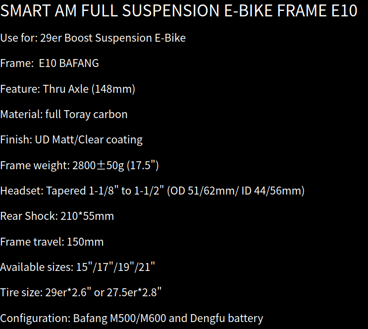

The hardtail Dengfu E14 might be pretty good choice, it fits a M500 and a 48V (768WA) battery.

why don't you buy the dengfu e10 and the m800 motor and do the mod which has been done by Karakoenig.You will achieve 17 18 kg with as far as i remember 600wh battery.Just look at this thread m800 build
this is what i plan for my dengfu with m600 but ill buy the motor later .
greets sava
Do the Dengfu frames come with an empty battery case? I cannot find anybody offering Dengfu batteries. Who offers the mentioned Dengfu 48v 768WA battery?

Hi, when you order the dengfu frame it's a option to deliver the battery and motor with the frame.
Greatings
Thanks, It appear the Dengfu E14 is pretty close to my target especially if I can get the 768wa battery. Do you order directly from Dengfu Sports Equipment Co., Ltd ?

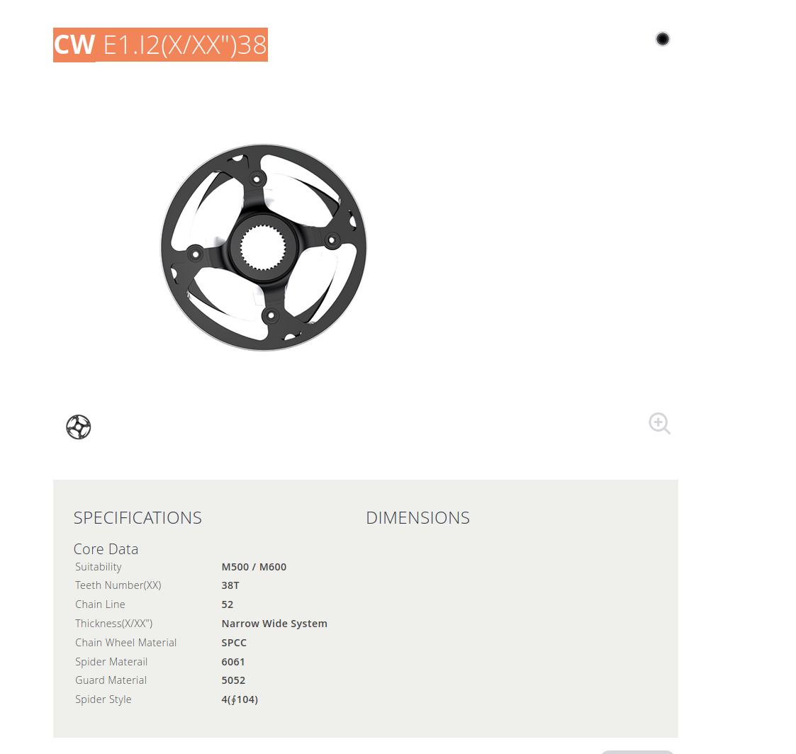

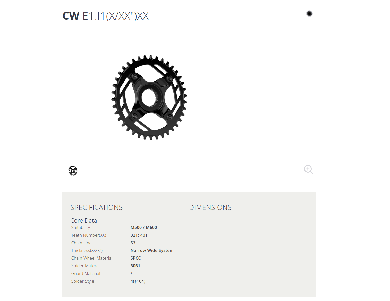

Does Bafang make the 32T chainring they specify under the "M500 Drive System"? If so, who would market them. I think I have figured out the rest of the components so I could place an order on the Dengfu E14 frame with the 48V 768WA battery and the M500 engine. But I will will not budge on my requirement to have the (in my opinion) proper chainring. Is'nt it odd that them specify 32T/40T as the proper sizes and then not supply them?

The motor is delivered with a steel chainring from bafang. Don't know the tooth count for a m500 motor maybe other members can give you this information.
The chainring is mounted on a spider 104 bcd size so you can fit aftermarket parts no problem...

I am buying the whole package with frame, battery and M500 motor from Dengfu. They say they can only supply 38T or 44T chainrings. Shall I interpret what you write their 38T chainring is attached to a 104 BCD spider, which will enable me to detach the 38T ring and attach an other chainring of my prefered 32T choice?
I could be wrong but a 38t - 44t suggests a 110bcd.
Are you able to screenshot the chainring so I can view it in case I'm looking at something else @pelle ?

These are screenshoots from Bafang components spects and the photo is what I got from Dengfu when I asked "What's in the M500 motor box", with the comment like "Something like this, M600 box". So the problem is that Dengfu doesn't really know (in detail) what he is supplying. They said we only have 38T and 44T chainwheels. We don't know the weight of the frame because we don't weigh the frame separately. It sound like the frame comes from an other source than Dengfu.
Could you tell from the photo if there are provisions to connect brake sensors or whould I not care about the brake sensors. A rear light maybe nice but there seems to be no provisions for that.
right, as you can see in your pics, it is an 32

Unfortunately what you see in the photo is only "Kind of " what they say they deliver, but explicitly state that they ONLY carry 38T and 44T chainrings......
i think we have misuderstanding. The motor is delivered with 38T or 44T, no mater because you put it in the trash (or you turn it into a work of art). because it is in heavy steel and it is a shameful to use it on a carbon frame. you replace it by a beautiful 104BCD narrow wide alloy plate in 32 , 38 or other you want.

I don't mind steel component on a carbon frame if they fullfill their mission and I will probably keep a 38T for hard times. Hopefully I can use the 104 BCD spider as you suggested and then everything might be resolved. Thanks for your response.

Like Patdam mentioned, You can use any 104 BCD Chainring. I‘m runnuing a 32 T Garabruk narrow/wide myself on the M500 cranks/spyder.

Absolutely if I get a a 104BCD spider I will be fine, nice to hear that you are also using a 32T chainring. Which motor and gear/cassette are you using.
Melody from Dengfu, approached me and offered to answer ANY questions, which sound encouraging.
Ebike is a new world to me, so I want to understand where the culprits are. Given long delivery times from China I find it important to base decisions on established facts rather than to find out by trial and error.
This will be my fourth carbon frame build. I bought my earlier frames from Airwolf in China. Established a very nice relation with a sales person which rendered him a lot of sales and me all the information I wanted. Unfortunately Airwolf doesn’t carry e-bike carbon frames.
I‘m sure You will get the crankset with 104 BCD spider. I‘m running a 11-46 10-speed Shimano SLX Cassette, same as Rob in the Cheeb uild thread. I‘m very happy with the gear ratio, fits perfect to the M500 behaviour. I need the 46 T sprocket only at extreme steep climbs, mostly the 2nd sprocket at 42 T is sufficient. Using the fastest gear ratio 11-32 You can pedal the bike up to 36-38 km/h.
Thanks for your response. I was thinking about the same gear set up.
Now I have a XT-12p 10-51 cassette and 32T chainring on my current mtb, that I considered shifting to the new build.Maybe I just keep the current bike intact and buy new 10p gear for the emtb. How easy is the pedalling when you tuen off the motor? Do you have to turn any parts of the motor when you are pedalling with power turned off. What charger do you use for the Dengfu battery?

My pleasure ? I would recommend 10 speed with much cheeper cassette an cheeper / stronger chain. Wear is very high with the Ebike, and You dont need 12 speed with motor. I use the charger delivered with the motor/battery. He‘s a bit loud (fan noise) but I charge the bike in the basement. Pedaling without motor is ok, more efficient / less drag then the EP 8, also over 25 km/h. But You feel the weight of the bike....
