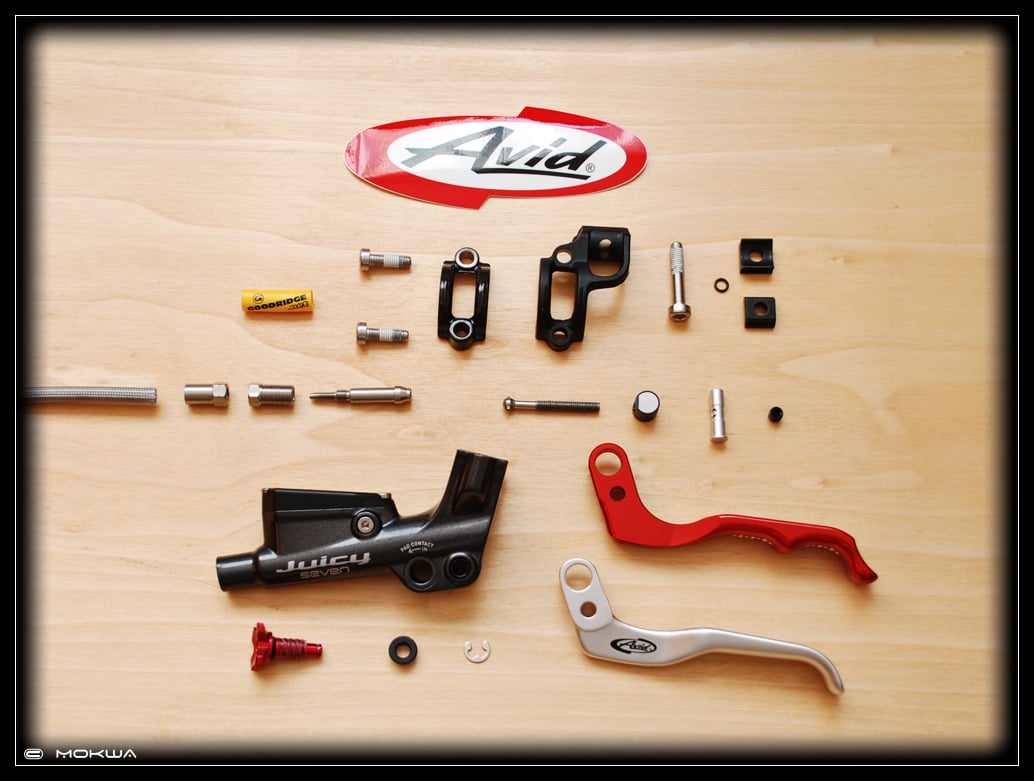

I'm obsessed about brakes. During my 30+ years biker carrier I've tried virtually all brakes from big and small brands. I was never happy with any OEM set. Around 2010 I started to build my own "custom" brakes, which is now very popular.
My first "custom" set consisted of: Avid Juicy Seven master cylinder plus Straitline levers and Code calipers connected with Goodridge lines. It not only looked good but also worked great!

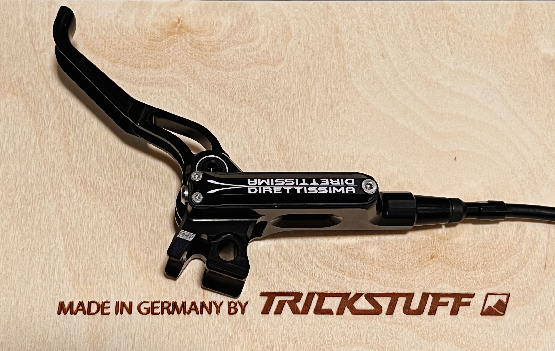

My Levo came with Codes which slowed me down but I was not happy. I didn't want to go the "custom" route again (I got lazy with age) so I decided to go crazy and got Trickstuff Direttissima complemented by Galfer Shark rotors (223/203) and Galfer G1652 purple emtb specific brake pads.
The stopping power is remarkable, providing a sense of control and safety that enhances every ride. The build quality is impeccable, reflecting the craftsmanship I appreciate as a perfectionist. Setting up the brakes was a straightforward process, and their durability gives me confidence that they can withstand the demanding conditions of my favorite trails.
What truly sets these brakes apart is their consistent performance across diverse terrains. I hate wandering braking point or different lever stroke of some brakes during long downhill sessions.
Trickstuff Direttissima has been a game-changer for me. They embody the precision, reliability, and performance I seek in brakes.

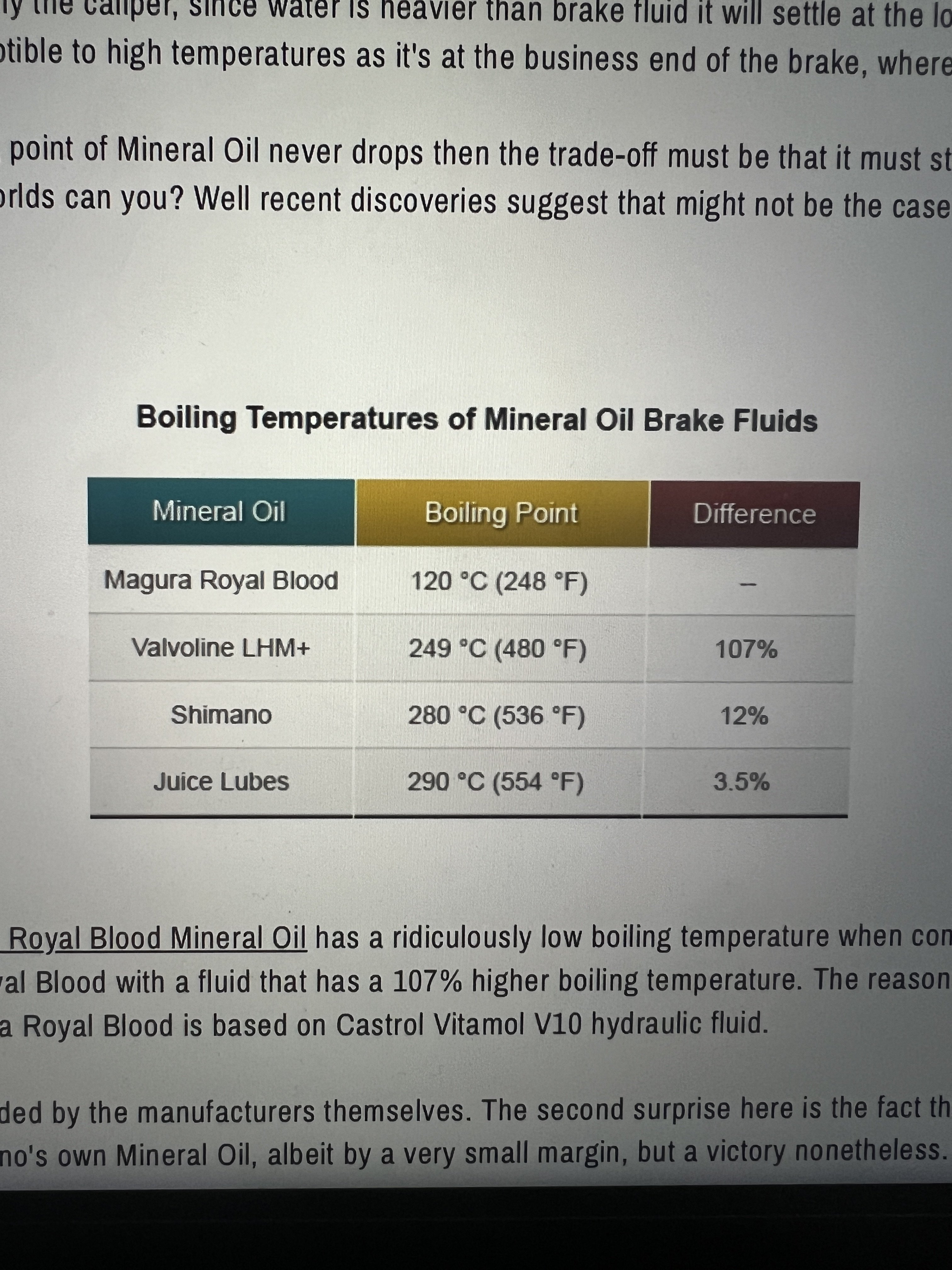

Probably because shimano's use mineral oil which is hydrophobic so doesnt absorb water
BUT, mineral oil has lower heat ranges…. This is why it’s not used in the auto industry. If you do bike park days you should change out your fluid after about 100 hours.
Believe it or not the shimano fluid is up there with dot 5, the mugura is lower than all dot's as weve both thought, i change my fluid regular on all my bikes, iv felt the difference it's made on a race bike, it's a cheap and easy job to do mostly too.

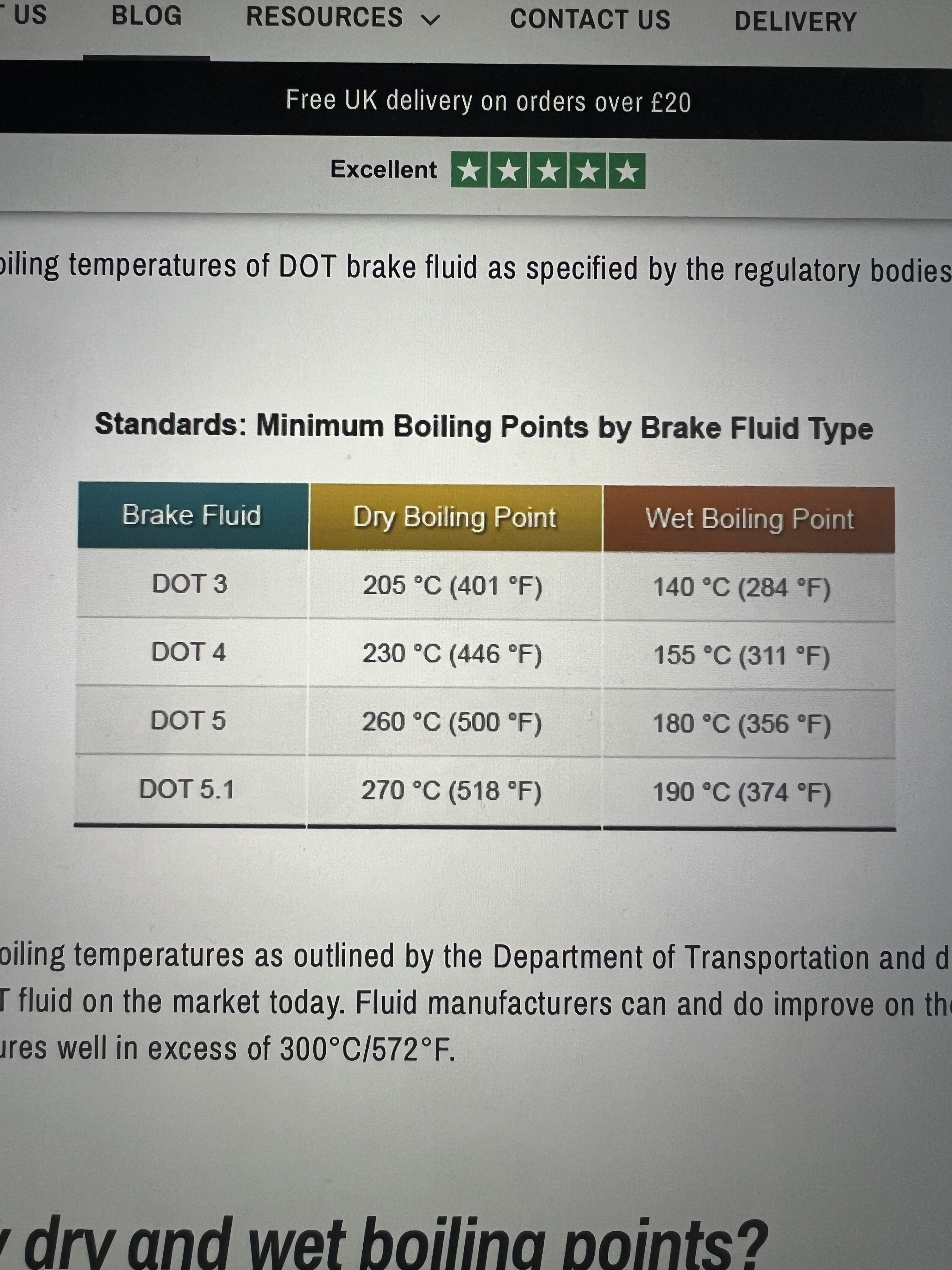

I was not expecting this.. shimano and juice lubes top all the dot's, also shows the difference between fresh fluid "dry" and old fluid "wet" again backing up it's good to change your fluid IMG_6885.jpeg IMG_6886.jpeg
Sorry, as someone that raced in the scca for years, I don’t believe it. It’s not just the boiling point, it’s the fluid stability through heat cycles.

IMG_6886.jpeg IMG_6885.jpeg Sorry, as someone that raced in the scca for years, I don’t believe it. It’s not just the boiling point, it’s the fluid stability through heat cycles.
Dont shoot the messenger..i was shocked at the results myself. I'v not done any testing just gone by the testing epic bleed solutions have done, As iv said i change my fluid regular, iv felt the difference in fresh fluid in only 3 months of racing & testing, and that was motul rbf.
