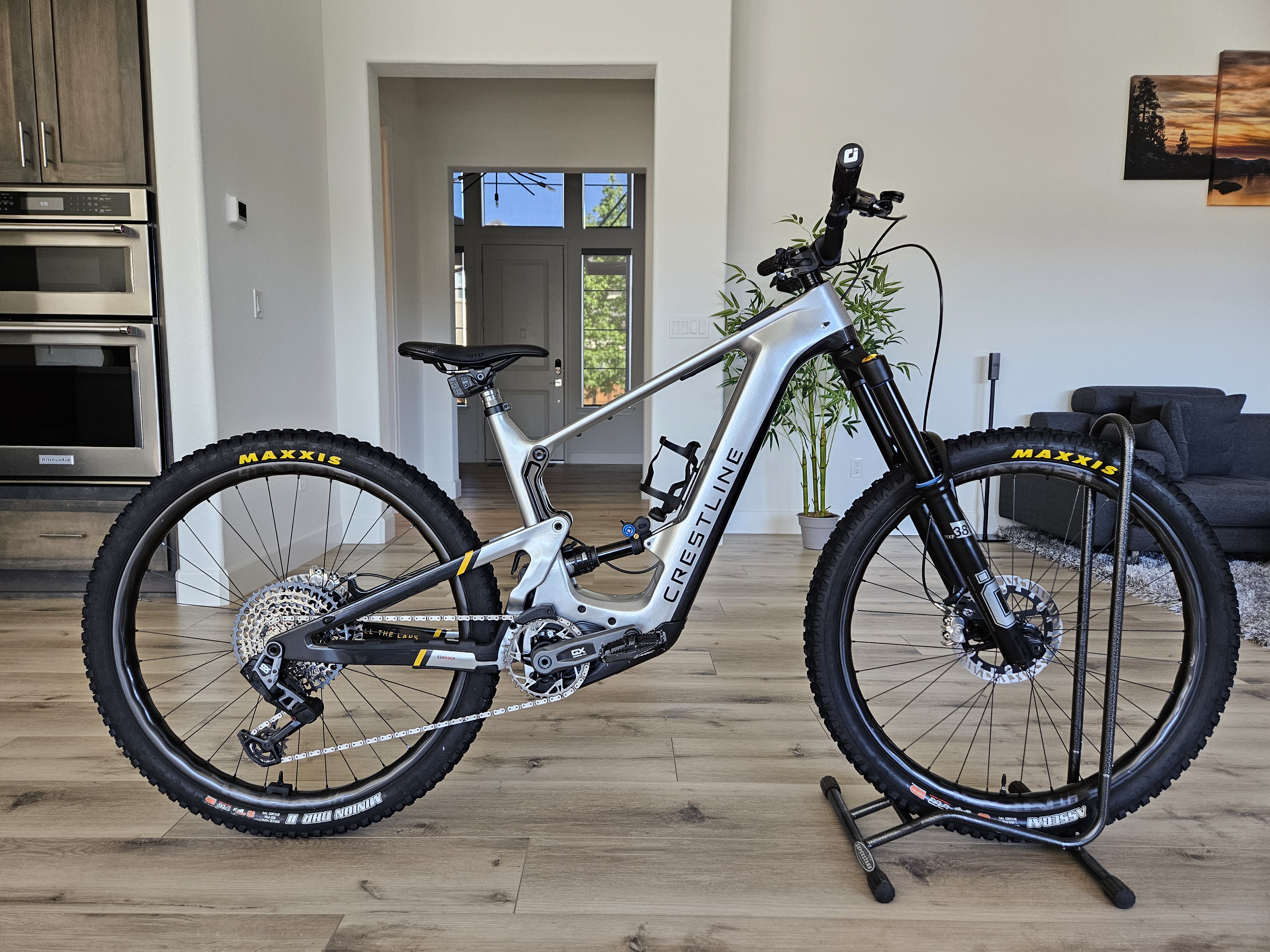

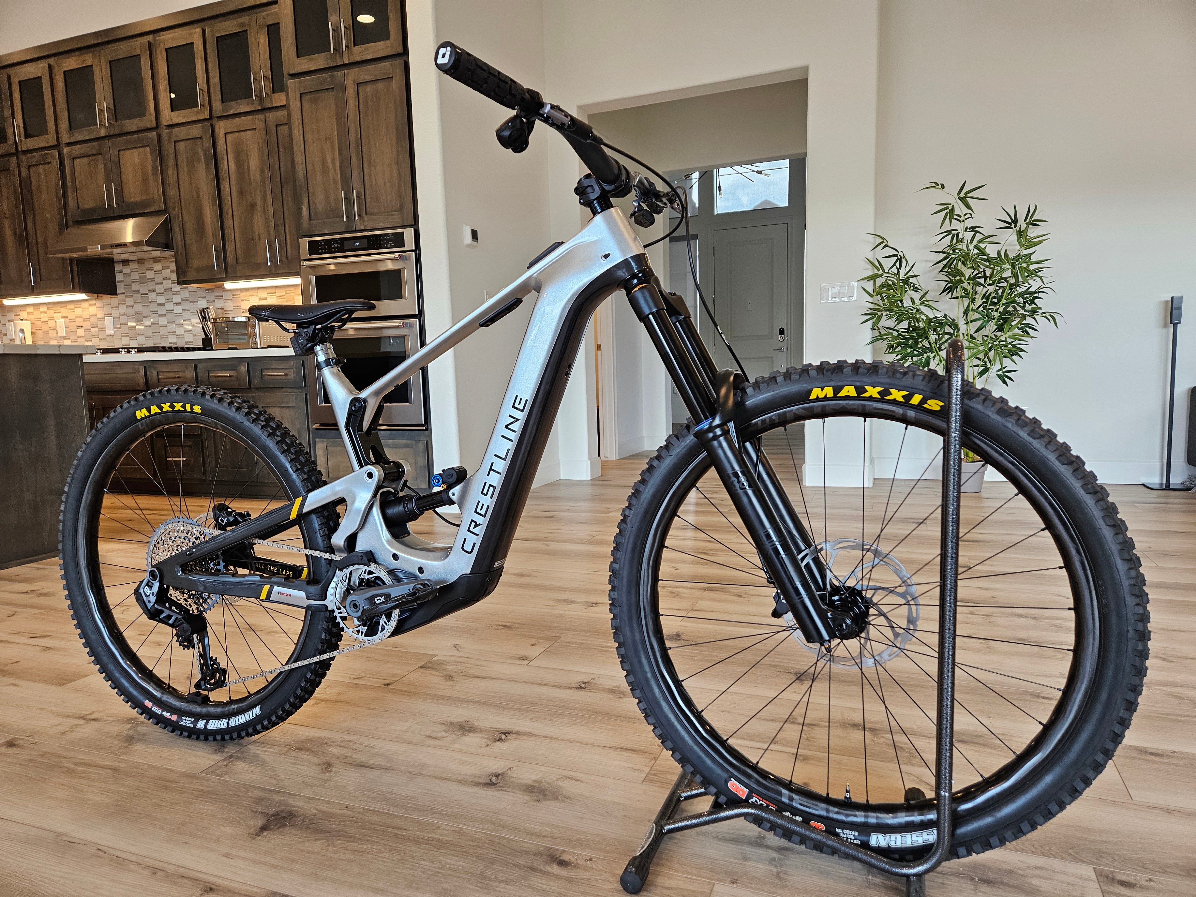

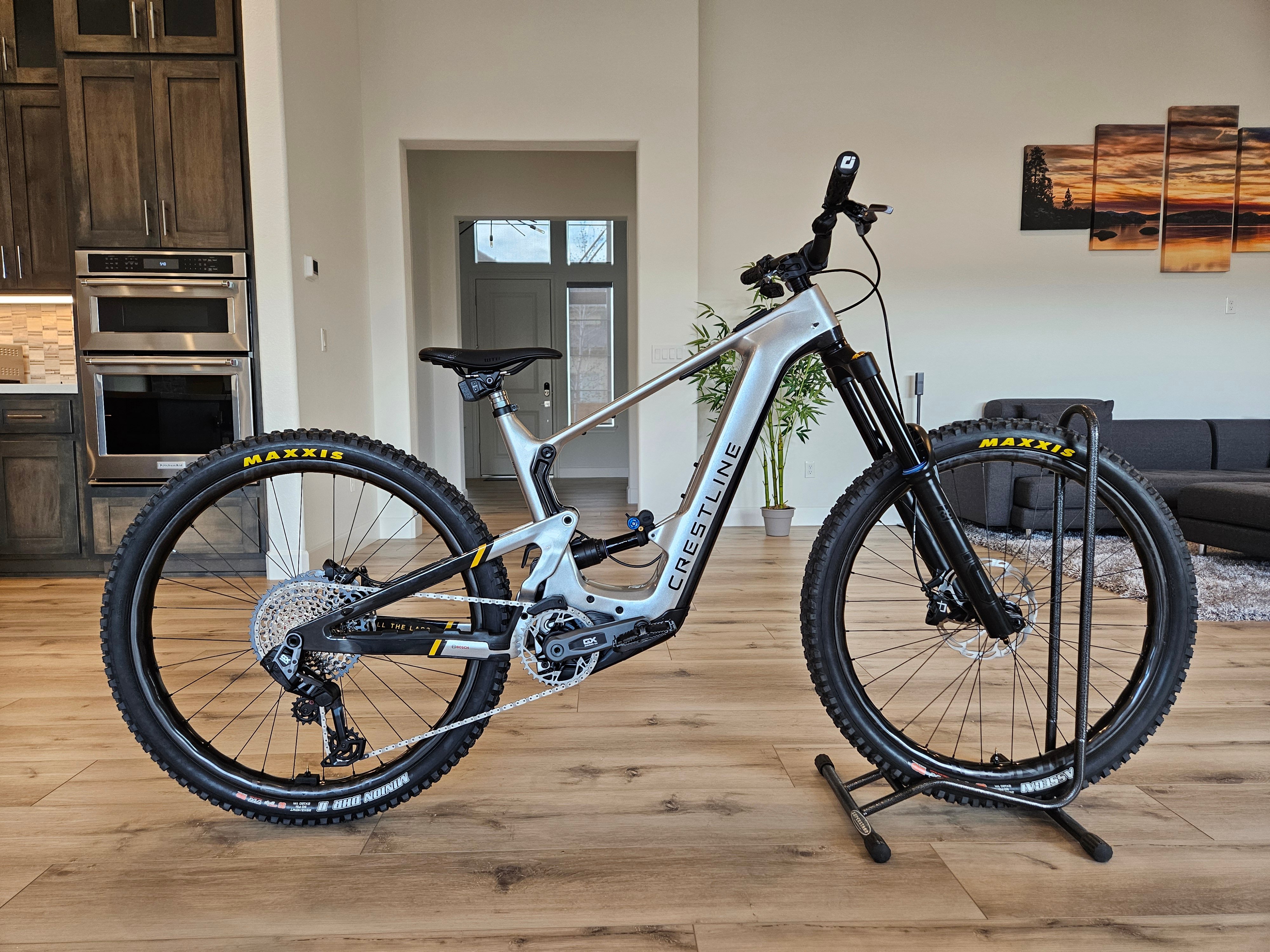

New bike days are the best! This is my 3rd Crestline bike. My white one is set up 29er/29er with 160mm/150mm travel, my black one is set up mullet with 180mm/175mm travel and my new silver one is set up 29er/29er with 180mm/180mm travel. Ordered the Crestline RS 180 Silver Edition Frameset and built it up with the following items.
Ohlins RXF 38 Fork (80psi main/160psi ramp up/10 clicks rebound/compression wide open) (I'm 6ft 1in tall/130lbs)
Ohlins TTX2 Shock (160psi/9 clicks rebound/compression wide open)
SRAM AXS GX Transmission Drivetrain
SRAM AXS Dropper Post (170mm slammed into frame)
NOBL TR41 Carbon Wheels with Onyx Classic Hubs
Hayes Dominion A4 Brake Set
One Up Carbon Bars (800mm)
One Up Stem (43mm)
One Up Aluminum Pedals
ODI Rogue Grips
WTB Silverado Saddle
Maxxis Assegai/Double Down/Maxx Grip/2.5 WT (20psi)
Maxxis DHR2/Double Down/Maxx Grip/2.4 WT (21psi)
Thank you Troydon at Crestline Bikes and Cody and crew at Pacos Bike Shop for the excellent service! You always go above and beyond for me.

why did you go 29/29 instead of mullet?
btw i live right near verdi would love to check out those bikes sometime. my ebike is like an ol jalopy compared to those. but i may get one if i can ever find a nice used one
GeorgesEBike
Jul 30, 2018
204
375
Verdi, NV
I prefer the full 29/29 with the rocky Lake Tahoe terrain. If I lived in Santa Cruz with the smoother tight/twisty trails I would go mullet. My current mullet get's hung up on the rocks. Hit me up any time if you want to check out the bikes.

Had a few a rides on the new bike and love having 29in/29in wheels with the 180mm/180mm travel. This is a home run in the Lake Tahoe area.

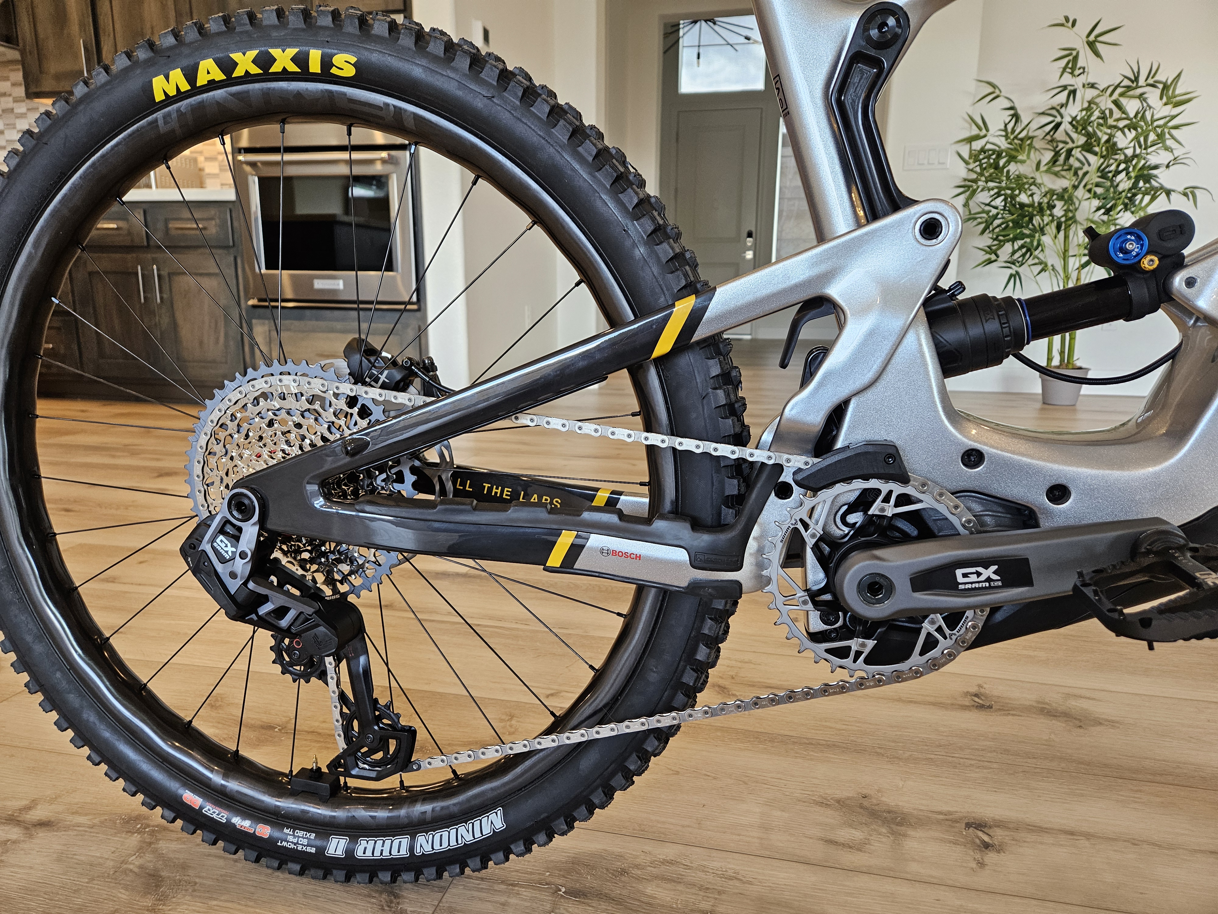

Not a fan of the SRAM AXS Transmission. Will be swapping that out for the old style SRAM AXS drivetrain. The ghost shifting sucks. Sometimes everything is perfect and smooth and sometimes noisy and clunky. The old style AXS also shifts much faster.
Also not a fan of the Hayes Dominion A4 brakes. Will be swapping those out for the Magura MT7's. The Hayes A4's feel exactly like Shimano XT brakes which I'm also not a fan of.
The NOBL TR41 carbon wheels and Onyx Classic hubs are amazing! Love the compliance and super fast rolling.
GeorgesEBike
Jul 30, 2018
204
375
Verdi, NV
Stoked I was able to fix my ghost shifting issues with my SRAM AXS Transmission today. I adjusted the micro-tune on the trail vs bike stand and had zero issues on todays ride. It does shift like crap on the bike stand but perfect on the trail. The old school AXS still shifts faster though, lol.
I'm going to swap pads on my Hayes Brakes and see if that makes a difference before I swap back to Magura MT7's.
Love my bike!
