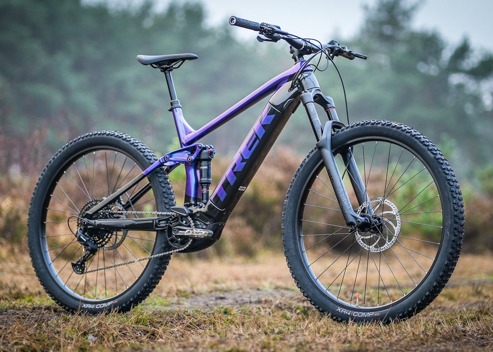

My new 2021 Trek Rail 5 Purple Flip

A fine choice, Rob - it is the same as my own!
Will be interesting to see what mods and upgrades you try and how they work out for you, so I hope you keep this thread updated.

That's a nice color.
Interesting to see how long the Rail 5 components lasts with you. Besiders frame, handlebar, brakes, dropper, front sprocket and rear shock I've ended up to change all else.

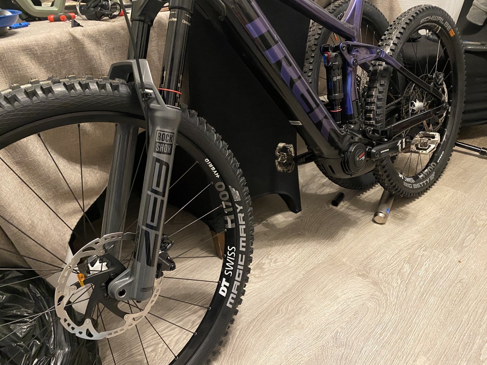

Ok some updates
Zeb 170
Mullet with Magic Mary 29 front 2.6”, Big Betty rear 2.6” 27.5” on
head angle 63.3 degrees
BB height 334mm with flip chip in low (stock reading was much higher than Trek quoted height)
Deore brakes
210mm One up V2 dropper
XT Drivetrain
weight approx 24.1 KG
9,190

So at normal RRP (I'm presuming you get some discount) what's the cost of the bike so far after these changes?
Bike: £4150
parts when shopping around
Zeb: £710
Wheelset: £473
Tyres: 90
Brakes: £160
XT Drivetrain off old bike but about £200
One Up V2 dropper including remote £220
total if paying RRP of bike £5803
could sell take off stuff for £400 easily (wheels tyres drivetrain fork dropper etc)
maybe total cost around £5400
if you can get the bike for a discount, then closer to £5k
Rob Rides EMTB
Administrator
Staff member
Jan 14, 2018
6,292
13,854
Surrey, UK
I just checked out the Rail 9. That’s £5400 so arguably we are at the same price point.
I like to faff around with parts and try stuff out. But not everyone likes this approach, often it’s much easier to buy off the shelf.
Also, not taking into account all the tools to do this (workshop stand, crown race remover, installer, all the hassle of dropping motor out for hoses etc etc!).
