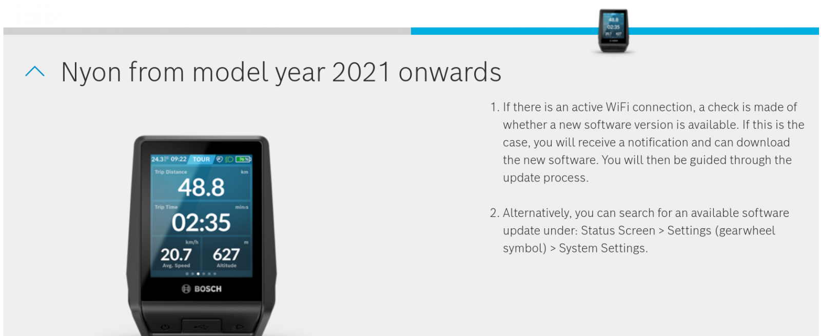

14,195
21,128
I put some more in here :
I thought at first it meant just the software for the unit itself and mapping, That screen shot is from the bosch updates page. It's the only system where it says you can download the updates - so presumably for the whole bike.
