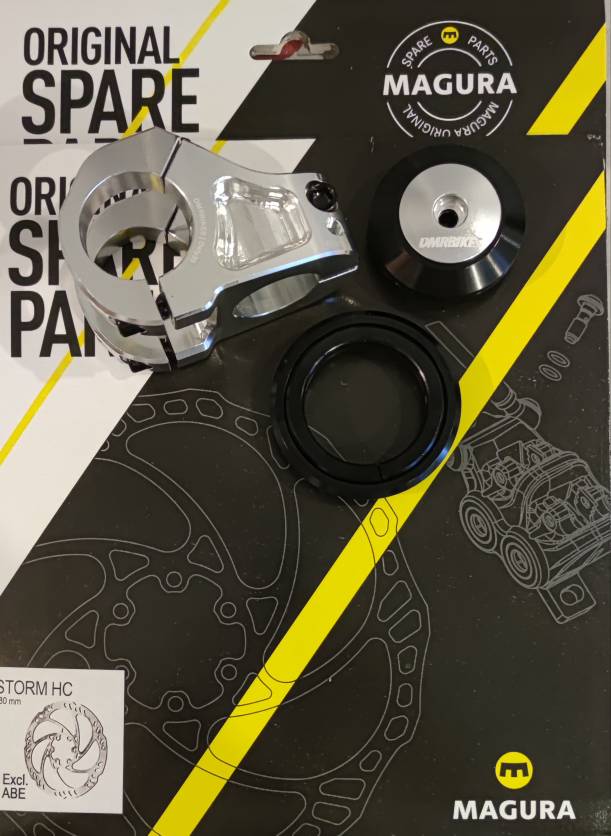

All fitted and bedded in now so will update on a few things:
Rotors - Massive difference and fixes my bite point issues with the magura mt5's. Obviously my previous rotors ( even though new ) rotors are thinner and was giving the lack of bite point i was used to, the Magura rotors are 2mm thick so pushing them pistons back in a bit results in sharper bite point which i prefer.
DMR defy 35 - Beautiful stem and much needed low stack profile for the steerer tube that was cut a tad short. The defy 35 along with new headset ( i will go into that next !! ) has transformed my front end immensely.
Brand X headset - Was running ballbearing so needed to move to sealed bearings and got a deal on the BX headset, So.... bottom bearing fitted fine into existing cup but had issues !
The actual sealed bearing did not slide fully down onto the crown race so pretty much useless and had to hunt the ballbearing out of the bin to service and re-fit .
Onto the top cup.... like everything it was not plain sailing lol, the sealed bearing didn't fit the existing cup so had to go to war getting the cup removed, After some very choice words and heavy handed tactics i got it out and then the rest was bliss. The sealed bearing fitted, compression ring slotted in perfectly with the top cap sitting nice and low for the Defy 35 to slide on sweetly now giving me about 4mm extra clearance so popped a 5mm spacer below the stem to give an extra reach rise.
The way i had modified my headset for the steerer tube length shortage must have been giving a slight drag because now my front end is butterly smooth and such an improvement.
For now im ok with ballbearing bottom and sealed top but will look into it more later.
