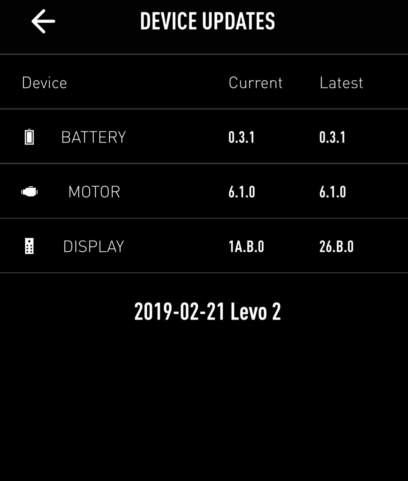

Because model 2019 and 2020 are the same bikes regarding motor, TCU and batteries (and frame).
shacall2
Sep 25, 2019
39
25
California (SoCal)
Thanks - I know they're the same bikes. I just thought this date would have been an actual date the motor (or battery or TCU) were made. Makes it seem like my electronics were made on Feb 2019 (maybe they were?)

@Specialized Rider Care do you have a changelog you could share for version 7.3.6 please?

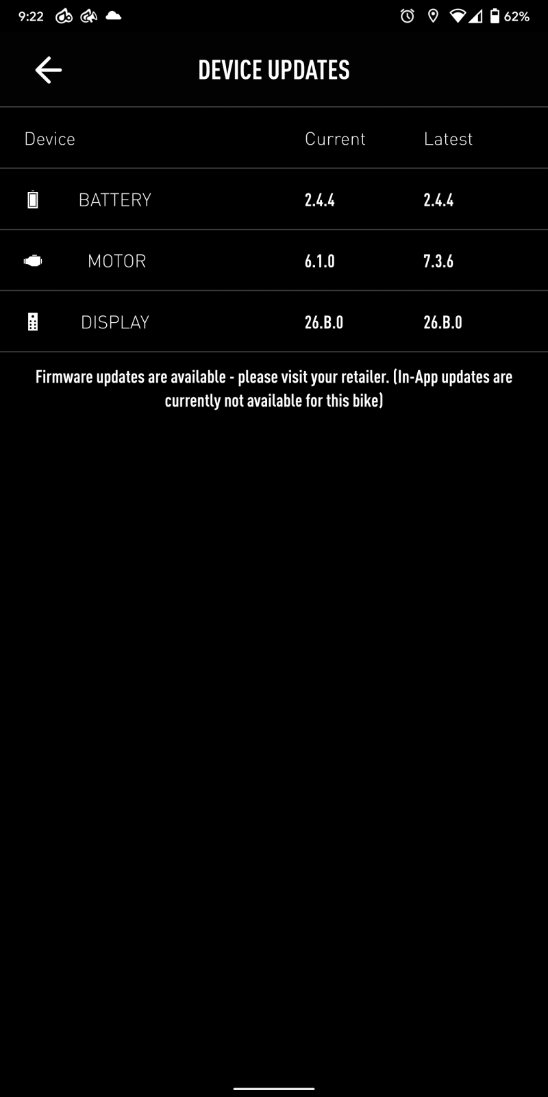

Correct - on the 15th June 2020 we soft-launched functionality within Mission Control for Levo 2019/2020 and Kenevo 2020 owners to update their TCU firmware. This will ensure that riders have the latest TCU performance updates, bluetooth connectivity improvements and error management revisions. Only those bike types will allow updates at this time - and only if motor firmware is at version 6.1.0.
Our aim here is to let riders make incremental updates themselves - however bike build/set-up, battery/motor updates, advanced diagnostics etc remain within the remit of our authorised retail partners.
Creo / Vado / Levo SL bikes do not support over the air (OTA) updates at this time. Earlier Levo/Kenevo without TCU will not ever support OTA updates - sorry about that. We'll keep a watch on this thread - let us know how you get on.

You can only update TCU, for battery & motor you must visit dealer.

Does anyone know what the motor firmware upgrade to 7.3.6 does on a 2019 Turbo Levo?
Dirk74
Jun 6, 2020
99
55
