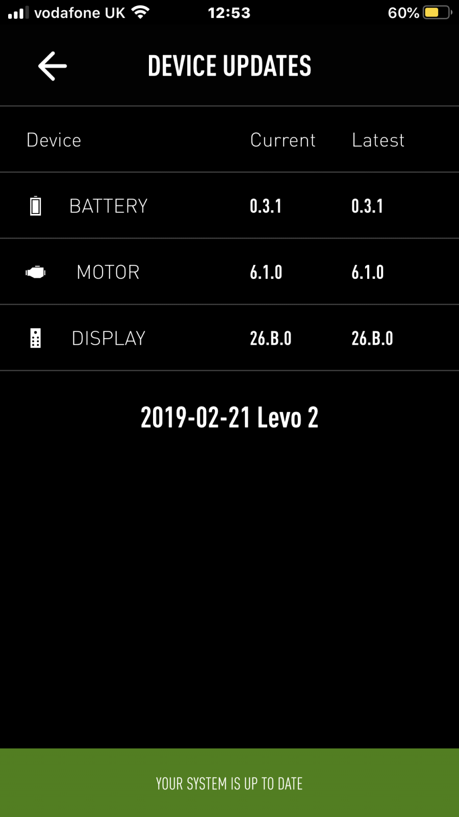

When i look on the update page there are no figures at all in the columns, am i only supposed to see figures if there is an update available?

Log off/on also worked for me on IOS.
I love that I can see that all my firmware is up to date.

Correct - on the 15th June 2020 we soft-launched functionality within Mission Control for Levo 2019/2020 and Kenevo 2020 owners to update their TCU firmware. This will ensure that riders have the latest TCU performance updates, bluetooth connectivity improvements and error management revisions. Only those bike types will allow updates at this time - and only if motor firmware is at version 6.1.0.
Our aim here is to let riders make incremental updates themselves - however bike build/set-up, battery/motor updates, advanced diagnostics etc remain within the remit of our authorised retail partners.
Creo / Vado / Levo SL bikes do not support over the air (OTA) updates at this time. Earlier Levo/Kenevo without TCU will not ever support OTA updates - sorry about that. We'll keep a watch on this thread - let us know how you get on.
I’ve got that motor version but I don’t see the update below advanced diagnostics, any ideas?
