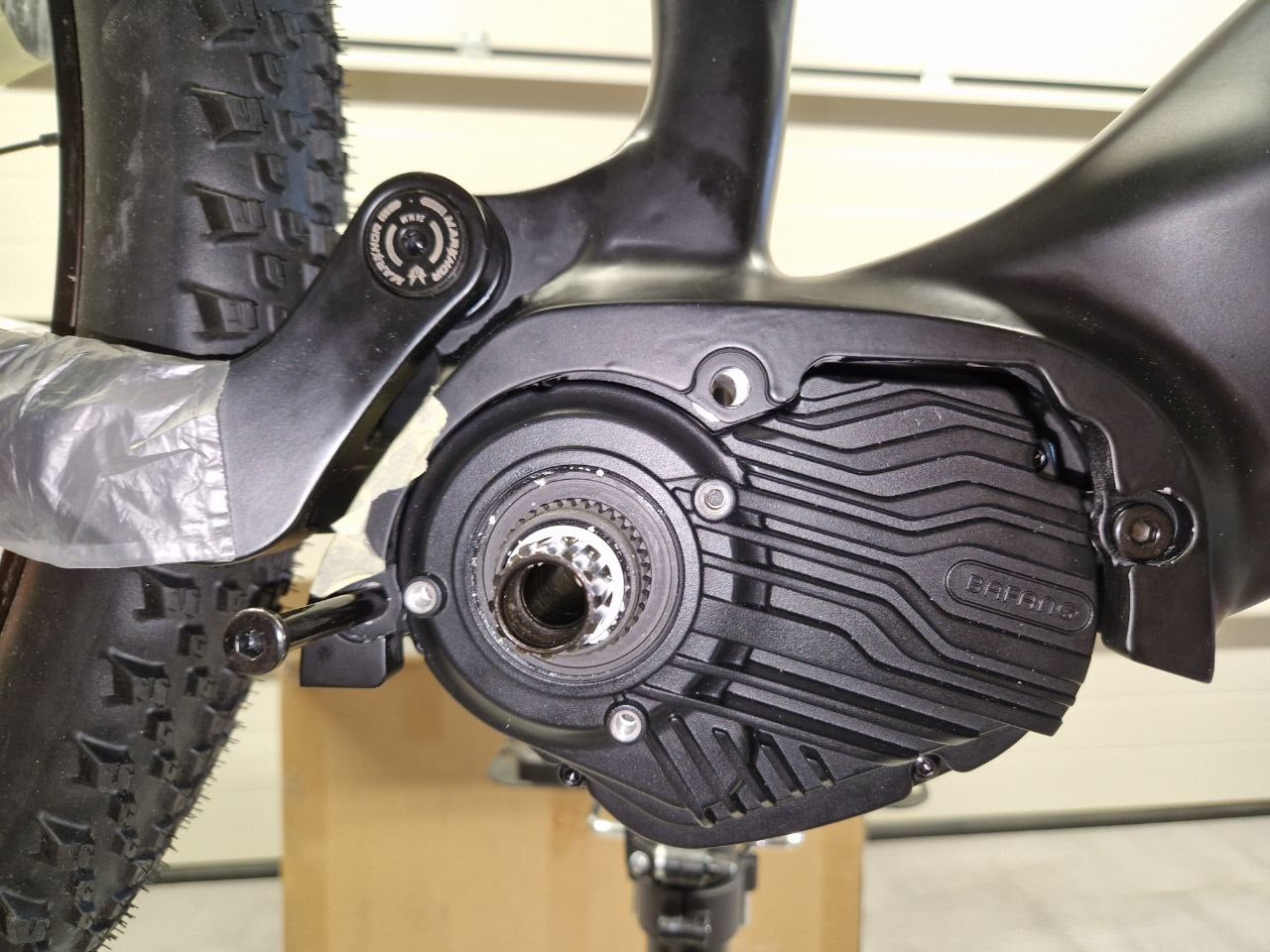

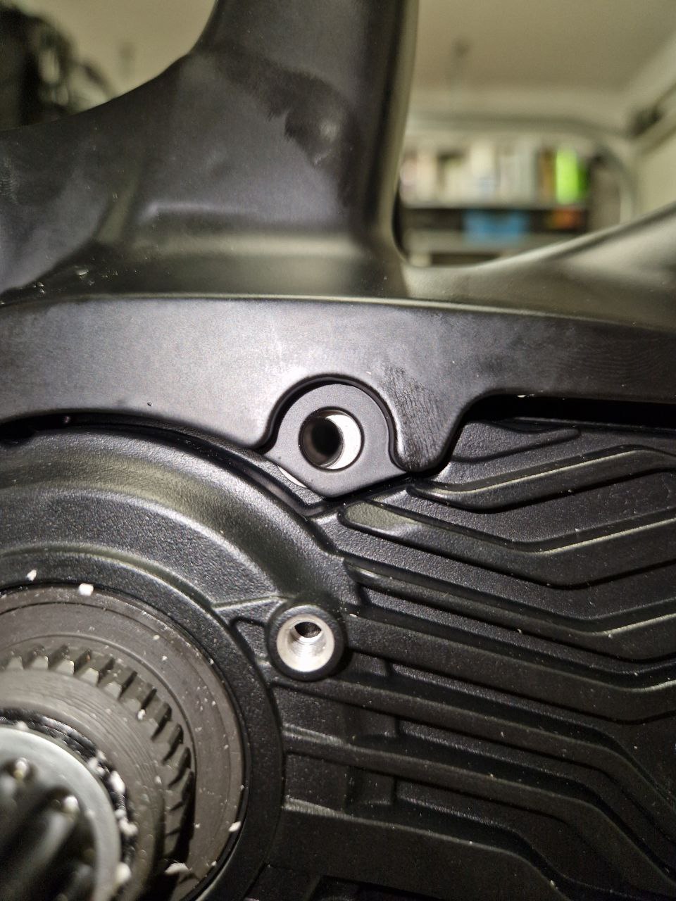

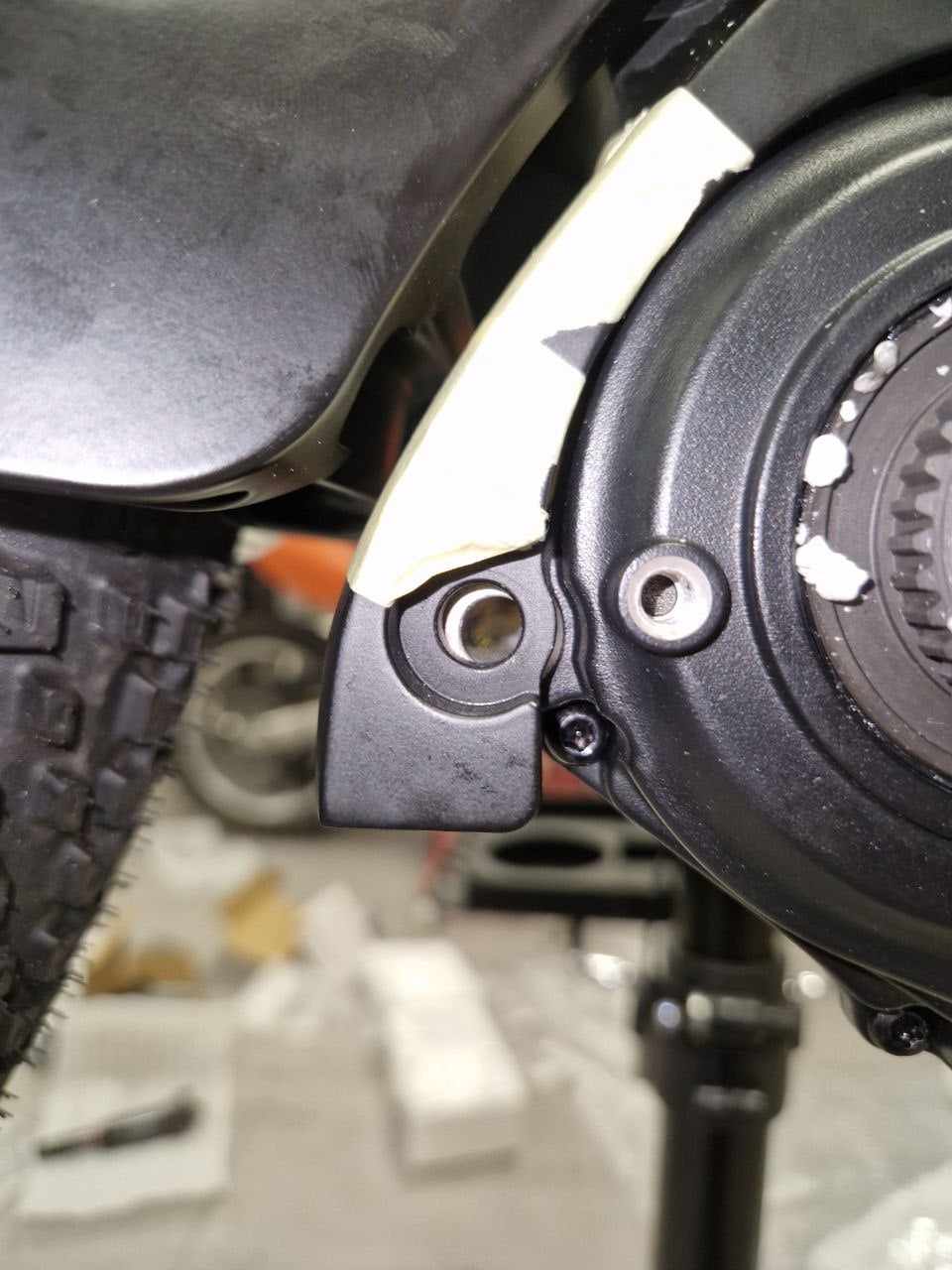

Some pictures of the problem... after inserting the bolt into the front hole, the top center hole and the rear hole do not match the motor mounting points.
There is no option to insert front bolt and rear or middle bolt together.
There is an offset, slight at the rear and about 40% in the middle....
I made a video describing this to the dealer and am waiting for a new front frame. The worst part is that I am about 4-6 weeks longer without a bike because of this situation :/.
It looks like the problem occurred during welding, where the operator didn't install the motor mount properly and the welding pull off the mounting holes.
If it would be a result of mechanical failure, only the rear holes would have been displaced.
So - if you are ordering a frame, ask the seller to check that the motor fits the frame mounts before shipping.
It goes without saying that the two should fit together (if, of course, the frame is dedicated to a specific model of motor), but as this example shows, there may be a problem.

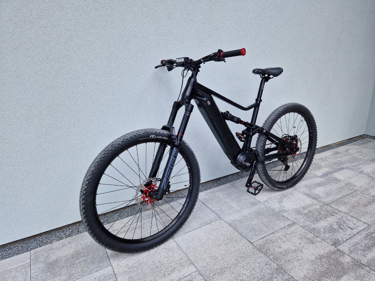

It is time to write a summary.
Thanks to the seller's professional approach to the problem, I received a new front part of the frame, which perfectly fits the motor's mounts.
Therefore, it is very important to buy from reliable sellers, because a mistake can be made by anyone, even the factory.
At this point I would like to thank Chili Shen and Tars of Changzhou Fieldebikes for understanding the problem, providing great service and sending a second frame. As I talked to them, they added checking this frame element to their checklist before shipping.
My bike is finished and I am very happy with it. The quality of the frame (welds, grinding) is really good. Geometry fits me a lot.
