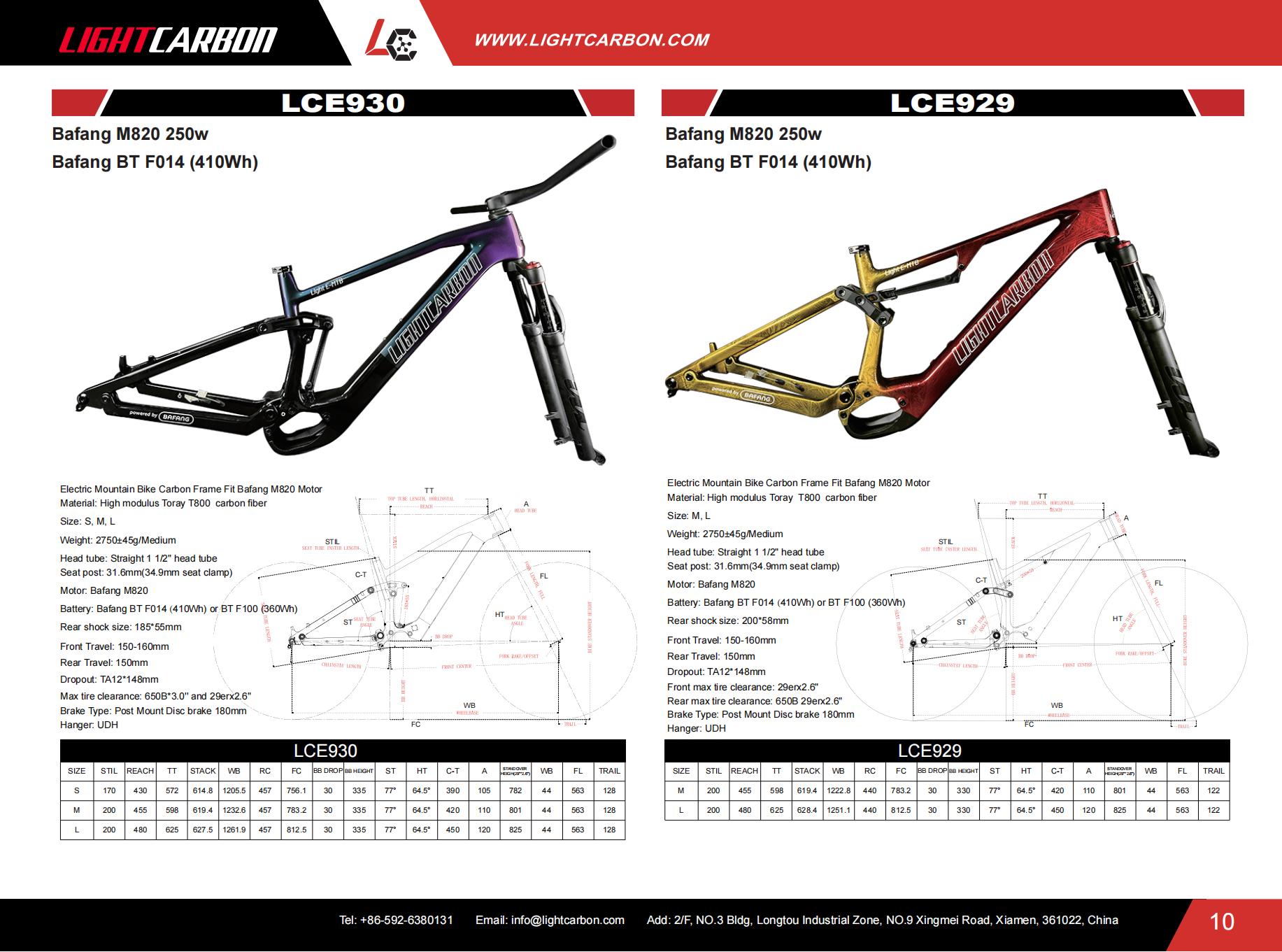

@JimLee-Lightcarbon I also noticed, that PXE930 is listed as 3000g for M, and LCE930 is listed as 2750g for M.
I don't really care about the extra weight. I am just curious why there is a difference.

haha, thank you, PX is our wheel's web, we will change the weight, 2750g is correctly, before the weight is 2980g, and reduced by 330g after optimization.

the frame you asked is LCE929, The sister version o LCE930, with the same rear triangle,Just because of changing the rear shock to a horizontal position, some changes were made to the linkage and carbon layup orientation of the front triangle.

@JimLee-Lightcarbon if the rear triangle is the same on both frames, why is the RC length different?
LCE930 = 457mm, LCE929 = 440mm.

Do you know what is the size of battery compartment of LCE930? I want to DIY battery and would be great to know max dimension of it prior the frame arrives (size M if it makes any difference).

The bafang btf014 has the following size:
470x52x63
I have no idea how much play there is however when the battery is inside the frame
