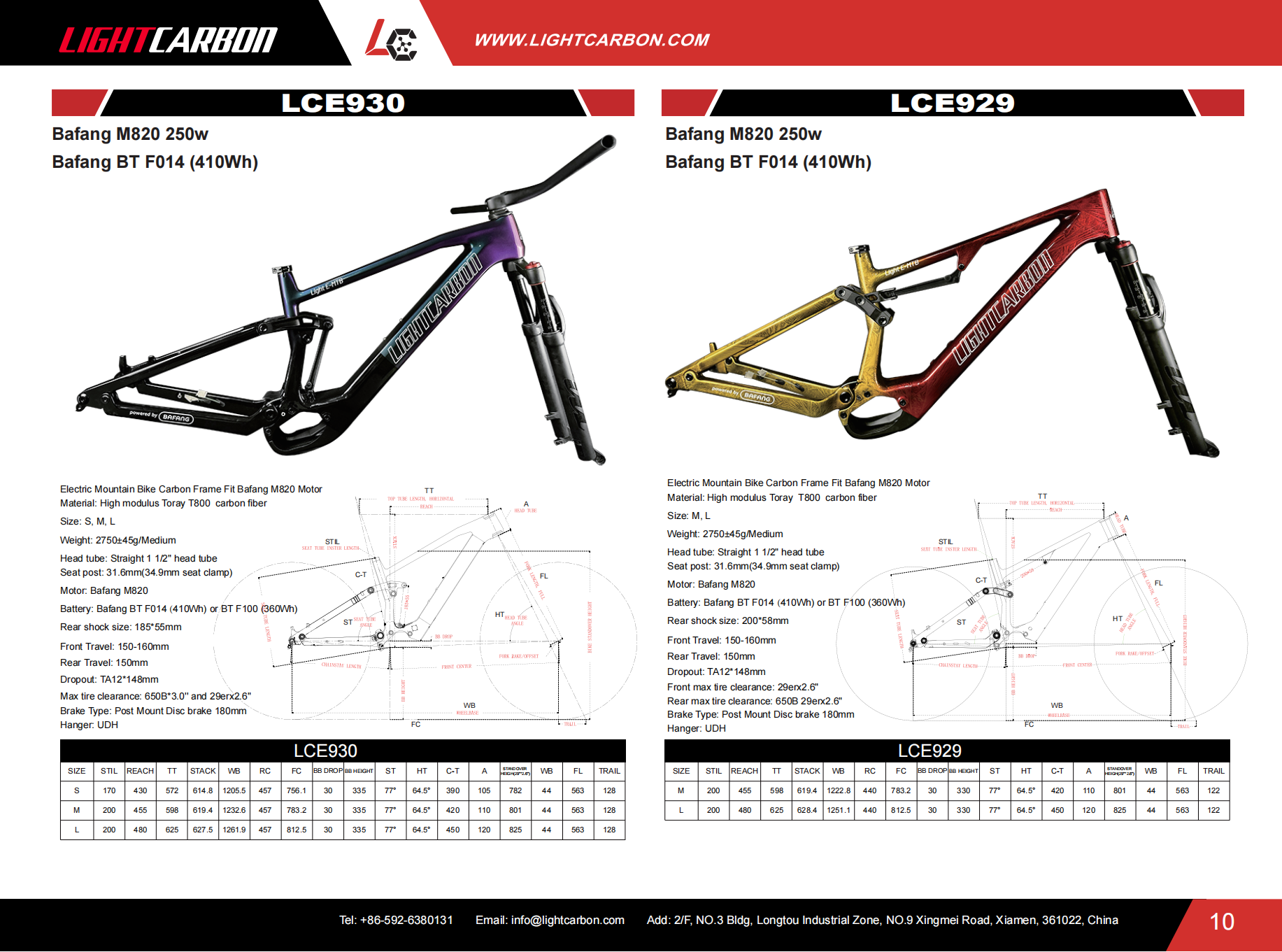

LCE929 is a common mold, which can save development costs, several buyers from different fatories want a frame also fit for M820, so we and others designed it, now only size M passed the test.
LCE930 is our private model of LC, it can be sold only with our permission.
We do not evaluate the commercial behavior of our peers, but product quality and delivery time and service of after-sell will prove everything.

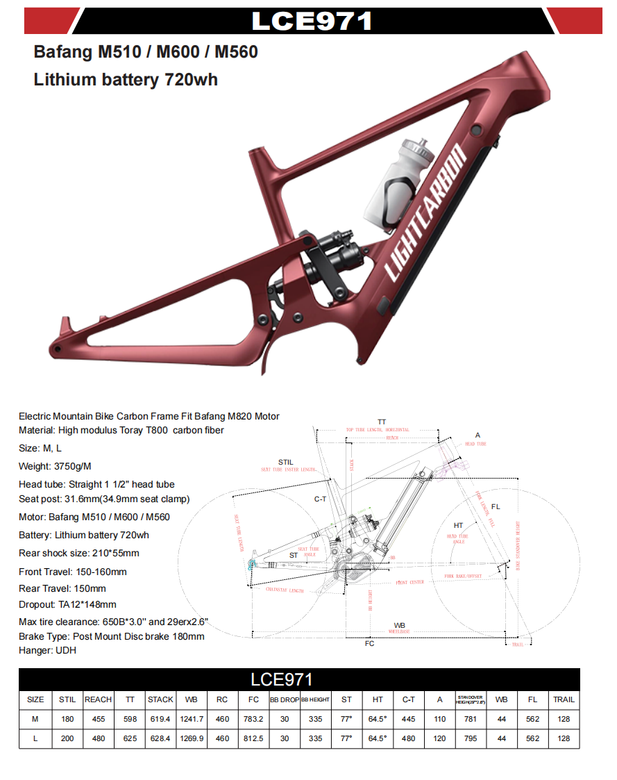

There is already a topic about this frame with some more info. No response from LightCarbon yet.
LightCarbon LCE971, VPP/DW, Bafang M510/M600/M560
LCE971 now only size M passed test and mass production will be later, size L need more than two months,
the rear shock is standard 210*55mm
the battery is not bafang's battery, the box is SYR new youth, now not confirm the battery supplier,
