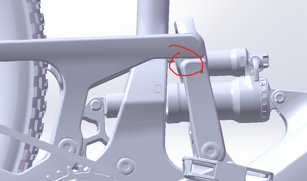

Have you modified the rocker link yourself? Because there are some holes on it to reduce weight. You reinstalled the rocker link in the wrong direction, causing the rear seat fork to not rotate downward to the specified position when the rear wheel hits upward, so the rear seat fork was hit in an undesirable way.

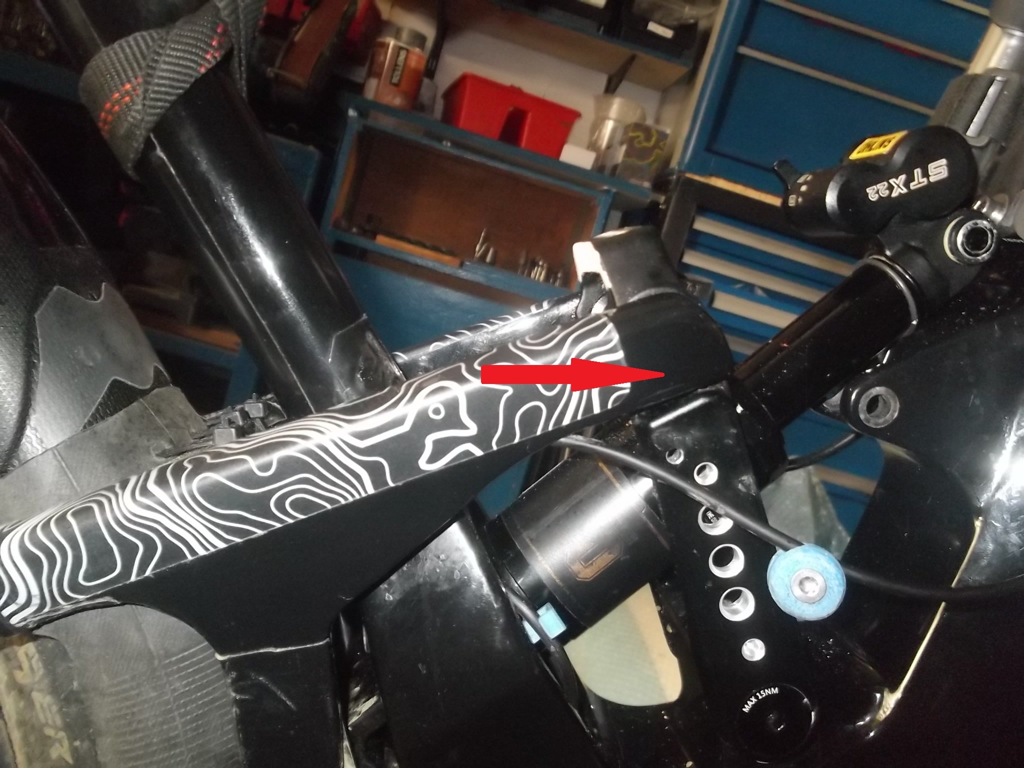

Pics of my swingarm fully compressed, assembled in that's i estimate the best way

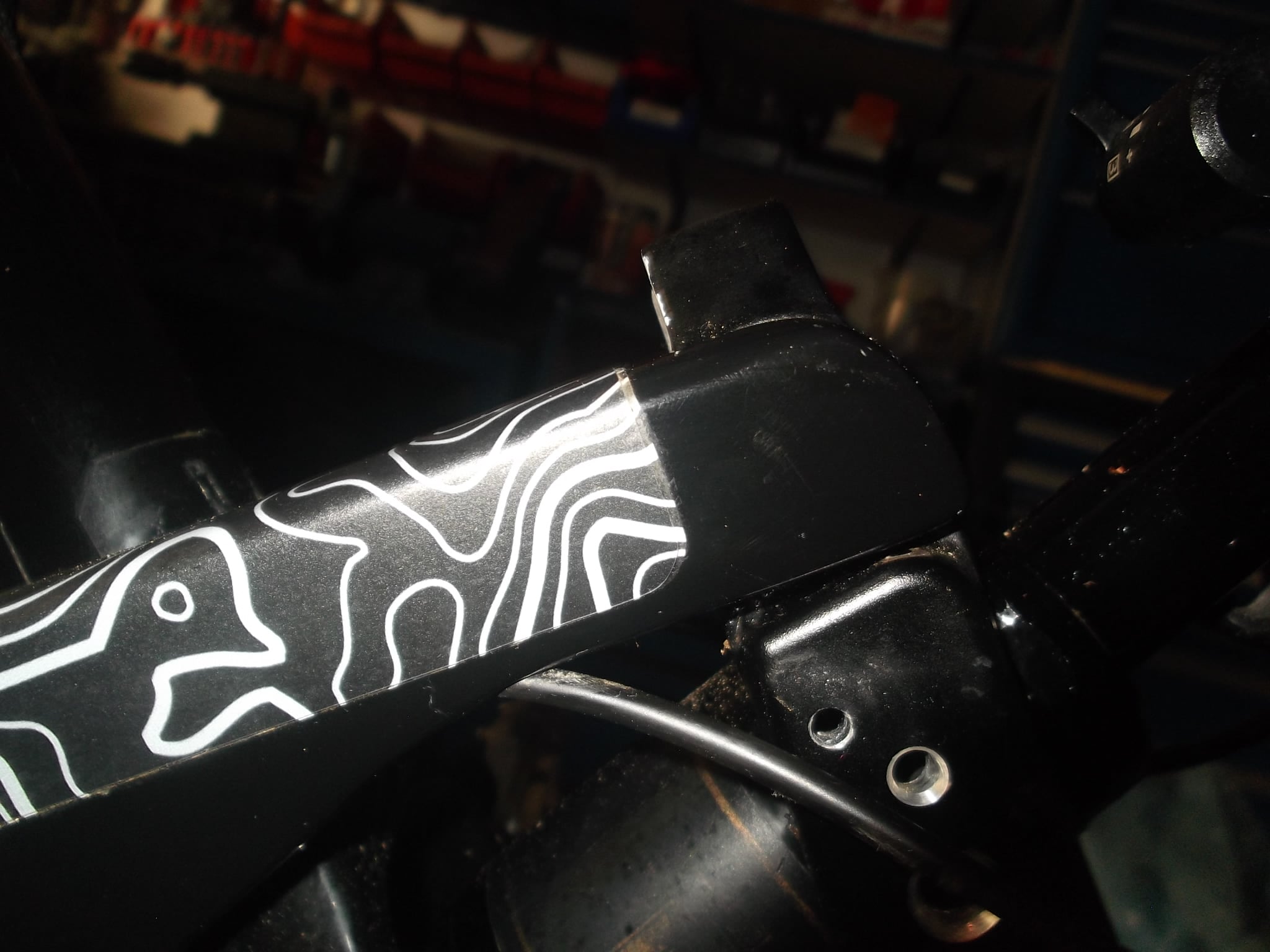

Pics of the swingarm fully compressed and assembled in the right position for lightcarbon

To complete, the last mail of light carbon after i have sent pics to prove that it have nothing additional constraints (and impacts) on swingarm with my assembly.
Please check the correct direction of Rocker link of LCE971.
The design direction of rocker link not only includes whether the rocker link can be touched by the seatstay, but also the stress direction. The design of the frame is a whole. If the cracks appear due to the wrong installation direction, the after-sales department will not agree to replace it for free, and will charge $430 for shipping and material costs.

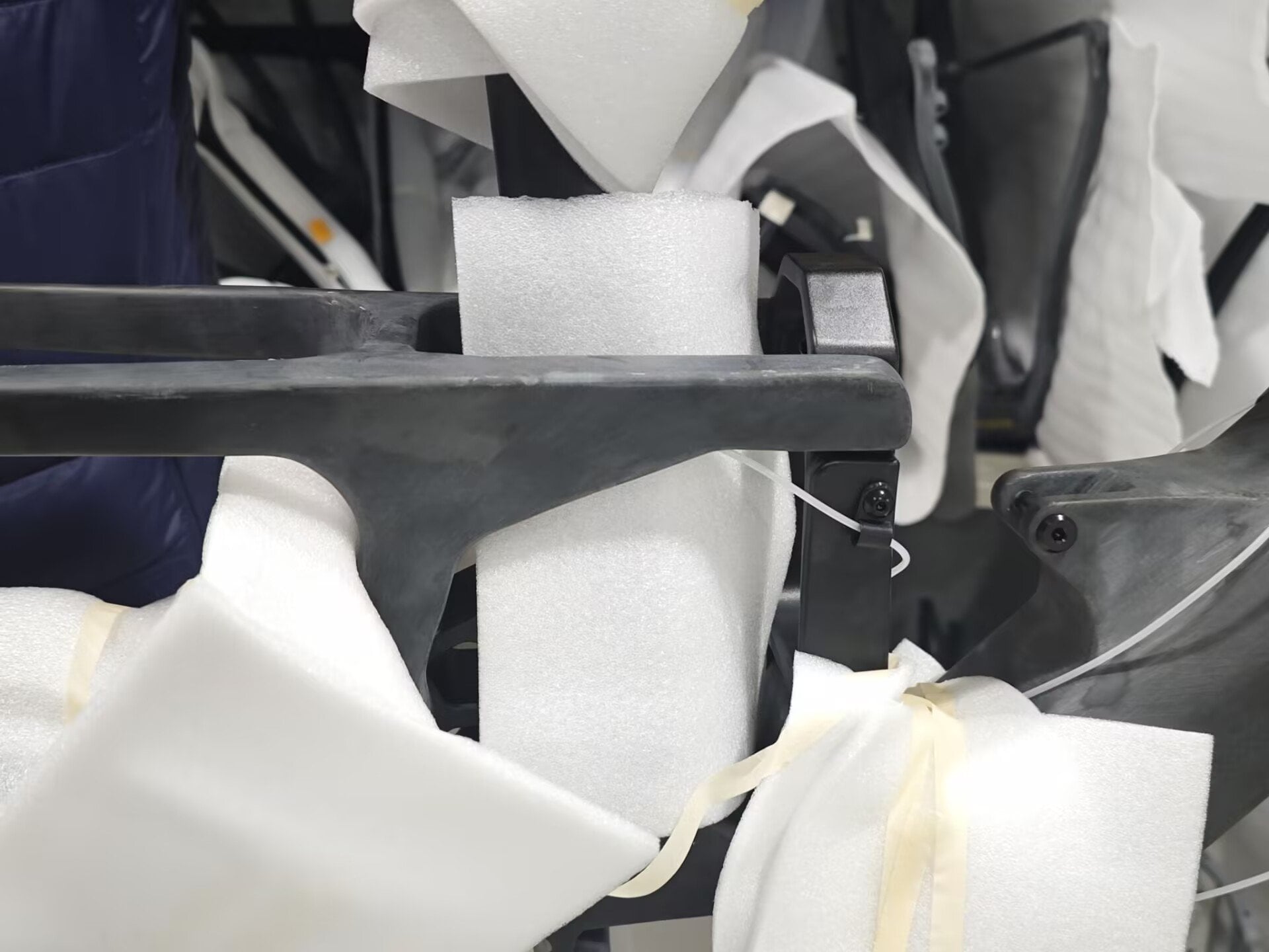

Hi Patrick,
Sorry about the cracks on the frame.
But I'm sorry, the after-sales department rejected the application for free replacement.
As I told you in the email, because you modified the rocker link and drilled holes on it to reduce its weight. Then you installed it in the wrong direction.Incorrect installation direction is the cause of cracks.
When the frame was designed, the auxiliary role of the rocker link in unloading the rear triangle was considered, because the distance it can move in the forward and reverse directions is different. If the direction is installed incorrectly, when the shock absorber is compressed to a certain extent, the rocker link can no longer move, and all the forces brought by the rear wheel will accumulate at the location where the crack appears.
Now the after-sales department requires you to pay then we replace the new rear triangle for you; I can also do my best to give you some discounts, but free is not feasible. I'm sorry.

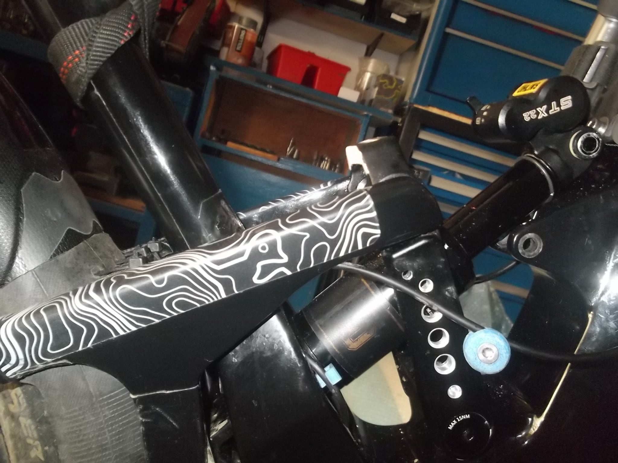

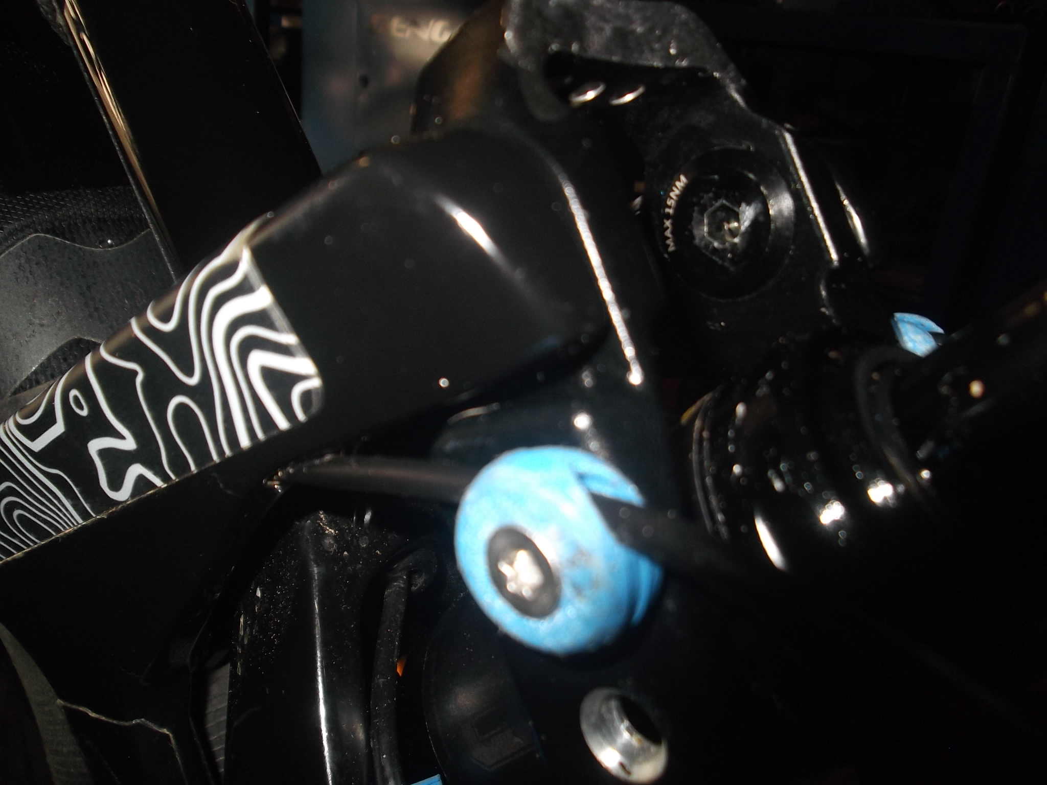

You have another time changed the cause of the breaks, initially rear side contact, after stress direction and now front side contact. Sorry you are another time wrong, no contact who restricted the swingarm travel in any position whit my assembly. I can prove it. do you want i dismantel all to take pics of each parts able to be in contact ? i can also in prevision of your next justification perform metrologie of the bridge to prove that my holes havent't modified any case this dimensions, parallelism and squareness.
As i wouldn't pass more money in this frame, end of storie for me (after share my experiency). I don't know if other heavy rider has make the same mistake than me and purchase this frame or an "nervous youngers" who will jump with it ? but if occur, we will seen another breaks if i true. If not, that would mean you are true and my "modifications" are the alone cause.
another pics fully compressed whith my assembly where we can see nothing contacts
