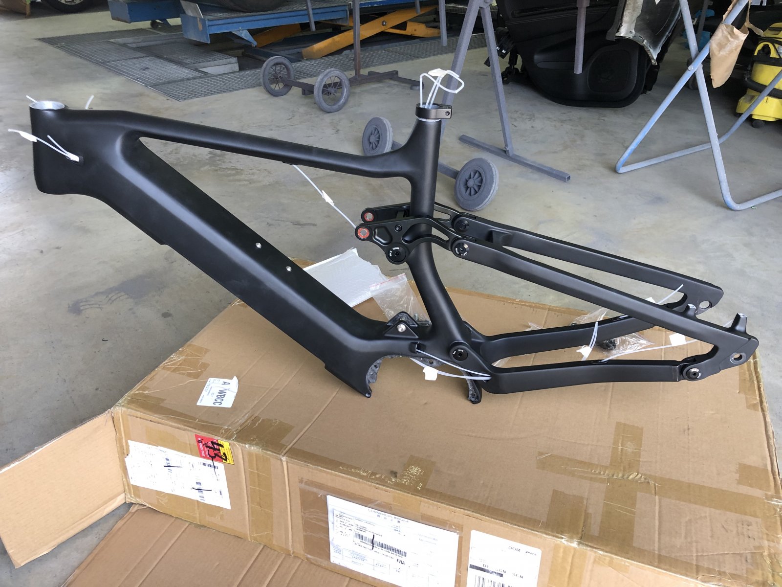

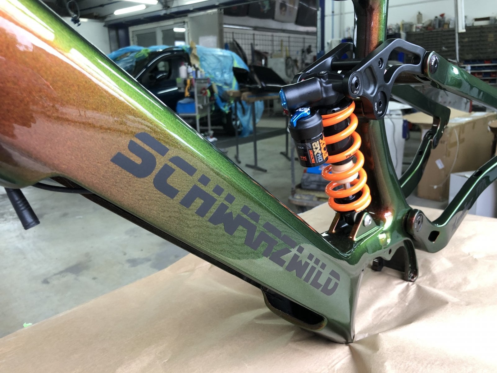

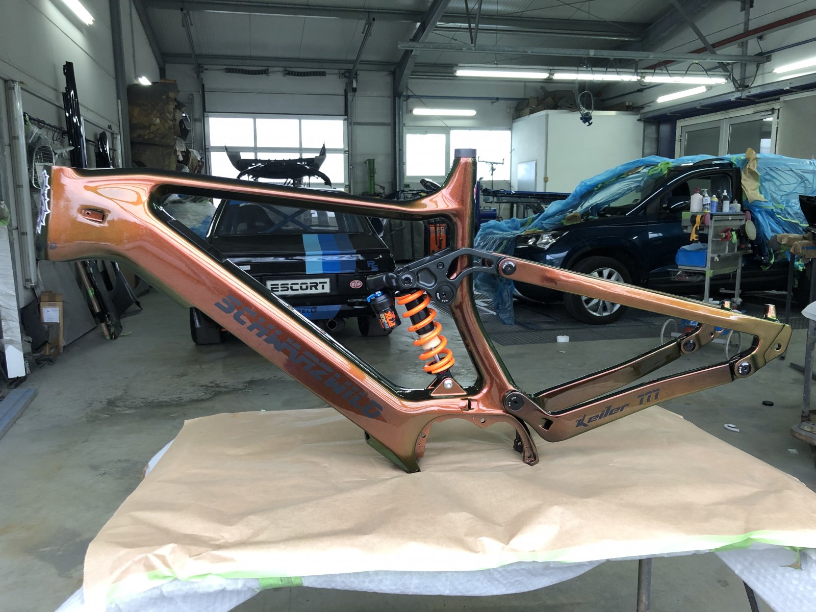

My LCES 004 frame came 3 weeks ago and is very well made. The Trunnion mount for the damper limits the choice a bit, but is very stable

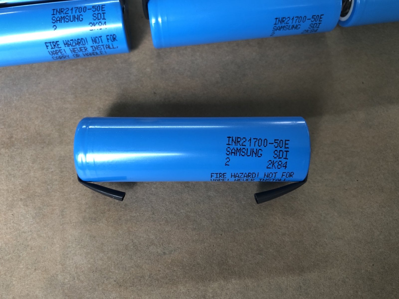

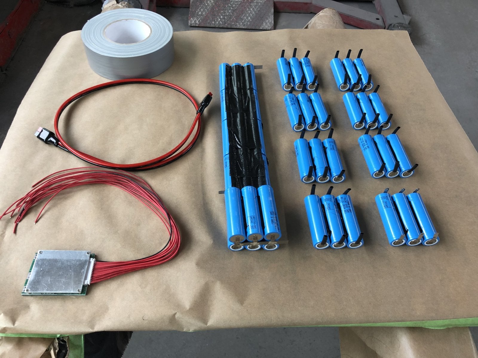

Nice! What are your plans with this bike? Your Dengfu is a beast! Are you going to build your own batteries?

That is really amazing (and way beyond my skills jaja). I’m considering this frame with a m600 motor and a BTF04 battery.
What size is the shock you installed? Are you going for 29/27.5/mullet configuration?
The shock dimensions are 185x55 and I use 29" front and rear because of the 180mm fork. I change the steering angle to 64 degrees

The 3 frames that I have ordered from China so far were all very well made. Depending on the intended use, I would choose a fork with 160 to 170mm of travel

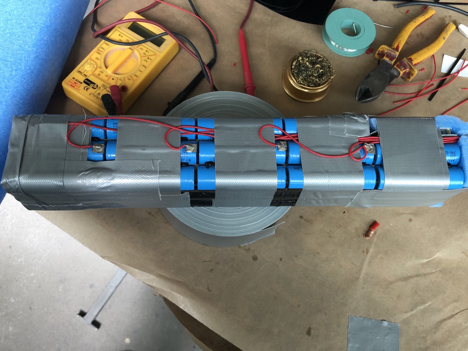

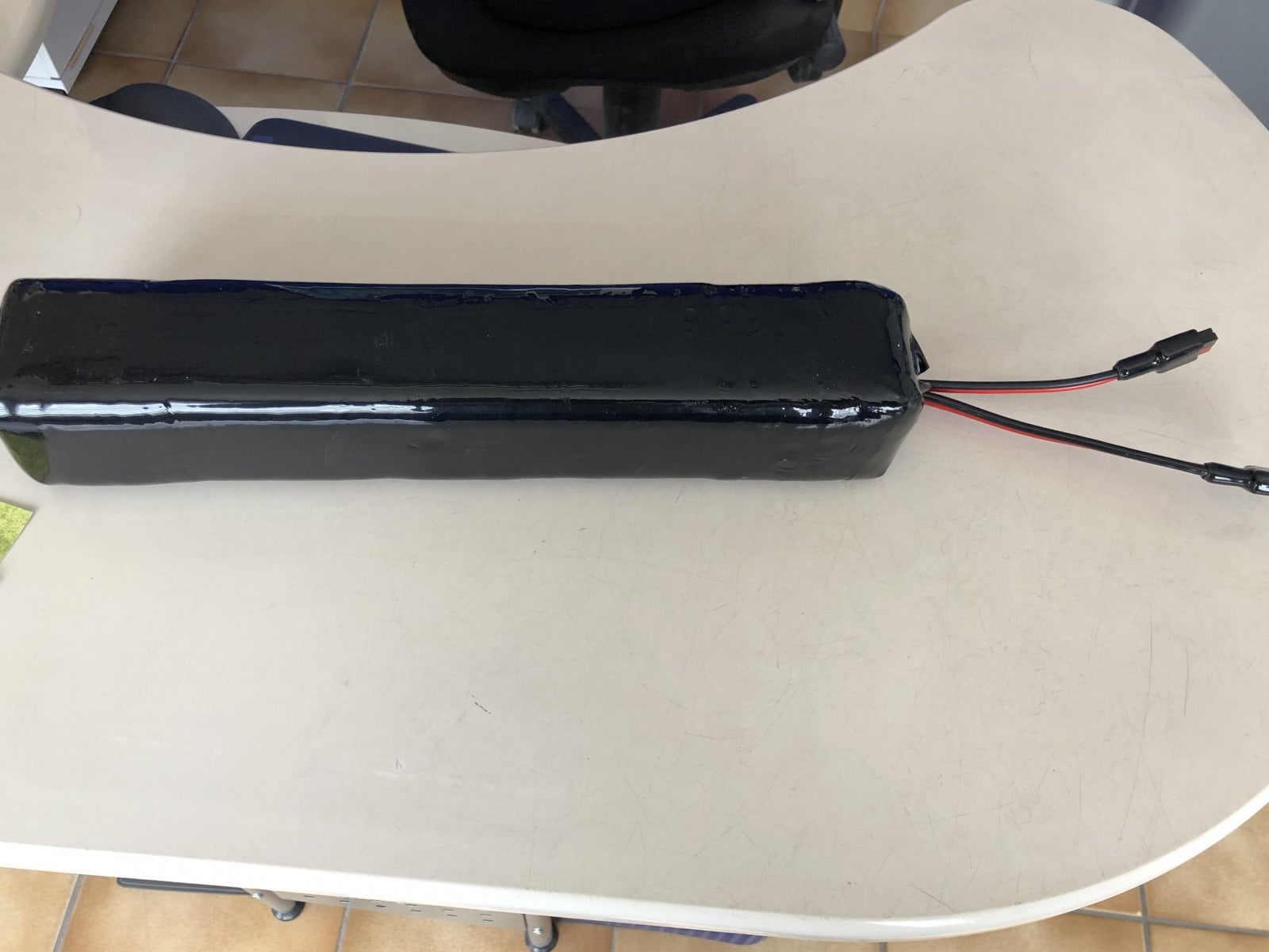

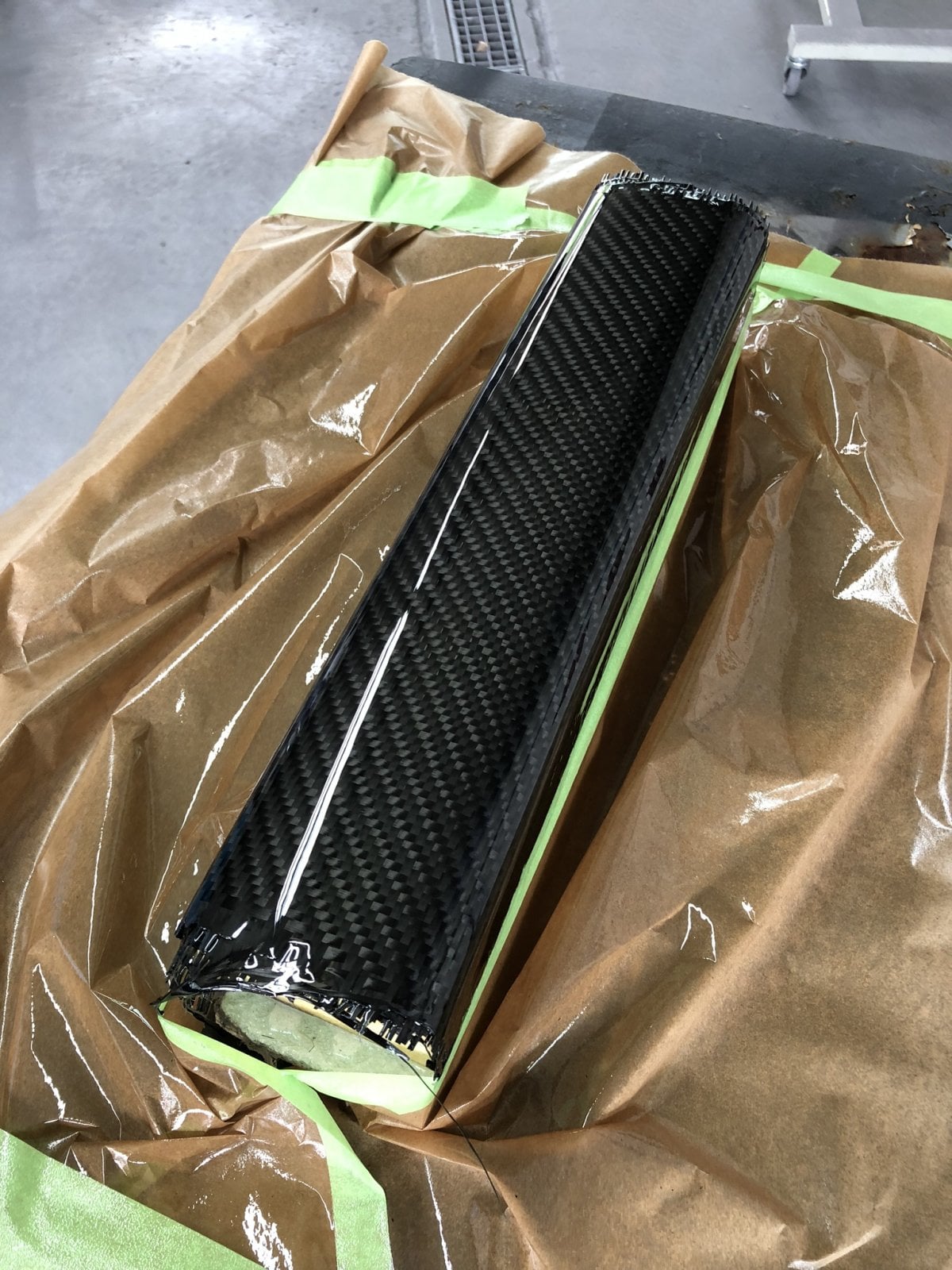

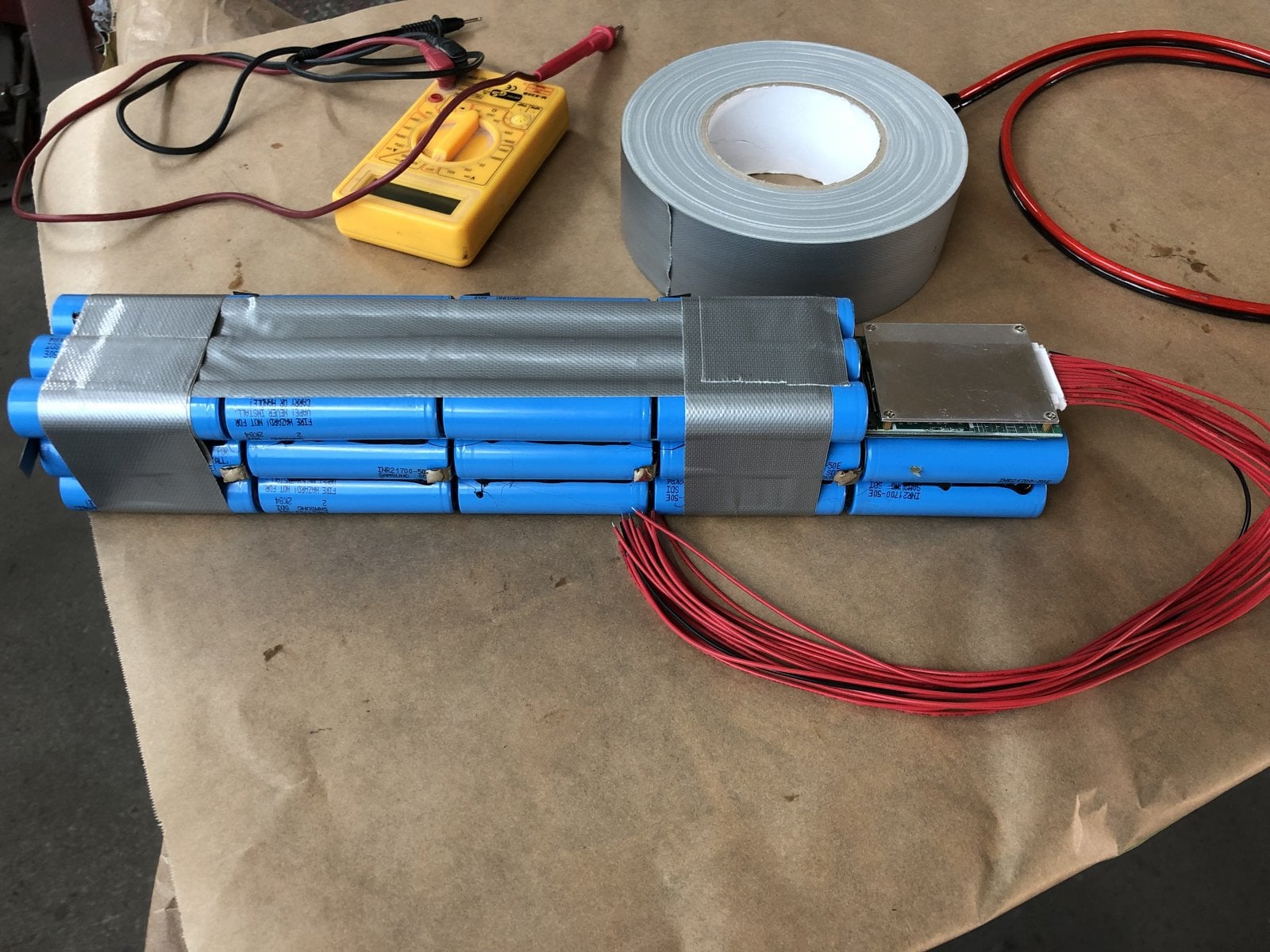

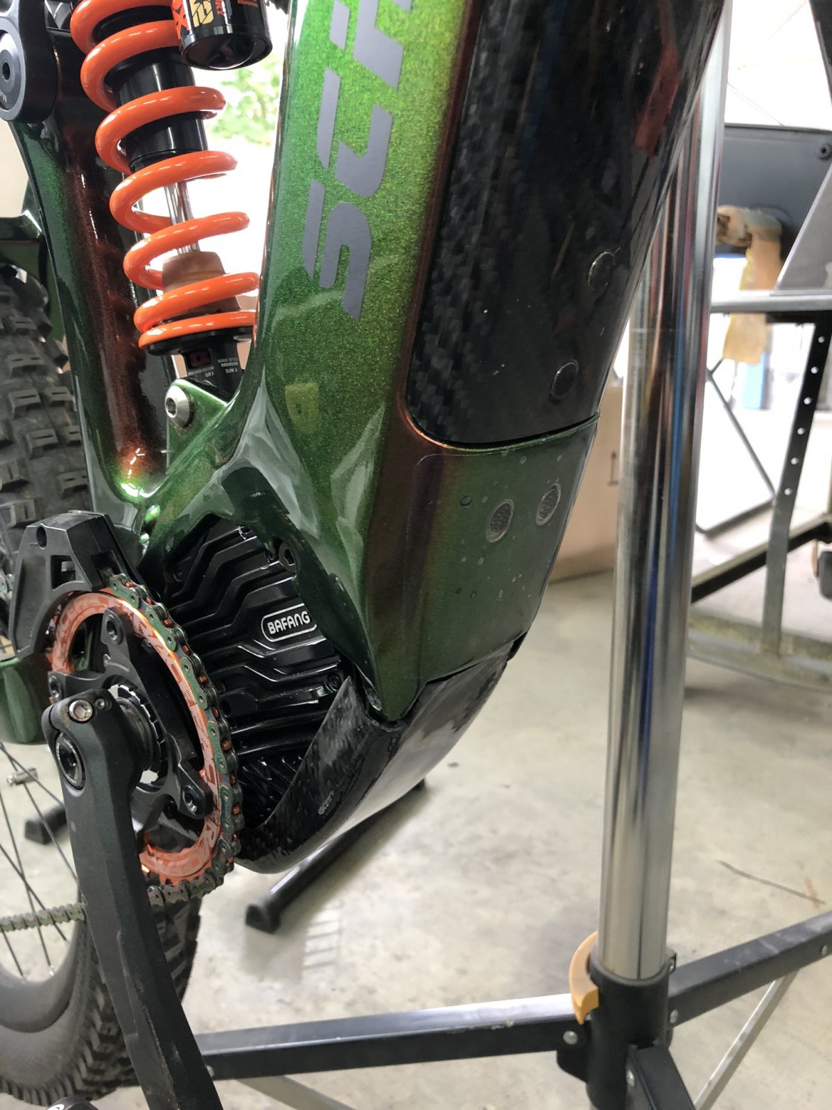

You have to make a stable battery cover with which the battery is clamped. Put a little foam in between so that nothing rattles. 42 of 21700 cells fit into the frame.

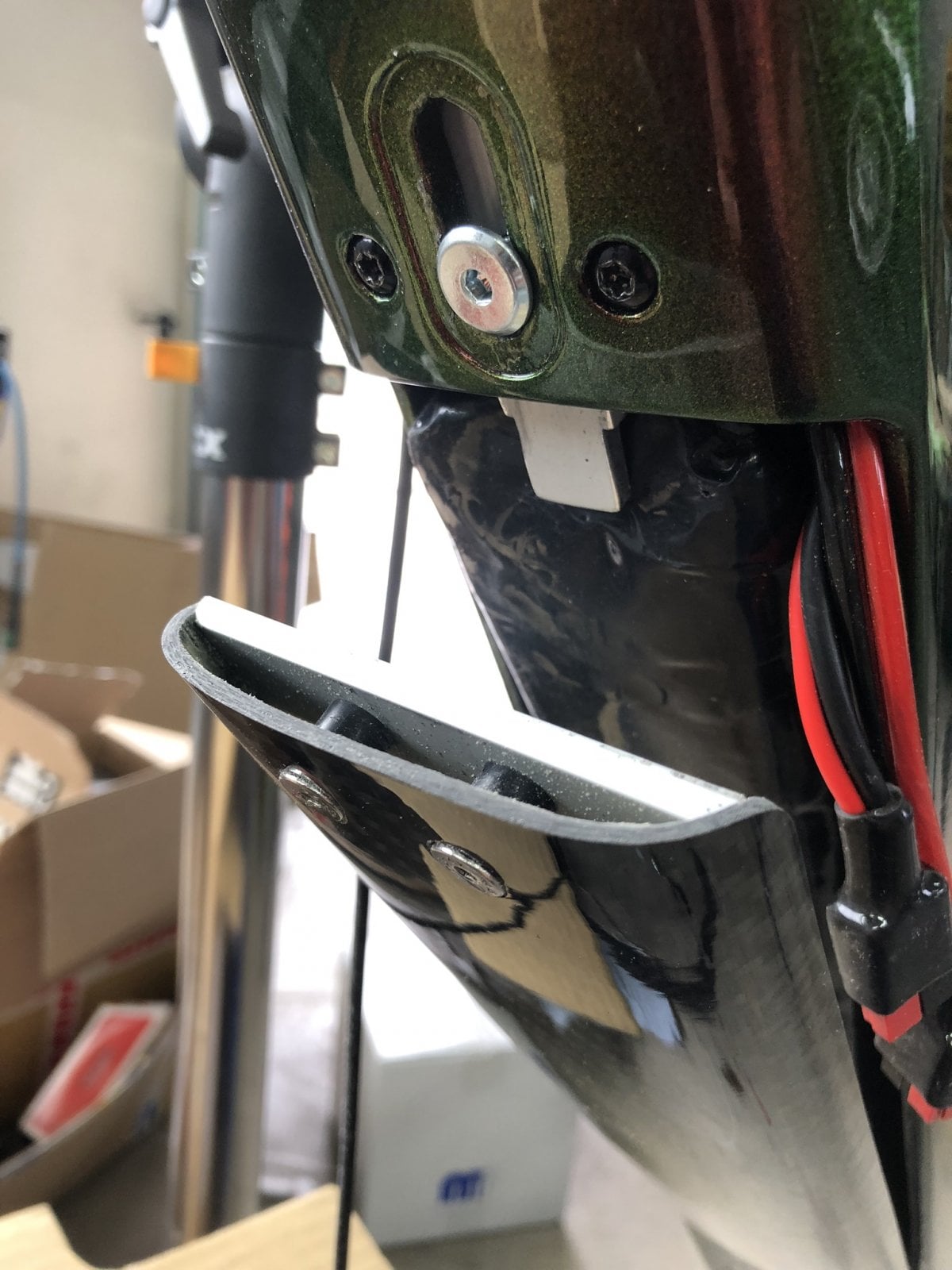

Cables and the brake line still run past to the right and left of the threaded sleeves. I glued a thin foam rubber plate on top of this, the battery lies flat on it.
View attachment 73648 View attachment 73647 View attachment 73646 View attachment 73649
Thanks for posting your experience with the light carbon 004. I also have the LC 004 and am almost done with my build. I do have to build the battery cover yet. I was just wondering if you would share more information about the hardware you used. Specifically the frame hardware at the top and where you got it/ what is it called.
