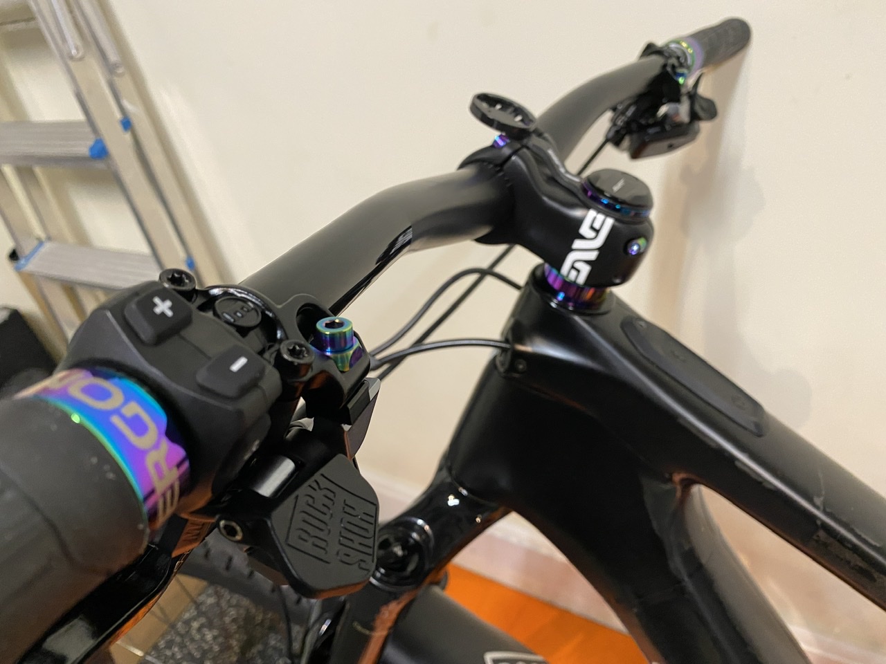

You will never be done with this kind of project :cool:

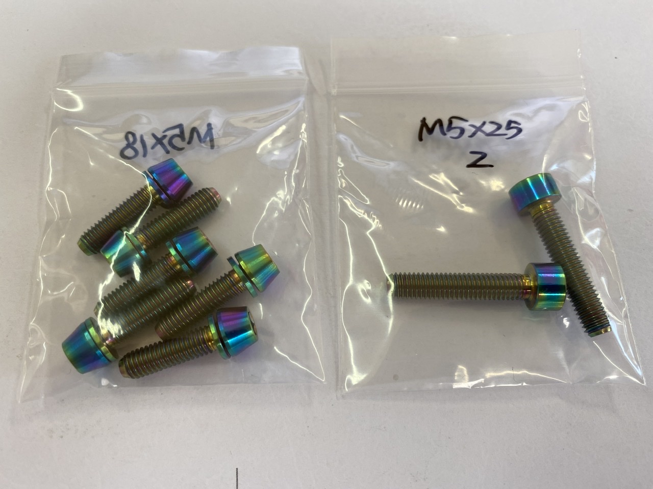

These arrived remarkably quick... wonder what other screws I can swap ?

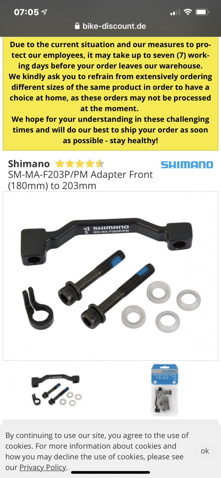

I can tell you 1000 million % that This is the wrong Post adaptor for 180 post mount forks .. the adaptor that’s in this post is for 160mm to 203mm post adaptor As this is the one I had to buy for my partners 160mm forks to 203 rotor .what ever you do do not buy this adaptor if your forks are standard 180mm . I know this as I fitted the correct adaptor . To my Lyrik forks that needed 23mm 180 to 203 . Pic below is the correct adaptor as you only need 23mm not 43mm

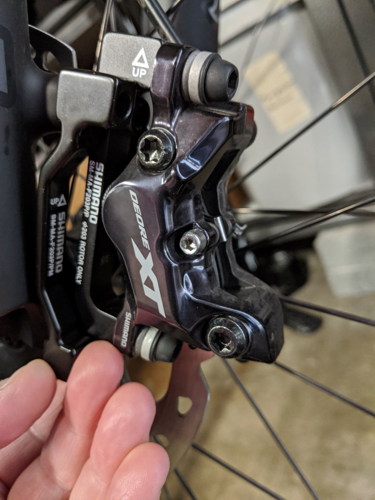

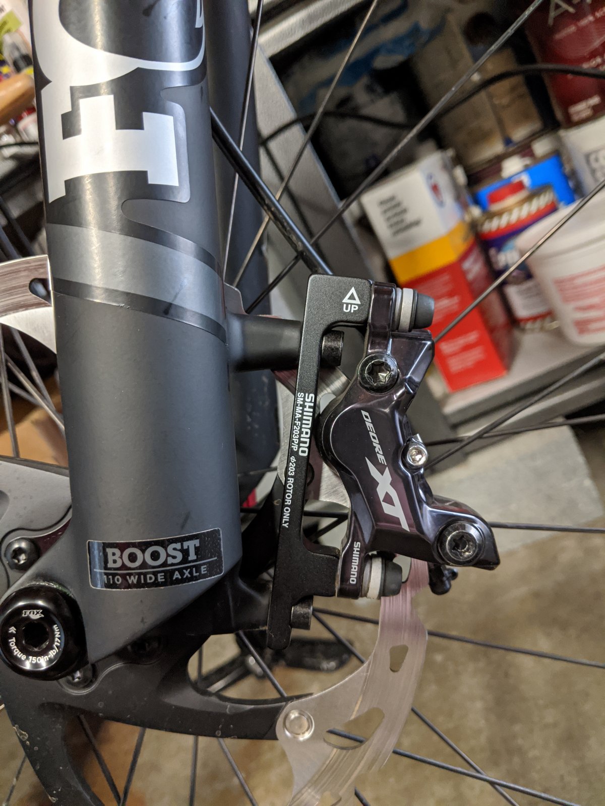

Killswitch...The F203P/P adapter below is the CORRECT one for mounting a Shimano 203mm rotor using Shimano brake calipers to the stock Fox fork on comp carbon SL. See photo below:
I tried the F203P/PM and it does NOT work. I bought and tried both adapters. As shown below the F203P/PM doesn't even come close to positioning the Shimano caliper in the proper place for the pads to contact the 203mm rotor.
If you notice the bottom spacer pad on the P/PM adapter would need to be much thicker to allow the caliper to be in the correct position. It will not work on the Fox fork that comes on the Levo SL Comp Carbon.
Ahhh so the post mounts on the Fox forks are 160mm then ? and not 180mm ..
when you took the sram brake caliper off was there a 180mm adaptor on it to accomidate the 200mm sram rotor ?
Only works for SRAM rotor as they are 200mm and not 203mm. I tried it but the Shimano brake pads do not make contact with the entire Shimano rotor surface.
Ay i know bud .. i got XTR on my stumpy using the lyrik RC2 and i bought the 20mm adaptor and the 203mm rotor was rubbing .. so had to buy the 203 adaptor which i put a link up for .. atleast i got it now so when i put my Lyrik ultimates on my carbon comp and new XTR 4pots ive not got to worry .. i do need to purchase the adaptor you have though as im still using the 2pot xtr on my stumpy as will the fox forks on that and use as my spare bike ..i will be switching wheels around on both bikes so it uses the same roteor .
at least your post was good in letting knw i still got to buy that 43mm adaptor .

@p3eps don’t think I’ve seen a weight yet for the carbon wheels. Will you get chance for that at some point?
I was just going with 1800g as per Specialized website.
I think it’ll be a while until I have the tyres off / sealant out / rotors off / cassette off etc to be able to give an accurate weight.
I could probably give you a wheel / rotor / cassette / tyre combined weight fairly soon as I have lovely iridescent bolts for the brake rotors on the way!
