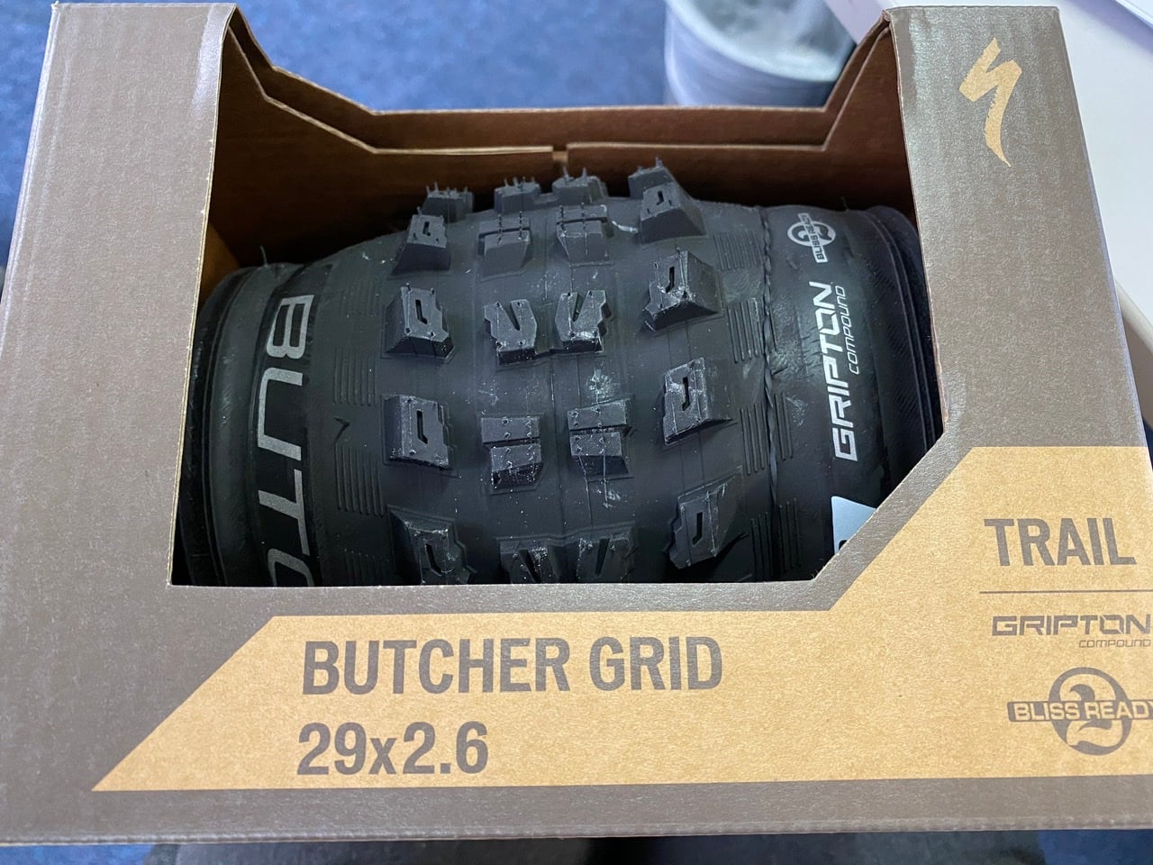

New tyre is here - so I can get it fitted and the tube out tonight.
30mm inner diameter on my rim, makes it 2.5.
This is a 2.6 tyre, but doesn’t look like there is any rim size that makes it 2.6?!
I run that on my '19 Levo rear (they're stock) with a Minion on the front.
When weighted and lower pressure you'll probably get 2.6, FWIW.

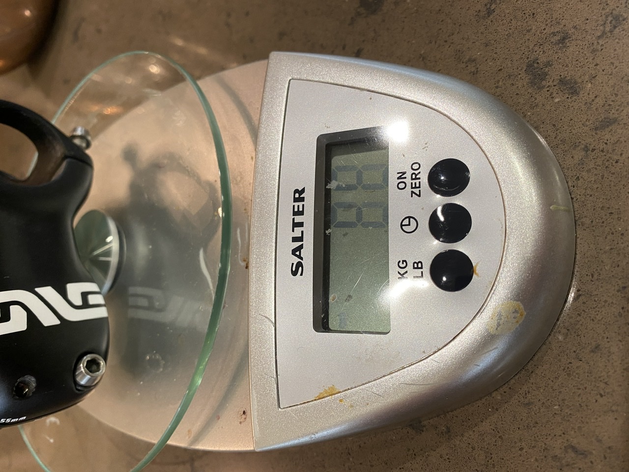

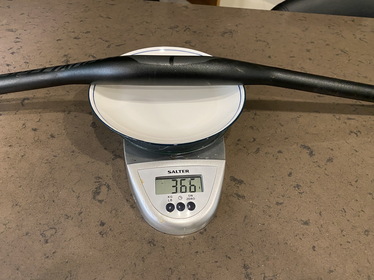

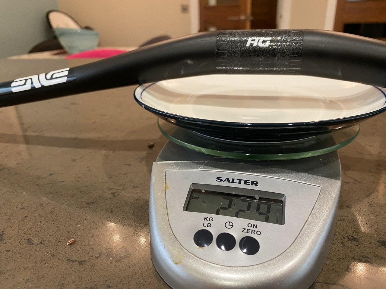

A few more grams knocked off by fitting my carbon ENVE bars and stem...
Spesh stock aluminium bars = 366g
ENVE DH carbon bars = 229g
Saving = 137g

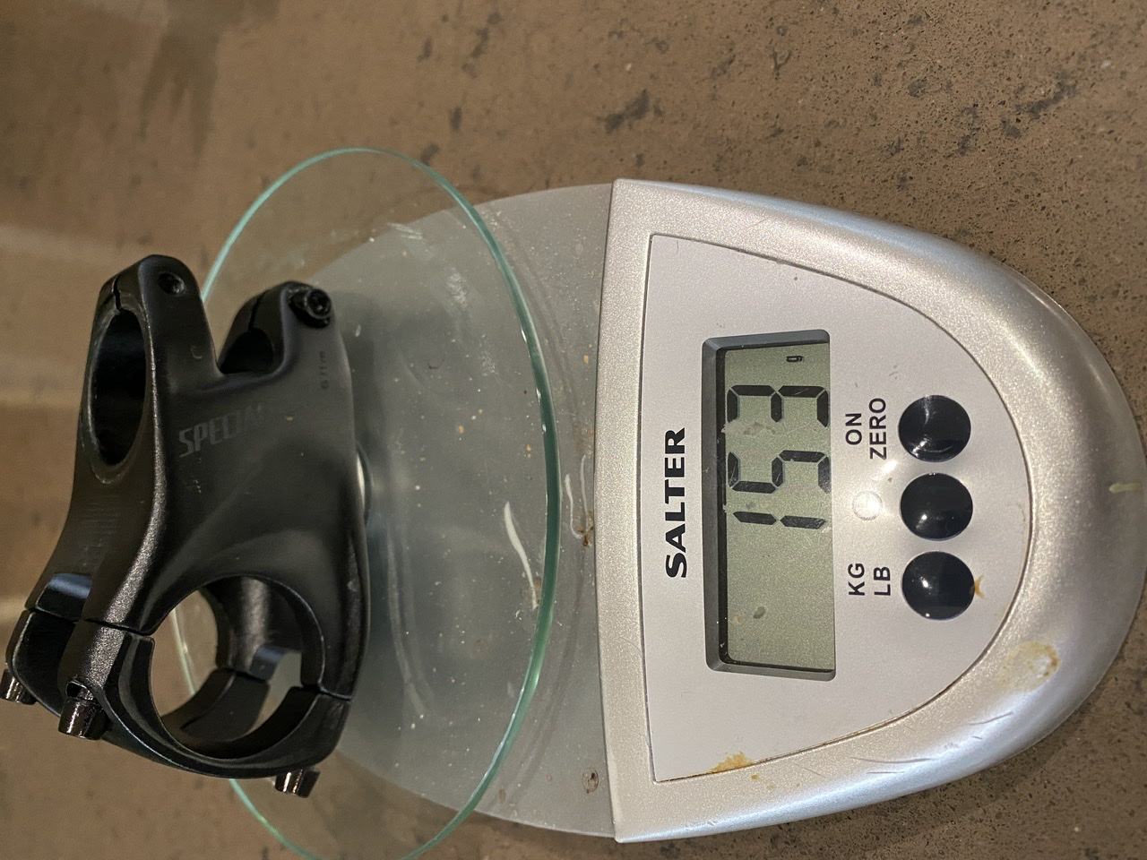

Spesh stock aluminium stem = 153g
ENVE carbon stem = 88g
Saving = 65g
Overall saving = 202g

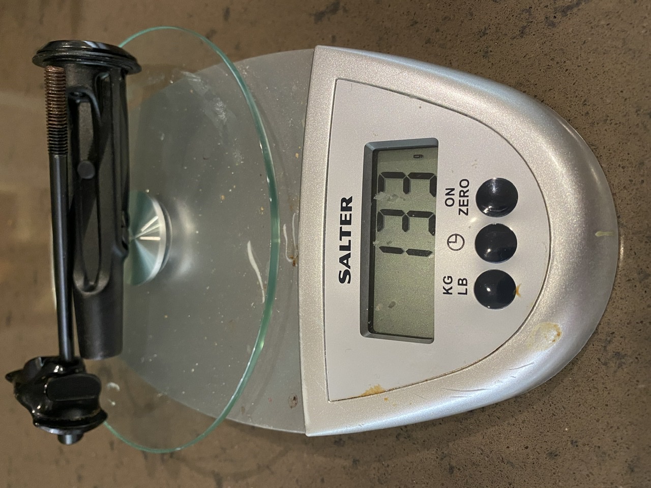

Whilst I had all this apart, I weighed the mechanism / multi tool that’s stored in the headset.
133g - that could easily be replaced with a lightweight top cap if you were desperate to save 100g+ for little cost.

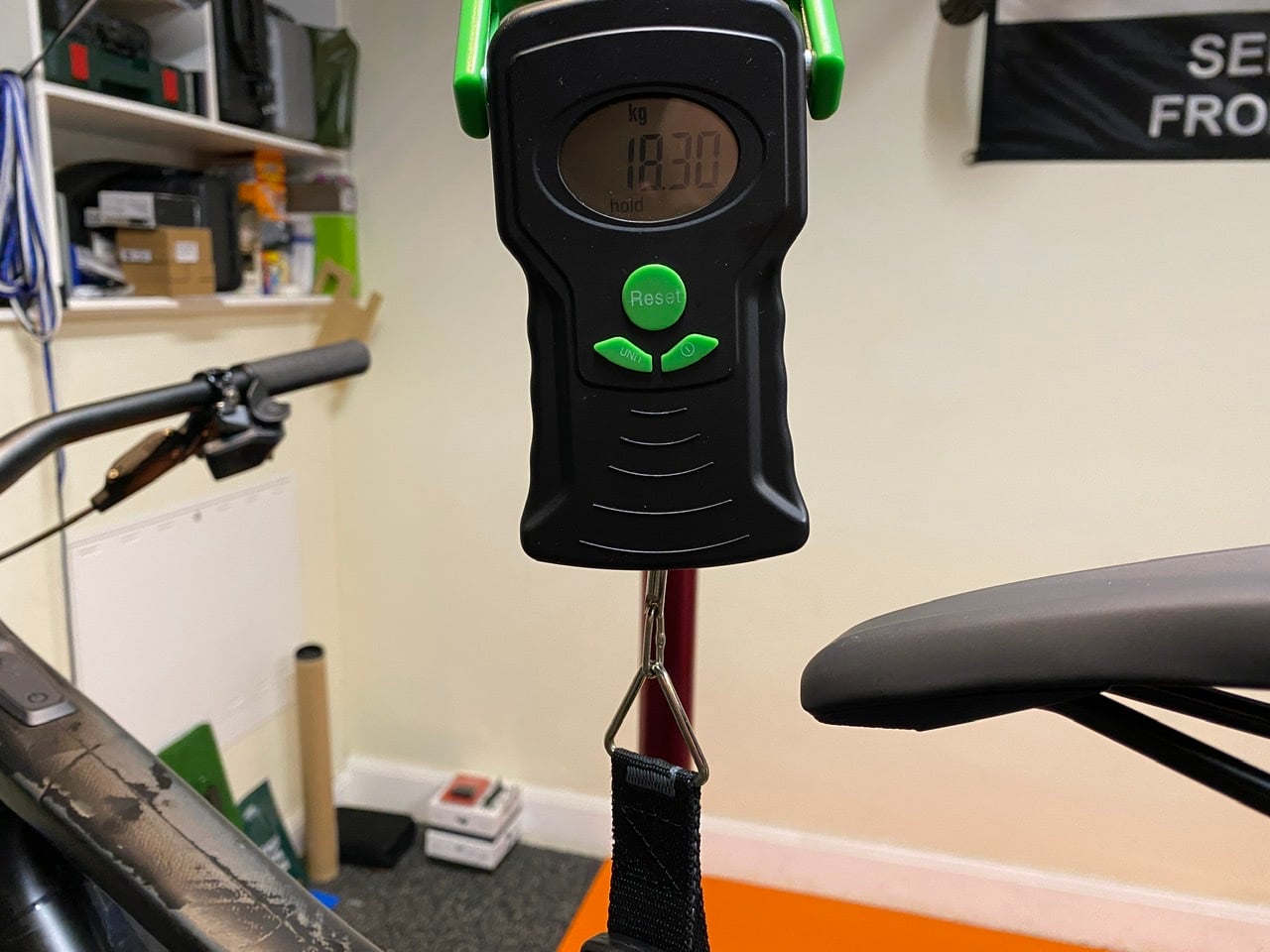

Away to take my own one out for its first run. It’s actually snowing just now... but hey ho! When you live in Scotland, you’ve got to embrace the weather!!
So far...
Invisiframe kit fitted
Derailleur / shifter swapped to AXS XX1
Rear tyre tubeless
DMR Vault mg pedals
Front Mudhugger
Carbon Garmin mount
Shockwiz fitted to rear shock
Weight: (XL SL Expert)
18.30kg or 40.34lb
Still to swap my bars / stem over, fit new front tyre and make it tubeless. Also swap dropper for AXS Reverb.
Should tip the scale at less than 18kg... which is a little over 4.5kg less than my Rail 9.9 was.
May be other mods along the way, but that’ll be my starting point.
Now... away to get this thing an extra few KG’s in mud ?

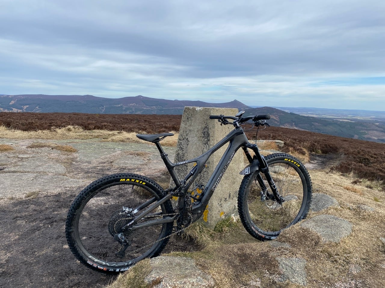

High Rock Ruti
Nice picture of the scale......don't tease us show the bike "resting on stuff" please baby please baby, baby baby please (Spike Lee She's gotta have it)
p3eps
Dec 14, 2019
1,987
2,410

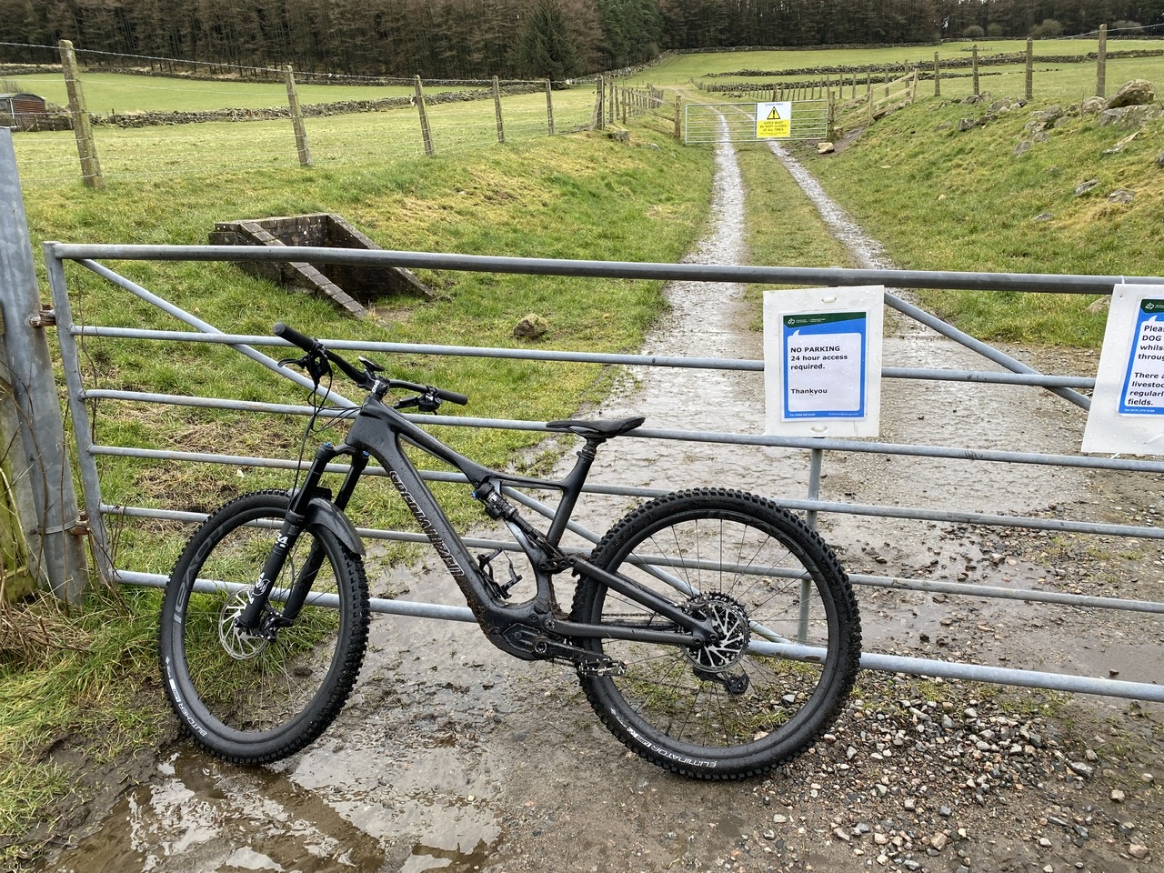

High Rock Ruti
Here’s a couple from this morning.
This is where ~4kg makes a huge difference, as lifting it over these 2 gates would’ve been a different story with a 22.5kg bike!!

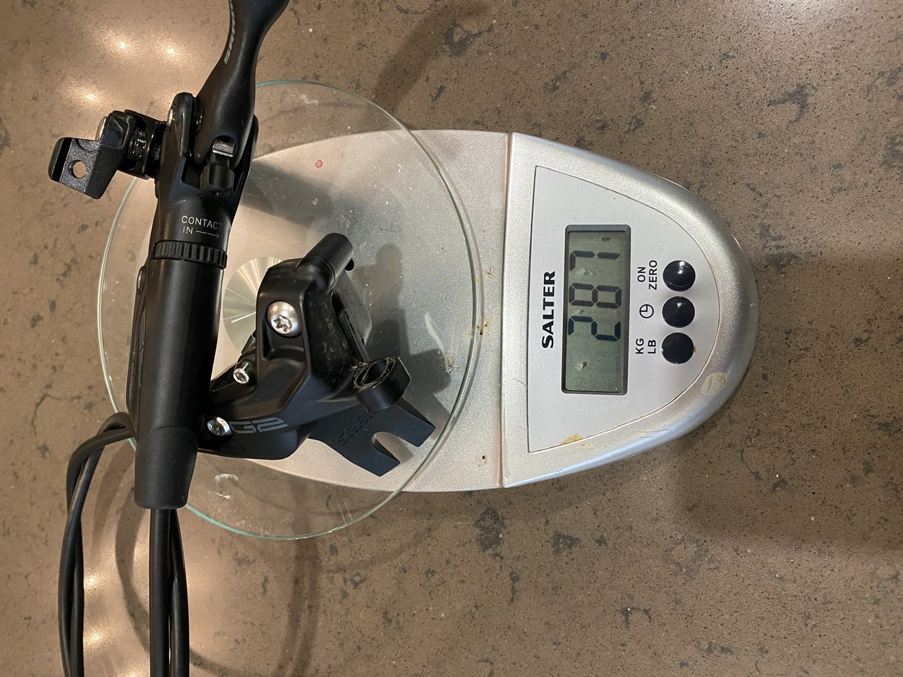

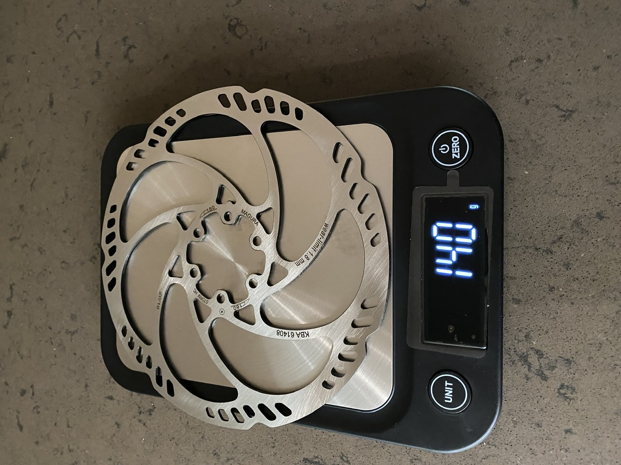

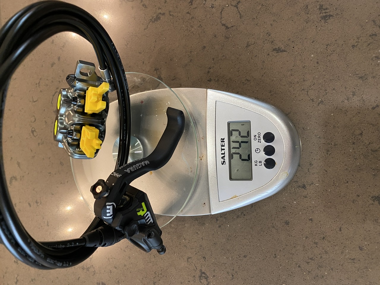

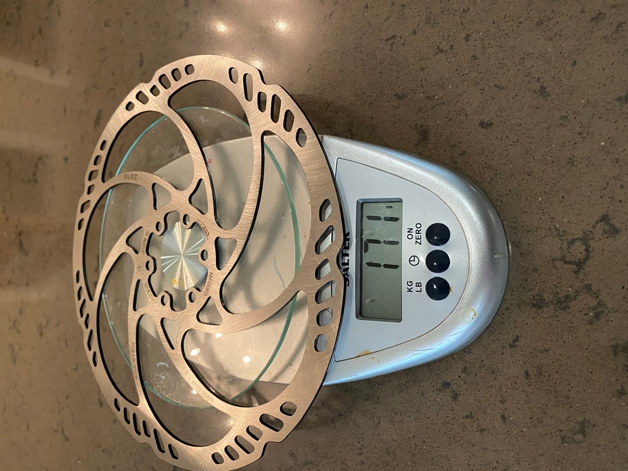

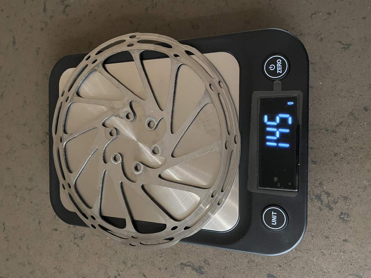

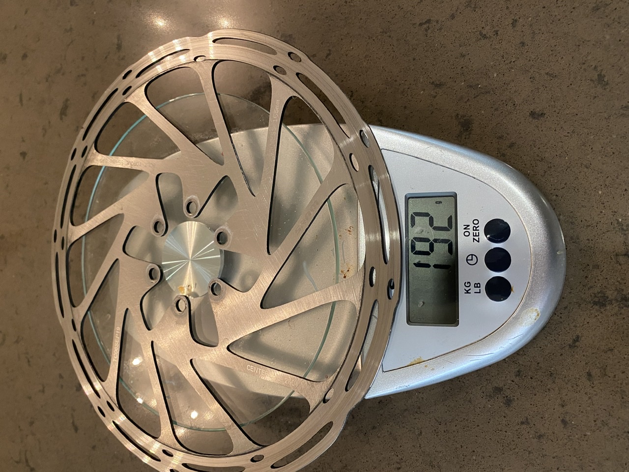

Some more weighing...
Once again - I am building this bike to be how I want it, regardless of weight! Just interesting to see the differences.
Original SRAM G2 RSC - lever, hose (shortened front) and calliper. 287g
Magura MT7 with full length hose and calliper. 242g
SRAM 203mm front rotor. 192g
Magura 203mm front rotor. 171g
SRAM 180mm rear rotor. 145g
Magura 180 rear rotor. 140g
As you can see... I got some new scales ??

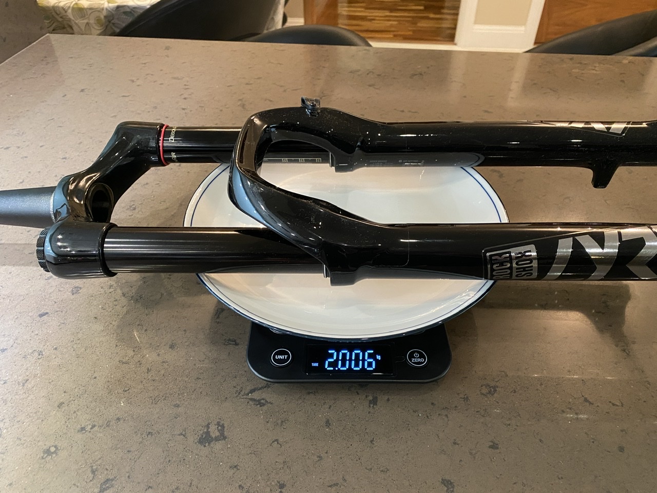

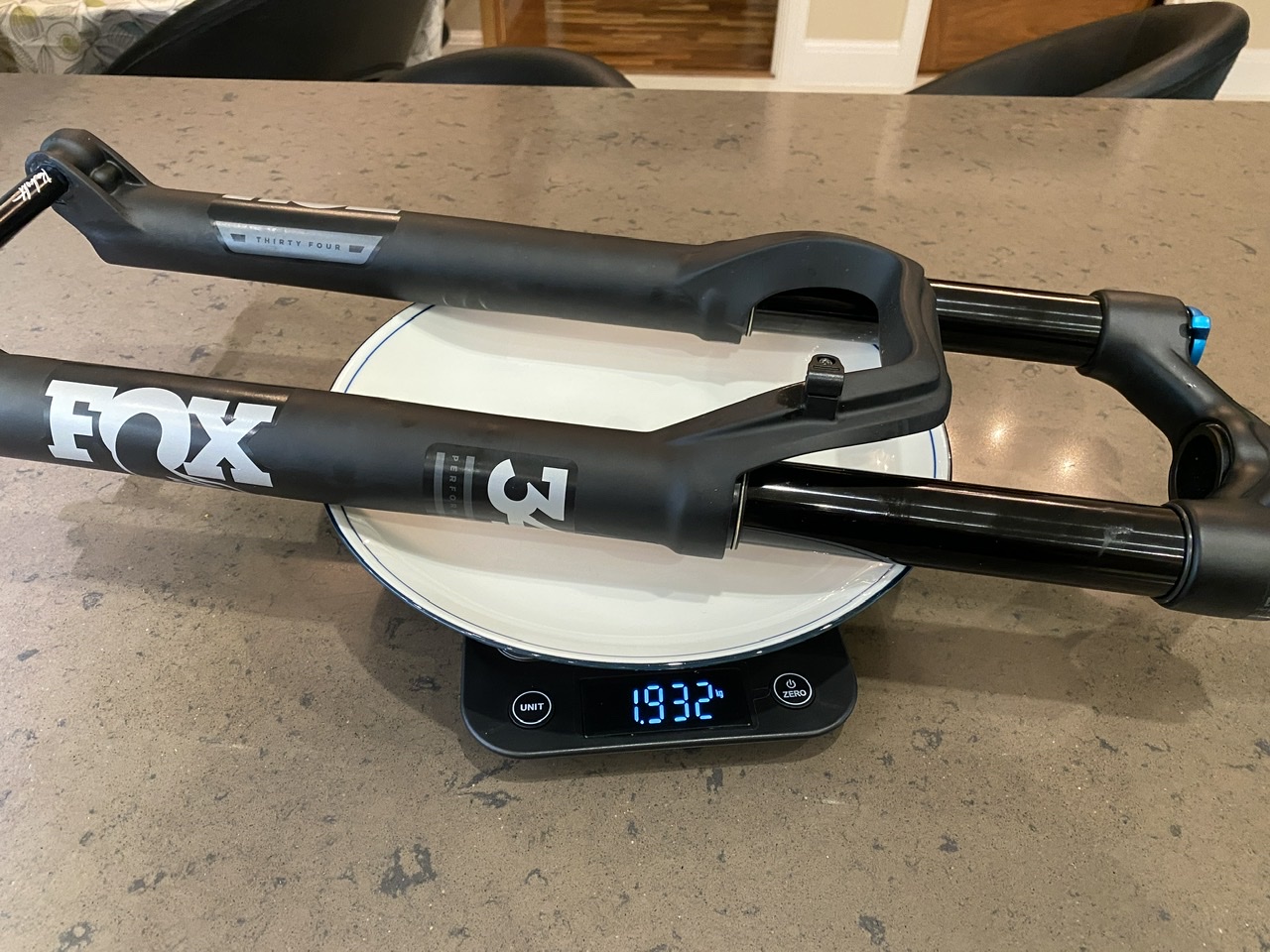

Here’s a good one. Everyone saying Spesh have fitted a Fox 34 to save weight.
Here’s it vs the Lyric I got today. 160mm 51offset.
FYI, I work with instrumentation and have calibration labs at my work. I had them calibrate my scales when I had them delivered yesterday.
When a certified 2.000kg is applied, mine read 2.008kg... so take 0.008g off both readings!!
Fox 34 Performance - 29er 150mm 51 offset. 1.932kg (or 1.926kg corrected)
RockShox Lyric Ultimate 29er 160mm 51 offset. 2.006kg (or 1.998kg corrected)
Surprised to see only 74g between them. I genuinely thought this was going to put my weight up by about 250-300g... so very pleased with this result!

that with steered cut? grams to be had there ?
The person I bought it from says no, but I’d be inclined to differ. About 1cm shorter than the Fox, and with not nearly as nice a finish at the top.
On another note though... the Lyric has Invisiframe applied, so that’s some extra g’s there ?

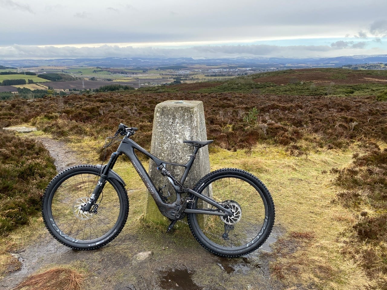

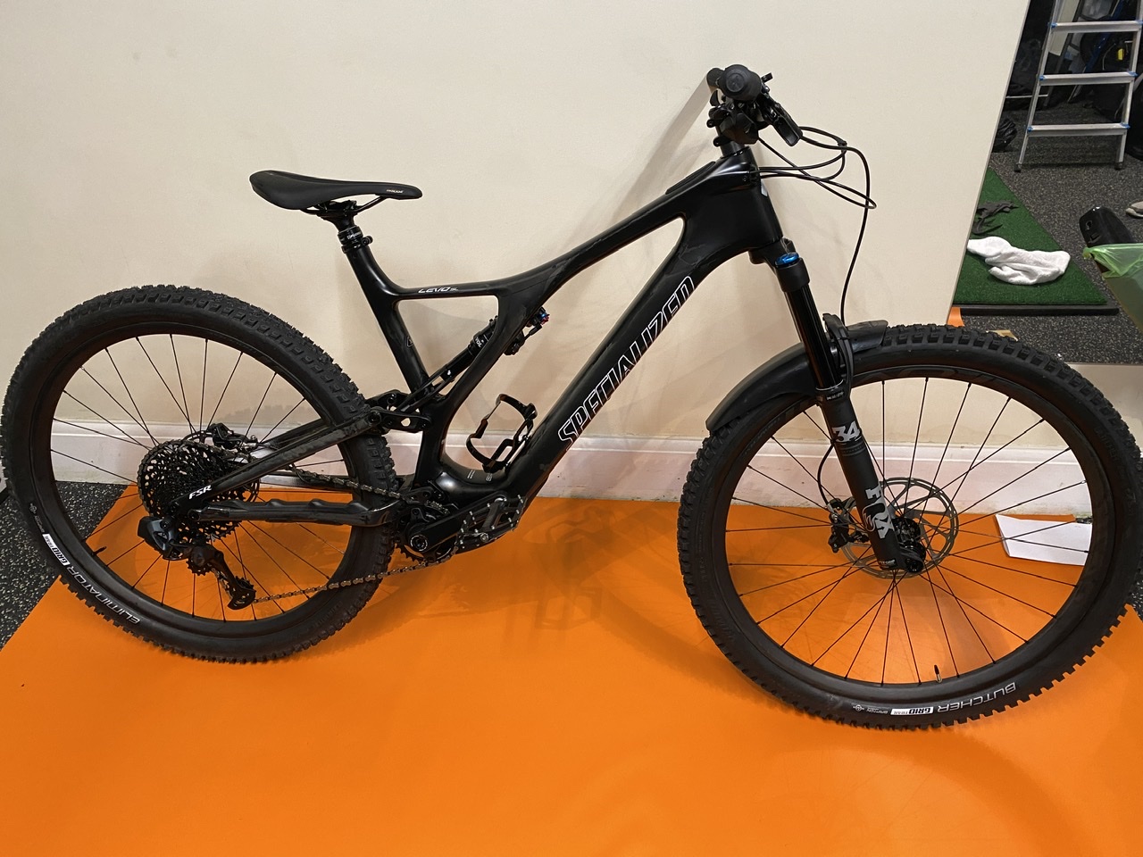

Today’s ride was like riding a different bike.
Probably because it was.
First time I’ve ridden with the Lyric Ultimate 160, Magura MT7’s, and I have Maxxis DHF 2.5 upfront and DHR II 2.3 at the back.
What a transformation.
Firstly, the Lyric is so much smoother than the Fox 34. Did the extra 10mm make a difference to my ride today - probably not... but the Lyric (for me) is just a much better fork. No issues climbing. I put my stem about 5mm lower, and didn’t have any issues with the front wheel coming up - even on super steep climbs that I needed 1st gear for.
The MT7’s offered much more stopping power, with much less effort. I didn’t feel like I was having to crush the levers to slow the bike down. The G2’s felt like they faded really quickly, but the MT7’s offered so much more... and they didn’t shriek at any given opportunity!!
The bike felt much more planted on descents, and less prone to sketchy moments where the tyre slipped. Could be down to better dampening or better tyres - but it certainly cut out a few brown shorts moments!
Overall I’m really chuffed with the difference. I’m still waiting for my AXS dropper to come, and then I think I’m done with mods for a while. I’d like the Praxis carbon cranks when they release them... and I’ll maybe order the Magura carbon levers.
Also need to get a new tubeless valve (the Specialized one won’t seal 100%) and invest in a charger pump rather than taking my wheel / tyre full of glue to the LBS at 9am!
The bike is currently sitting at just under 17.7kgs with mudguard and ShockWiz fitted.
Carbon cranks should take it down to 17.5... which will be 5 full kgs lighter than my Trek Rail was!
I’m sure I could have done more to make it lighter... however I have some pretty high end components that have added weight rather than remove it. I’d much rather have the setup I want than losing 500g and sacrificing the ride for the sake of weight.

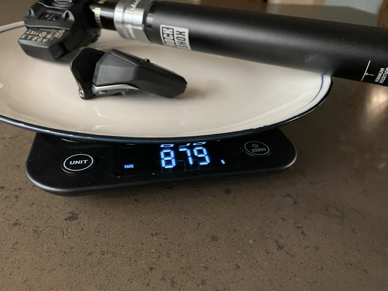

What a saga...
When ordering the bike, the shop I got it from had to issue me quite a large refund (the difference between a Rail 9.9 and the SL Expert). I asked if they’d price match Wiggle(£539.99), and order me in a 170mm AXS Reverb dropper. They did - but it was out of stock in their warehouse. The due date has moved, and moved, and moved... until yesterday they advised it would be mid April.
I asked why - as I could get one from Tredz next day, at £489.99. They agreed to offer me a refund so I could order from Tredz. Ordered yesterday, here today!
X-Fusion Manic 34.9mm x 170mm dropper with cable and lever: 752g
Rockshox Reverb AXS 34.9mm x 170mm dropper with battery and wireless lever: 879g
+127g for the AXS Reverb... but well worth it!!

Good weenying. The Manic dropper is heavier than I thought it might be.
The Reverb weighs more than I’d expect too. It’s a little more about function though so I do understand your draw to it.
My whole build is about function rather than weight. It’d be nice if they coincided and the bike got lighter with every component change... but sadly that isn’t the case for some of these!
