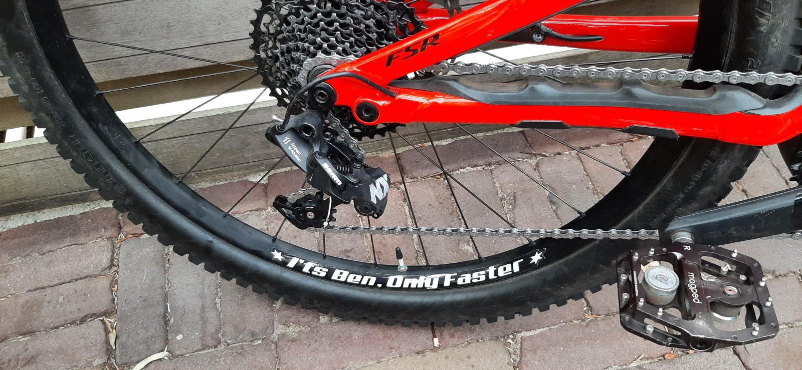

Voltage compensation...if I understood well, it's just as buying a Tesla and use it as a Volvo to save some performance at the end of the trip, but you know you will always recharge it before reaching 20%...for me it's silly...it's not a feature I would like to have by sacrificing all the fun
Exactly, how often do you ride <15% left. And if we get a longer lasting battery, what are we talking about.. 1 mile extra or 5 miles?
The whole Ebike is compensating ;) but that is why i have bought a Turbo Levo. I want back to 7.4.1 or option in MC to set it in 7.4.2 "pussy" (just kidding) mode or Turbo mode.
Or i could replace this with " * I'ts Ben, Only Slower * " ;)

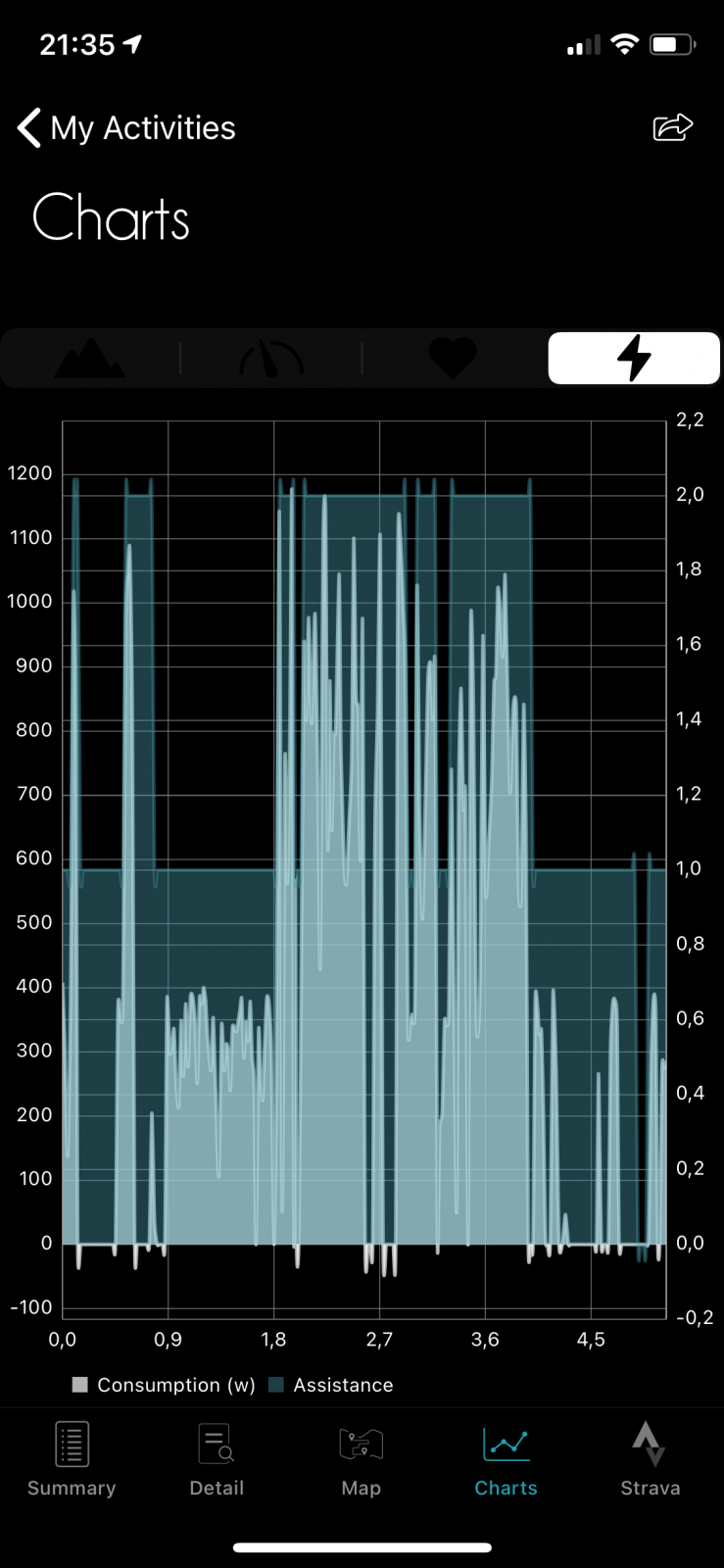

My Rocky Mountain Powerplay’s top assistance level, famous for disproportionately draining the battery compared to the lower levels, is actually called “ludicrous mode”, like the toggle on Teslas which lets hell loose. I wonder whether (and it actually feels like) this also lets it all out raw without regard to any compensation and the sort..
This consumption diagram would suggest as much but I don’t know if it’s wrong (consumption isn’t necessarily power output either). Watts on the left side and assistance level on the right (0=Eco, 1=Trail, 2=Ludicrous/Turbo). Peak power is referred to as 770W officially though.
Anyway, I support the feature suggestion. Specialized will probably default to voltage compensation being on though.

Now will come Mr. Zimmeframe asking you for data, curves or files to show to us. Many of us are feeling it so something has changed 100% sure.
In 30 minutes I am going to the specialized dealer to talk to him about it and will ask him to contact specialized importer about that, I think will be more productive.
14,171
21,078
It can't be any less productive than just repeating .. repeating .. repeating .. that you think it has less power but not giving anything more than that for anyone to work with ! :) Believe it or not, we heard you the first time .. The forum font doesn't get smaller with time.
What I've not worked out, and this is obviously a fault of mine, is why you think repeating it will suddenly make it different ?
Does this work normally for you guys who have "THE PROBLEM" ? :D
Come on, please, help us a bit and maybe we can make some progress.
14,171
21,078
Not sweep it under the rug as you appear to be trying to do.
So my REPEATEDLY (in response to your repeated claims) asking for more information, some screen captures, some evidence or something of some sort other than just your feeling .. is sweeping it under the rug ?
When in fact isn't it the complete opposite ?
By trying to get some EVIDENCE from you guys, it's to try to work out if this is actually happening on certain bikes so we can find out why.
Whilst just repeating EXACTLY THE SAME THING and continuing to provide nothing, not even motor serial numbers and proof you have 7.4.2, eventually just makes everyone think you're having a bad day and are making it up or have some other technical issue, like a battery problem. - especially as 99% of the people who have the update DON'T have an issue.
As far as we know, you don't even have a bike !
Specialized won't ever step in on the thread if no one gives anything to work with. They'll just presume you're some trolls from Moscow-Cruz worried about your entry into the global market.
Don't you get that if there is a problem, we'd like to help. That's why we're here typing this crap.
