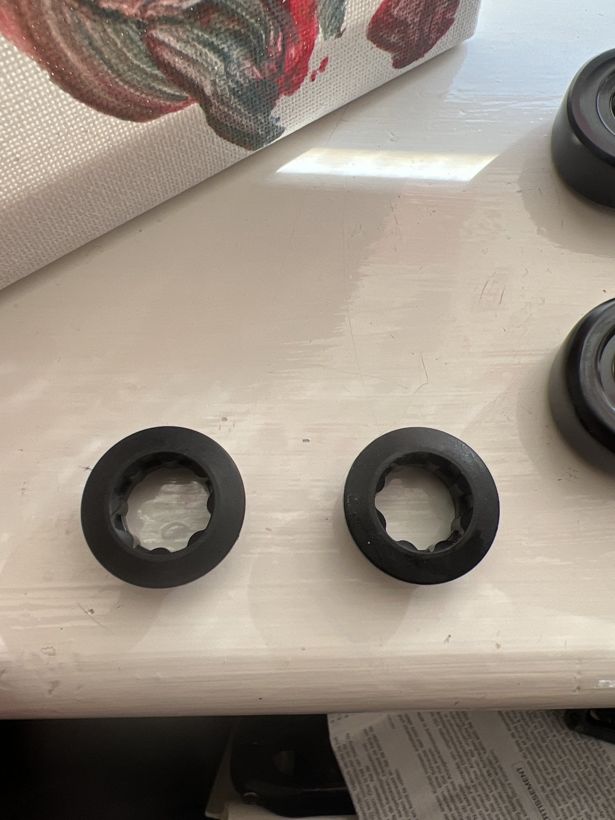

Received the crank arms today what tool is used to tighten up the preload caps is it a shimano special tool View attachment 85071
Based on input from a similar thread, purchased this aluminum end cap that is much more robust then cheap plastic type material that came stock on my YT Decoy. Also purchased tool to remove stock end cap and it cane off very easy. Could have used something from toolbox without dropping any cash for tool since I was replacing cap anyway. Have a tool I will never use again! New aluminum end cap uses standard allenwrench.
Singletrackmind
Sep 17, 2020
477
435
San Diego, CA
  1. Ask Shimano?! Most stuff has been out of stock for months, not just the crank arms. Also since Orbea is using Shimano cranks for their recall that's going to suck up some of the supply.
  2. Seem to be standard.
Pretty sure they are ebike specific meant for the EP8 or E8000 motor. If thread is too long, will bottom out against spindle arm and not seat up against crank, thus not securing crank to motor spindle.

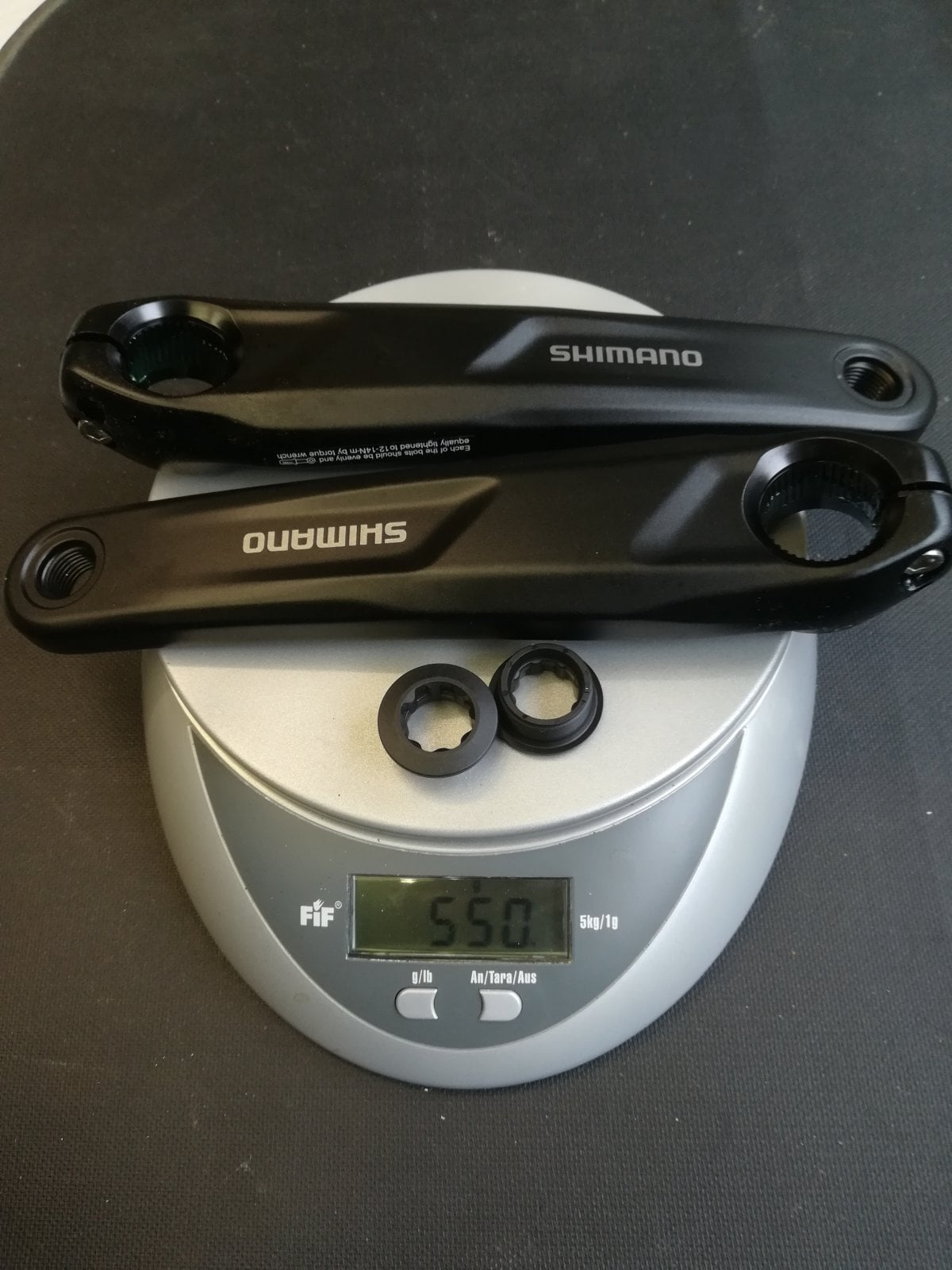

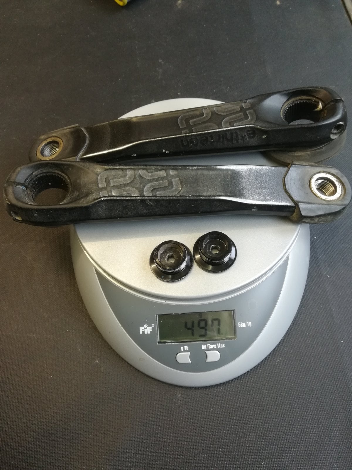

After more than 7000km on my orbea rise M20 i had no issues concerning cranks and spindle.
But following this discusssion i decided to install some Shimano FC-EM600's at my own expense.
It is worth 40€ to feel safe. I am not really interested in waiting for the e*thirteens to fail.
For the weight watchers: FC-EM600 = 550g, e-thirteen = 497g

I wondered if he meant the carbon ones. Seems pretty shitty that Orbea are using cranks that the motor manufacturer themselves have said are incompatible with the spindle. Seems the em600 cranks are compatible and SUPER cheap compared to the em900/XT ones, but I don't know if they weigh a bomb and I can't find weight specs anywhere on those.
EM600 = 550g. I just mounted a pair. see my recent post.
Excellent first hand data. These are almost the exact weights I posted from manufacturer data: EM600, EM900, M8150 crank weights confirmed - EMTB Forums
Funny that parts manufacturers can accurately measure their parts to a few grams of accuracy, but bike manufacturers are hundreds of
grams wrong!

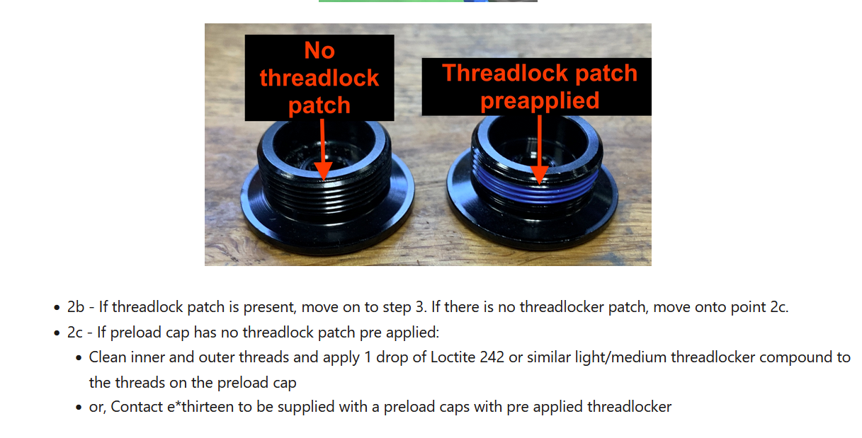

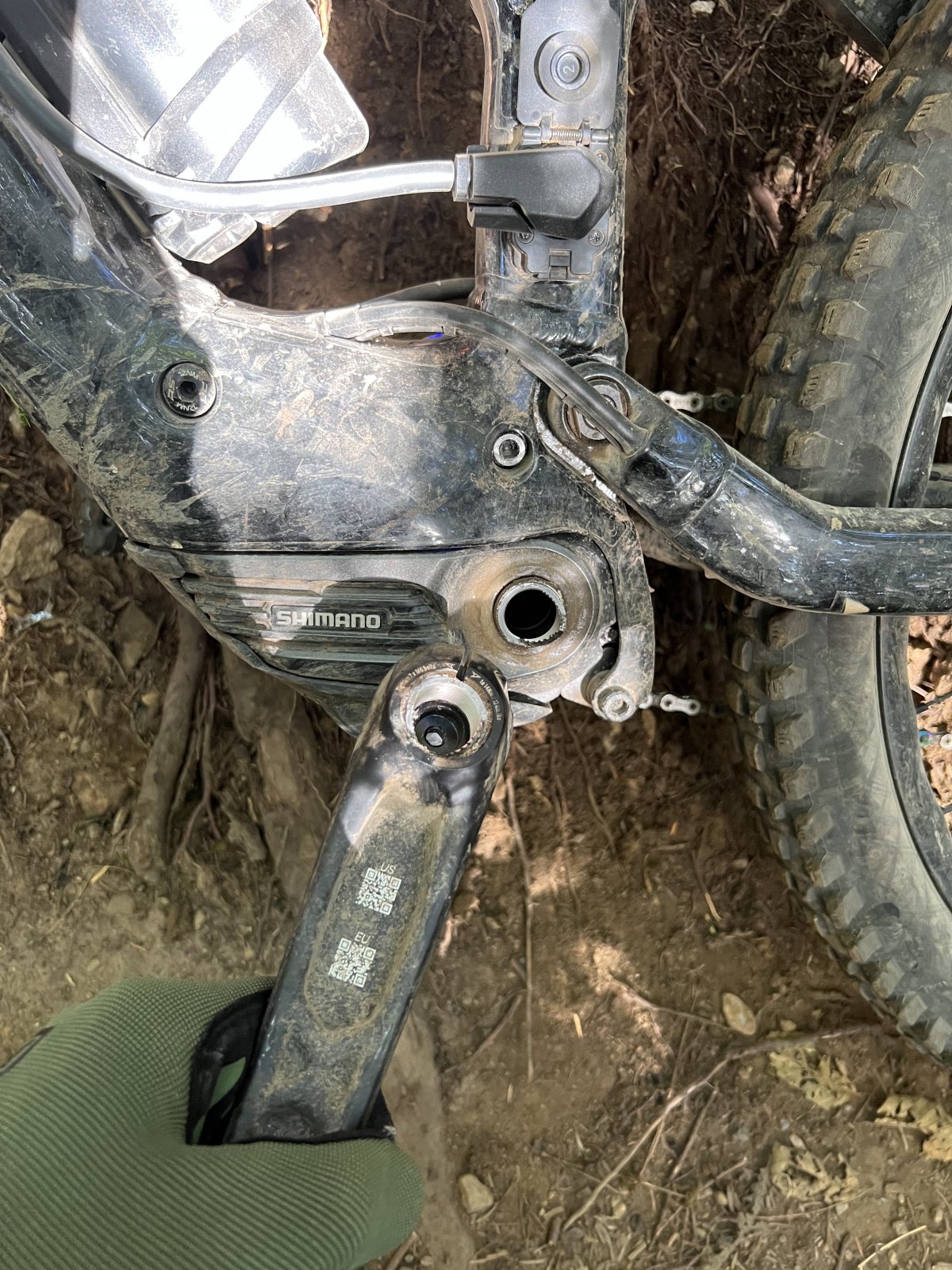

Oh Damn. Were they set up to the "new" recommendations, i.e. with loctite, 14nm, and with the hole the opposite side to the pinch bolts?

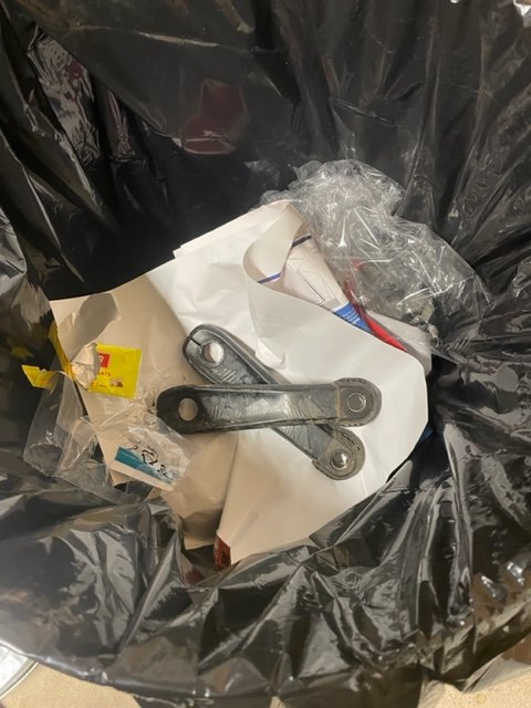

I didn't even ride my bike with the e13s, pair of XTs went straight on before I started.
Yes, followed the new guidelines. Pretty disappointing.

One of mine came off yesterday too 😭 (slow speed uphill thankfully)
I’ve got the M20 with alloy cranks and to be fair I haven’t had any issues over the last 18 months. I did the threadlocker etc but hadn’t checked torque for the last few rides, so keep an eye on it if you’re sticking with e13 (I’ve ordered shimano xt cranks)

Shit. First instance I have seen of this since the new guidelines. Maybe your bike shop didn't follow them?
Have you spoken to them about it?
The "guidelines" include checking for hairline cracks in the axle. I suspect that's what happened here.

Add mine to the list of bikes with non-driveside arm falling off M10.
I even contacted orbea when I got the bike who stated that mine should be in the batch that have had the appropriate changes made to it! Not happy, luckily neither I or the bike (as far as I can tell) sustained damage.
Why doesnt the tech update say to reapply fresh loctite to the preload cap if it already had been applied? seems strange

My take, (not a mechanical engineer... so take it with a few grains of salt), is that aluminum is potentially the wrong material for that cap. It seems that shimano may be onto something with a plastic cap that deforms if/when the axle bends and/or expands with heat. It's been said elsewhere in this thread... but I'm a very seasoned bike mechanic and while I don't make my living doing it, I easily could. I checked my e13 cranks on both my and my wife's m20 rise's religiously, as much as every ride. I had them installed properly, read all of the documentation and updates on the correct install methods (from both orbea and e13) and that didn't stop the crank arms from falling off.
Since putting shimano XT cranks on my bike, and shimano deore (really, non series) cranks on my wife's bike... I've not had a single issue with this. In fact, I realized the other day that I had ridden my rise for about 4 months without checking the cranks on my personal m20. Checked them the other day, and they were still just as tight as the day I put them on, and the spindle shows no cracks, thread issues and the end caps were still as tight as they needed to be.

The caps are not for retention. The caps are for preload ("pre" as in "before tightening"). If you crank falls off, it's not because of the cap. It's because the crank bolts were loose. The caps don't have enough torque or material to keep your cranks on under any non-trivial load.
The plastic design of the Shimano caps is to prevent you for over-tightening the preload, not to retain the crank at different temperatures.
