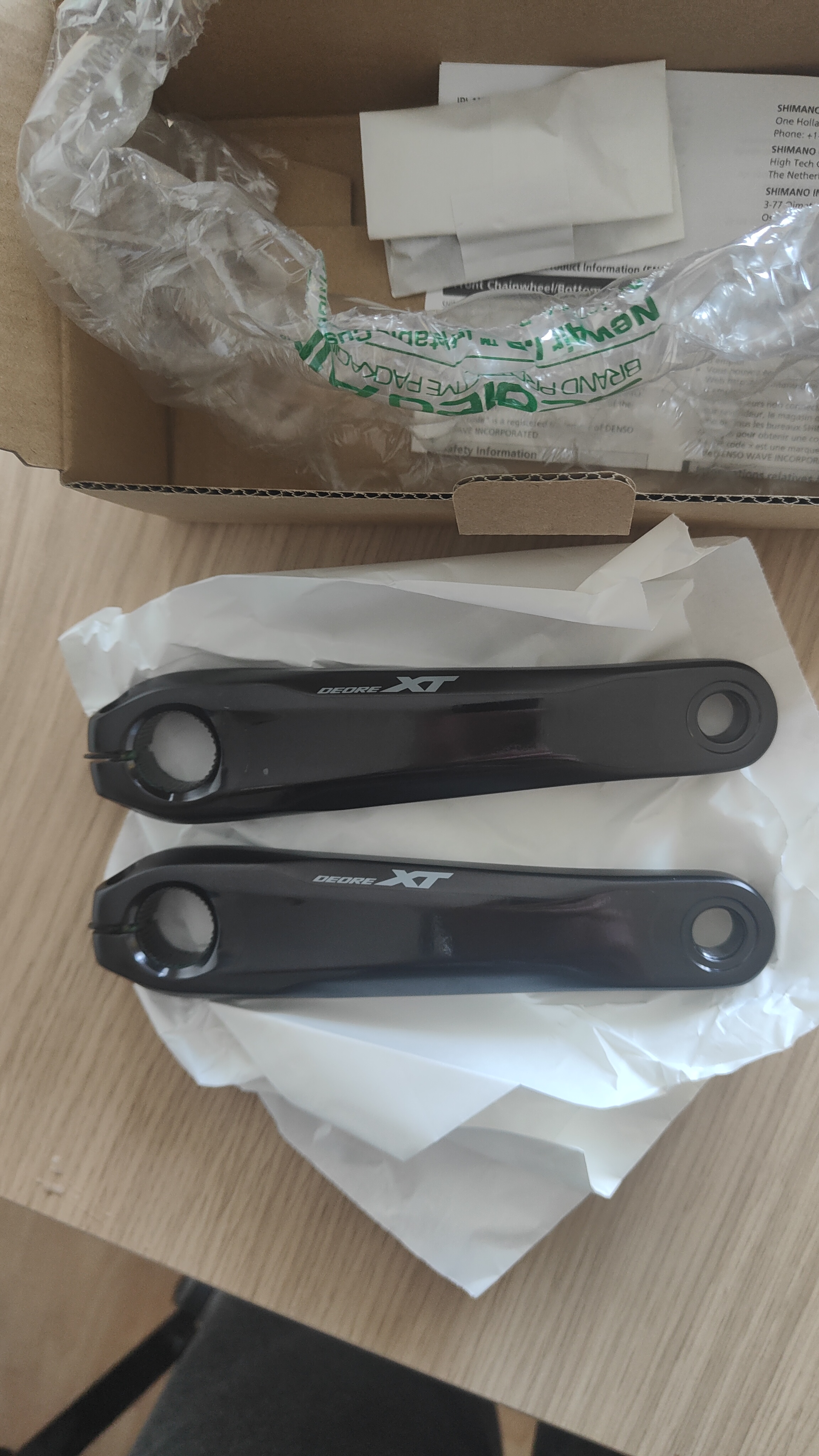

My Shimano goodness arrived today, will take off the e13's and check the spindles later.

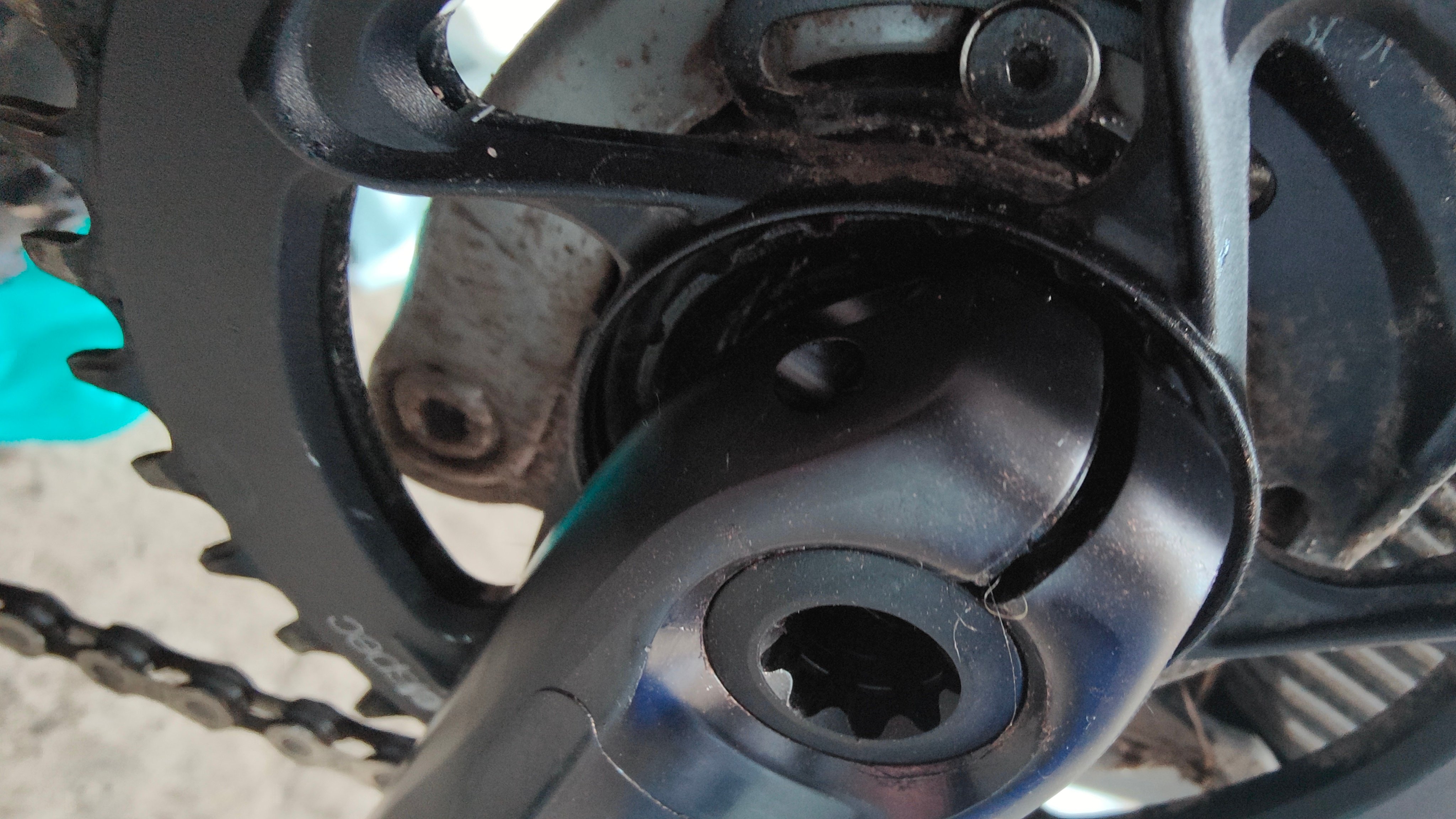

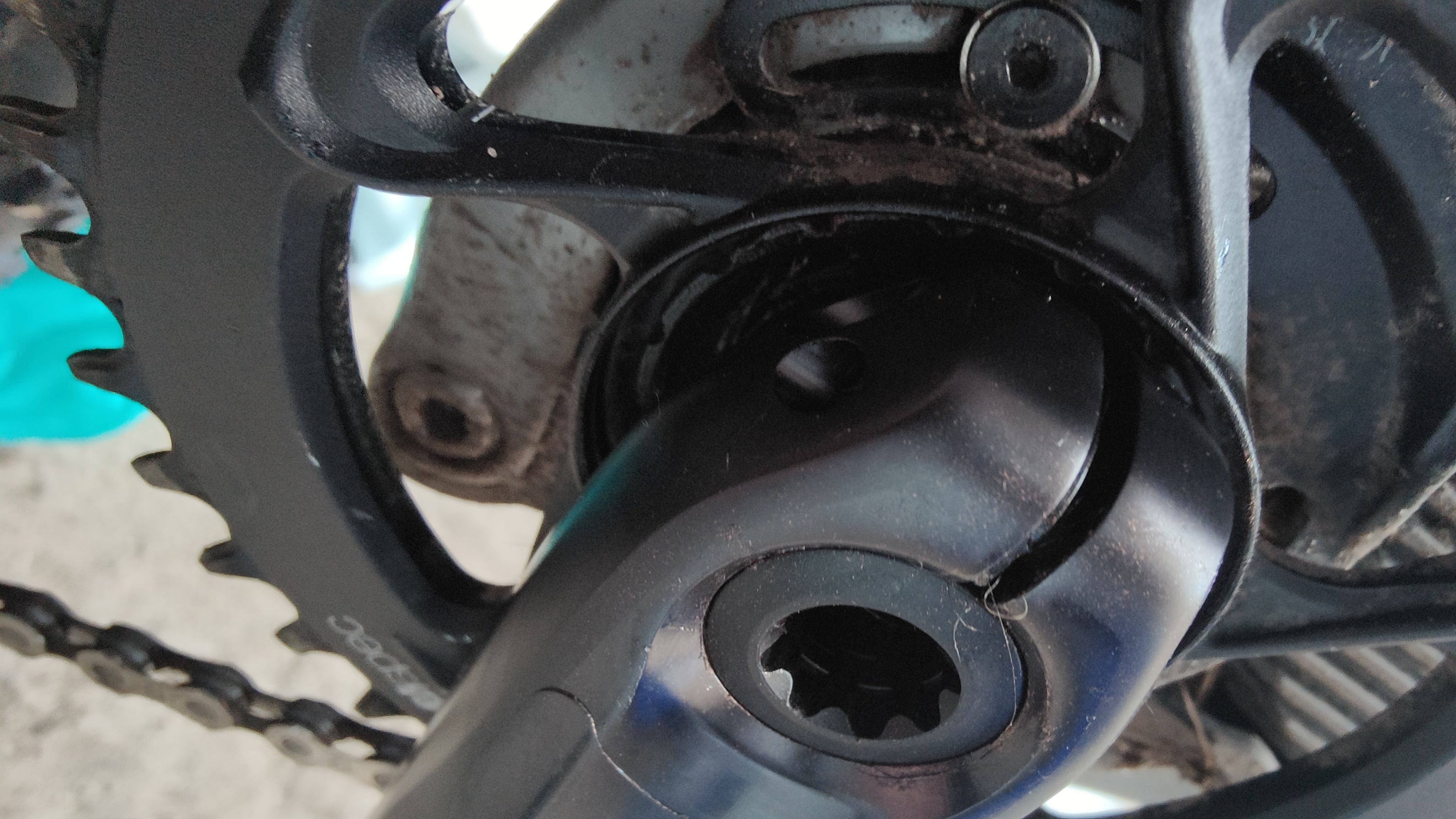

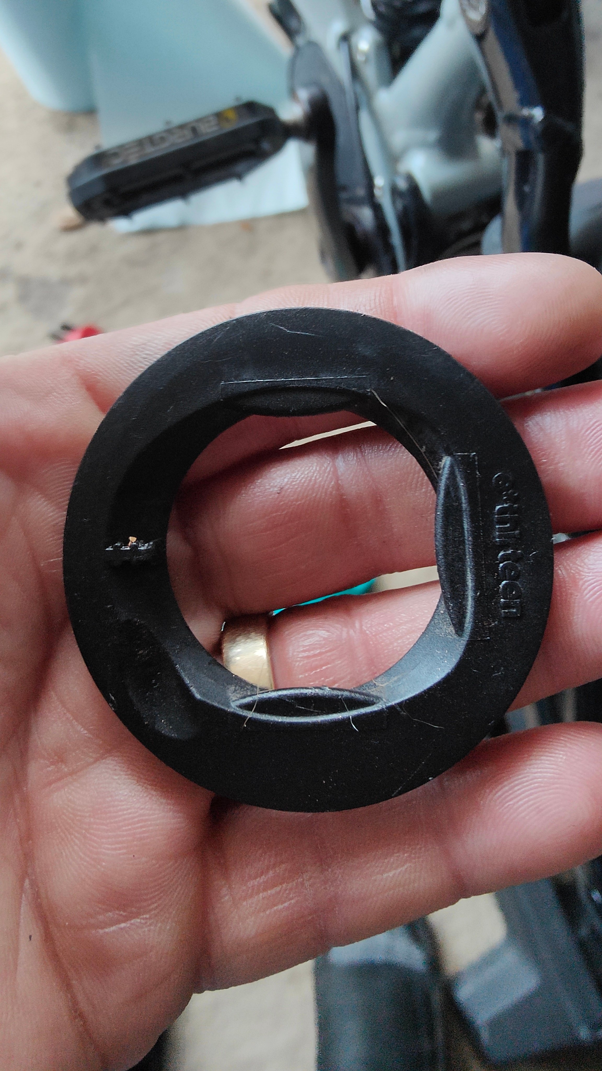

Hello all - in need of advice. So I swapped my cranks yesterday (no issues with the spindles thankfully - but I'm a little confused - there was a sort of rubber washer behind the drive side e13 crank, do I just discard that? I know the XT cranks wouldn't go fully on with it in place - and if so do I need anything to replace it with? there now seems to be just an ugly space behind the crank - any help appreciated.
See pics (apologies for the quality - it was all a bit rushed.

It was designed to be used with the E13 cranks so can leave out, I replaced mine without the rubber washer back in the summer
Thanks for putting my mind at rest - it does look odd, like something is missing which messes with my OCD a bit but as long as others have done the same with no issues.
I'm used to working on 'normal' drivetrains and BB's etc but am totally new to ebike maintenance.
At least now I have peace of mind that the spindles aren't cracked and in case of any issues I have Shimano cranks. The e13's are going in the bin.

I contacted Marin direct (I have the Alpine Trail E2) and they sent me out free XT cranks, which Shimano recommend for the EP8. Maybe Orbea will do the same?

Thx for the tip. I finally got the bike shop involved and Orbea has shipped me some new cranks. I didn't want to wait so bought some Shimano EM900 on Amazon and had the bike shop put those on. I'll use the ones I receive from Orbea as back ups. Appreciate all the help!
Much the same as me, bought some XTs myself but when Marin sent the replacements I sold em on.

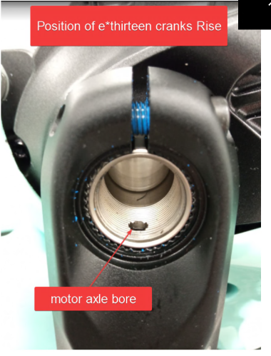

Latest advice (via my dealer) on fitment of e*thirteen cranks - note that they're upside down to how you'd fit a shimano crank (which has the safety tab/pin that drops into the hole).
