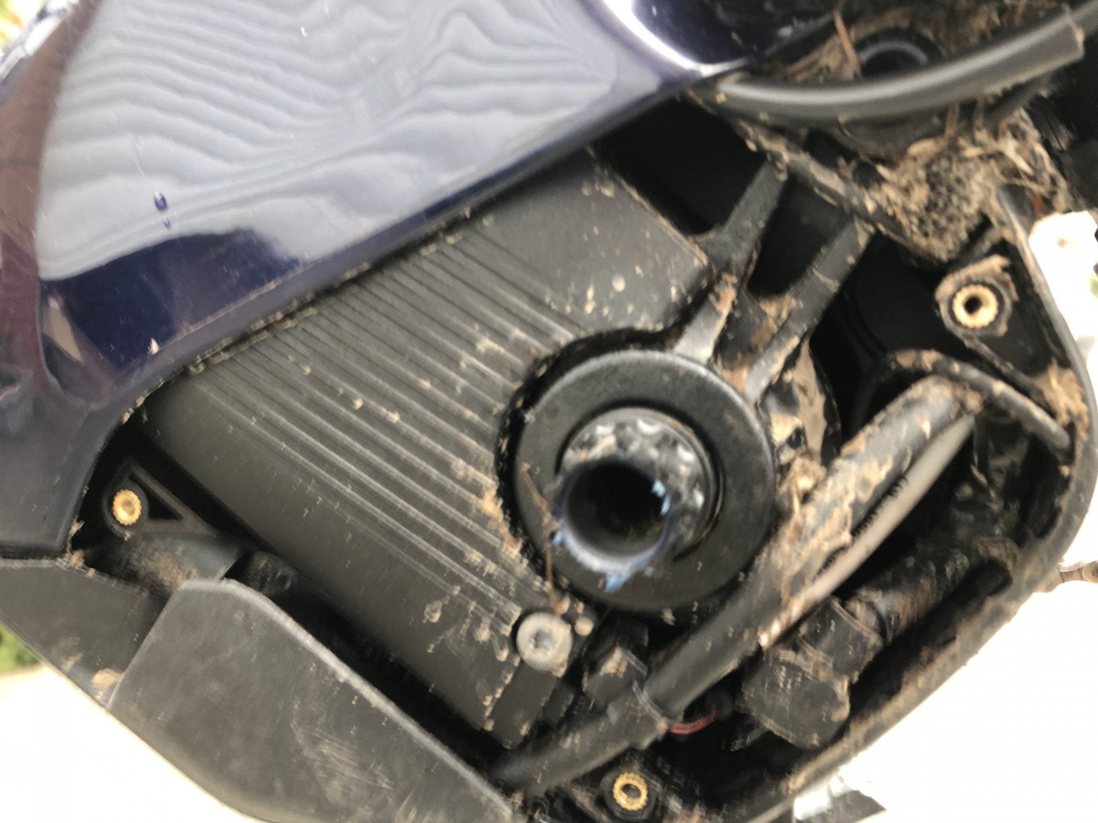

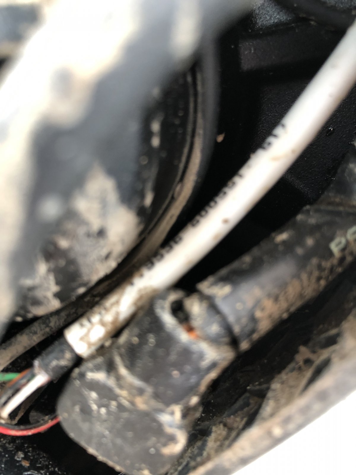

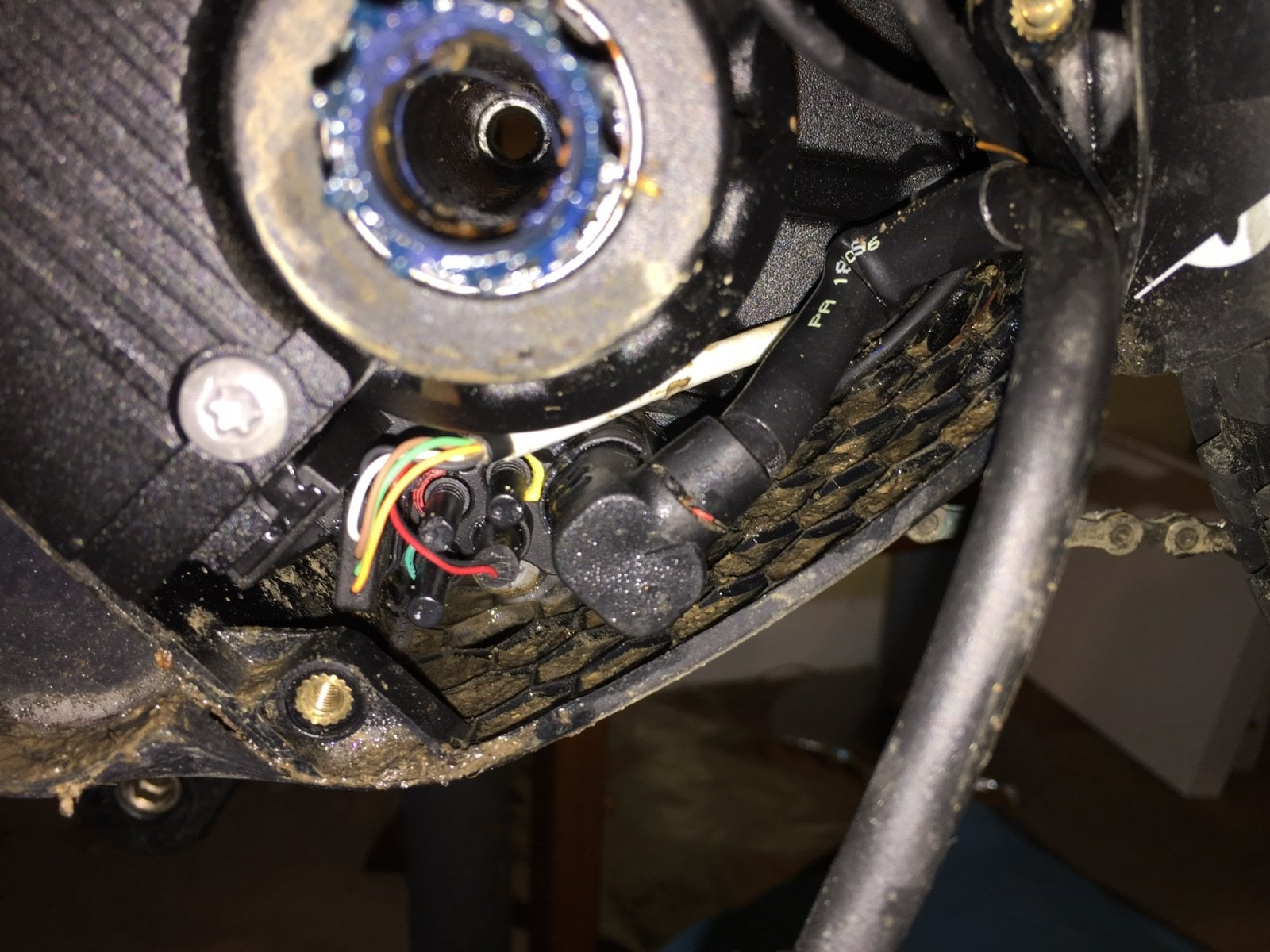

I opened up the non-drive side motor cover about a week after I had the noisy motor replaced on by 2019 Levo (bought 28/10/18, this photo 15/12/19). The work was done at Spesh UK, and as they fitted the foam to prevent debris getting in I wanted to do a quick inspection. There was a very small amount of debris in there, which had come in through the drain hole, but I also noticed the motor connector was split and you could see the wires below - I did report it and said I would monitor it. I also used a thick silicone grease to fill the crack and seal around all the connectors (obviously avoiding the electrical pins). You can also see the cable is kinked as others have reported. I have had maybe 4 occasions when I have had the blue/red LED battery fault code flashing on start up - each time cycling the TCD power switch resolved it, and no problems whilst riding. But it is always a lurking worry that the cable may let me down one day, although I have confidence that Spesh would resolve under warranty.

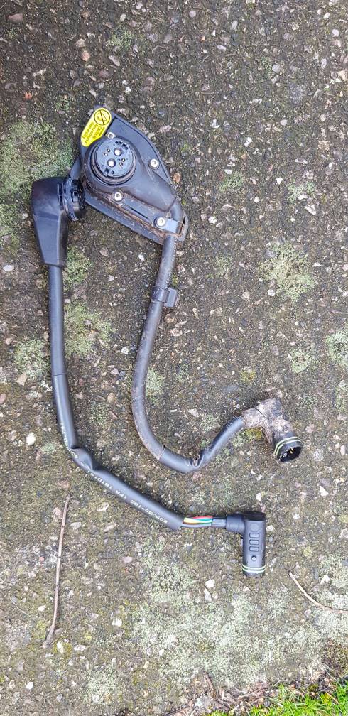

No Bike this weekend then as the new cable did not arrive from Spesh today at the LBS:(. Its on route apparently. In answer to BBKs question about the modded cable - I had a chat with the LBS mechanic tonight as it happens and he said the new cable is definitely modified at the plug end that goes into the motor. If I understood him correctly there is now less outer cable sleeve within the plug which means less tension on the plug itself (which is a right angle connector) Its the outer sleeve that is causing the connecter to effectively explode. I guess only time will tell if the new version solves the issue though.
There's is definitely less outer sleeve on the new cable

Just had my cable replaced 2 weeks after purchase with the shorter unsheathed version after failure to turn on and 2 flashing alternate lights on battery. Seems all good now.

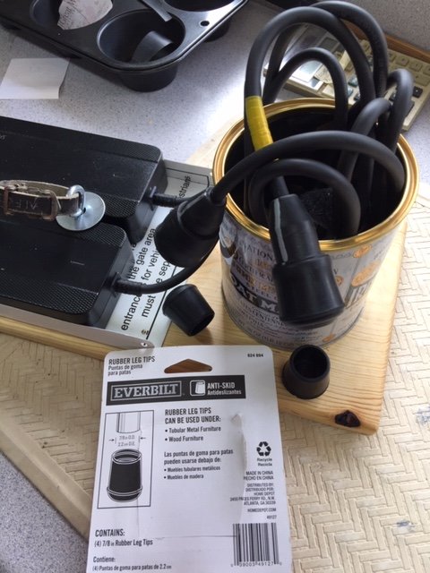

Just to be on the safe side and not allow debris or metal filings to stick to the ROSENBERGER charging plug and foul the charging connectors I place a rubber end cap for chair legs onto the plug when not in use.
7/8" diameter fits tight and seems to seal pretty well...also available in white color...;)

Hey guys. I've been reading through this thread and am experiencing an error that is not mentioned:
When I turn on my fully charged 2019 Spesh Levo Turbo S-Works there is a long delay (longer than when it turns on normally) the blue LEDs illuminate sequentially to the top, then they go back down and immediately shut off.
The bike will not stay on. Today I took the motor cover off and re-seated all three connectors - no luck. My motor was just replaced a couple weeks ago. Had one ride, then lightly hosed off some mud off the bike that day. One week later I now have this error.
Really sorry to hear @Geezer_Levo . Hopefully the store can quickly shed some light on this for you, one thing worth checking though is that when your motor was replaced they also moved the blanking plugs from the old motor to the new motor. On each motor there are a couple of sockets that aren't used (lights for example) and these have a plastic blanking plug with a rubber seal covering them. New motors typically don't have these plugs fitted - the retailer needs to take the plugs from the old motor and put them on your new motor to preserve the IP56 rating. If they don't do this and you get the motor wet, moisture can get into the connections and create short circuit conditions. This would be good to rule out.
