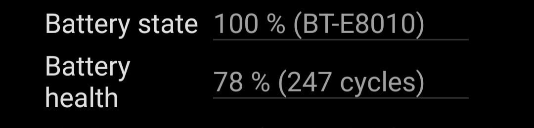

My Shimano 504 Wh battery is at 78% health after 60 cycles. Hard to be precise as I have a second battery, but that was probably about 2,500 km. I always bring the battery indoors, store it at about 60% charge, and charge it to full on the day of the ride.
It has been run to completely flat many times since the health has deteriorated, which surely can't help, but the last 40% of charge only lasts a few km, 10 at most, and there's no reserve any more.
I'm not an outlier. The BT-E8035 batteries all do this, there's a thread on here somewhere, and the new battery I got is on the same trajectory. Madison are not interested (allegedly 73% in 2 years is the magic number). I won't buy Shimano again.

On your post # 15 i read your battery health is 78% after 247 cycles or it lost 22%
if it keeps at the same rate after 300 cycles(charges) your battery health lost might be
26.7%. if at 30% lost or 70% health you choose to replace it to get the range it used to have
that might give you a bit more than the 300 i read somewhere.
