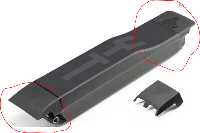

Fixing design of YT battery, a thru-bolted design, seems way more solid then the undeep threated Canyon bolts.

One end is hooked-in, the other end is fixed with a thru-bolt design. Same principle as YT and way better than Canyon.
Really? I don't see that on my Levo 22 :)
Anyway, I saw many times how Shimano external or bottom tube mount batteries flew out of the bikes and fell on rocks/ground. They were picked up, put in the bike and rode on. Also bad design? Or just a proper battery case made from proper materials?
In that case a better casing with preservation of the existing fixing design would solve the problem for Canyon. Fingers crosssed that the replacement can take place in february. According to the legal warranty law applied in Belgium, you can claim a refund if the problem isn t solved within 3 months.

Battery fixing methods are certainly something to keep a an eye on now . Batteries have moved on from 500w/h to typically 700/750 and even 800/900 w/h so getting bigger and heavier. Most use the multi male pin connector plug at one end of the battery and then a variety of fixing methods at the other end.
The first problem. Is that those plug connectors are not ideal fixing points especially if located at the bottom of the battery (e.g most of the batteries fitted into a cut out downtube), neither are they very suitable for constant connection and disconnection.
Then there is the fixing.at the bottom of the battery. This has to withstand not just the static but also the dynamic force of the battery weight.
The combination of top and bottom fixings also has to prevent any sideways movement of the battery.
Most of the problems inherent in the various solutions would be avoided if the battery was mounted horizontally rather than near vertical but designer's want the weight to be as low as possible .
Specialized resolved many of the issues by using a cable connected Rosenberger plug at the base of the battery and a simple blocking bolt at the top.
Bosch produced another solution using a steel rail system where both the battery itself , the plug connection and bottom fixing method are all fixed to and held by the rail.
Both of my bikes use the Bosch rail system and neither has caused any problems.
I had a Levo for a couple years and caused no problems either....although the magnetic Rosenberger connector and cable need some special care.
I would not buy a bike with a cut out downtube design.
My advice would be to consider how any battery is secured on bikes you short list to buy.
Interesting that there are some examples now of new approaches. Non removeable batteries is one.......using a smaller main battery plus an extender is another. Neither marketed as ways to resolve issues of housing bigger batteries....but they probably do just that!
