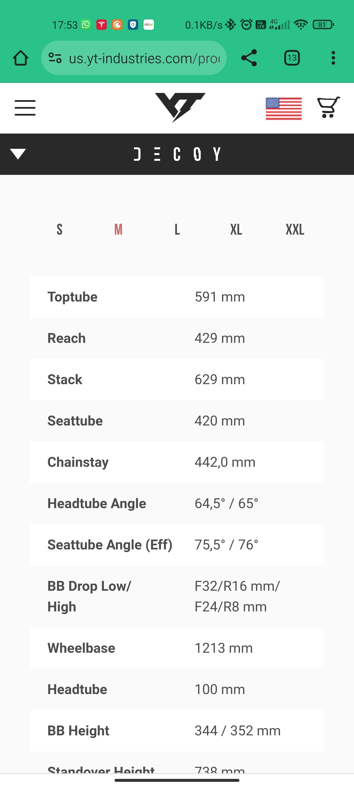

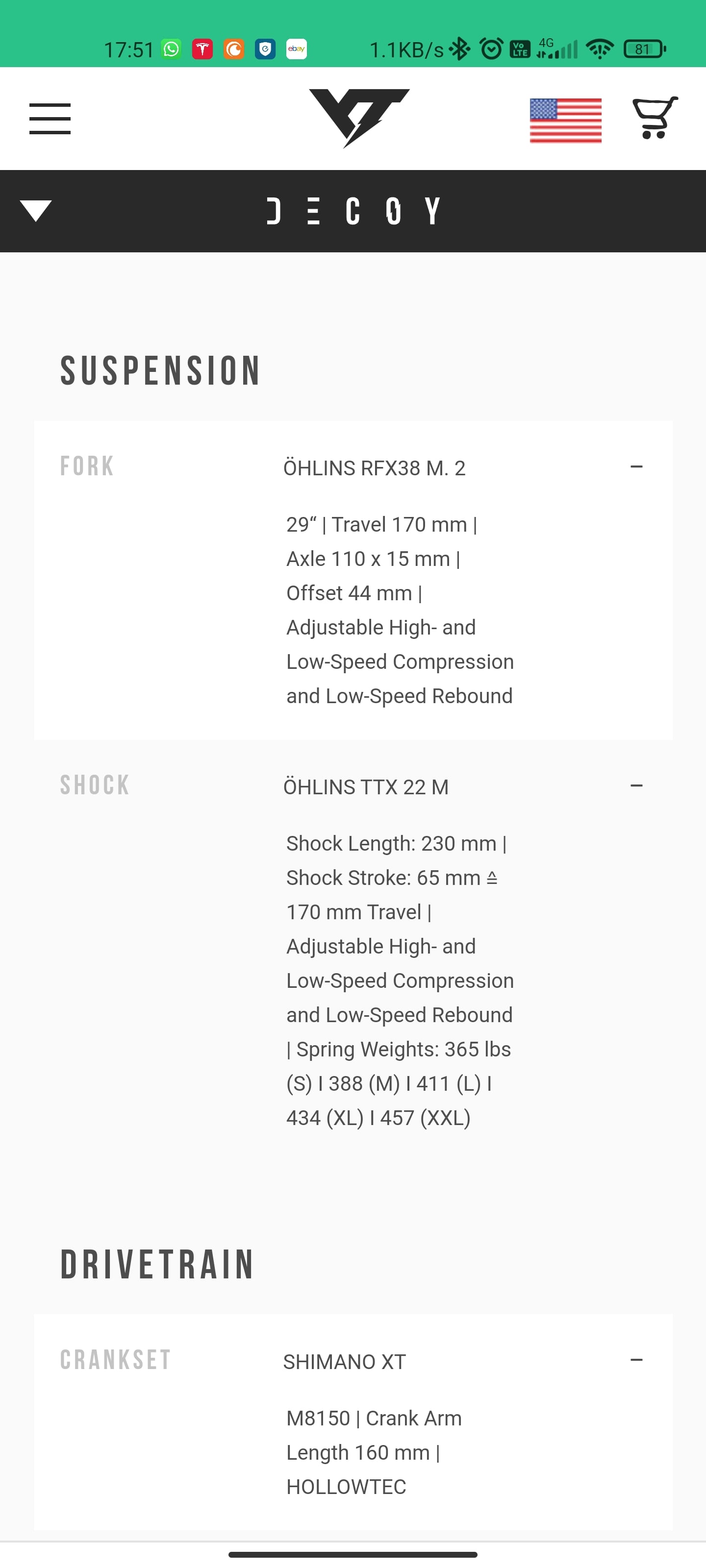

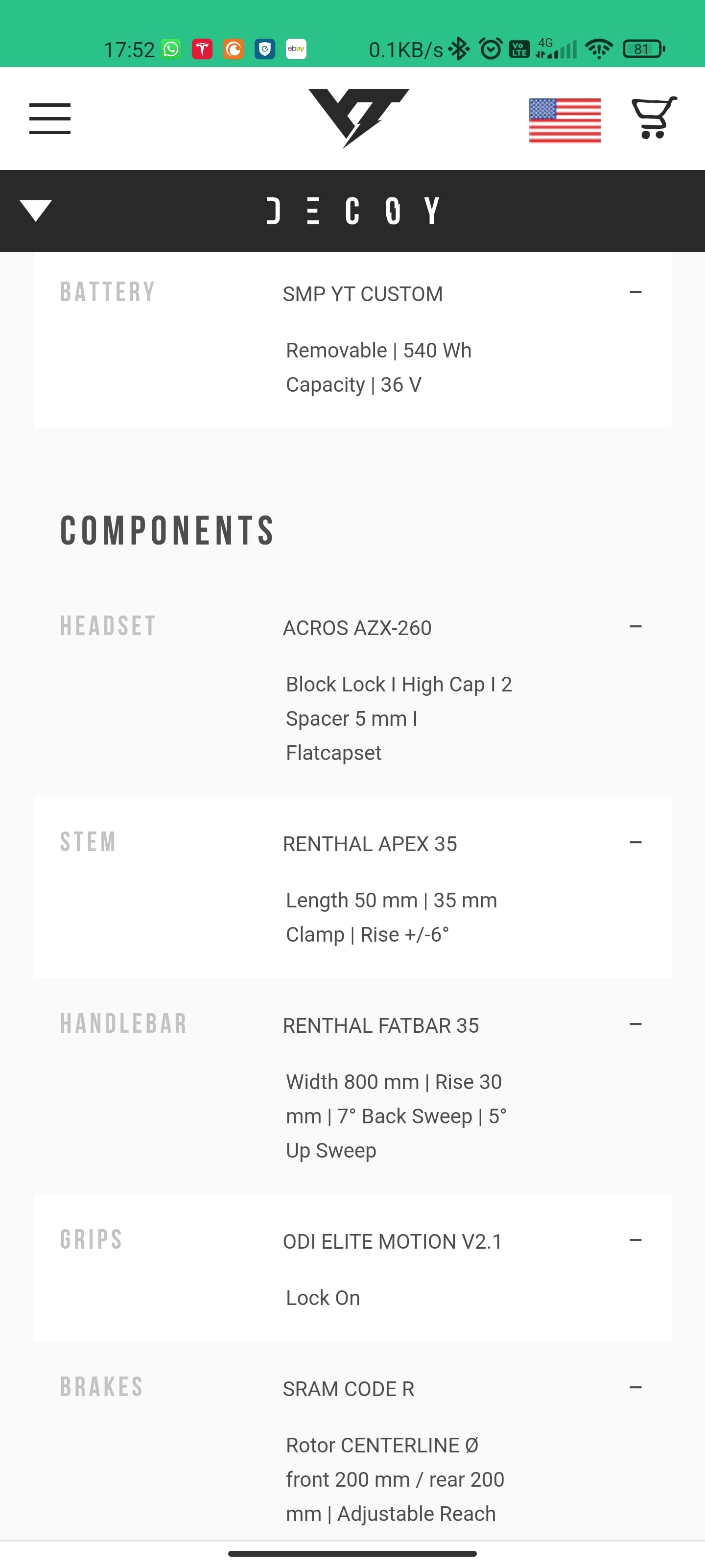

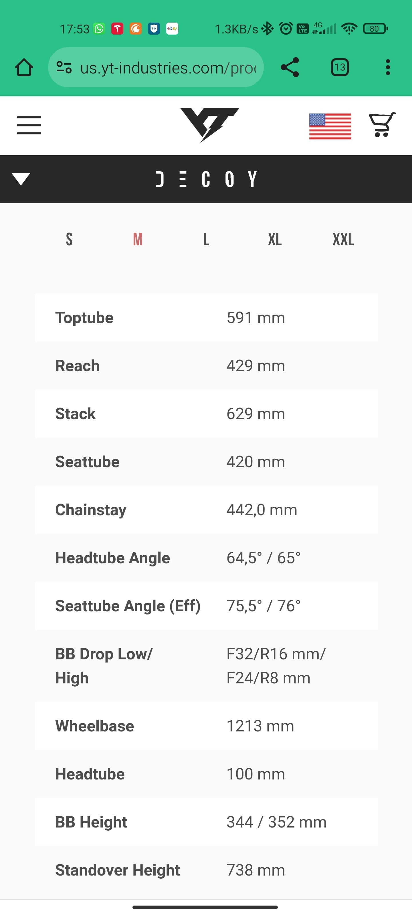

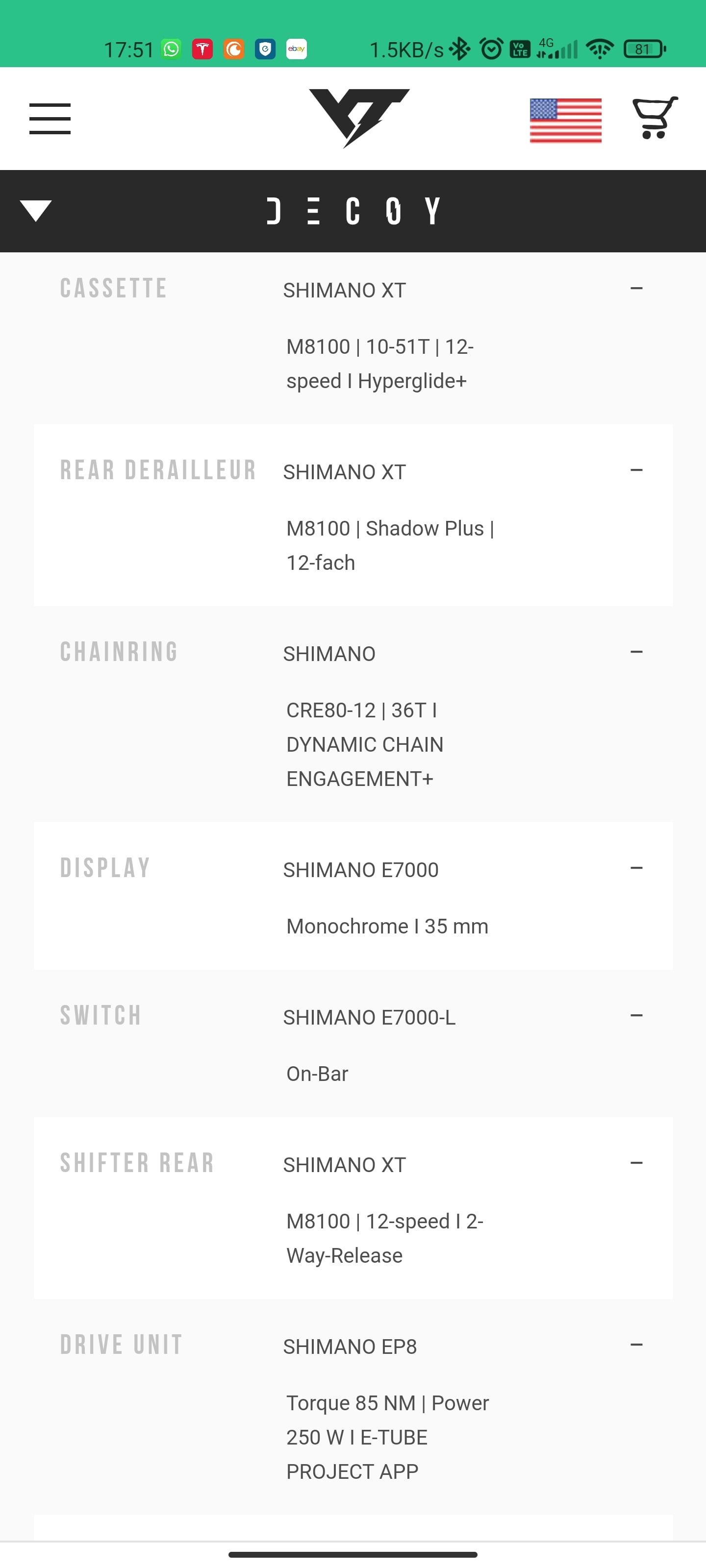

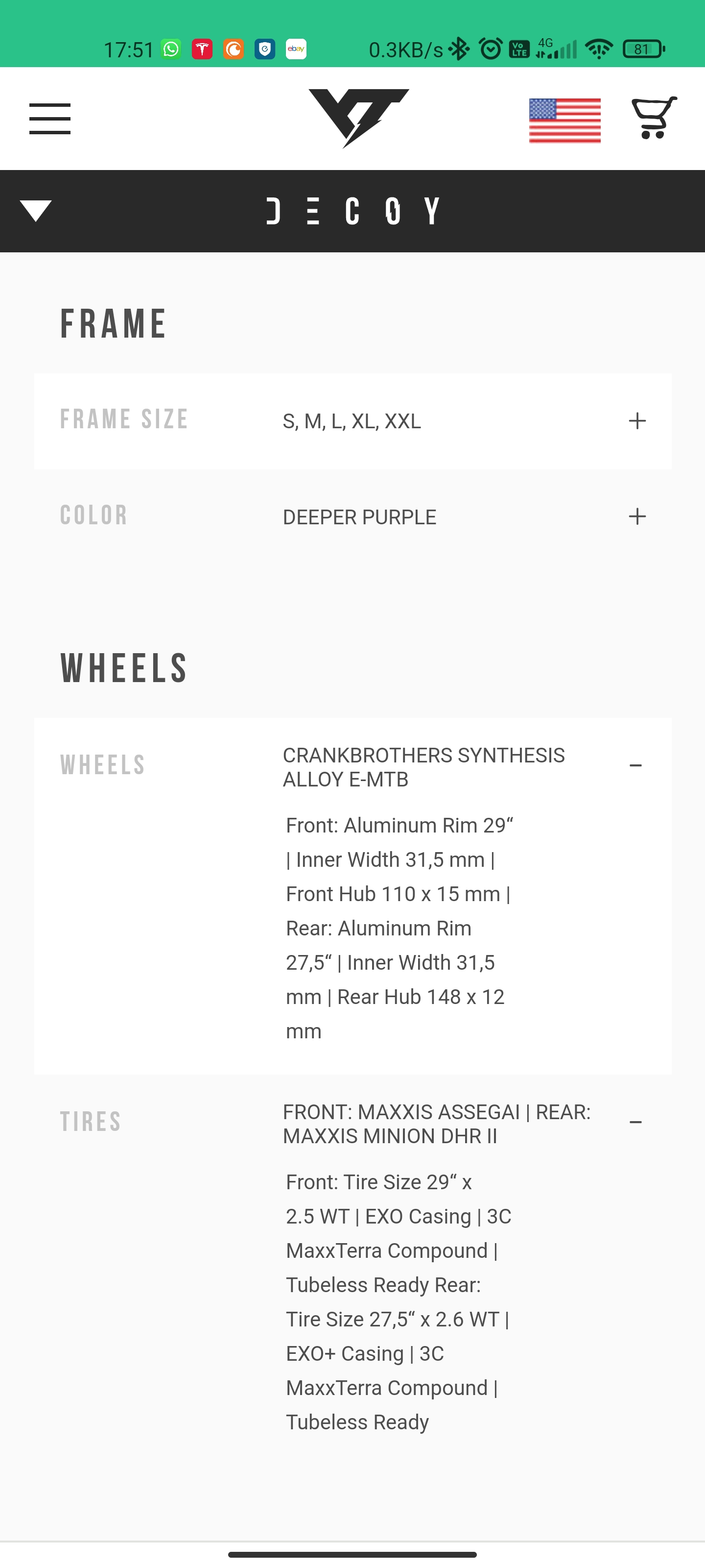

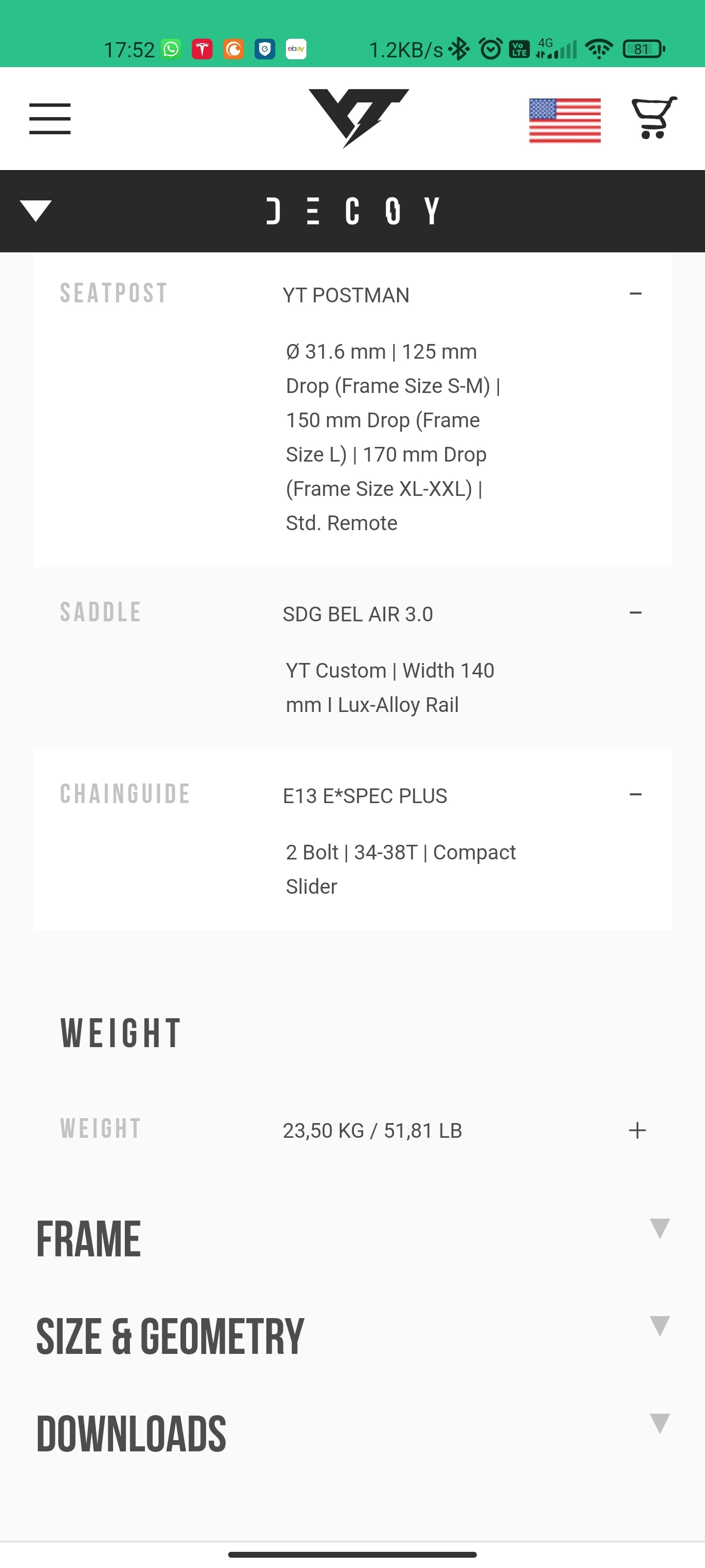

Or this one? Which one is better?
I'm looking for an all rounder, Trail/XC with some DH. Not specifically DH only.

The more I think about it the more I realise I have to be careful about the carbon components and frame.
I've been to China and met various suppliers and factory owners and had an English guy I know very well who has a business there for last 20 years.
What I learnt is everything is available but in three qualities. Low, medium, high. The high quality products are what they make for the western companies and those are the type of products I'm trying to source but at significantly reduced pricing compared to rip off UK.

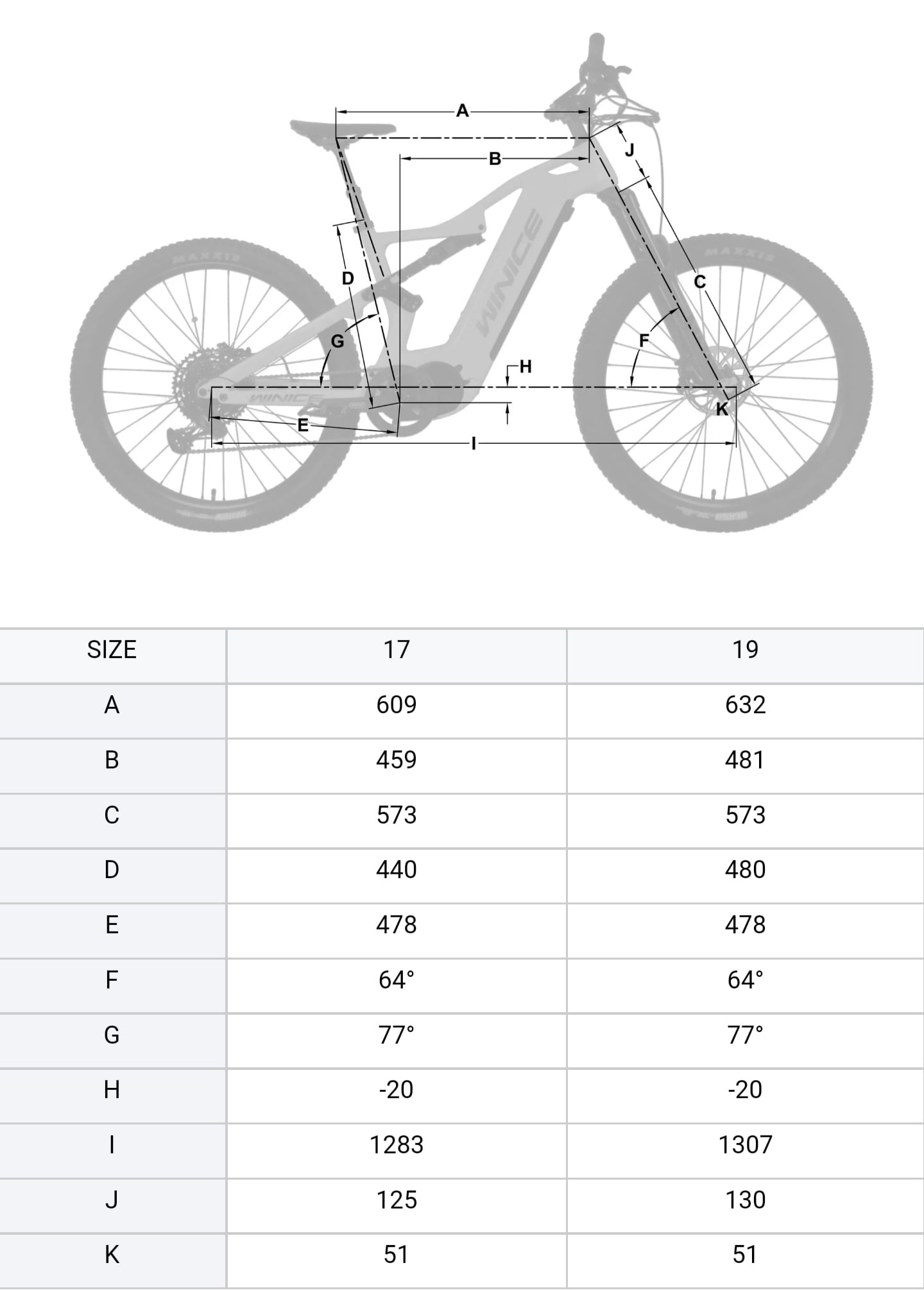

The two latest geometry examples I have posted above are both from well reputable company Dengfu direct. So I think their carbon stuff should hold up well.
Anyone got experience with them?

Dengfu is definitely one of the more reputable companies for frames, it seems to be them and LightCarbon (I have a frame on the way from LightCarbon right now, and it probably would have been Dengfu if they actually had a size L available for the E82) you see the most custom builds with. Although I expect each of them still has their own low/med/high build capabilities depending who they’re supplying and what the customer is willing to pay.

The Dengfu bike would be a great allrounder. Though quite a slack geometry. So more targeted for downhill. But being an E-bike, will XC just fine.
This is a good starting point. You would have very quickly out-grown the other bike.

The there's this:
YT Decoy Uncaged 9 (2022)
Asking £3500. Will offer £2750.
