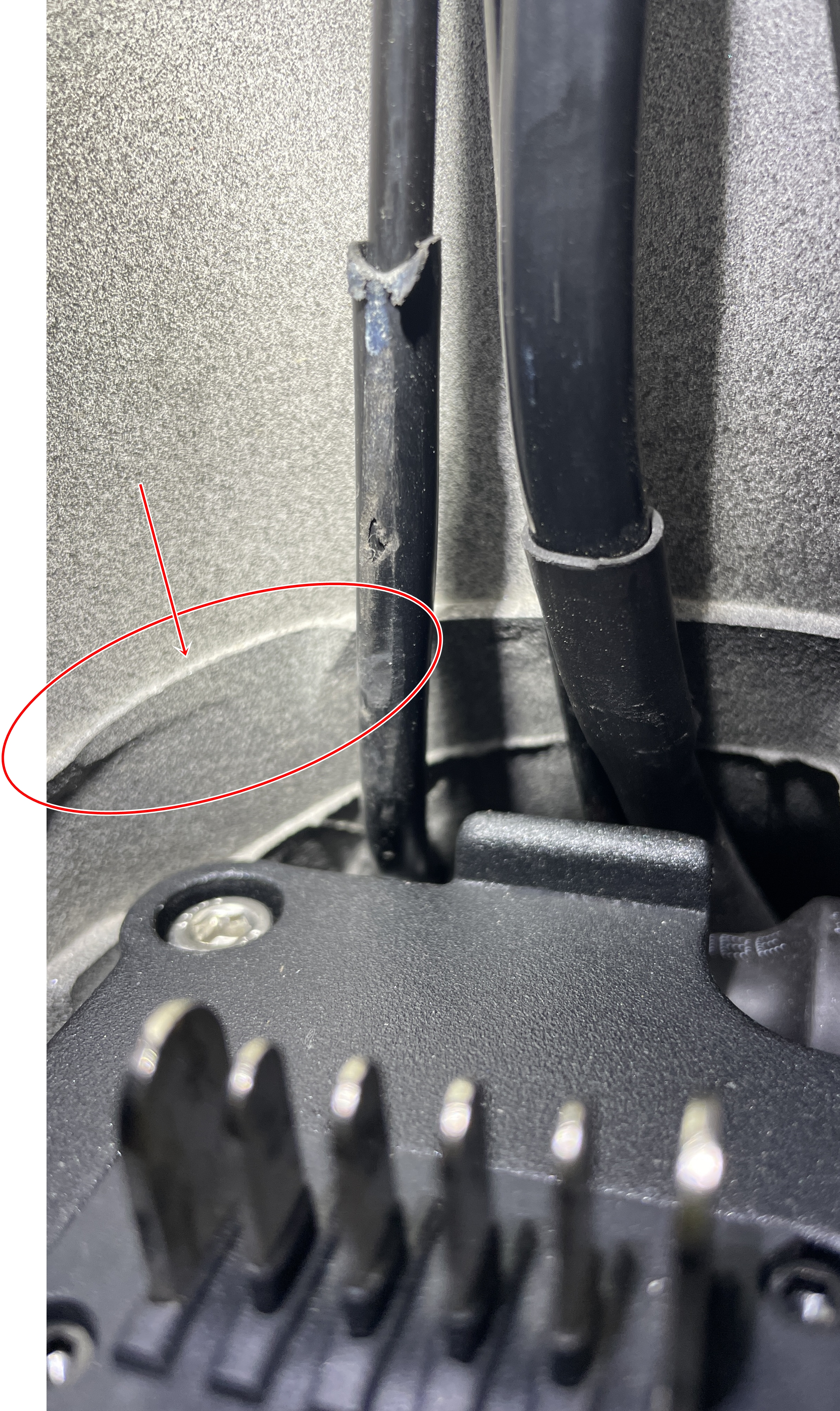

Does anyone with a crack frame have photos from the inside?
Can you see that crack from the inside?
Many people argue that it is not really a crack in the frame, but a crack in the filler that was used on the outside to hide the visible weld.

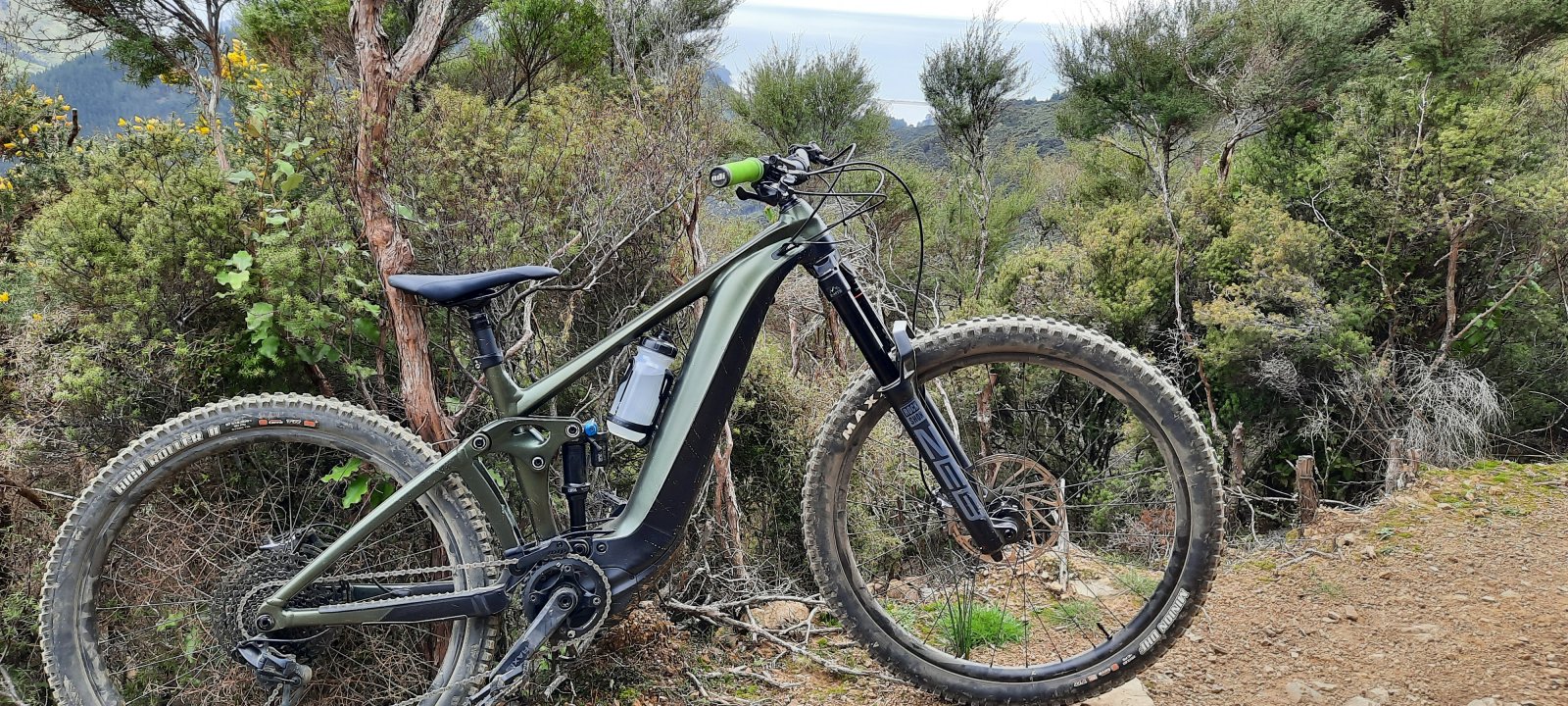

It took 9months for a replacement frame but it finally arrived! stoked to be back on this rig....love this bike

So cracking paint? Filler? or material???
Anybody got picutres from inside when crack be outside?
I you read the whole thread you can see there has been I think only one report of frame material cracking(and even that didn't show pics of cracks from inside of the frame).
It's the painted filler that covers the weld for cosmetic reasons that is cracking. In the 2023 models you can see a weld that isn't covered anymore(learning from mistakes).
From the amount of sold bikes around the world the reports what we see here are a drop in the sea(probably a batch of wrong filler mixture or wrong procedure at applying it).
At least that's my opinion ...✌⚡
Also I think the title of the thread is doing a little injustice to the bike as it's not the frame that is cracking as so far we could determine. Anyone who reads just the title and a few post can get a wrong opinion fast...

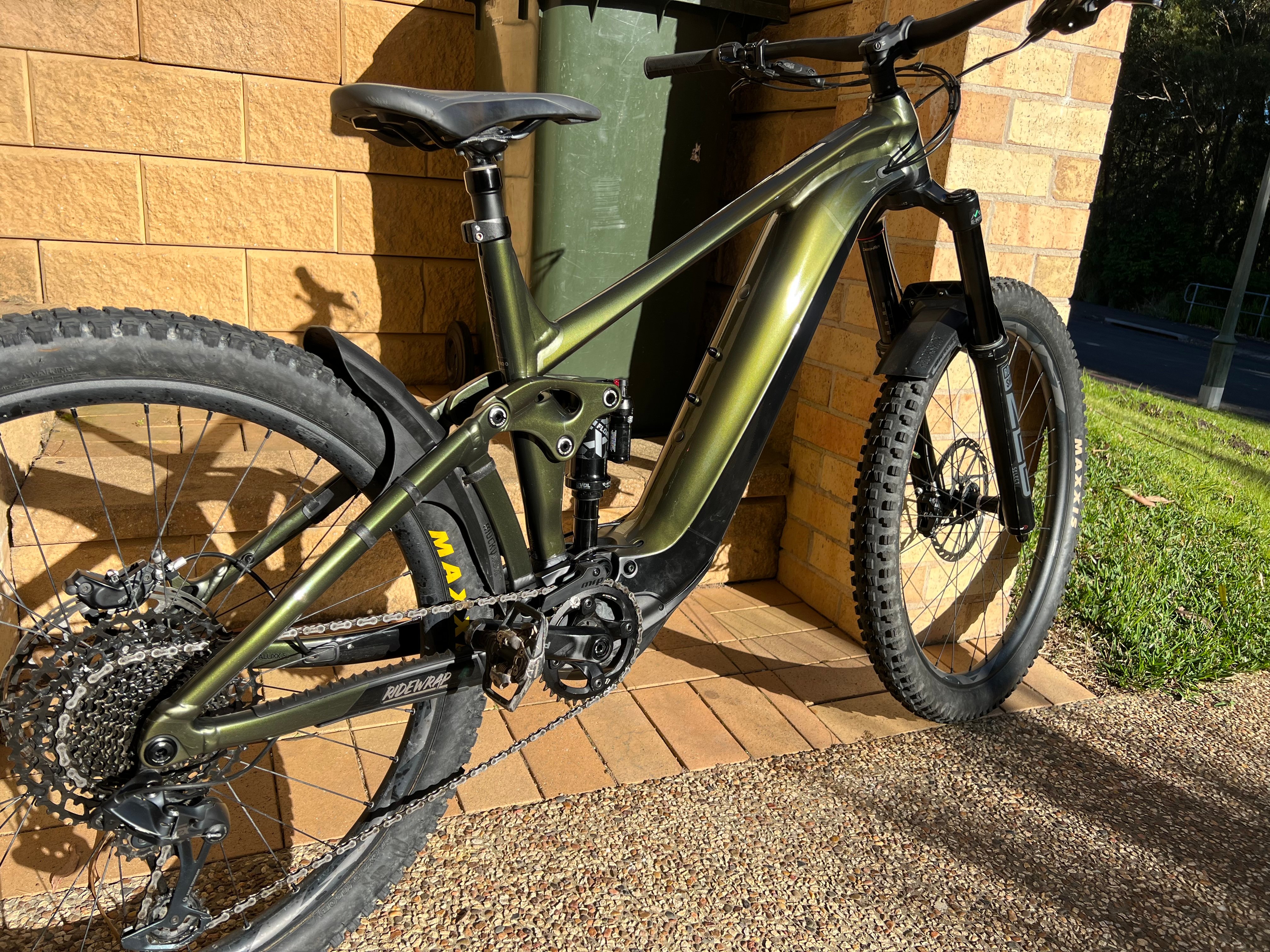

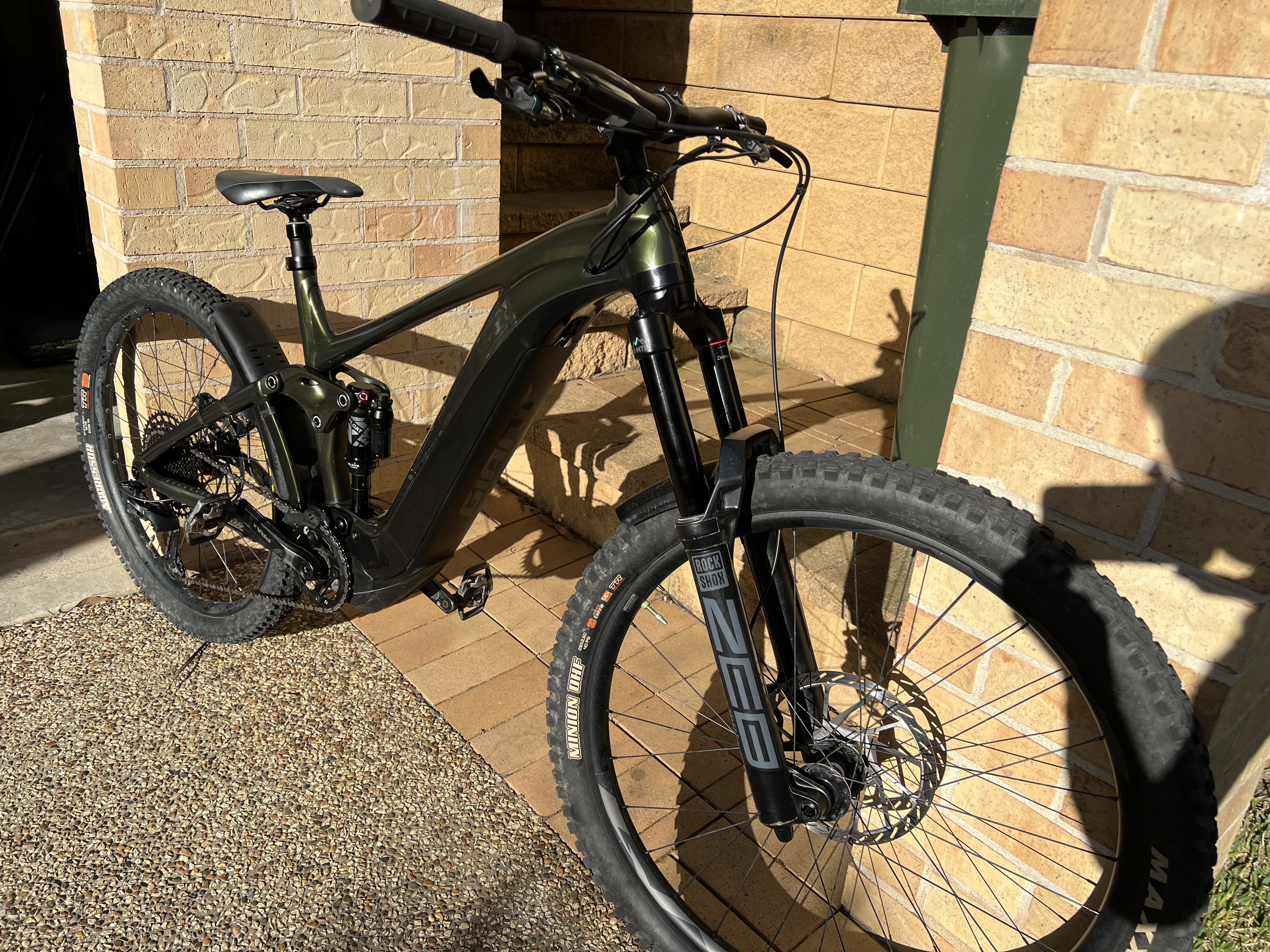

I unexpectedly got a call from my LBS and my frame had arrived! They had originally said November, but then that changed to Jan, and then it arrived right when they originally said. I dropped my bike in, picked up the frame and spent about 4 hours applying a ride wrap at home. The gloss ride wrap looks awesome on it - really brings out the depth in the colour. Dropped the frame back to the LBS and they did the swap over a couple of days. I discovered my crack July 12, and I'm all fixed on a new frame November 4 - just under 4 months. Not too bad I reckon. The LBS have done a great job putting it all back together and it looks mint!
58F1613D-7600-4DFB-B2DB-395077C204BE.jpeg 42BD3A2B-7EF1-4599-A636-0B4B4945573A.jpeg

kadlefkas After what mileage did it start? Have you bought a new or second-hand bike? A very strange place because this crack is not where it was welded. What does the right side look like from the inside?​
i have 1200 km on it , i bought it new before 1 year .the right side is not visible, the crack is somewhere there
Kevjob51
May 22, 2022
120
84
Colorado
That weld is covered with filler material on the other side of the frame which is what is cracking not the weld itself.
The weld on new 2023 models is exposed and not covered with any filler as I assume it was because of the failed filler on some of the 2022 models.
Contact your LBS and get the frame swapped out.

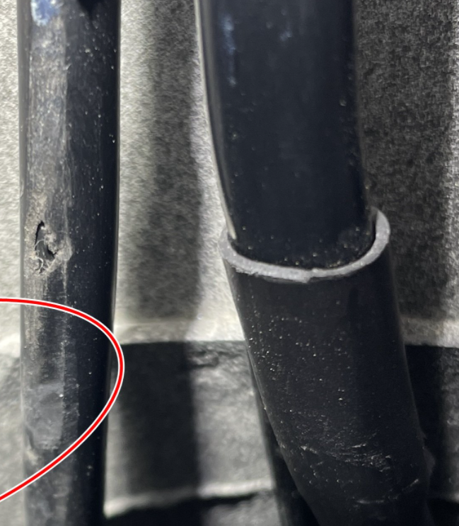

Not directly related, but there's an interesting amount of wear on the sheathing on he left cable and some cracking on the sheathing on the right cable .. If the wear on the left continues you may have a problem so worth re-sheathing/protecting in some way ?

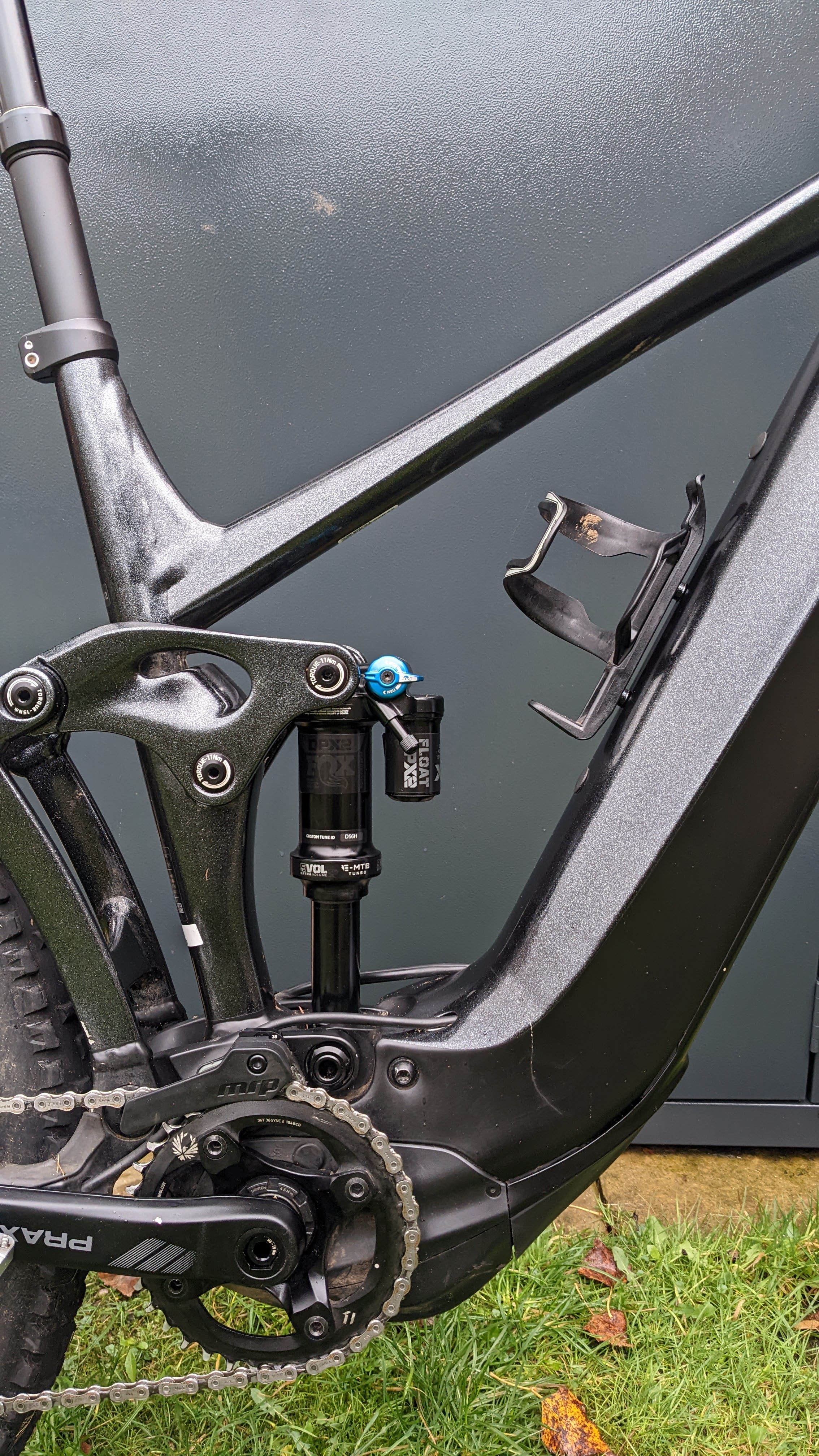

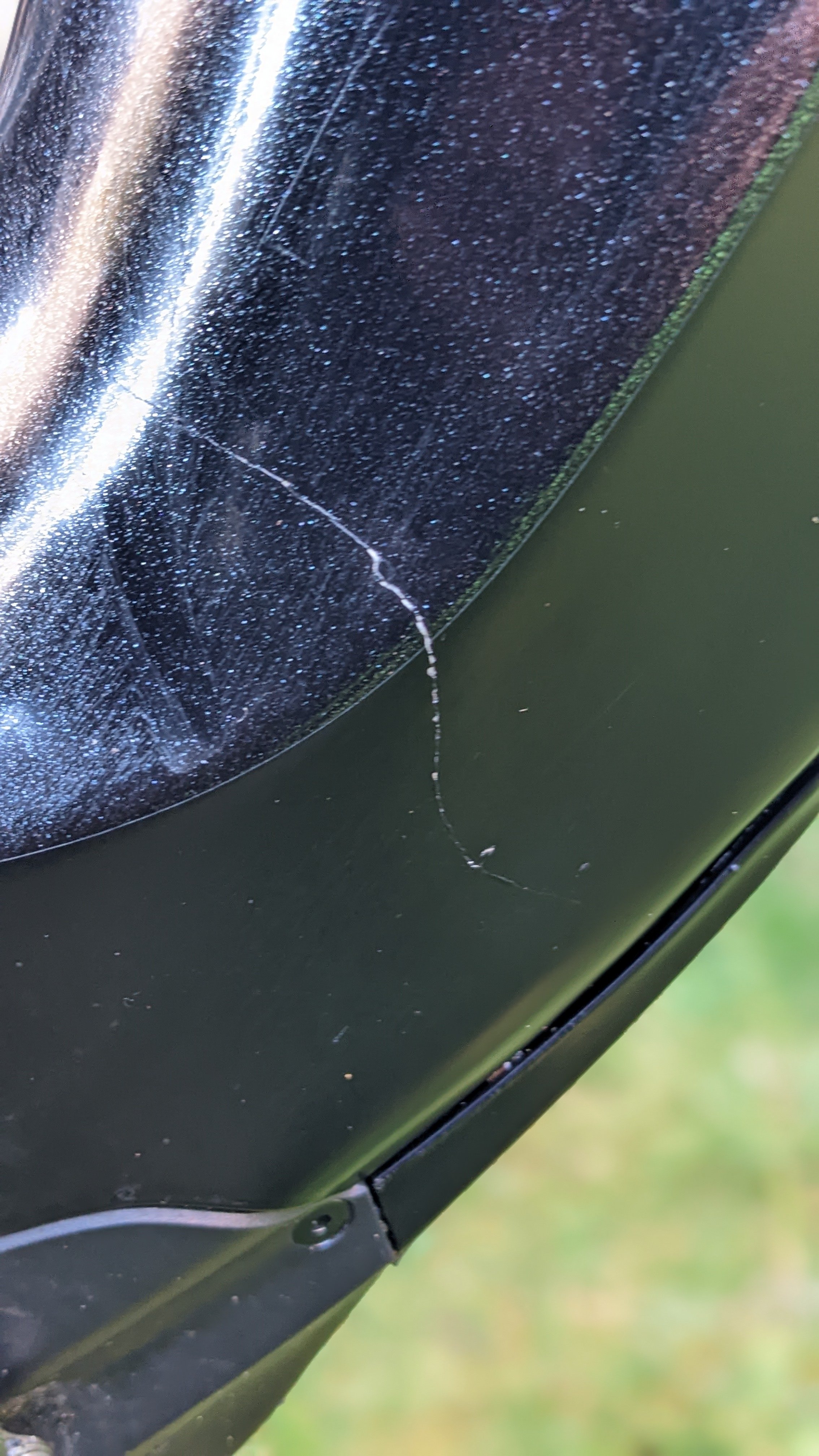

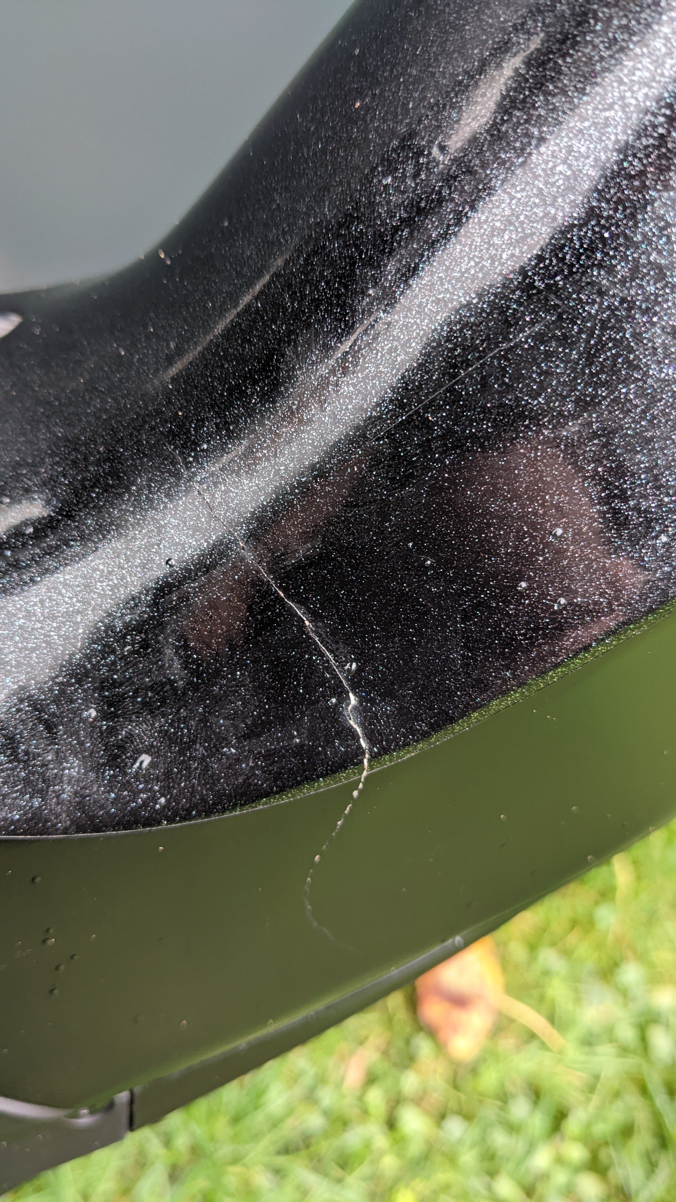

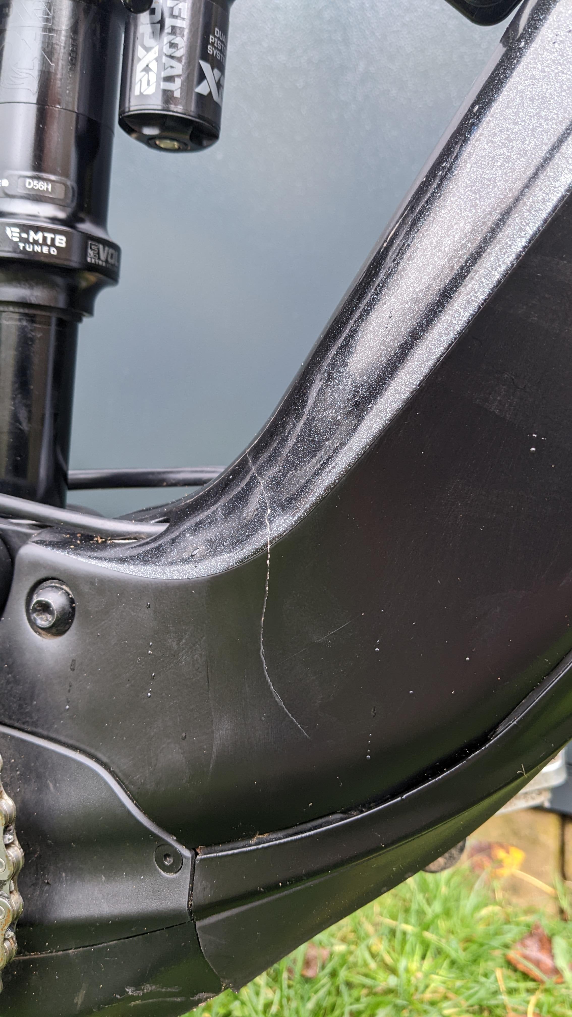

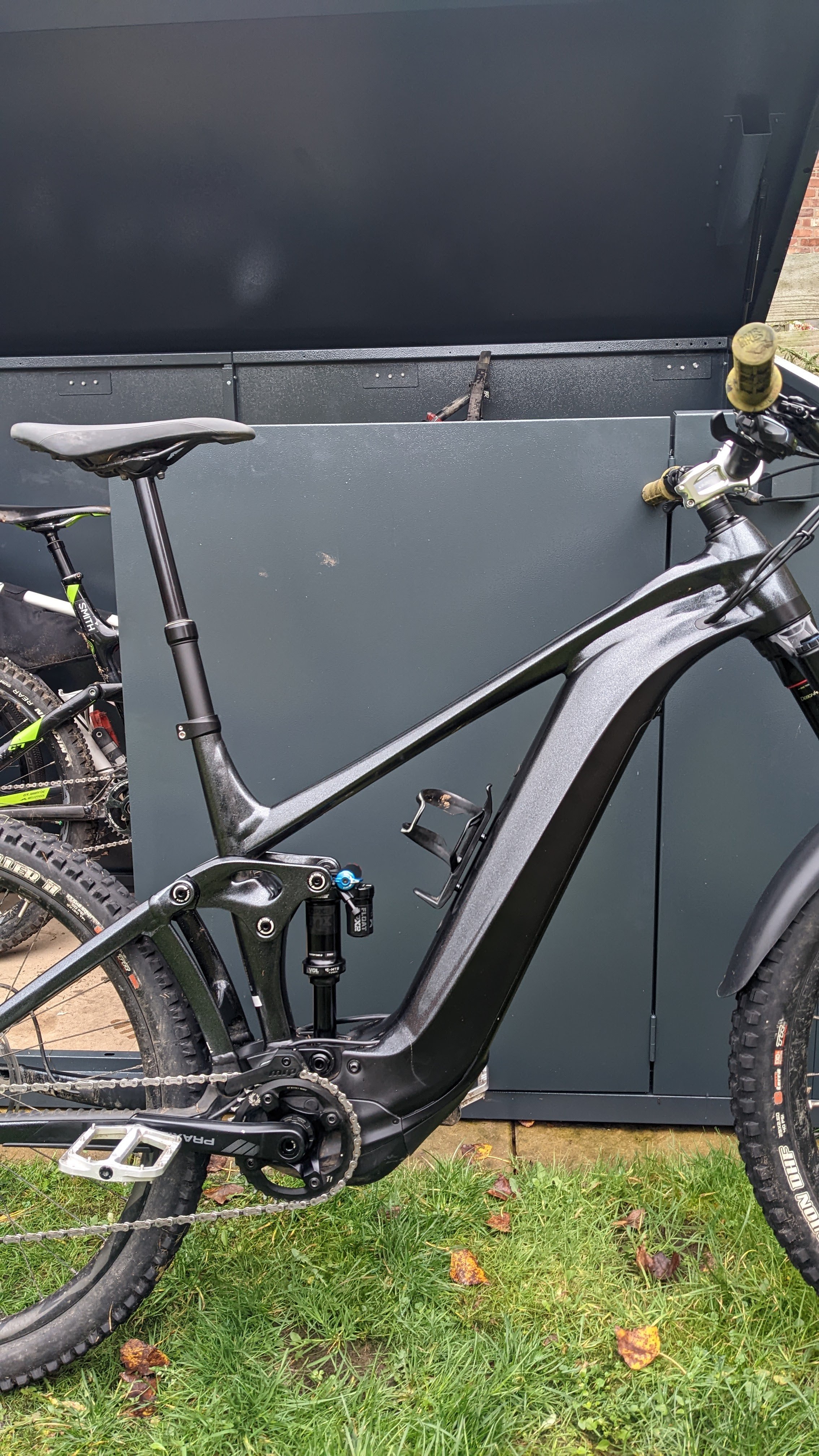

Hi,
First off, I want to say I love this bike and have been very impressed by how capable it is. This is my first eeb and I am absolutely buzzing.
Now to the shit part, after a muddy ride in the Peaks I found this (see pictures) after cleaning the bike, as you can see it’s pretty big!
After worrying for the last few days whether or not Giant will cover it, I’d like to mention how impressed I am in the shop (Rutland) and Giant UK. The service has been top notch!
It took 5 days and a few emails to get confirmation of a replacement frame (Green +0) being sent from Giant Europe, 7 - 14 Days until I have the bike back and ready to rock.
I then googled “Giant Reign crack” and found you lovely people, but unfortunately I also found that it’s a known issue. From what I have read here, it has made me a little worried and a little happy.
I’m half worried that this will happen again with the new frame, but on the other hand it could have been a bad batch from the factory and they have sorted it since?
What's the overall verdict?
Fingers crossed and I will keep you all posted here.
Cheers!
