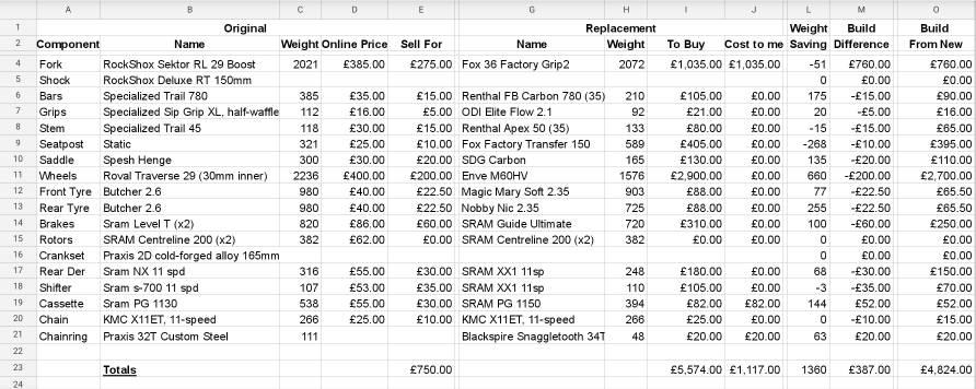

Expensive wheels, tubeless and lighter tyres. Were the biggest loss.
Here's a screenshot of my geeky spreadsheet that shows the weight loss and how much it cost... View attachment 12941
here's mine (or how to make a vitus 2019 E-sommet VR weigh sub 47lb)
What does your Levo weigh now?
and what wheels does it have?

20.9kg in winter setup from memory with pedals. (2x Mary soft)
very nice!
Never understood how we stand for manufacturers claimed bike weights omitting pedals.
I still have a 36t Alu chainring to fit which is a good bit lighter than the stock steel shimano 34t but other than that there's pretty much nothing else I'd swap out on mine for anything lighter.
Carbon bars give me the fear but frames and rims don't. I haven't dinged a single rim since I last raced DH over 15 years back though (I run higher pressures nowadays and rarely take such consequential lines) so carbon rims would probably work fine for me but there are a few non-ebikes here that would benefit from them more if I was feeling spendy.
Love this! I wouldn't show this to your non-biking friends tho #StraightJacket
looks like a dream build!
How is the cassette treating you? All my GX cassette's were shredded by my bike and would skip under pressure. Went with a NX which has much taller teeth, no issues but a heavy block o' steel

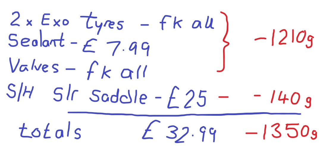

I changed the chainring earlier tonight.
another MASSIVE 20g weight loss right there ;)
the new chainring was a fiver.
I have a titanium SAM HILL stem cap bolt I was given for free in my kitchen I could also switch to save another 6g but i'm not sure my spreadsheet has room for all this data :p
