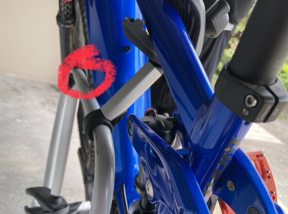

Yeah, unfortunately it's the only way it can work on this carrier. I can clamp it by the top tube, but then it's on a slant facing the car and the down tube rubs on the rack handle.

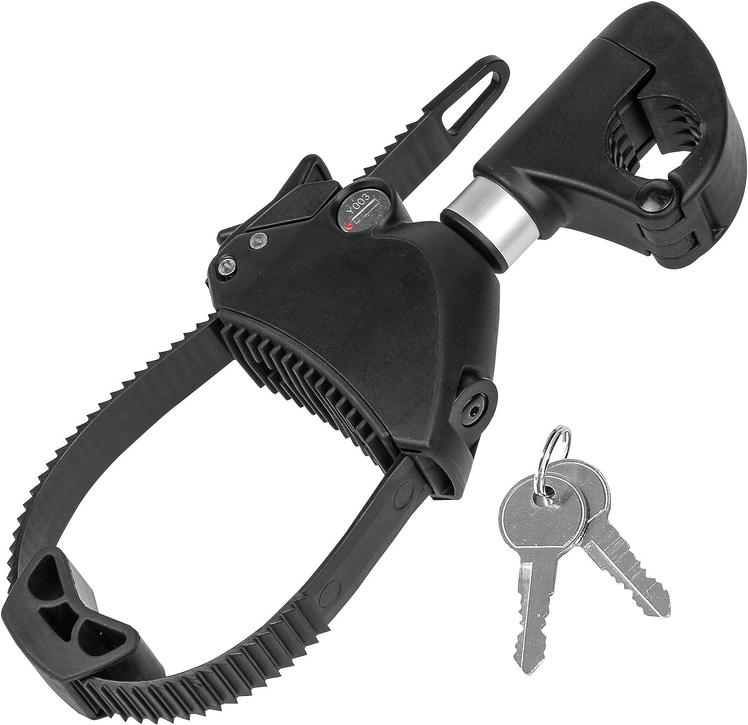

I recommend purchasing a Strap Holder like this one from Eufab and use the seat stray or the top tube
They are available in different length and clamp diameters (depends on the rail of your carrier).
I've replaced all the clamps on my Thule bike carrier and it makes life so much easier.
Is also very usefull if you have a carbon frame ;-)

Maybe just zip tie some thick pipe insulation around the part thats rubbing?
I ended up getting a pool noodle and cutting it up + putting them on. Still rubs and scratches the hell out of the bike but it’s purely cosmetic.
If I could do it all over again I’d not get a bike rack that dangles my bike by the top tube, and rather holds it by the wheels alone. Unfortunately I didn’t research much, just waltzed into the LBS and bought the first thing that didn’t look like a flimsy POS!

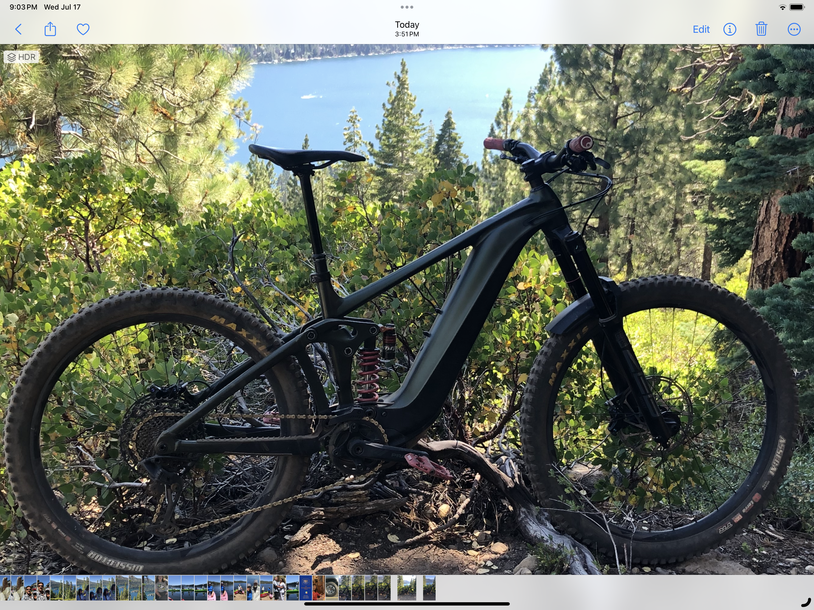

I run a MRP Hazzard with a progressive coil riding weight is 175-180lbs with a 400 spring. Love it I played with it a bit to get it right. I have not touched the settings since.
I ride enduro tracks mostly and still have the OEM wheels with cushcore fr and back I’m getting a set of carbon wheels I’ll ride for more flow/trail riding at the end of season here in Lake Tahoe Ca.
