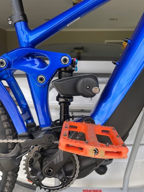

Is it OK to clamp the mtb by the rear shock (pic attached)
It’s the only place I can safely clamp it on my carrier.
