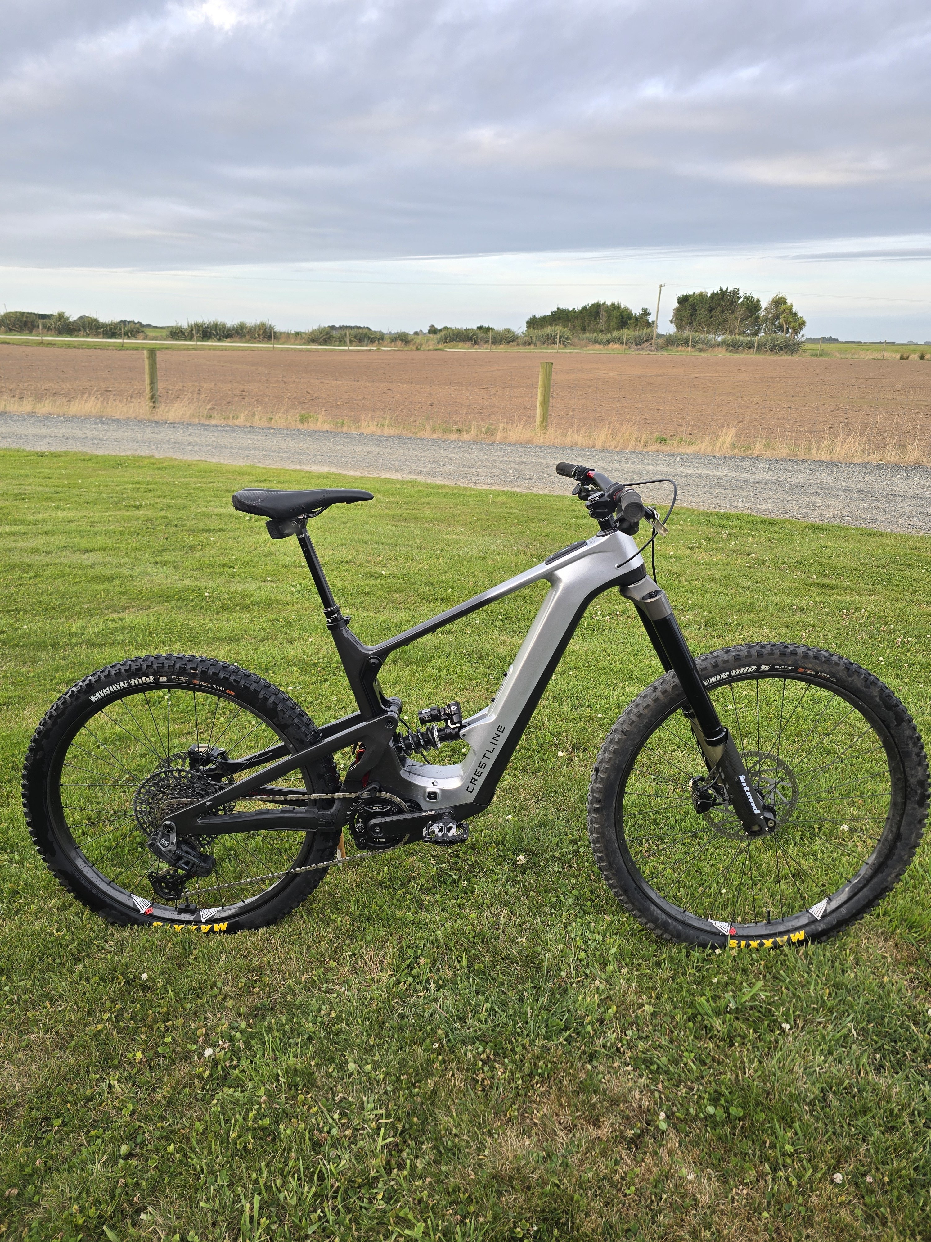

Pretty stoaked on the bike. Weights 23.8kg ish (the scale wouldn't stay still) as it sits here. 600 battery, maxxis DD, coil, fork isn't too bad they're only 50g more than a rxf38 for example) and WAO convergence rims (they are not light lol)

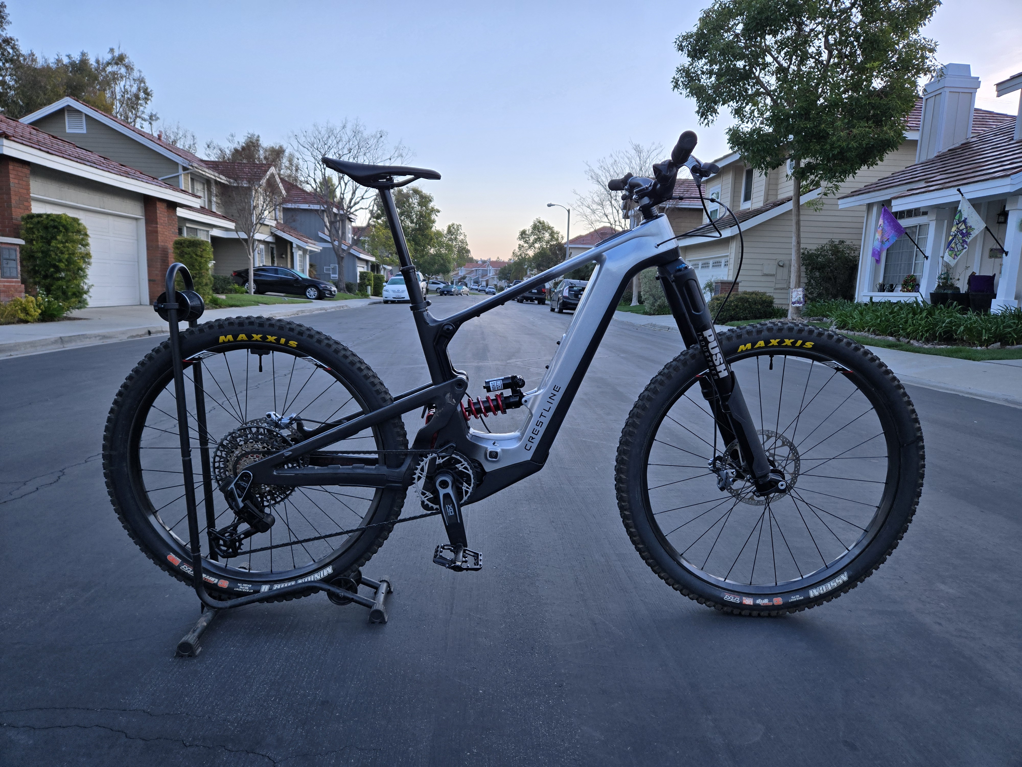

I already started tonight and all cables are already in. Will show a picture soon, will be a sweet and light build for a 180/180mm rig.
