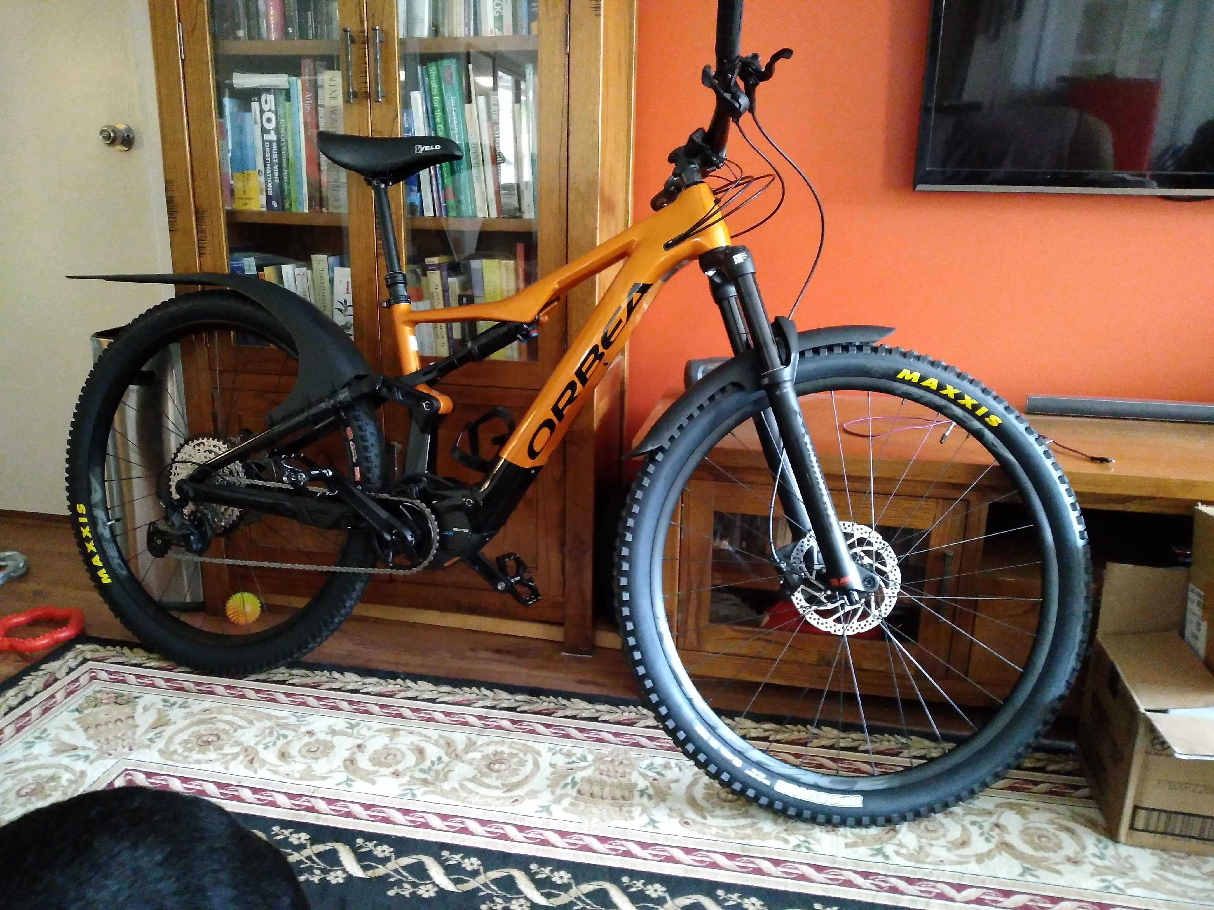

My new Rise H30 arrived and the app is showing 85nm as the maximum torque - I've bumped everything to max in boost mode but haven't been out to the trails yet. The weight as delivered and with pedals added is 20.6kg, about 5kg less than my Cube Stereo 120.

Had my first decent ride today on the new Rise H30 (with 85nm firmware). On very steep hills the power does feel less than my Bosch CX 4 powered Cube Stereo, but I'm still able to doddle easily up the hill provided I pick the right gear; the Shimano motor seems more sensitive to being in the right gear than the Bosch.
Riding the Rise feels a lot different to the Cube Stereo, with the Rise being more lively and playful and the Cube being more stable. The Rise would be better at the bike park but the Cube might be better on steep fire trails (until you get to a tall gate) - gonna take me some time to figure the bikes out.
