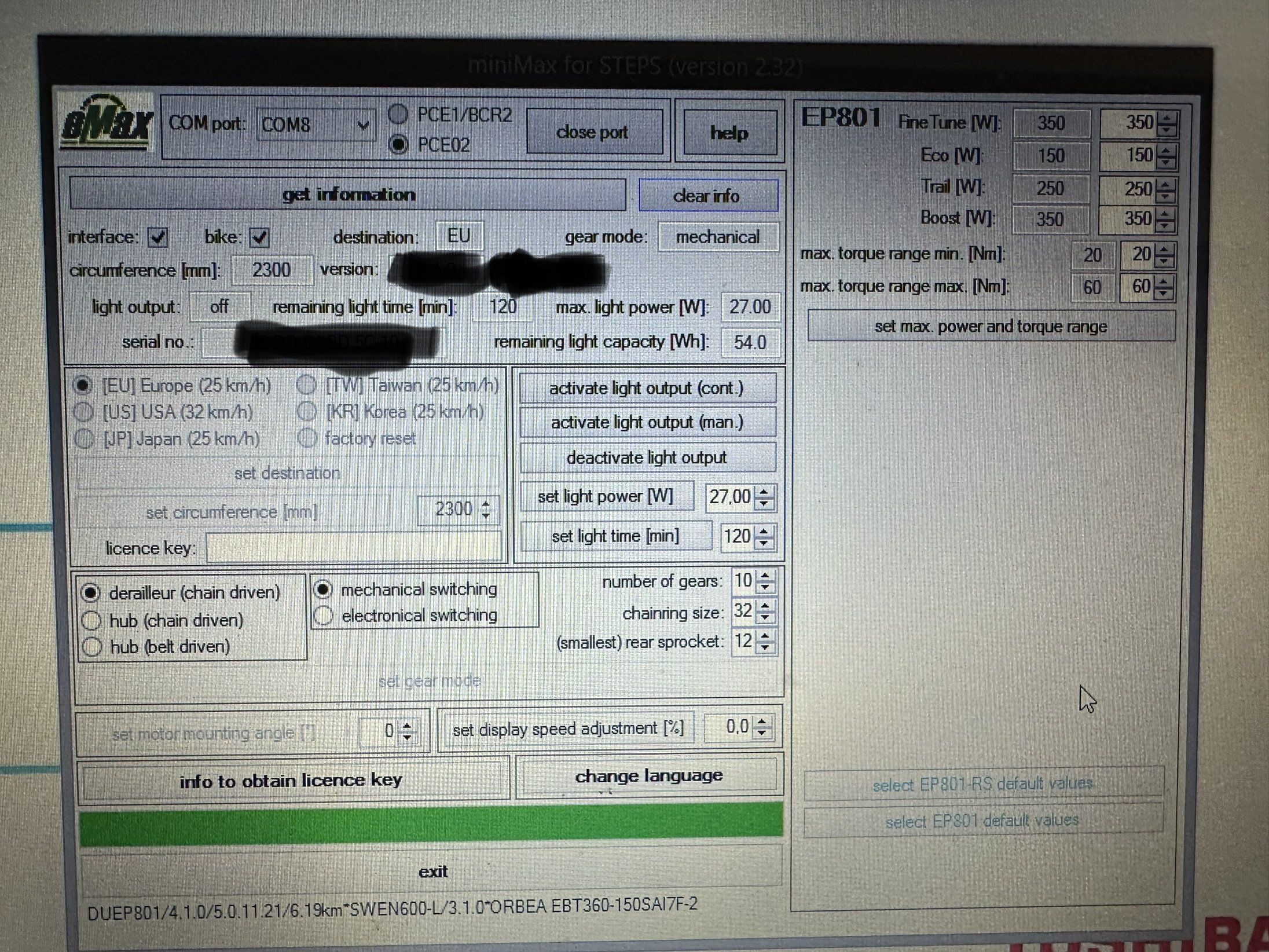

I've been running my Rise 2021 for several months with STunlocker. I've been running at 75NM max and 500W in boost, (lower torque and power for trail and eco). I use a range extender when I go for all out boost rides. I have 1300 miles on the motor like this, no issues. I believe with most certainty that this motor is nothing more than an EP8 with an rs sticker on it and that it was detuned to increase range and keep weight low. This bike is so much fun to ride like this, I've owned about 5 other ebikes and none can compare to this lightweight weight/big power experience.
Please note that the new Giant Trance X E+ (Yamaha Syncdrive pro) and the Rotwild RX375 (Shimano EP8) are equipped to ride this way, both are smaller battery lightweights with motors capable of full power (with option to use full power built-in), so there is definitely evidence that this is already possible in the market, only that Orbea seems to want to control the "user experience", i.e. no negative reviews about range etc. I'm completely able to manage my own battery capacity, thank you.

Hi, why 75 Nm and not 85 Nm?
squeegee
Aug 19, 2019
374
283
Only because didn't feel necessary to take all the way to 85, the power wattage setting feels like it does more for the motor's grunt in general, also bike is so light not sure it really needs 85, but I will try it eventually.

For context : H30 bought in 2022 with aim to upgrade spec from the off. All work done and also bought PCE02. I then used STUnlocker to unlock to full 85Nm but played with the profiles and amended to USA for 20 mph / 32 kph. I did find it irritating STUnlocker licences per bike but que sera it keeps the software dev going... or does it ?
Fast forward to 2023 and lovely wife tried my Rise and wants one !!! New 2023 H30 with EP6 arrives and I did a bit more research after I was told STUnlocker not doing anything for EP6 and found eMax Tuning FREE. With it I connect to the new bike via the PCE02 and it unlocks the power settings via manual input or a handy "Set to EP6" button that put in settings to unlock full power.
Now to get it to 20 mph / 32 kph I would need to again licence but TBH my wife is not needing that added support as she won't go do any knarly stuff.
Point is there's options out there and they don't all have to cost you. I find it hard to believe the eMax guys let you use their software for tuning unlock and provide great support (I sent questions re EP6 abilities). STUnlocker is used and rated by many so you pay's your money and make's your choice....

The PCE02 isn't free last time I checked, that's the most expensive part to making this work. I think the STunlocker license fee is quite reasonable. If all you want is derestriction is much cheaper than options out there for Specialized and other non-shimano motors.

I don't think the PCE02 is needed for eMax. I just happened to have it and find it easier.

I've never heard of anyone able to alter torque and power from a mobile app via bluetooth. To my knowledge is only possible with Windows + PCE02 which happens to cost $200-$300 in the US, totally worth it for what it does for EP8rs.
If someone else has been able to unlock the EP801 with emax without a PCE02 (i.e. via Bluetooth), please post about it here!

Did you actually read the info on the website - they seem to believe it does the torque at least which for a free app is a heck of a thing to offer.
Totally agree on PCE02 - only bit that annoyed me was having to get a Windows laptop as the house is 100% Mac. :D
Yes, and states you need the PCE02 calls it a "cable", so would be free software + $200-$300 for adaptor, not exactly free. Real question is will it work with BT and mobile version...this I doubt.
Derestriction of top speed requires $119 euro license

Right NOW the only way is the pce02

Interesting thing discovered … we have in ep801 4 level of max power 3 for basic mode and 1 for fine tune.
For the rs unit they are set for basic 150 250 350 and for fine tune 350. I am wondering if in fine tune we have an one only level of max power or is Just a max power limitation for fine tune whatever will be the eco trail boost set in basic.
In the full Power all for are set 600watt.

u can unlock 85NM for 1 buck on the app store... emaxmobile app for iphone... the developer recently added this feature for ep801 rs...
unlock speed restriction is not possible yet via the app but it is possible via pc interface
