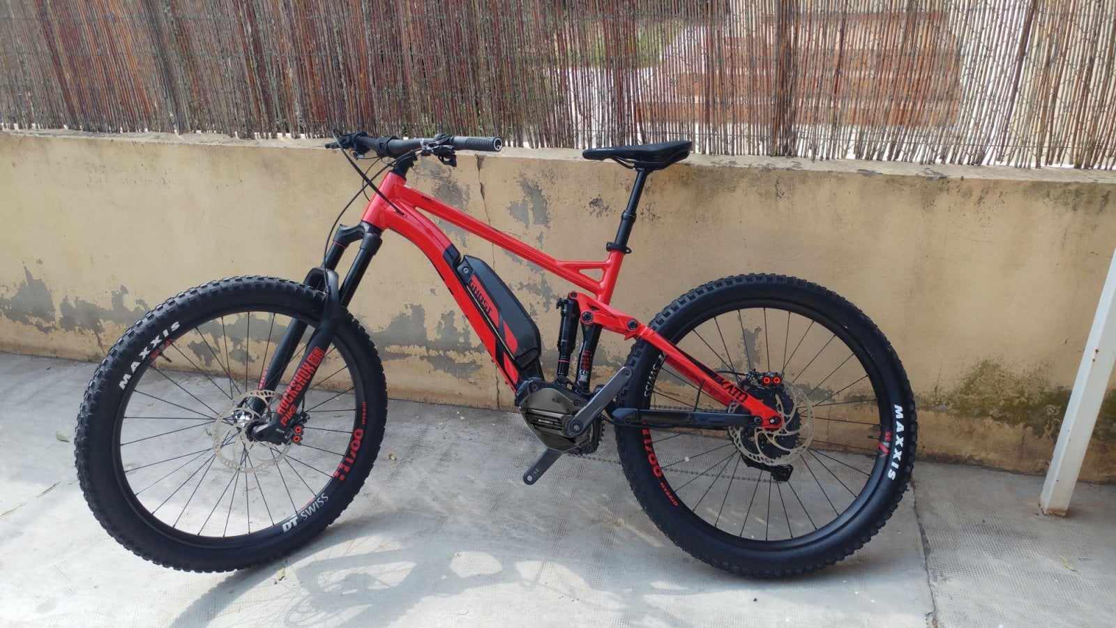

I believe I am the first to retrofit the new EP8 on a bike that originally had the E8000, attached you can see the graphic evidence, ha ha
Well, if in the future the E8000 of my Ghost broke down and I wanted to mount the EP8, then this is how it would look. The result is good, the mounting holes match like a glove with the old ones, and the EP8 front follows better the line of the down tube.
do you think bt e8020 is ep8 compatible too ?
