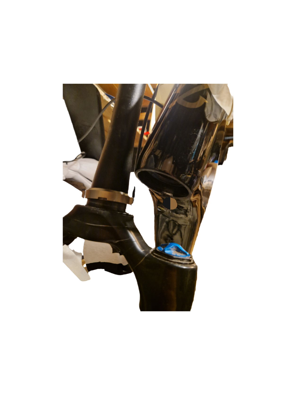

There was a guy on the Amflow Facebook group who had the door come off. He was advised to use a craft knife to reseat the door hinge pin and spring. He reported it was straightforward to do.
I tried to remove the door on mine using the same method but gave up eventually for fear of breaking or scratching something.
Thanks, I remember that post but cannot find it. But I checked hinge with loupes and I see no straightforward way to remove the cover.

Finally I did it. Sharp knife, loupes and trick is to press cover axle inside to the cover on oposite site then spring is. Its Simillar to watch strap axle.

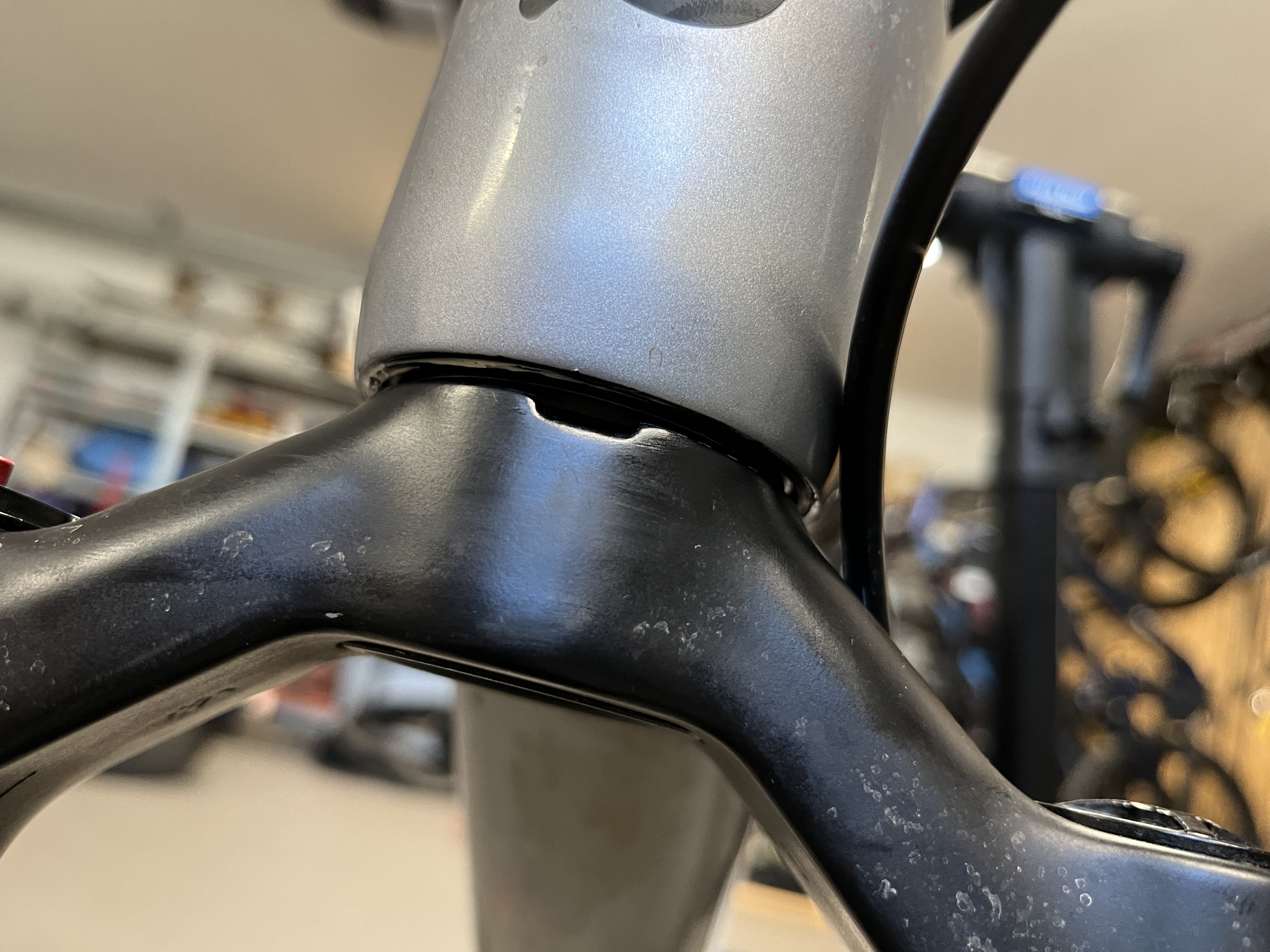

Hello!
It is repeatedly noted that the Amflow frame is quite soft. I'm wondering if it's also the steering lock limiter, which acts like a particularly high cone and means that the head tube is only supported higher up in the frame.
I have never seen something live that before. Does other brands have constructed something siminar?
The cone is also very light and delicate. Would a more stable cone (CNC milled or similar) perhaps help?

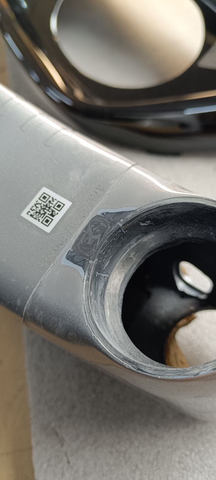

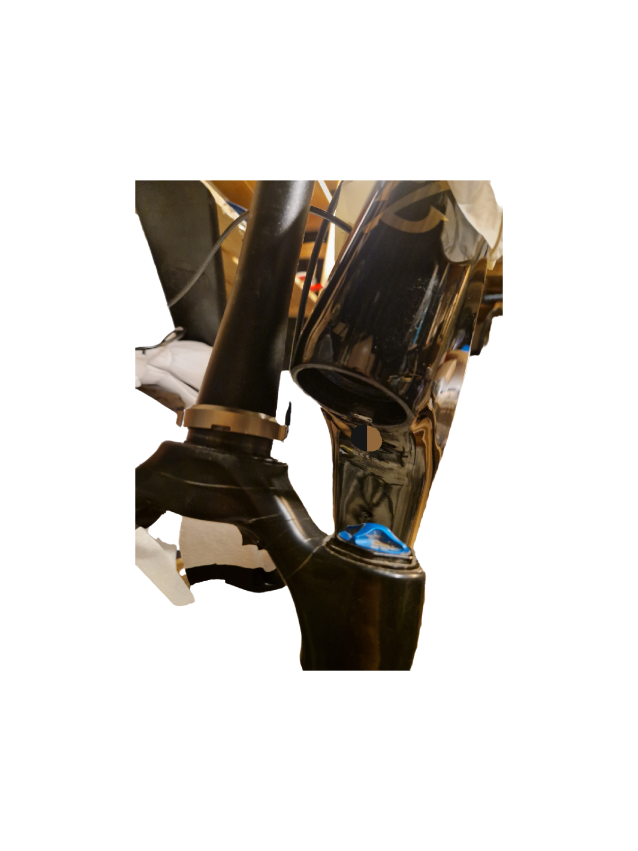

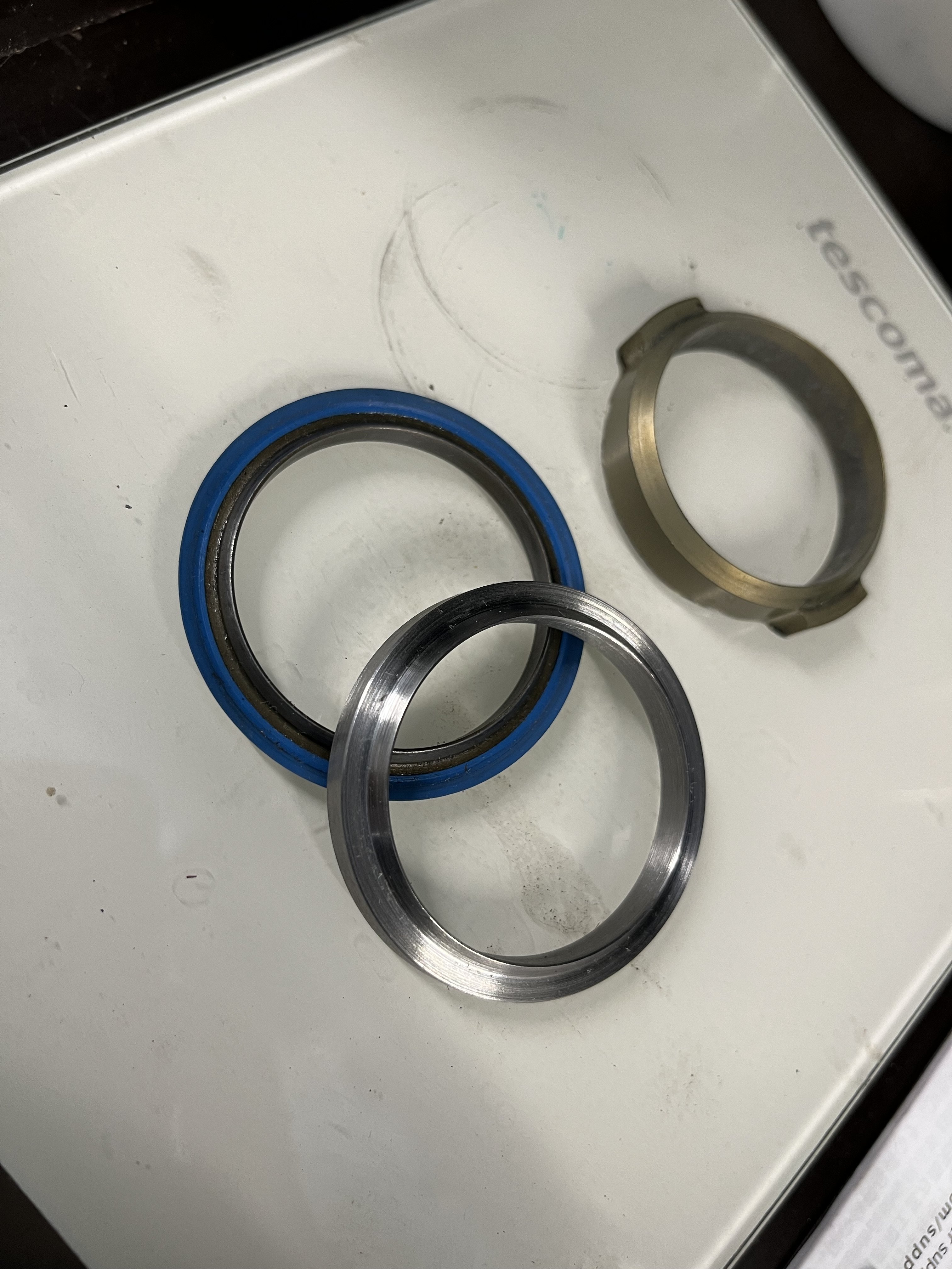

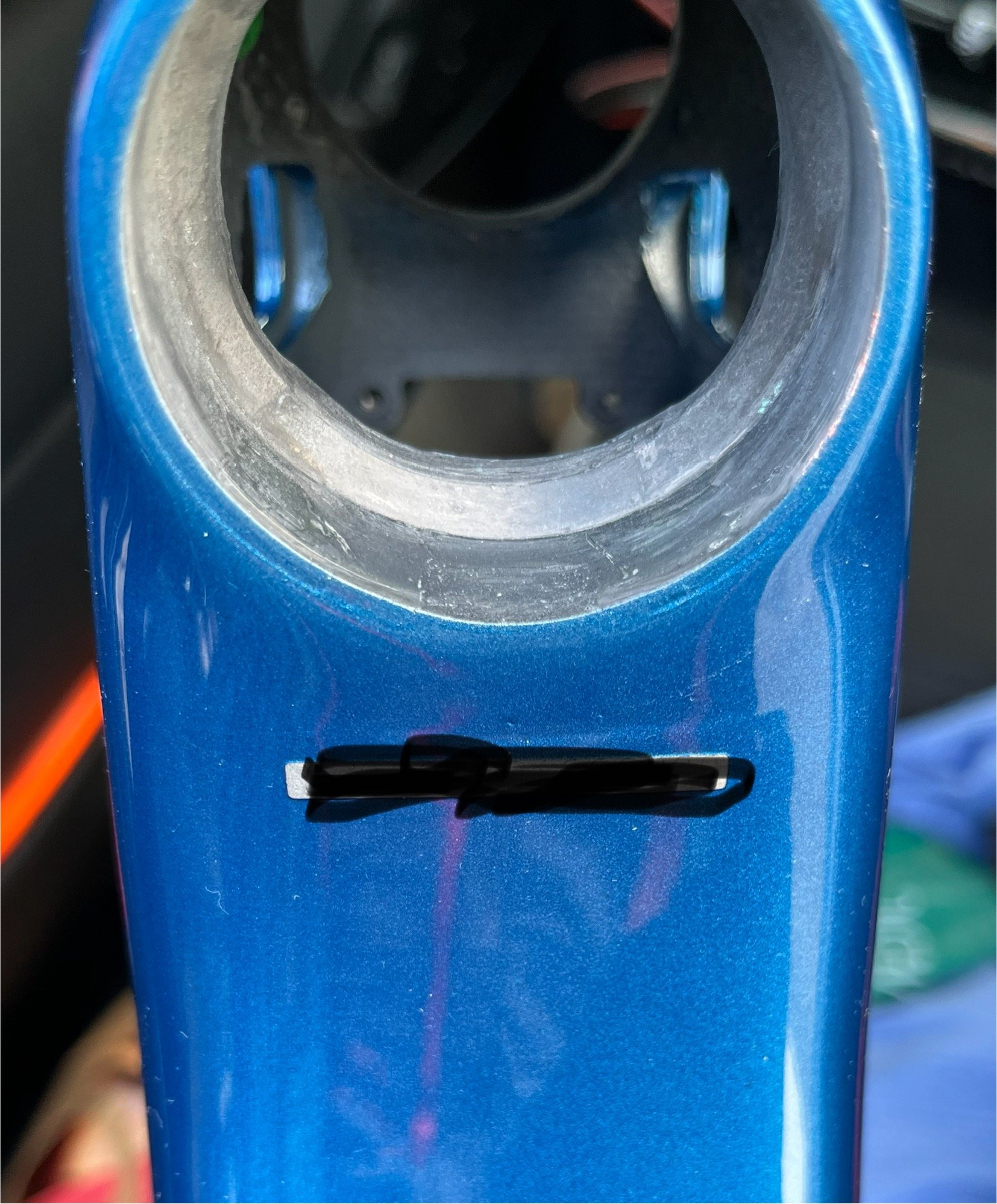

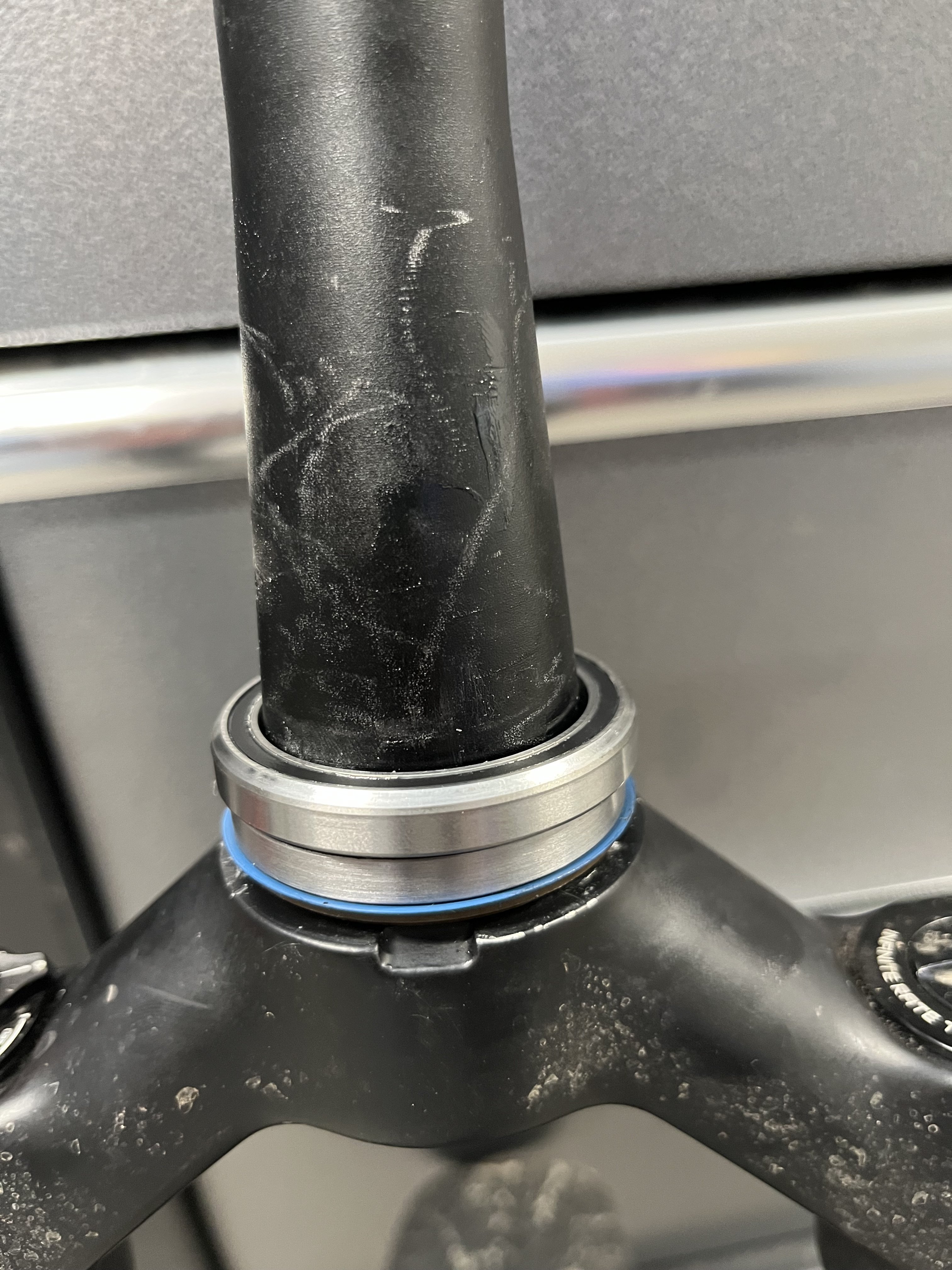

I solved it with custom made spacer and standard race crown. Works well. Hole for knock block filled with carbon before custom painfing. Jobs done.
Advavtage of standard canecreek race crown is blue sealing, now no debrids get inside to headtube to lower headset bearing.

Yes, it's unpleasant that dirt can get in there - but a solution is found to close the recess. What do you think: Is the lower headset bearing, which is set higher as a result, responsible for lower frame stiffness?

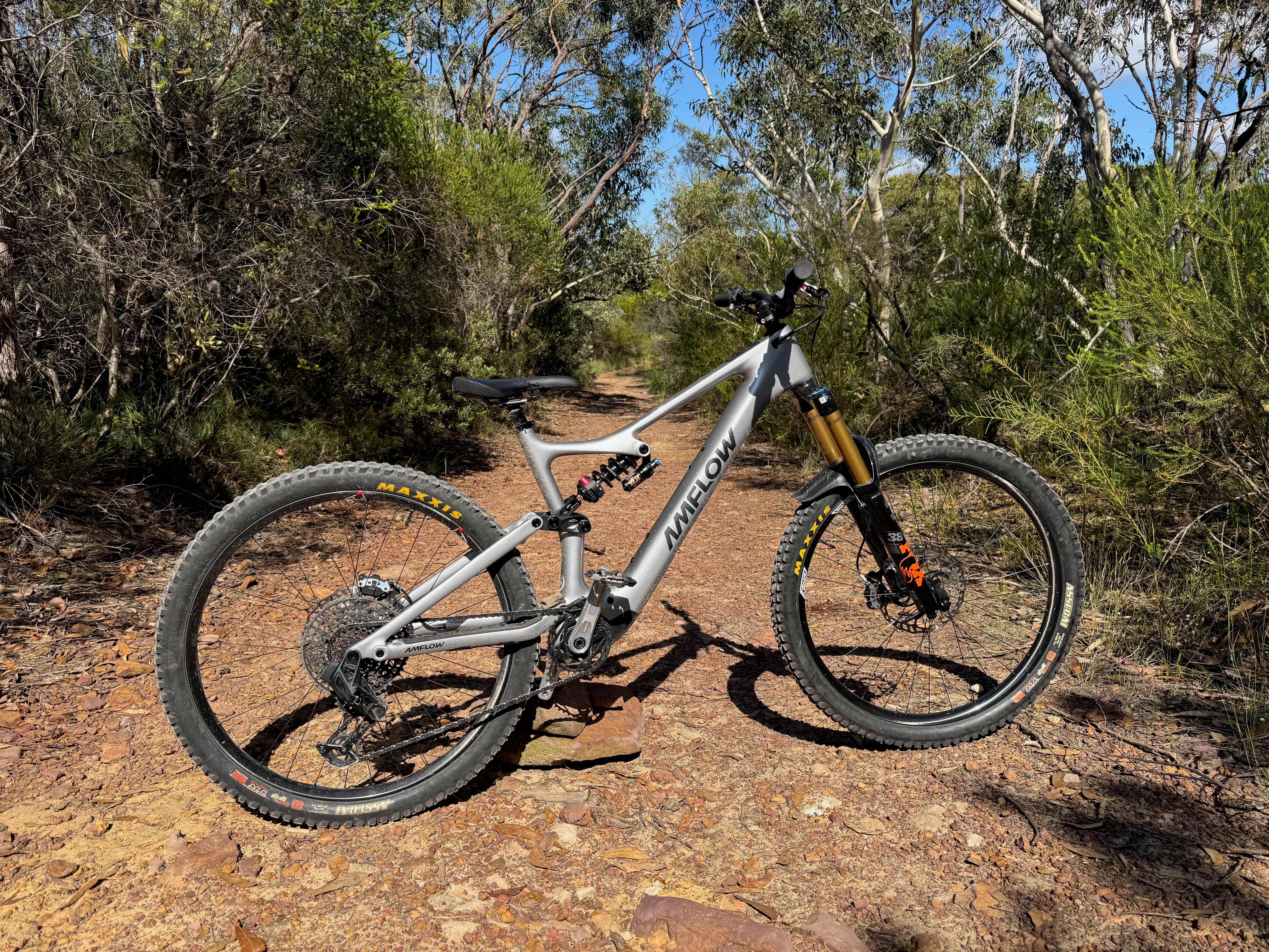

Seems 90% of the posters on this thread with strong opinions on the bike have never actually ridden one. To see what all the fuss was about I bought and built one (from a local bike shop).
Build:
Frame: PL Carbon XL, 800Wh battery
Wheels: tyres: We Are One, Asseggai, DD casing, Max Grip, 2.6 front and rear, 29/29
Shock: 2025 Fox DHX, Sprindex coil
Fork Fox 38, 170mm, mudguard
Dropper: OneUp V3 180mm, Wolf Tooth remote
Bar: Enve carbon M7
Stem: North Shore Billet Overlord 42mm
Brakes: Maven Ultimate, 200/220mm Galfer rotors
Drivetrain: SRAM XO Transmission
Pedals: Saint clips
Cranks: Hope, 155mm
I took it out on its first ride today, to shakedown and tune the suspension. I love Sprindex, makes setup so much simpler. Settled at 650lbs/in rate for my 95kg.
I weighed the bike as above…. Was somewhat shocked to see 23.8kg. The ride was my local. Loose chunky DH style tracks with firetrail connections. Bike took a little getting used to, almost tucked the front a couple of times - this is definitely a trail bike, but is capable of doing anything, as long as you’re careful. I’d heard about the frame flex - hitting a 1.7m drop to flat, the bike felt overly stiff if anything. Despite its heavier than expected weight, it still felt very nimble. It feels a smaller bike than it reads on paper. I am 188cm/6’2”. So far so normal. Good, fun playful riding.
Riding up the hill, the motor showed why it exists. It’s simply ridiculous. My other e-bikes are a 2024 Levo SL and a Crestline RS175. The difference to the Bosch Race felt equivalent to the difference between the Bosch and the SL. I’m not worried about Strava times going uphill, but I got KOMs on three of the four long ascents, and 2nd on the other, without even trying to do so. This was without changing any of the defaults. I rode exclusively in Turbo, did 16.4km with 600m elevation, in 55 minutes. I used 55% of the battery. The value of the power IMO is being able to ride between trails much, much faster than you could on anything else I’ve ridden, and I’ve ridden a lot of ebikes.
So the nay-sayers are right. Apart from the motor and charging, there’s nothing revolutionary about the bike. But of course that’s cherry-picking. The motor and integrations are the best currently on the market. I have zero regrets after my first ride.
Sorry about the somewhat dry read, just trying to get the fact across without writing an essay.

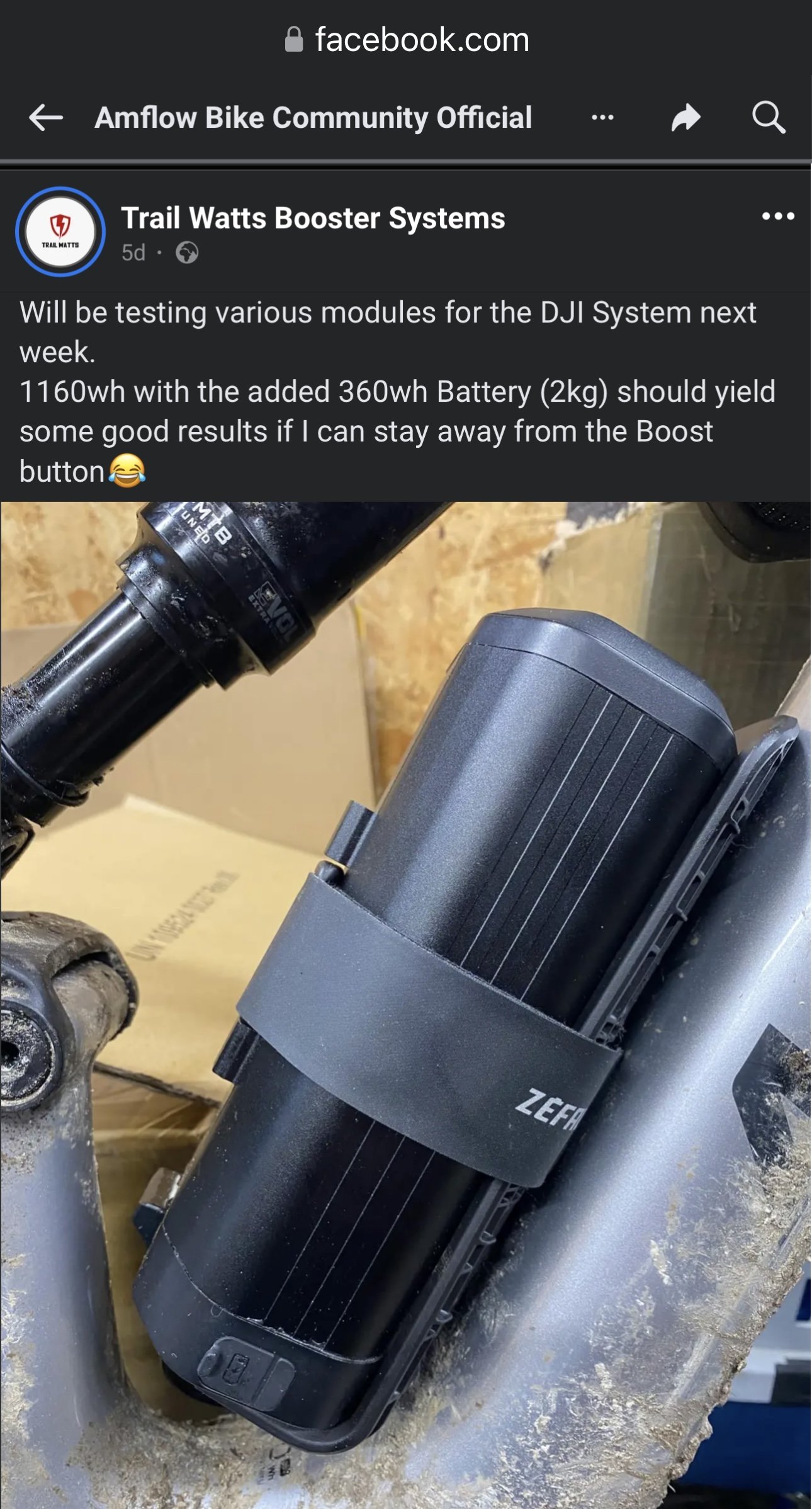

There is a company who are making 360wh range extenders for thee amflow as i follow them on insta, they are called trail watts, they gave a preview of it on insta, they also do an arrange of extenders for other e bikes and are uk based

Beware of the warranty.

It’s been reported on the Amflow Facebook page too. 👍🏽
