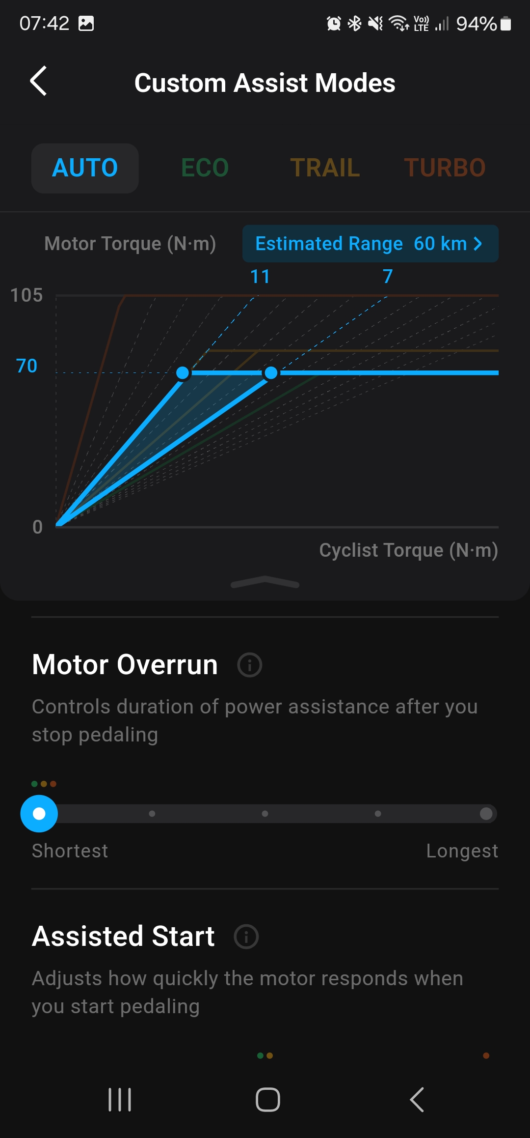

I run mine mostly in auto but I set the band from eco all the way up to trail so it encompasses both, it provides the most natural feel and I get 60km from a full battery. As a result I find the trail setting obsolete.
Wow, that's pretty good. 60 km is 37 miles.
Have you tried an entire ride, on trail?

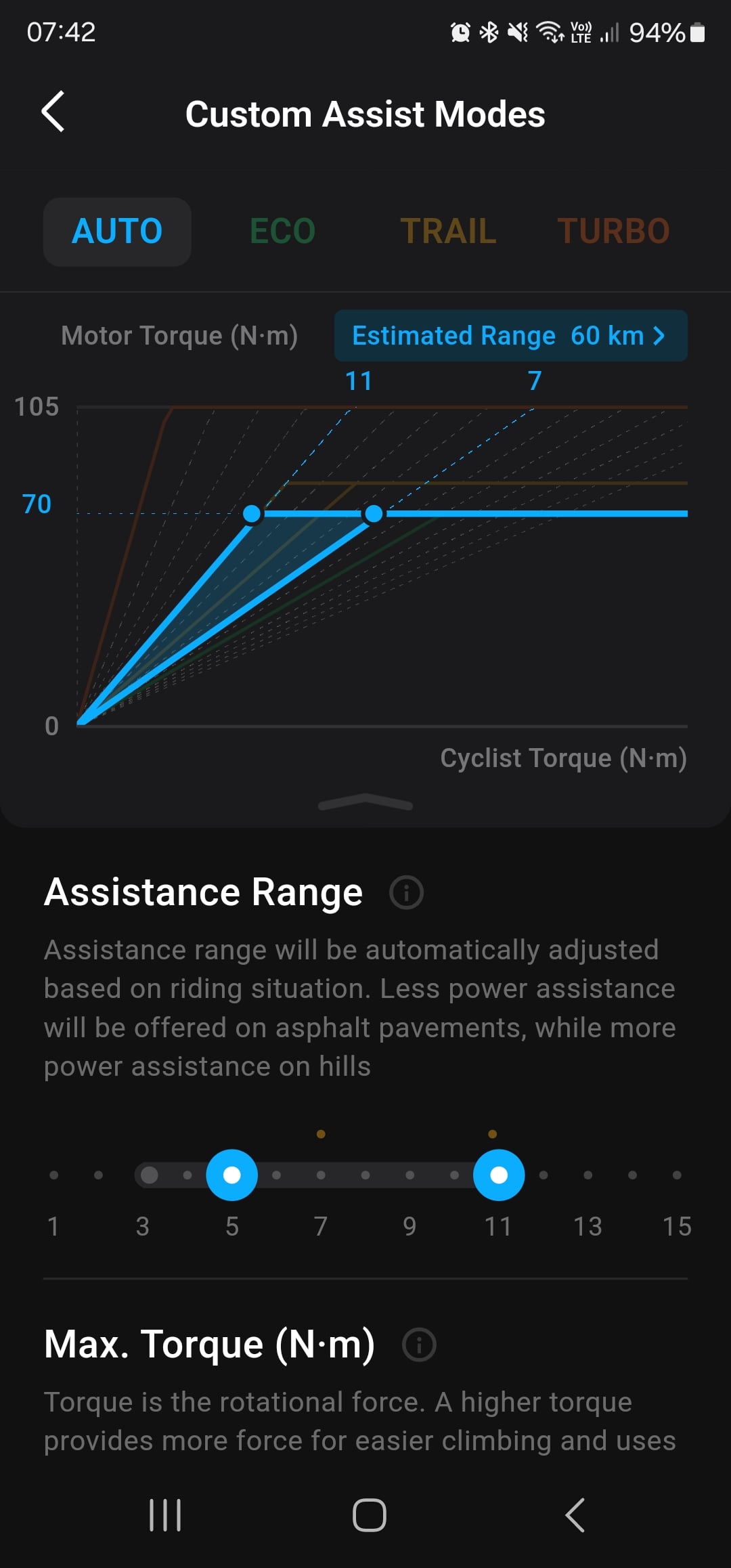

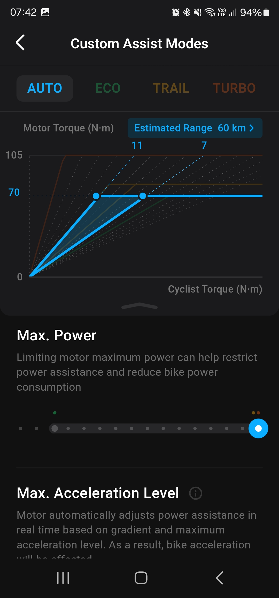

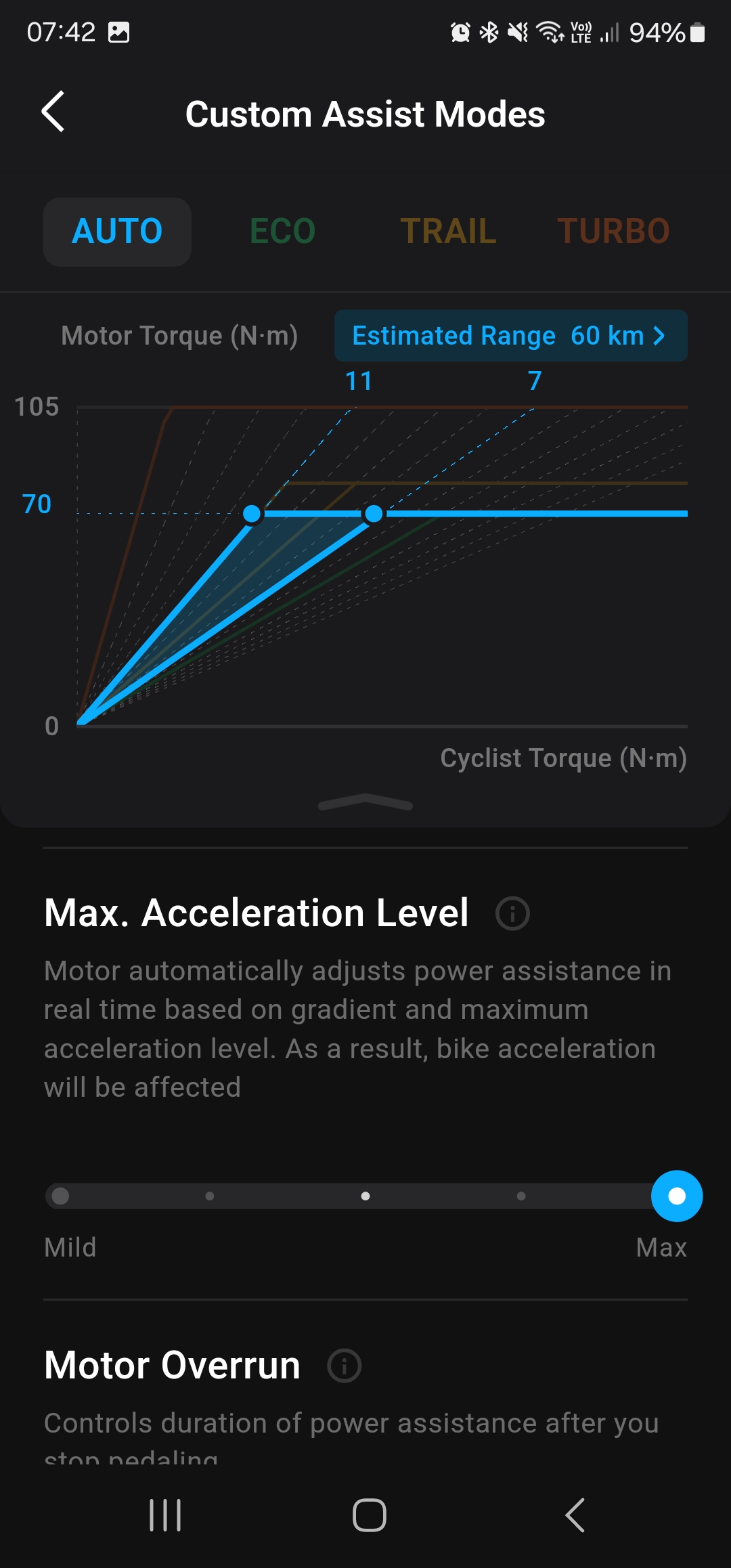

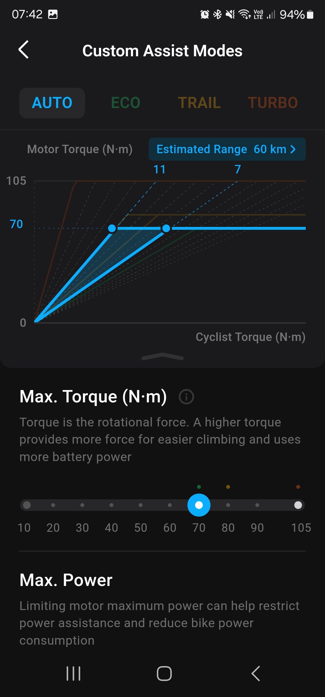

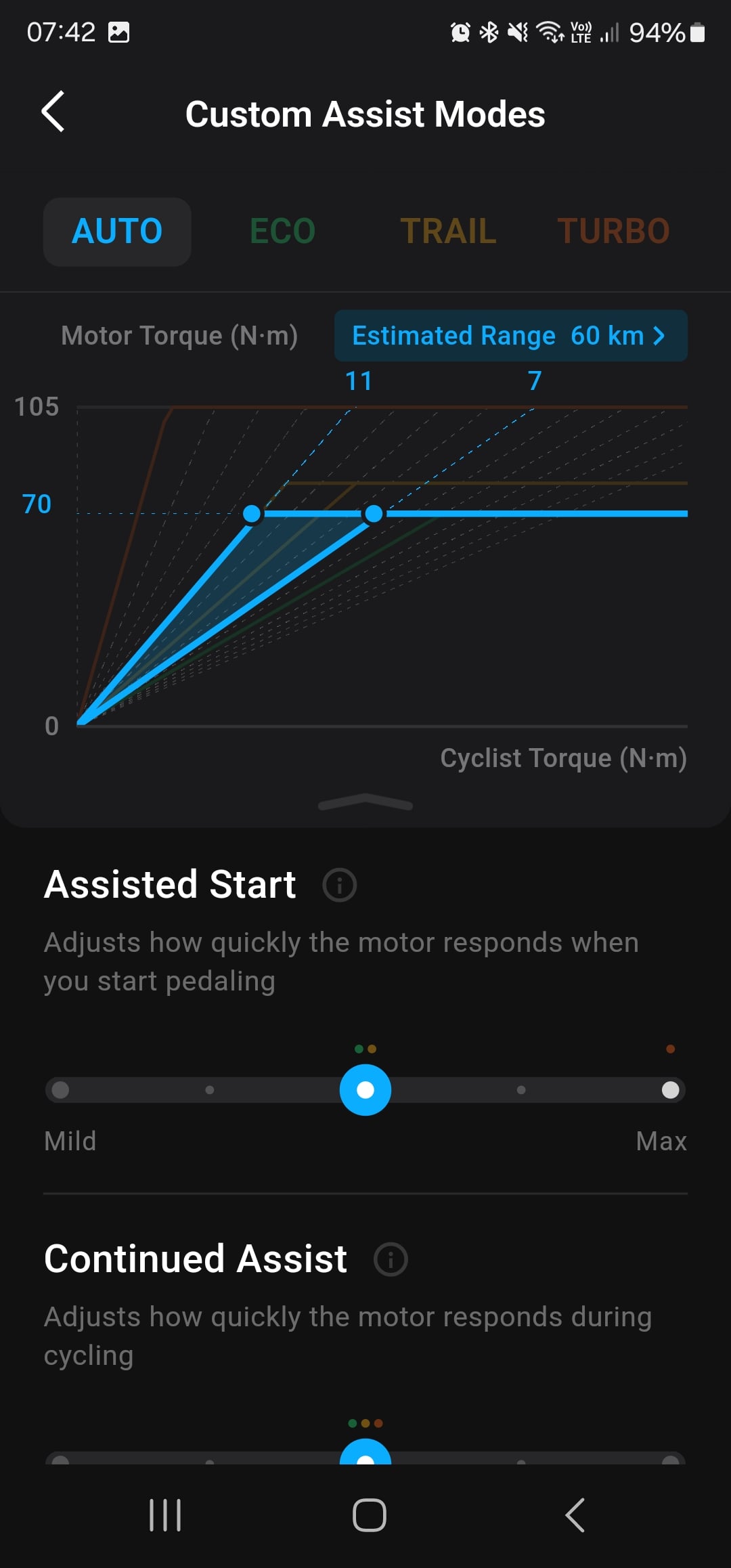

I haven't, I rarely use trail. Auto is enough and if I need a quick boost I use the over boost as easier to long press then to jump from auto to eco to trail then boost.
With the new app the fine tuning of the motor is more configurable so I find 4 modes a waste but that's just me.

It Sounds interesting Would you please post a screenshot of your Auto settings

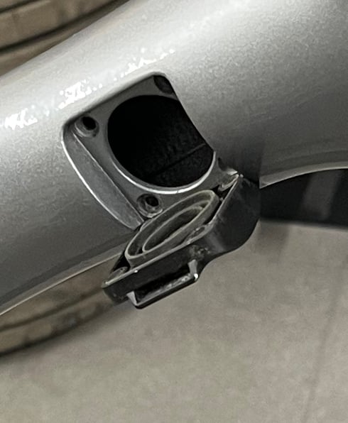

Hi guys. I prepare my silver amflow frame for custom painting. Its already dismantled to frame single parts, only thing I dont know how to remove (and refit after painting) is charging port plastic cover. Any idea how to remove it? Thanks!
nrgbod
Mar 11, 2022
66
56
Middlesbrough
Hi guys. I prepare my silver amflow frame for custom painting. Its already dismantled to frame single parts, only thing I dont know how to remove (and refit after painting) is charging port plastic cover. Any idea how to remove it? Thanks! View attachment 152936
There was a guy on the Amflow Facebook group who had the door come off. He was advised to use a craft knife to reseat the door hinge pin and spring. He reported it was straightforward to do.
I tried to remove the door on mine using the same method but gave up eventually for fear of breaking or scratching something.
I'm too cack handed for anything fiddly , and definitely getting worse as I get older .
