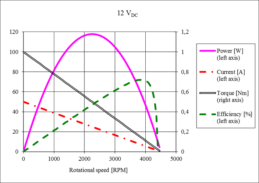

Also a bit about electric motor power and the 250W nominal power limit in the EU, as I see there seem to be some misconceptions about how an electric DC motor works and how the 250W limit is imposed on manufacturers.》》》》
The power output of an electric motor is a complex measurment:
P(Watt) = V(Volt) * I(Ampere)is only true in special circumstances eg when the load is a resistor.
It is not true in cases of an electric motor, whose real output depends on its Q factor, switching control, load etc.
This is because a motor gets pushed around its axle by solenoids, whose voltage across their terminals varies with time, the intensity of the current flowing through it is also a function of time, the output power is also a function of time with more variables than just V (voltage) and I (current Intensity).
Each function has also its harmonics, the resultant P is a complex function and it can be only measured in a lab environment.
The power is usually measured while the motor reaches its thermal equilibrium in a room at 25°C. Then there's also the factor of internal transmission that needs to be taken into consideration when looking at the final crank output numbers, if you look at some test diagrams from a german test lab the real crank Nm outputs are far lower than the speced motor are...
Also as I see a lot of people are confused about the 250W Power limit in EU, I did a little bit of online research about the European legislation EN15194, it is the standard that is most commonly applied, so maybe the bottom description will clears things up why such differences between brands.>>>>
There's effectively no limit in the European legislation EN15194, which It's all about the words and test methods, neither of which pin it down. The rules are that the manufacturer must not label the motor with more than 250w and a motor with a 250w label mustn't overheat when running at 250w continuous. You have to be careful about terminology and calculations. If you have a 20 amp controller and a battery at 40V, you can take as much as 800W from the battery, but at the low speeds where the controller will allow that current, efficiency will be as low as 25%, so the output power will only be 200W. When the motor is spinning fast enough to reach its 80% efficiency, the back EMF from the motor cuts down the current, so the maximum current from the battery might only be 10 amps max, so output power will be 10 amps x 40v x 0.8 efficiency = 320w.
From the attached diagram it can be concluded that the maximal torque of the motor is at very low speed. This is advantageous because it gives very good starting behaviour, but also means
high values of the current and the efficiency is small. So we have to deal with heating problems. The power reaches its maximum at the midle value of the speed, but here the efficiency of the motor is still very small and the problem of heating still persists. The highest value of the efficiency is at 4000 RPM close to the maximum value of the speed. This could be a good operating point, but here both the torque and the power of the motor are rather small. There are also some mechanical constrains to be taken into consideration. The shaft speed of the DC motor is 4000 RPM. This corresponds about an 80 km/h speed of the vehicle if the shaft of the DC motor is connected directly to the shaft of wheel. At a such kind of speed the power need to drive the vehicle would be much higher than that DC motor could deliver, that's where the internal motor transmission comes into play.

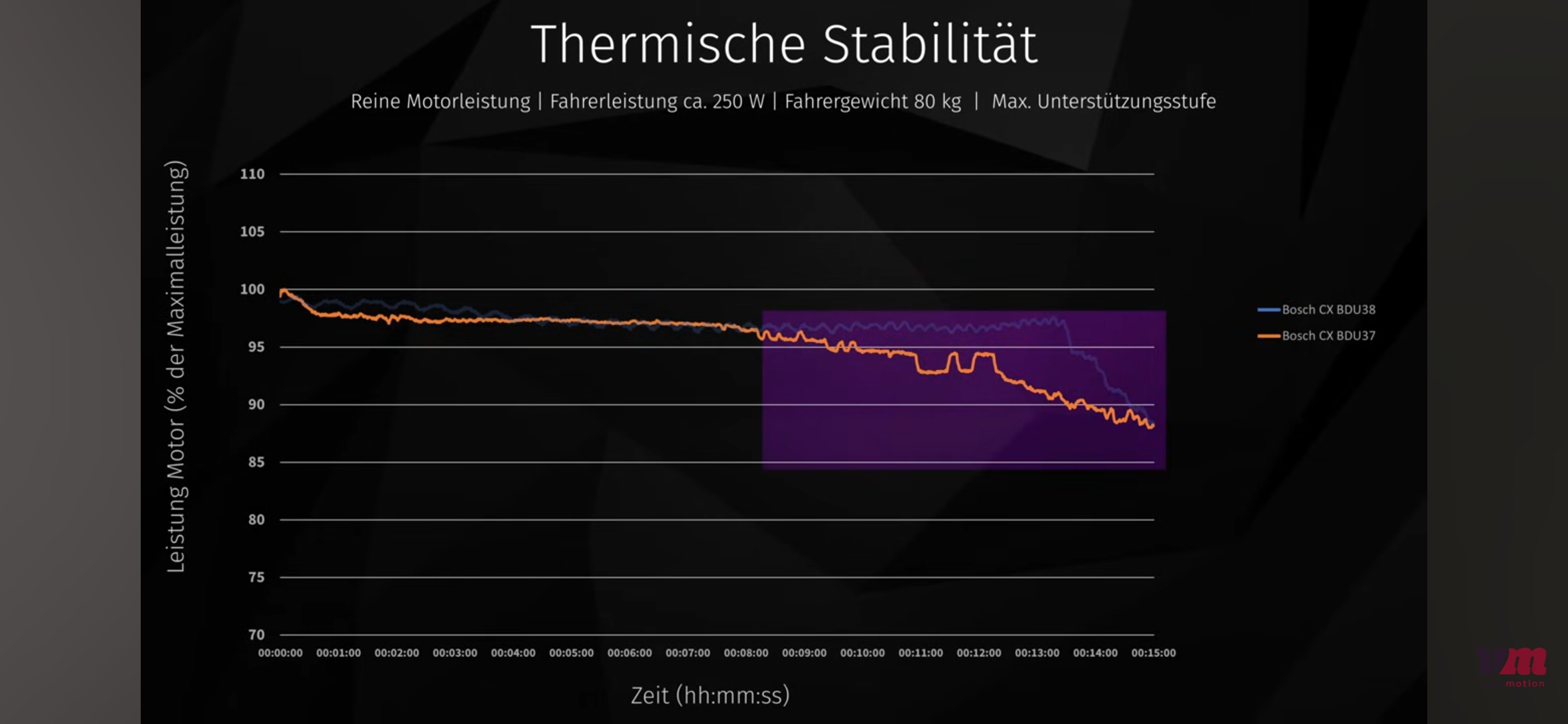

Just out ofcuriosity as these things interest me, I am still waiting to see what a real lab test of the Avinox will show...the mass of the motor is small, so thermal stability is a question here...
Everyone thinks the new Bosch BDU38 is a miss, I don't think so, I think this motor is just a base for the next step.
The most interesting improvement i think is that the Bosch gen5 has a significant improvement in the thermal stability area, it's thermal stability was high before but now it's really high and longer lasting as can be seen in this diagram.

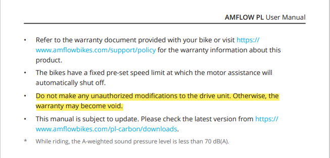

What we don't know is if de-restricting will affect the warranty like it does with bosch and Shimano.
This is the other thing. If you want to re-restrict, you must be prepared to lose your warranty. I can get a brand new EP801 motor for AUD$1200, which is £600, from a store 10km from my home. So I'm happy to pay that if the motor fails. Cost of doing business.
Who knows what a new DJI motor will cost ? You can't even get a price, let alone trying to find and get one from a distributor. So there is no chance I'm tampering with the motor.
