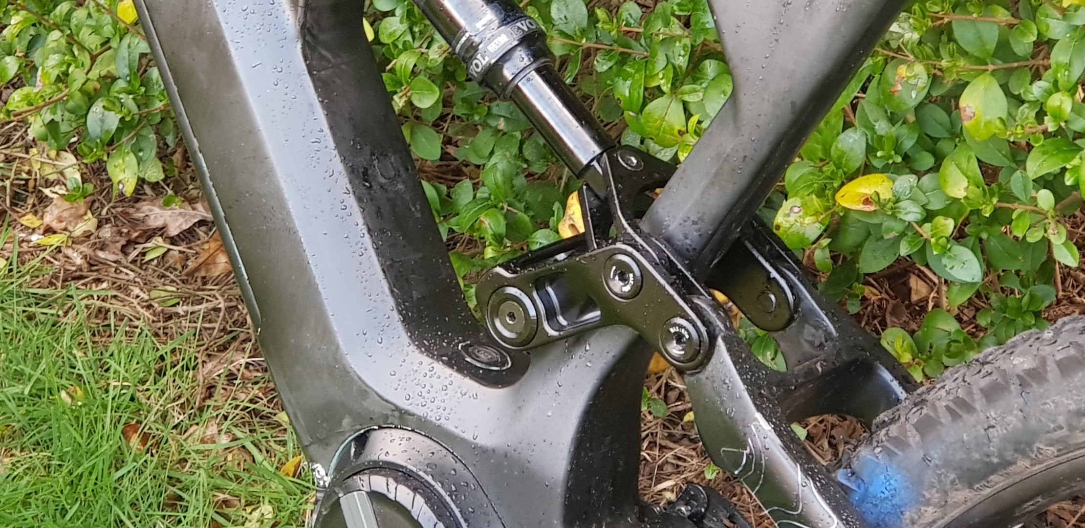

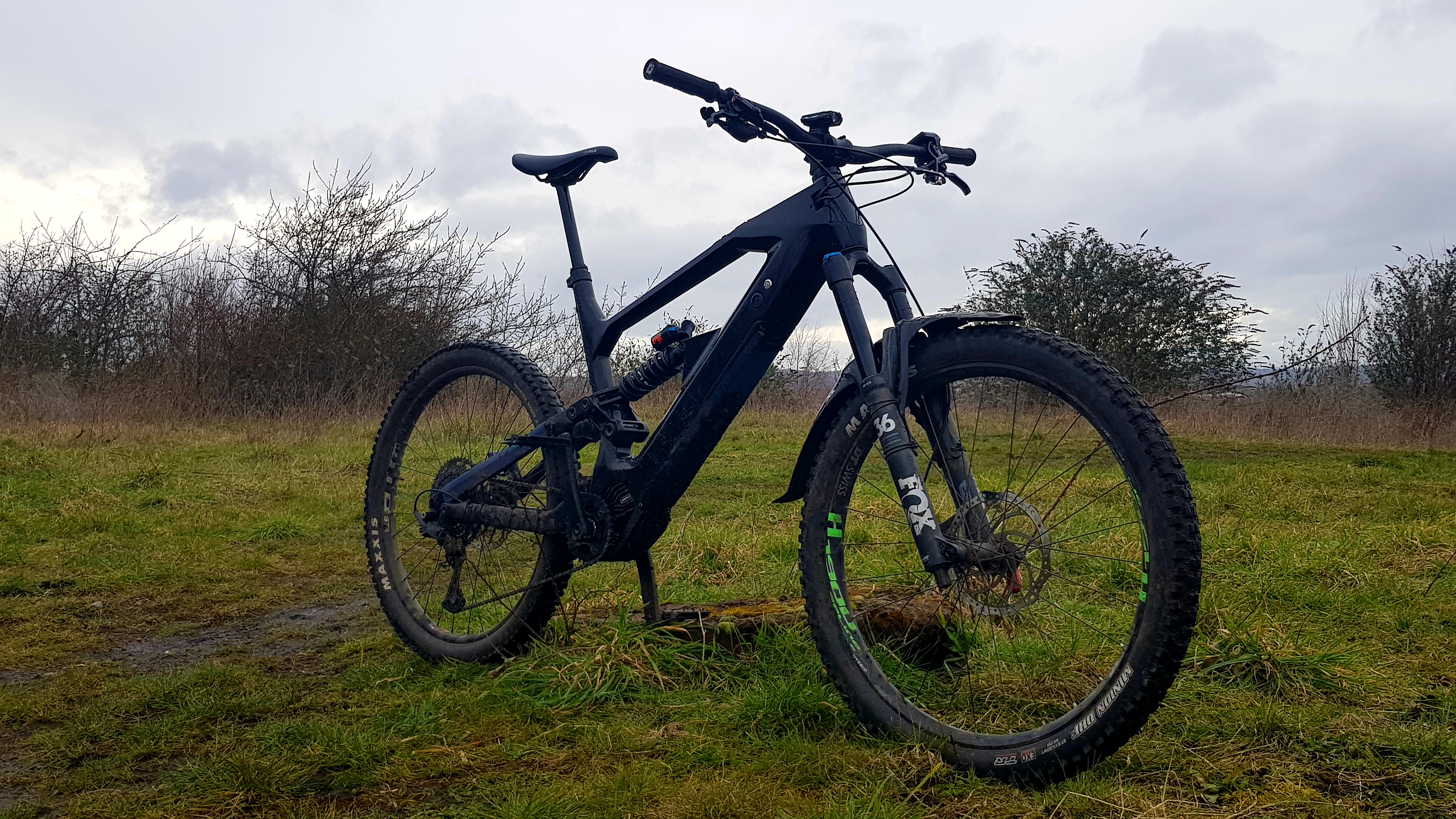

Does anyone know what are the differences between the old and new versions of this frame?
From pictures, it seems that the shock mount at the frame seems smaller in the new version, but I've not found anything else.
Neeko DeVinchi
Dec 31, 2020
1,032
1,373
I've been meaning to go into detail about the differences between the v1 and v2 frame differences. So apologies for the delay if you're still looking for information on this topic @Karamba!
Their are more differences however, the 3 main differences are as follows.

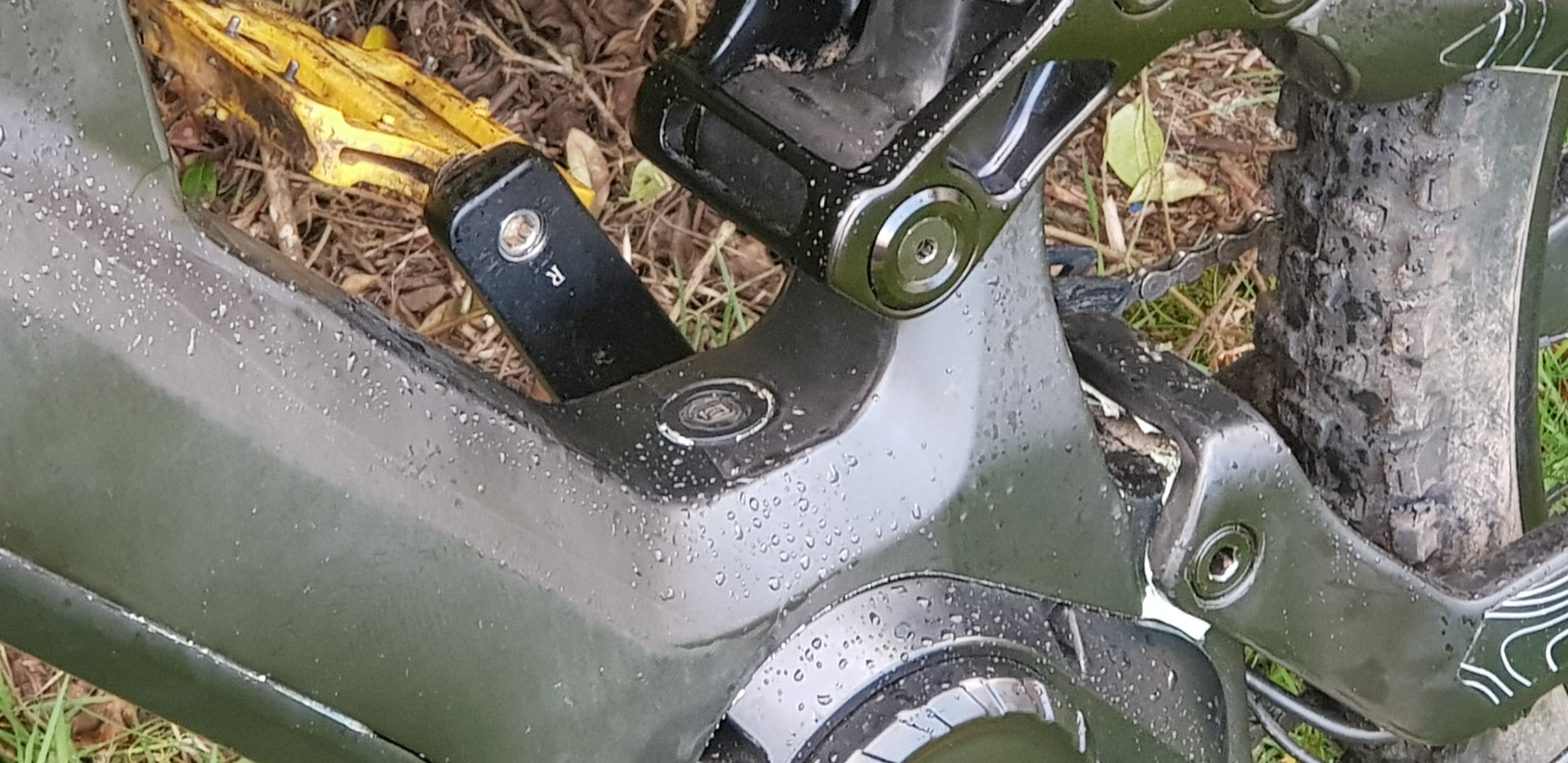

1. Onboard charger location - the v1 is located above the motor mount, in front of the seat tube. The v2 is located on the non drive side, above the motor. This was done to match the E22/E23s battery charger position for aesthetic consistency.
2. Lower battery mount cradle - working with Dengfu, they ensured that the v2 frames use the newer lower battery mount to reduce the intermittent power loss and water ingress issue.
3. Coil compatible - When Dengfu gifted me the v2 frame to build, they asked that I run the bike with a coil shock (but not overstroke it compared to my v1). This is because the 8mm upper shock mount position has slightly changed in triangle strut which protrudes on the downtube. Dengfu explained that this was done to cope with suspension actuated forces when using a coil shock, without the need of applying more material which would increase the weight. You can still run the v2 with an air shock but Dengfu confirms that the v2 frame is coil compatible.
I'll take pics and update this thread so others can see👍🏿
Neeko DeVinchi
Dec 31, 2020
1,032
1,373
V1 frame charging port locations are on top of the motor
V2 frames have the charger port location on the left (none drive side), above the motor on the seat tube. Similar to the E22.

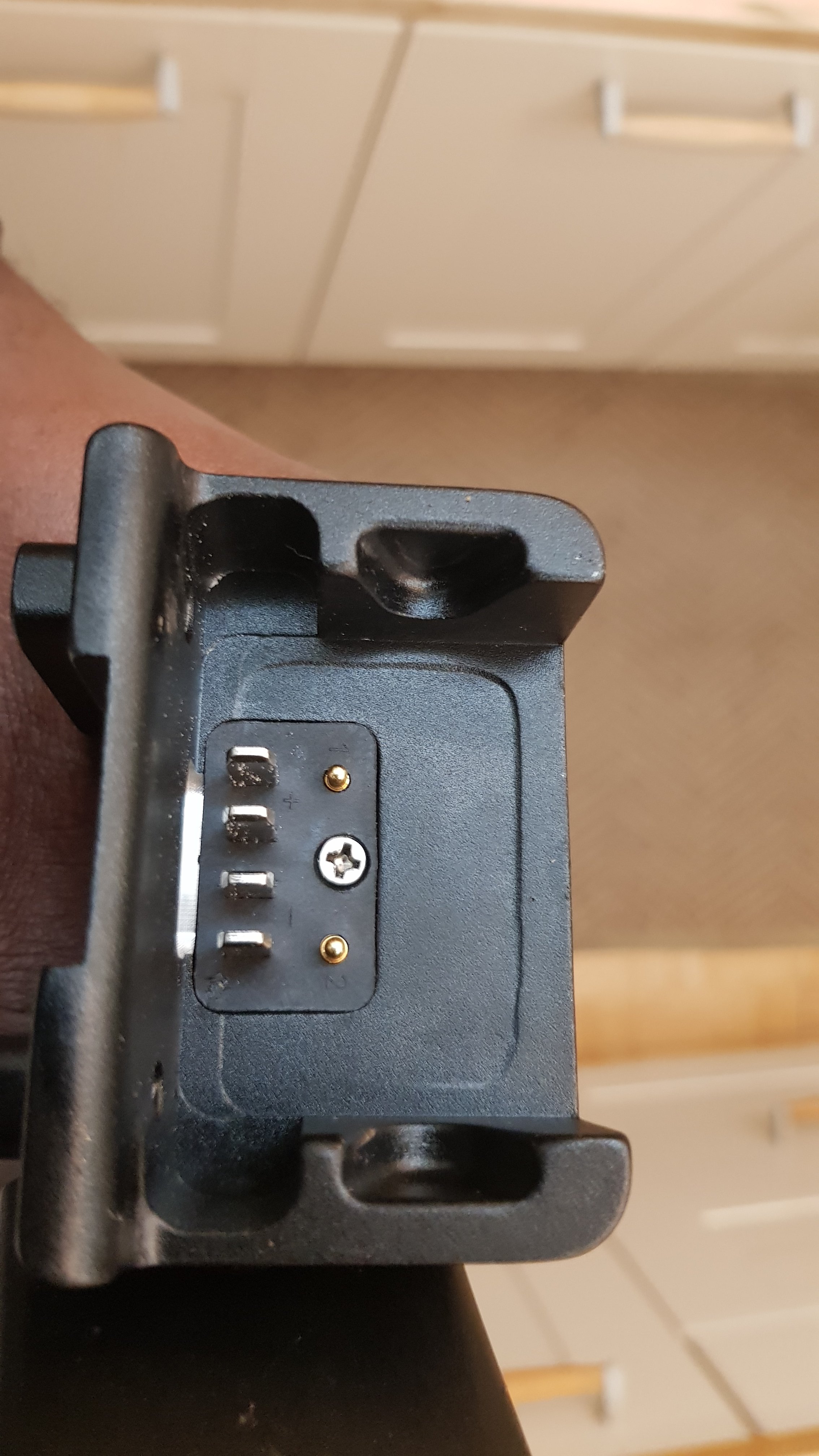

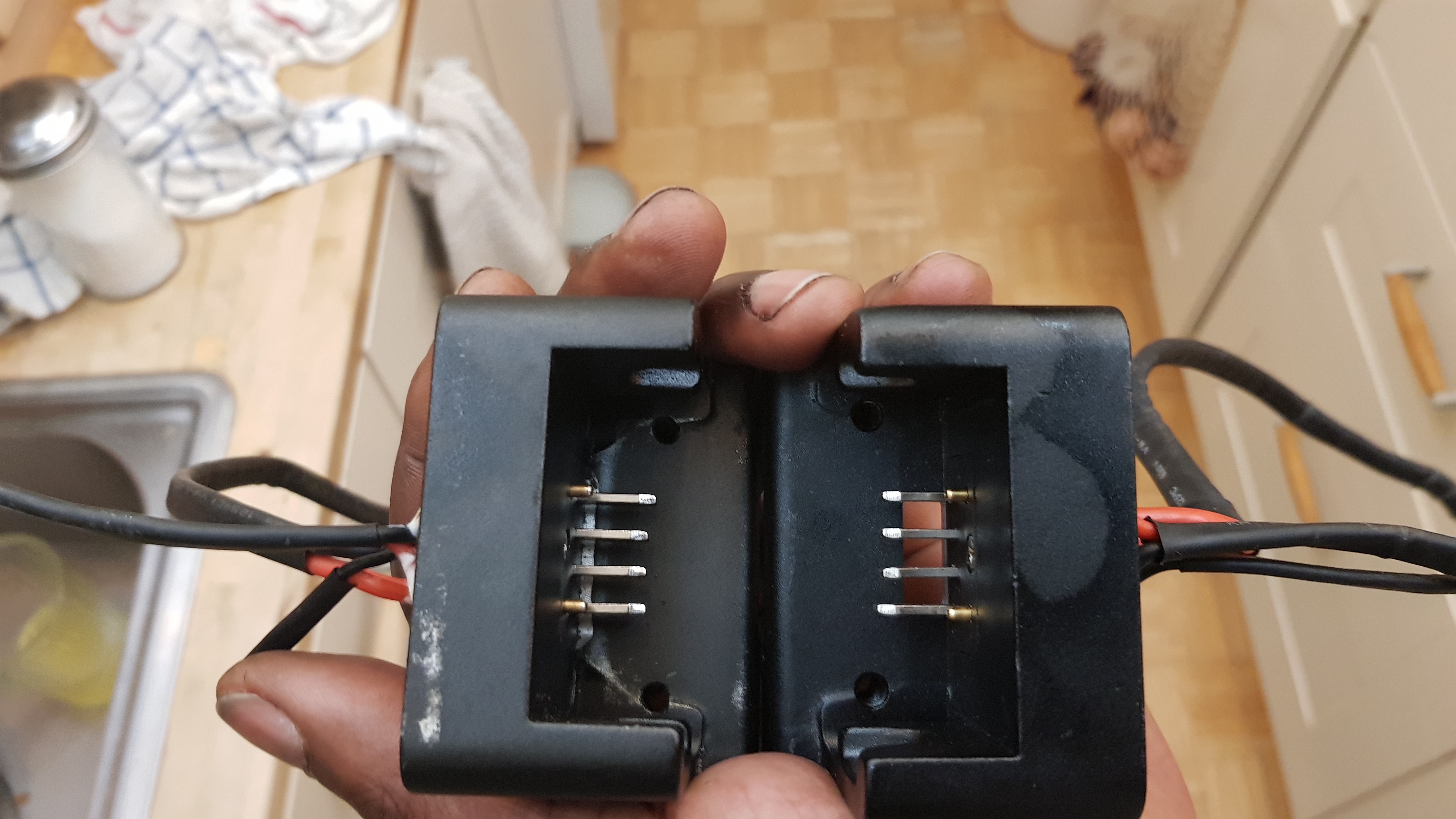

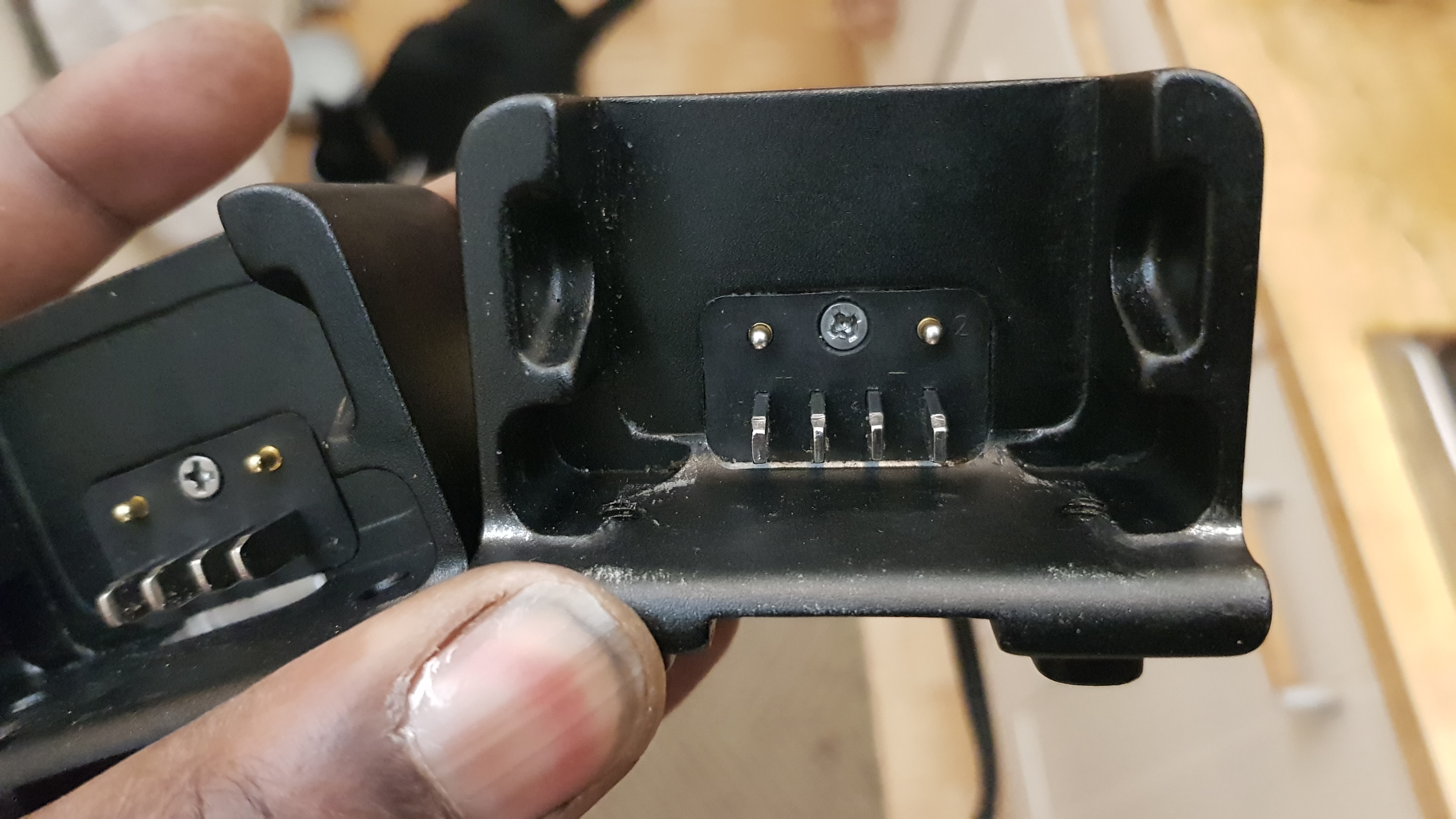

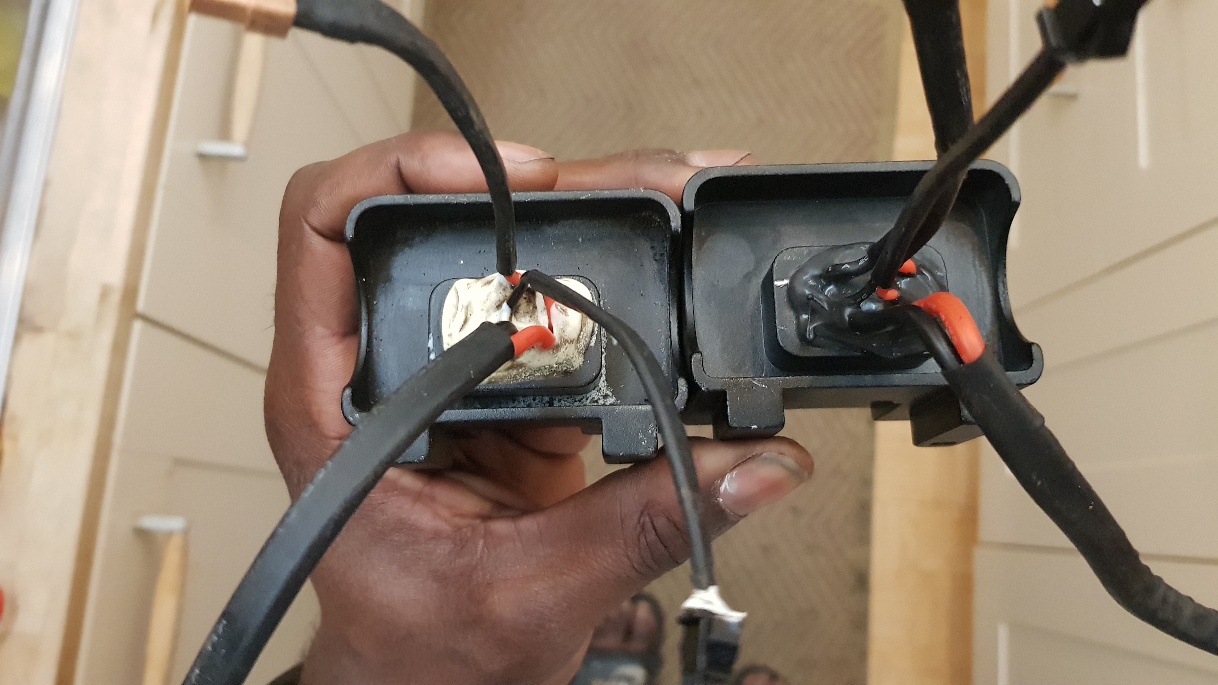

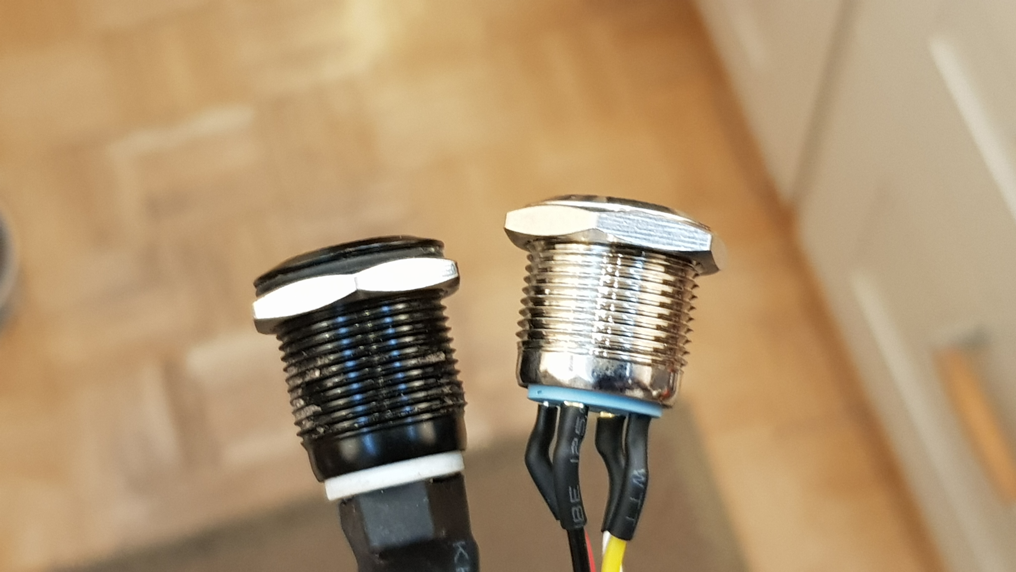

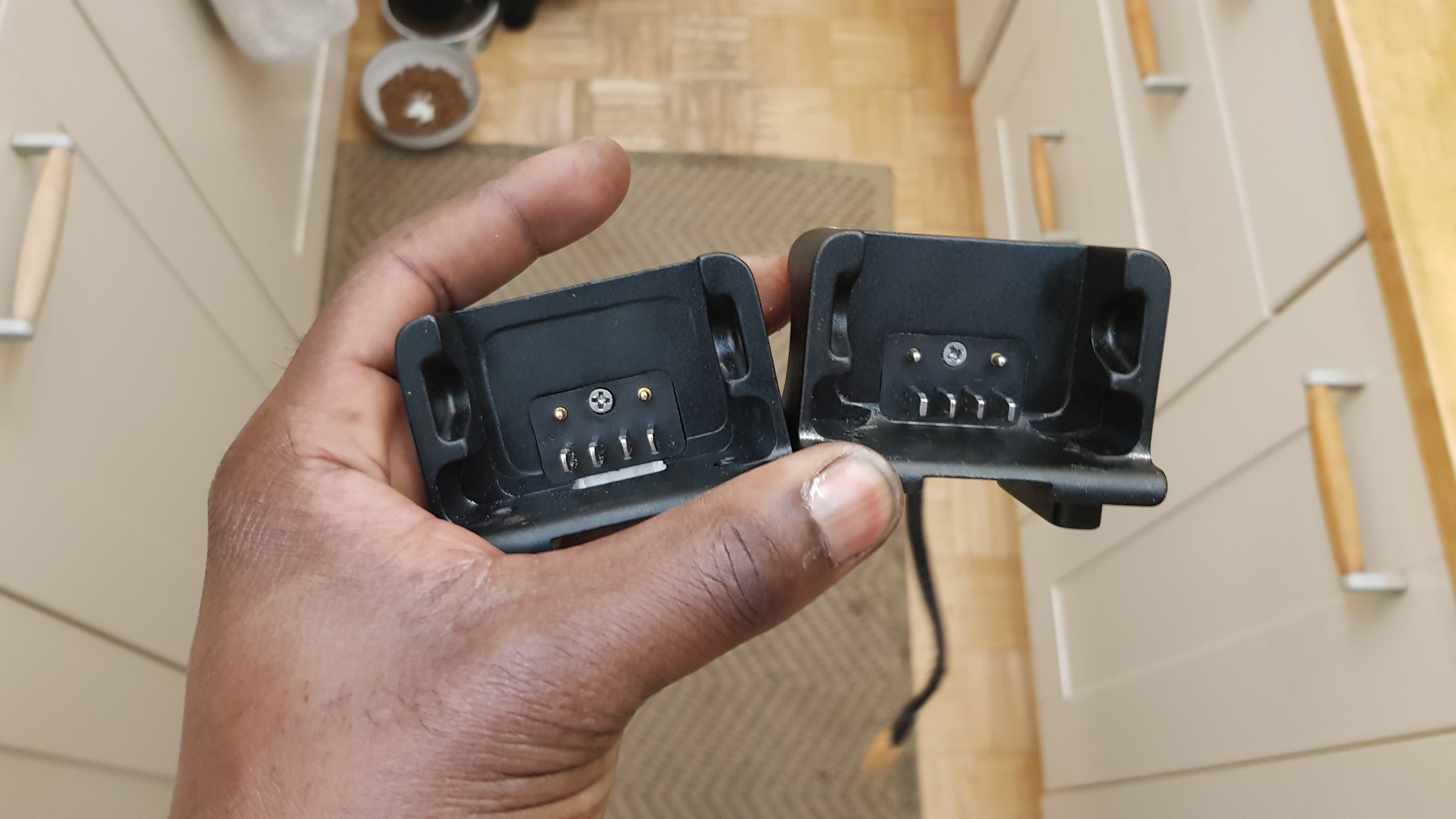

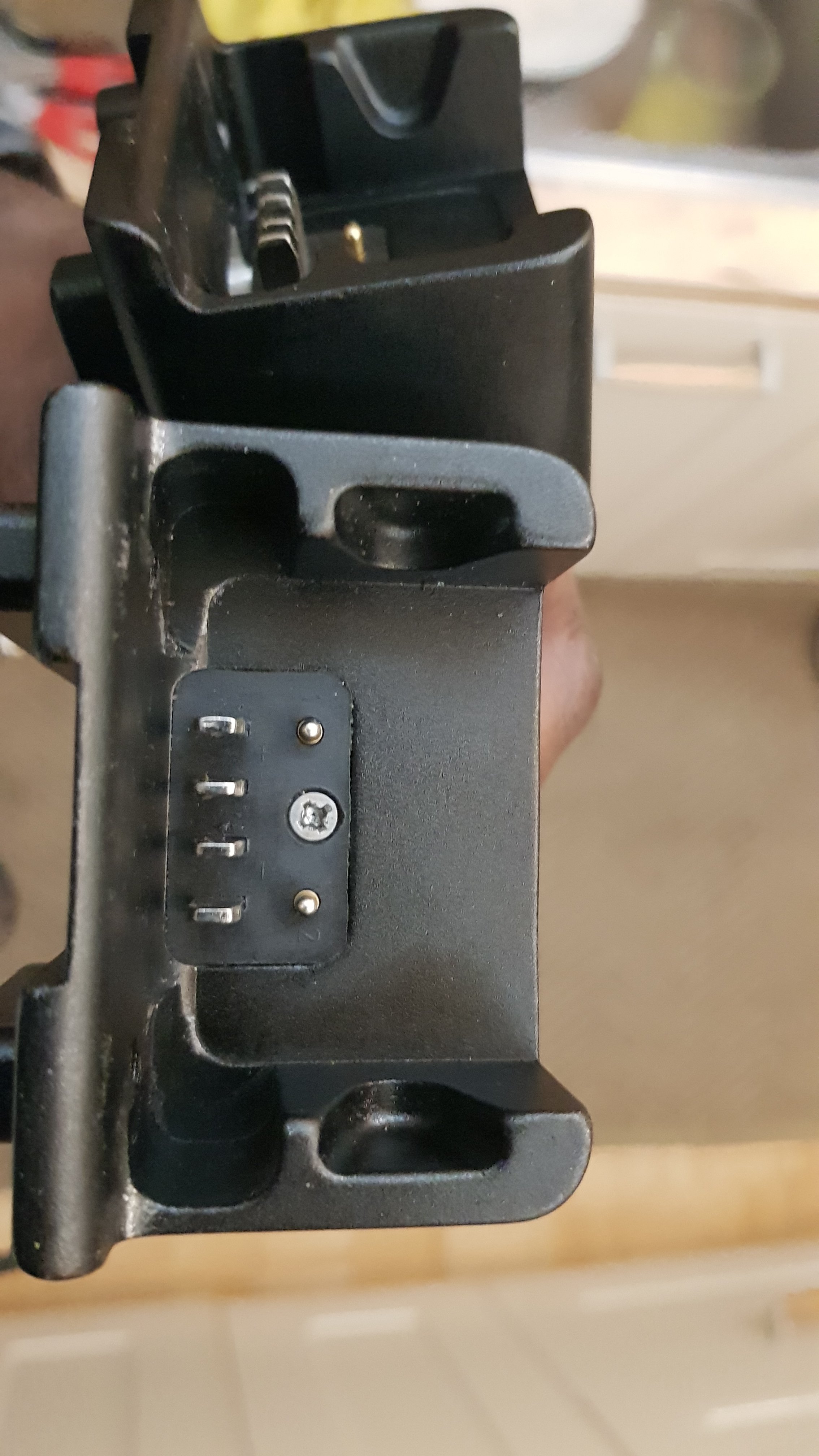

I'm thankful I've still got these pics😁
Anywho, the lower mount on the left is the oldest version of the battery mount. The one on the right is a newer version.
The exterior dimensions are the same. However, internally where the battery rests has been revised.
The plate which holds the contacts, protrudes out to ensure a more snug fit for the battery. As well as the gap underneath the plate to allow moisture to escape.
So far, the revised mount has improved the E10s performance. The intermittent power loss/water ingress issue has decreased from users I've spoken too. It hasn't fully illuminated the problem, which is why we reccomend using a strip of neoprene on sided tape on the inside of the battery lid.

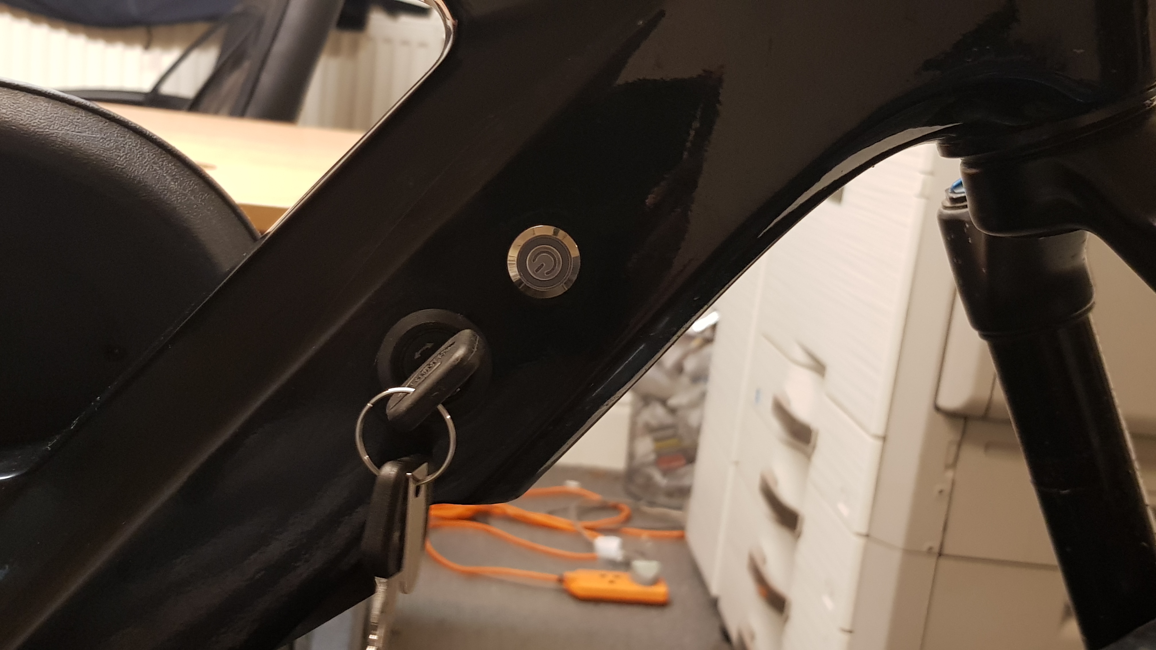

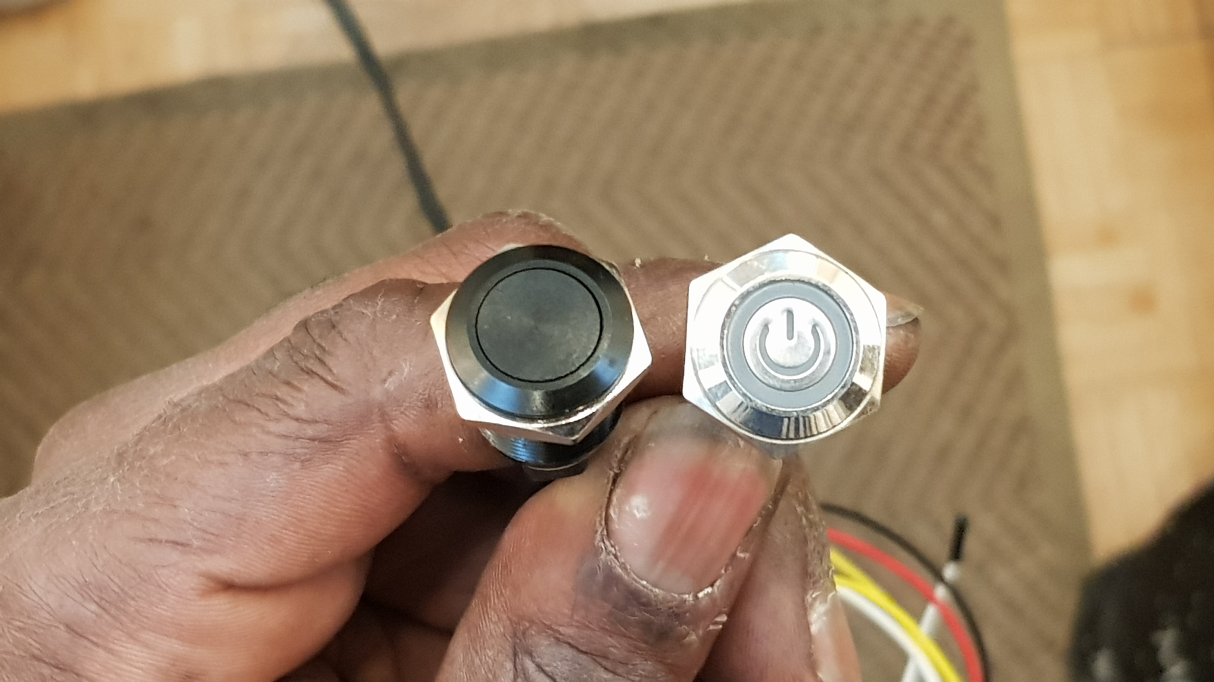

The power button is required to form the circuit for the battery to discharge. I have played around with aftermarket power switches and have retrofitted them to my E10 (for experimental purposes of course).
You might be able to see my custom power switch on my 2nd E10 above.
Here's a pic I've just taken.
Wiring in the switch to work with the molex connector wasn't too difficult. Although, it's not something I'd recommend if you don't know how to solder. Notwithstanding, performing these modifications "could" void your frame warranty. But I have seen members on the Facebook community group who have gone one step further than myself and have used the power switch/cut out area for other uses👍🏿

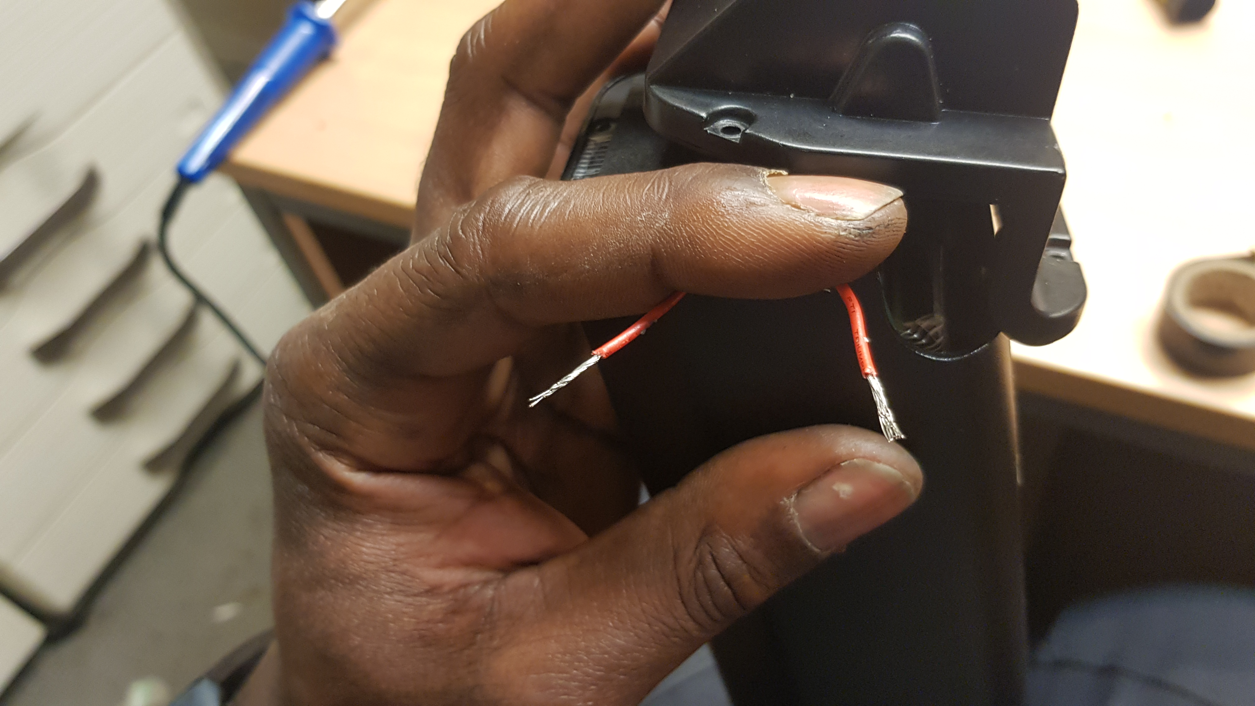

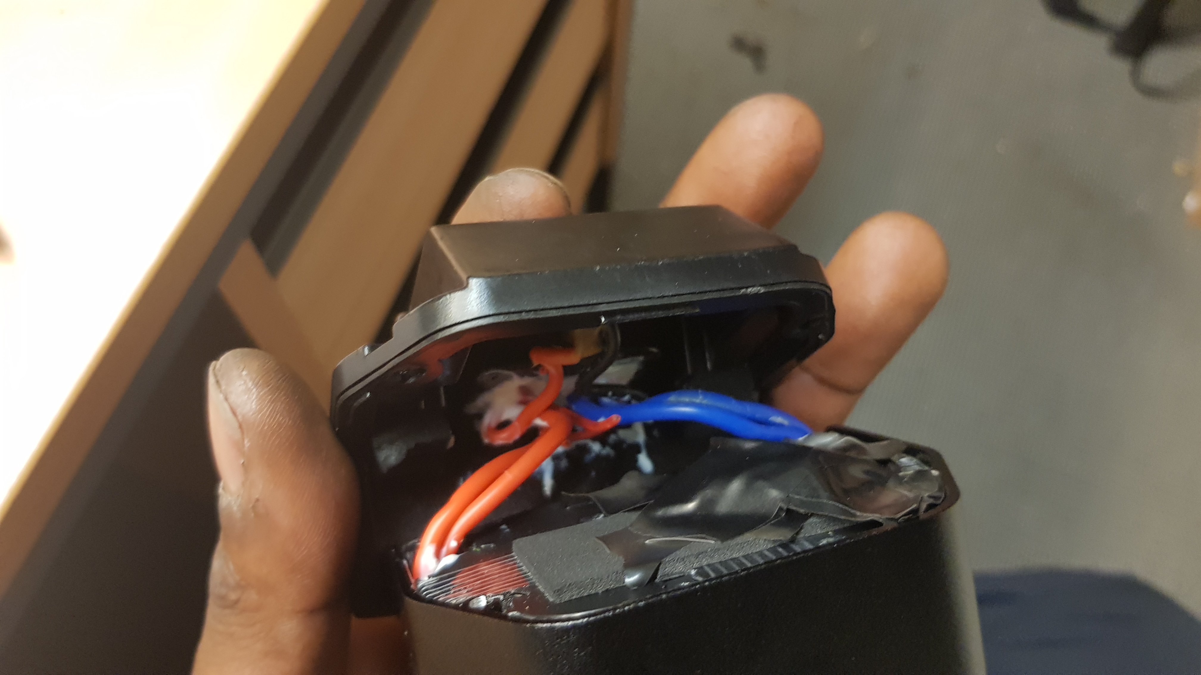

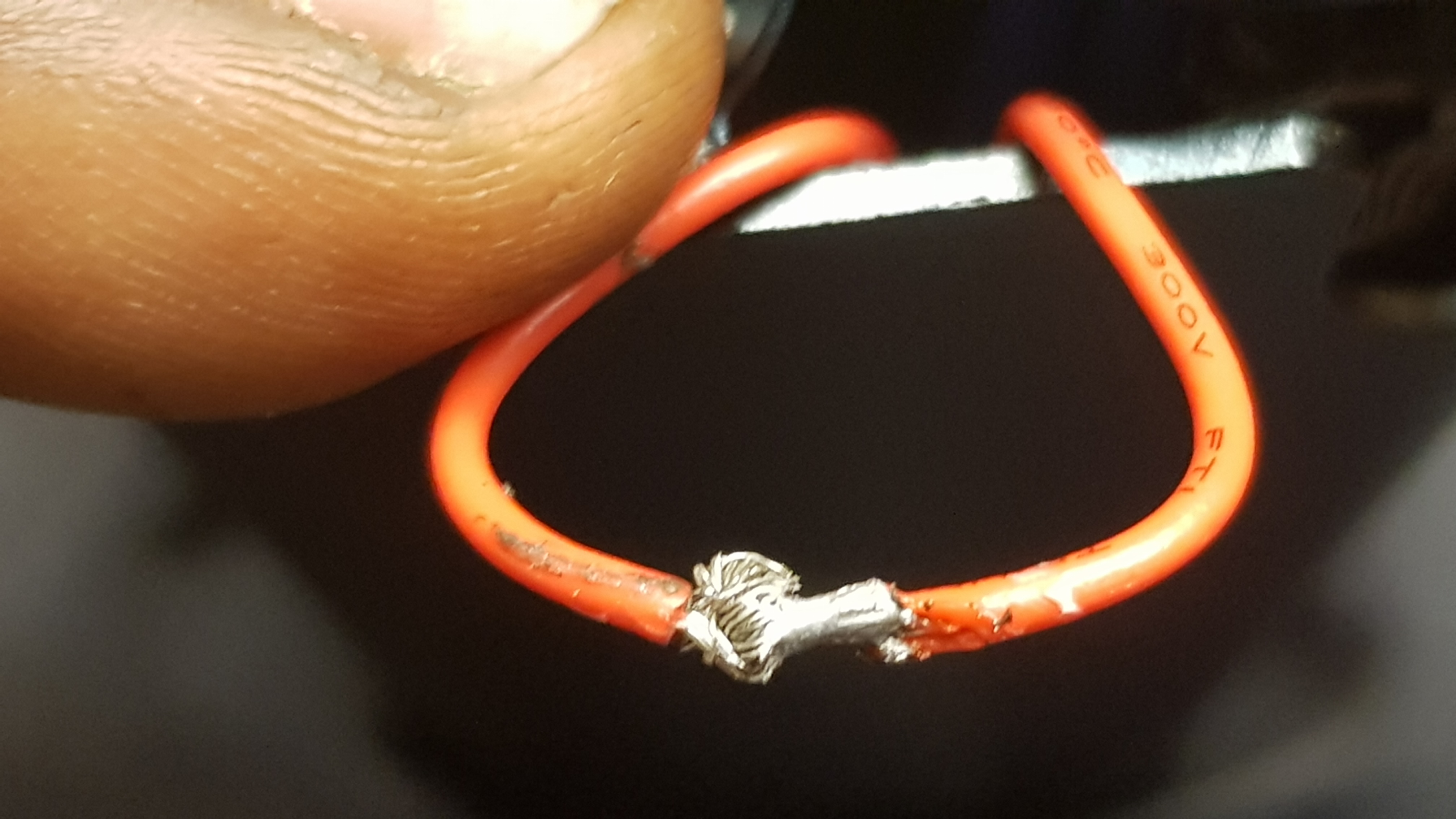

Good question.
I have performed this hack myself (using the battery from my first E10 for experimental purposes). It has yielded promising results whereby the power loss issue/water ingress issue no longer occurs. As for the lifespan of the battery (or the rate the battery discharging without being used), that remains unclear.
I have seen numerous variations of this battery. Variations include cells, cable colours etc.
The BMS trigger switch in my E10s battery is represented by the above two red cables. However, other batteries I've seen use either a red and black cable or two white cables (and their might be other batteries which use other colours which I'm not aware of).
Because of the different variations of batteries, it's difficult to verify whether the hack would impact the battery's health overall. Comparatively, other aspects (heavy discharging, charge cycles, battery storage) could equally impact the battery's health as well.
I will say that this hack voids the one year battery warranty.
And naturally, if you cut the wrong cable, you open up a new can of worms.
