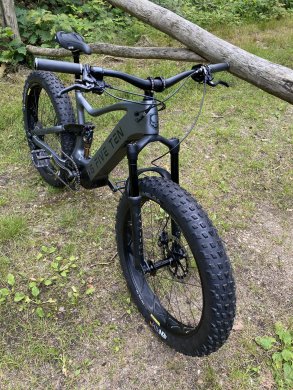

Measures for the E05 battery compartment:
Height: 370mm
Width: 82mm
Depth: 71mm
These are not be the most accurate ones since I'm on the road and don't have a calliper.
Forgot to post my build here previously but here are some pictures. The E05 with M600 has done well for these past months after riding over 1000km. Only issue has been the derailleu hanger (broke once) which I highly recommend to buy as spare part from ebay. Have been riding the 627Wh battery for long as 60 to 70km per charge depending on the assist level. With 27.5er wheels there's some pedal striking on tight corners because of bafang 170mm cranks.
Overall great frame but don't they start selling the E10 with Rob's factory painted colors? He did a youtube video recently about that

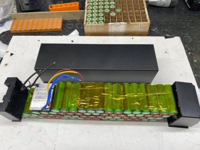

I tried to order an E10 but could not. Like you, I will go with the E05 frame.
Can one of you that has an E05 please measure the dimensions of the battery compartment and/or the battery? I would like to make my own battery.
Thank you.
Made this Dengfu E06 (same battery as E05)
Made a 14S5P. It's a tight fit in the case.
