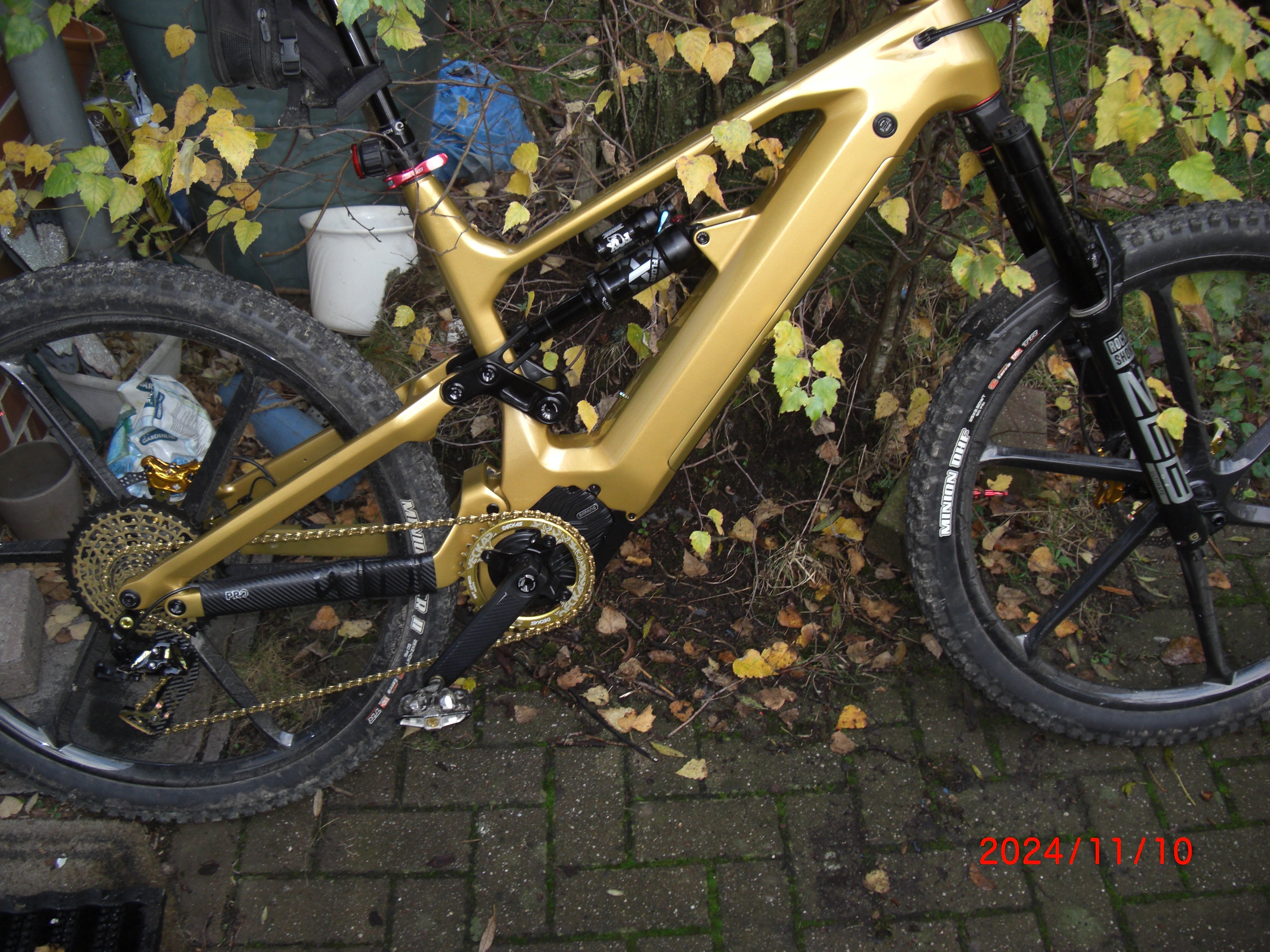

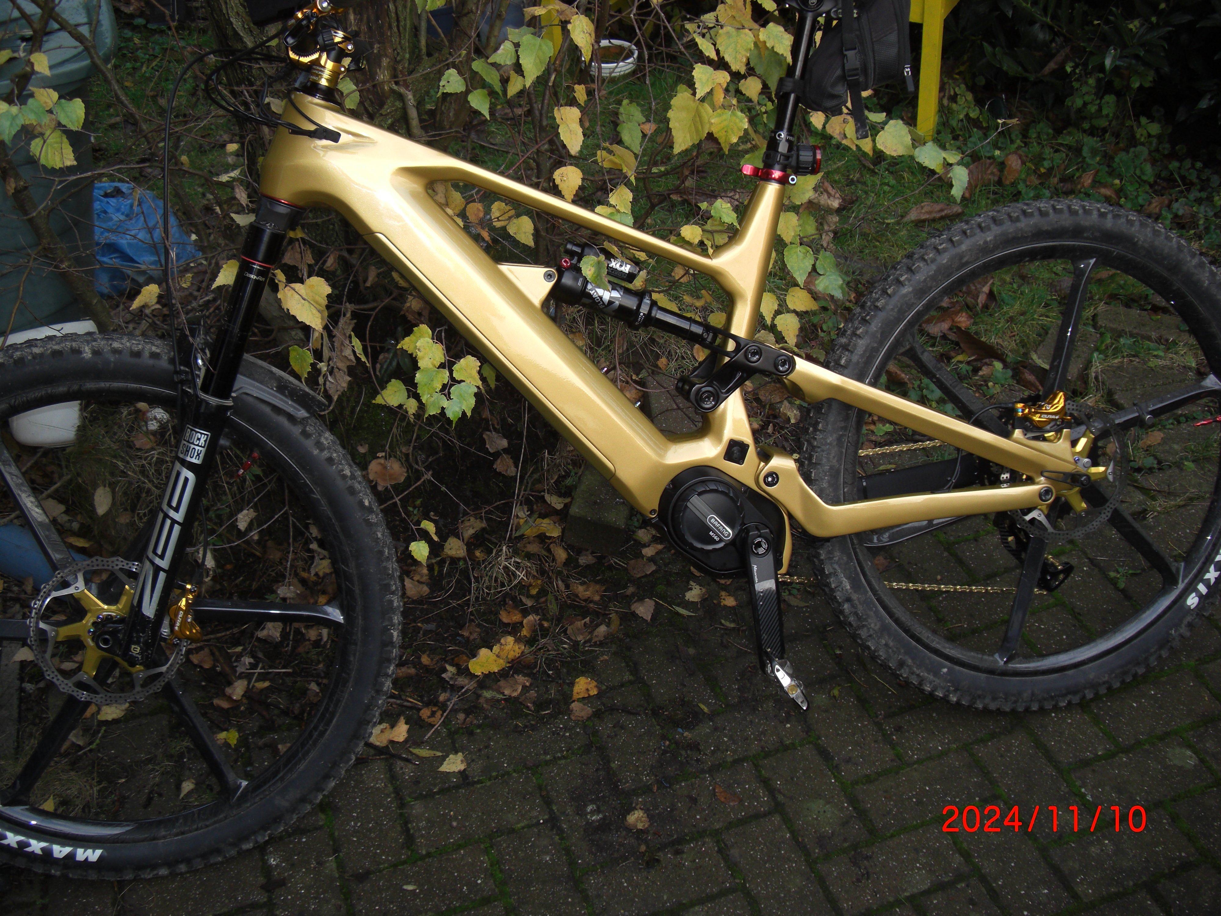

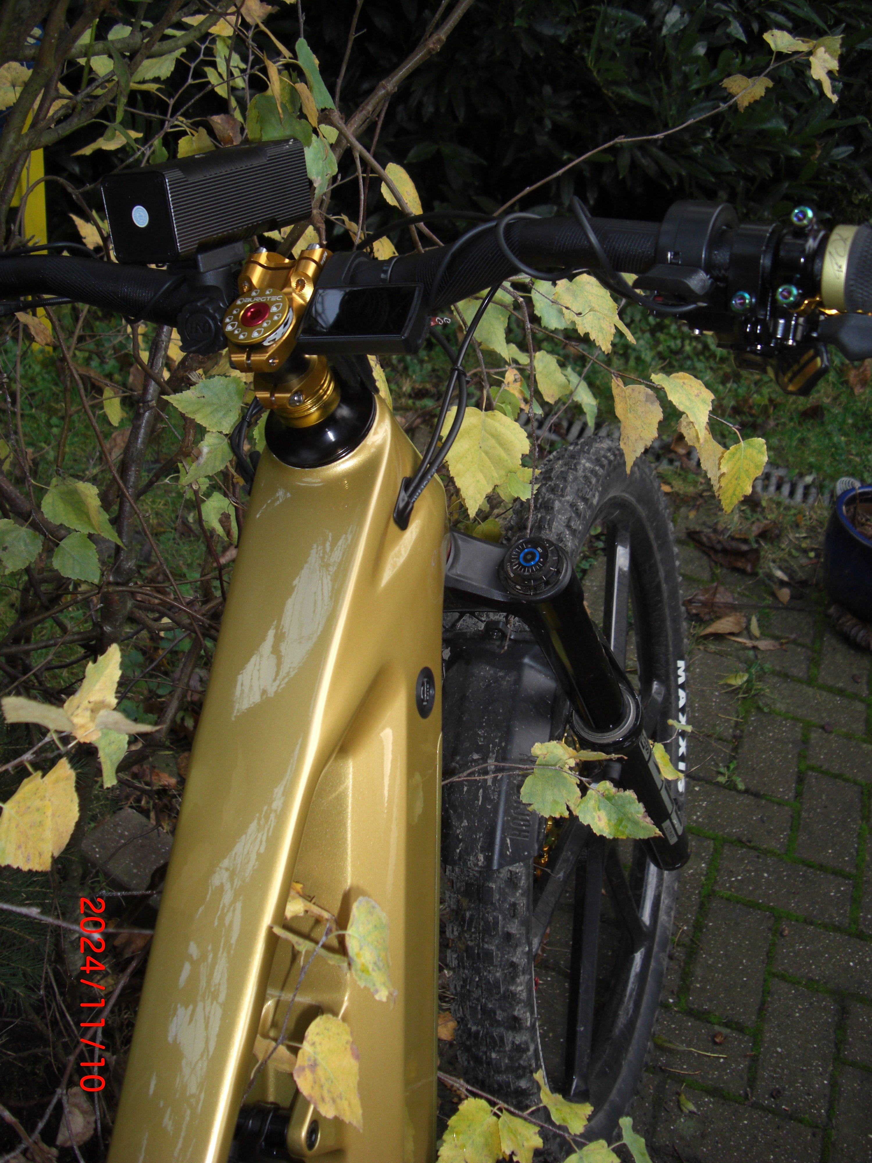

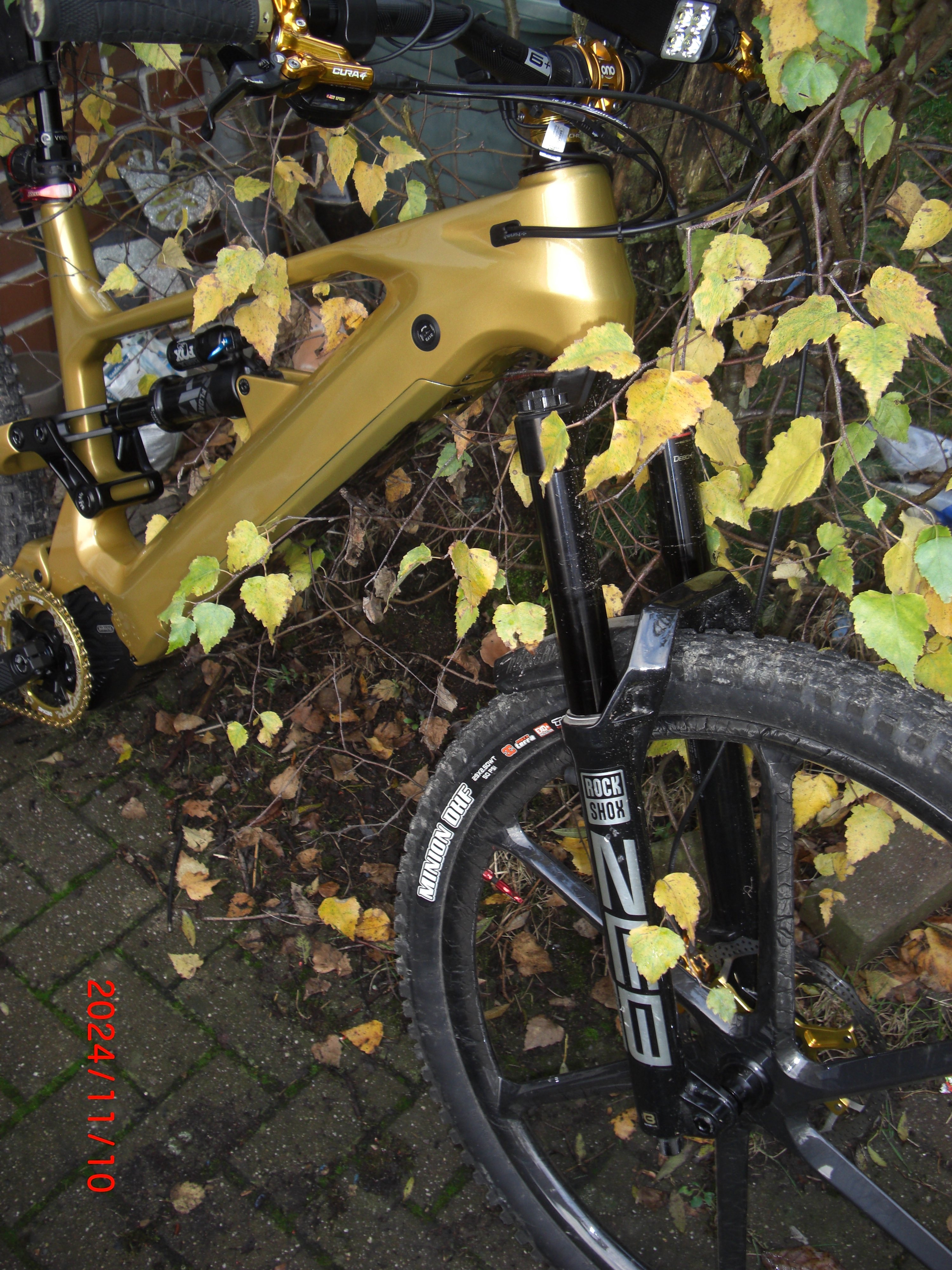

Hello,
at first greetings from Germany.
I have now build up my new E-Bike Dengfu E 82 with Bafang M 560,750 Watt Version.
Size Large,special gold color.
Specs:
Formula Cura 4 Brakes in gold,Reverse 203 mm Rotors in Gold,RS Zeb Ultimate 29 Fork with 170mm Travel.
40 mm Stem in gold color.
Magura Veyron Post
Miranda Cranks in 160mm
Deckas Gold Chainring 38t.
Carbon Wheels 6 Spoke with Maxxis Tires.
12 Speed Cassette from ZTTO in gold.
Very nice looking Bike
Hope Headset
Michael
View attachment 150182 View attachment 150183 View attachment 150184 View attachment 150185 View attachment 150186 View attachment 150187 View attachment 150188 View attachment 150189 View attachment 150190 View attachment 150191
Nice bike🔥 Do you have bike-ahead-composites wheels or China carbon? How does the bike ride on these wheels? I want these too :)

The Wheels are from Ali-Express.
The inner wide is 31mm, very good for tires up to 2,6.
For carbon wheels they have a smooth run and the weight is also good.
Price with shipping was € 740.

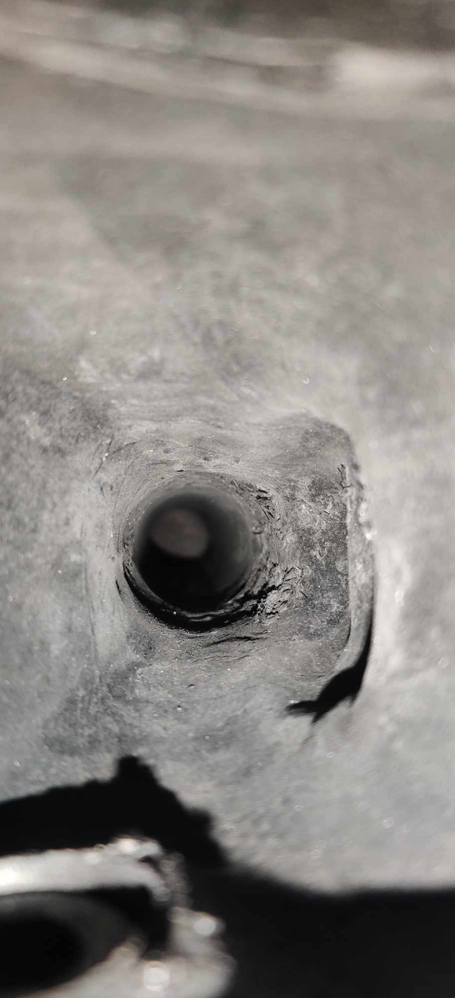

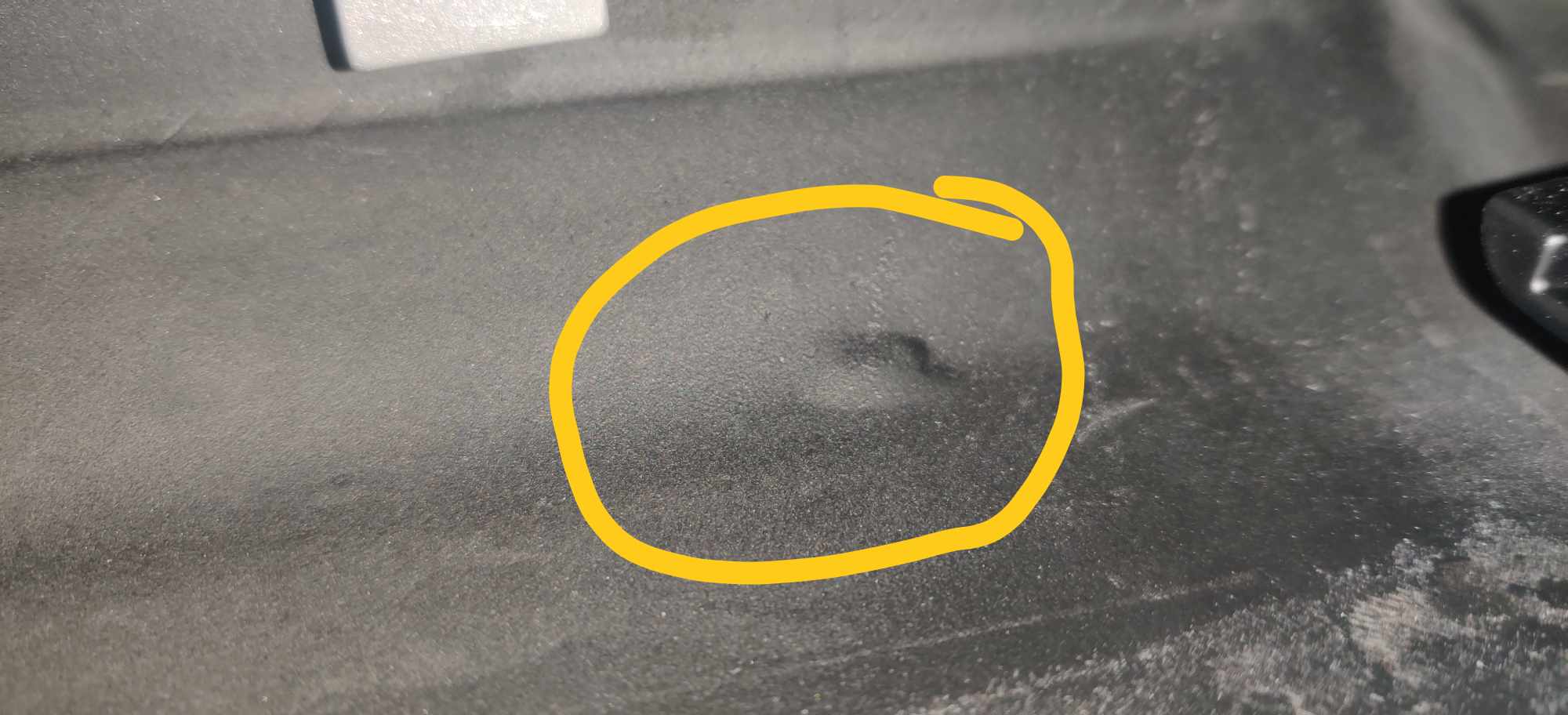

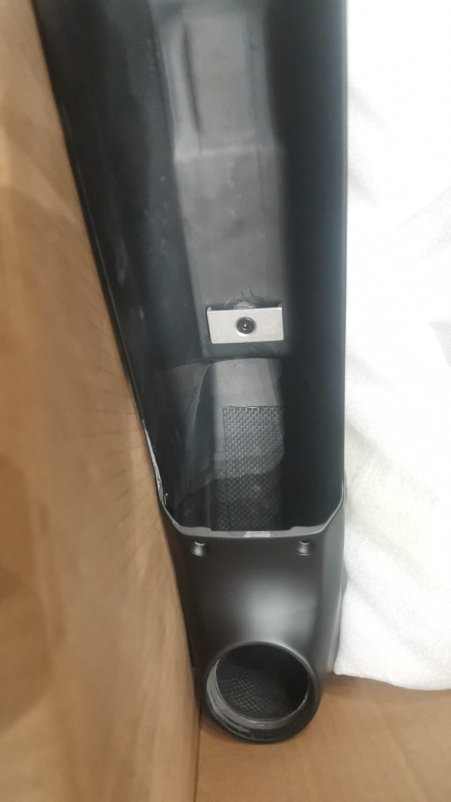

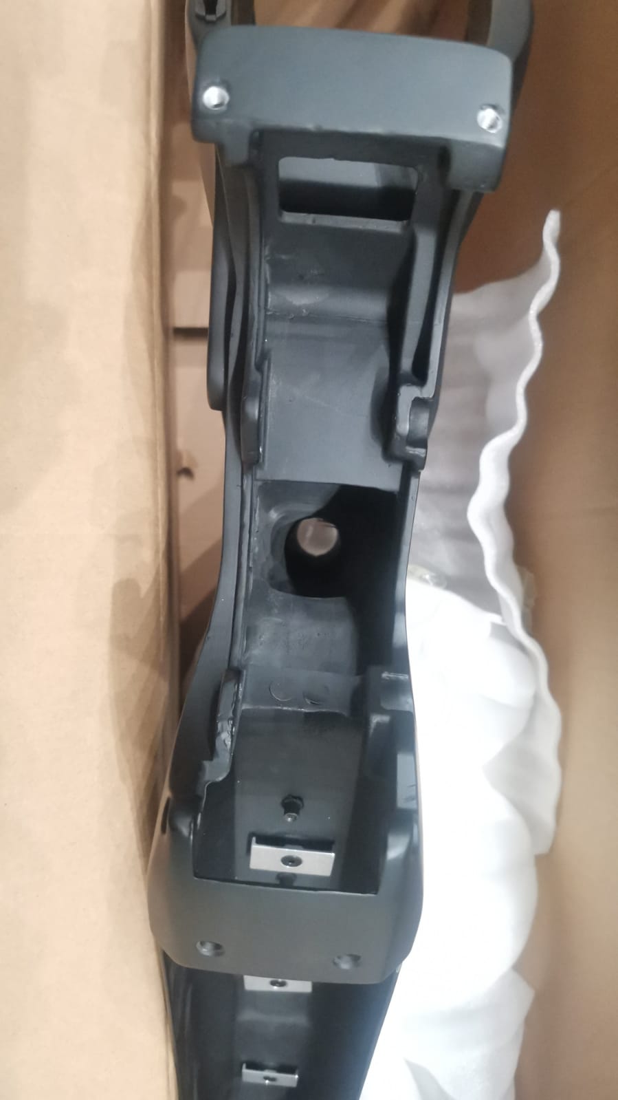

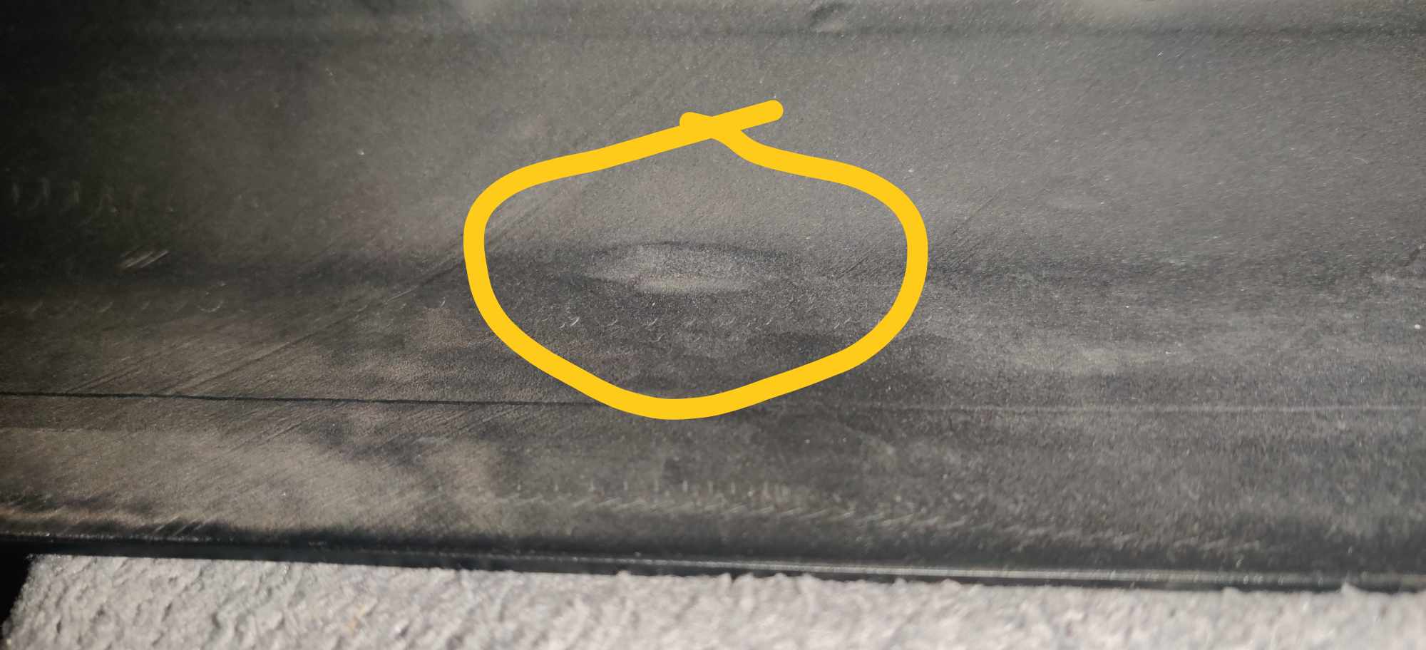

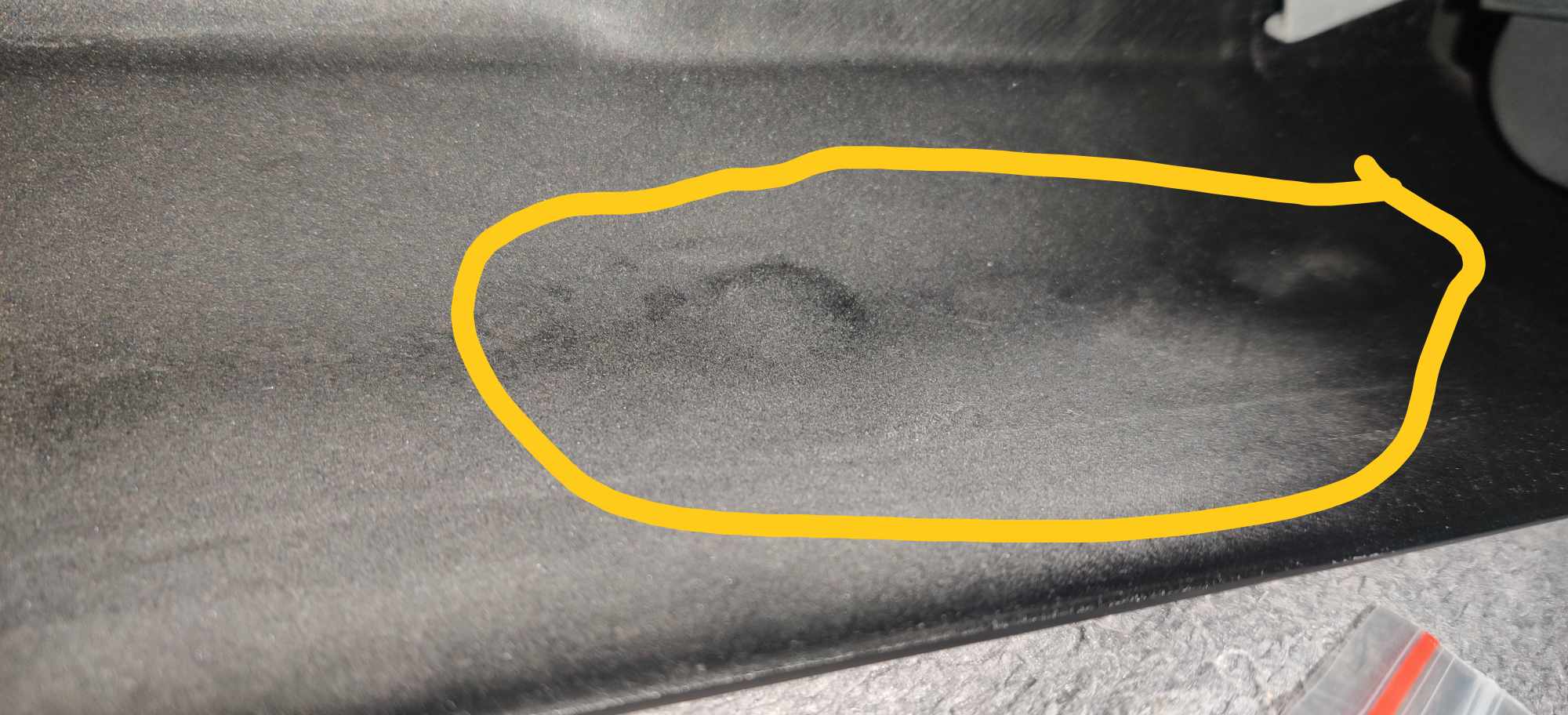

If your frame is of the same quality as mine you will find defects. I'd inspect this frame with a fine tooth comb before using it. On mine inside the frame where the battery goes I found multiple air bubbles under the lamination of the carbon, if I press against them they make a pop noise. Shine a light up your seatpost from the motor end and have a look at what your bonding on the pivot joint looks like, if it's like mine it's gonna look very rough.
Also the bearings that's used on all of the suspension pivot joints are absolute garbage, I had one lock up after only 100ish km, it was terriblely pressed into the yolk from factory.
Dengfu also drench all the bolts in far too much blue thread lock to the point it will damage threads.
The rear axel you have from them is also made from chinisum, you will bend it like many of us have already.
Another thing is I see bolts on your pivot/yolk that are labeled as 8Nm, they are Infact 12Nm. Dengfu Lazer engraved the wrong specs on the bolts as confirmed by them on their Facebook owners group

i think you are right! dengfu quality went down over time. Replace all those bearings with Enduro branded ones. they have some special designed ones for yokes ect. i ordered a cheap bearing puller kit from aliexpress and pressed them all out from the beginning.
maybe get a replacement frame? did you get it with some kind of warranty ?

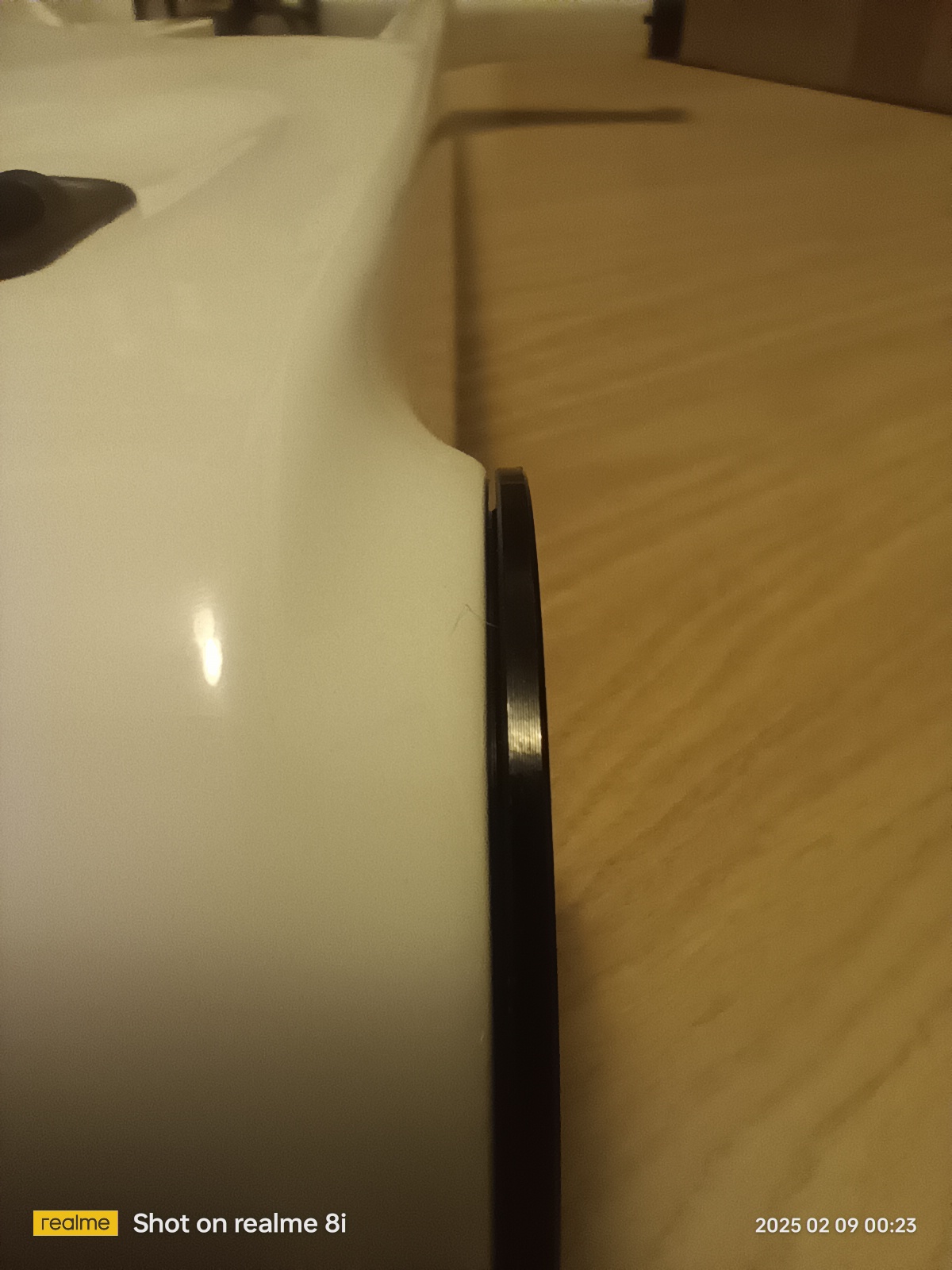

The quality of the E82 frame is the same as that of the E10. It has become significantly lighter. Now the lidless frame weighs 3200g. The lid is 270g. If you jump from a height of 9m, the frame will break. It has thin walls. The painting quality is good, I like the e82 frame. I really liked that the bushings for installing the rear shock absorber are included.
