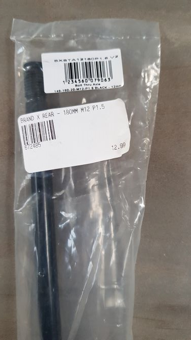

Has anyone had issues with rear thru axle, the quick release on mine has come undone and will not tighten up to enable axle to be turned, and axle is stuck in wheel?
Both axles front and back are not the best to be honest i have already rounded the locking tabs on front axle ant one else had any issues, i will be replacing the back one.
Had very similar issues, not the greatest parts. Managed to screw the lever back in and tighten the axle but it's not confidence inspiring. Can anybody recommend a replacement?
i had to remove quick release and use mole grips to push in inner shaft then unscrewed axle, quick release on back axle just not pushing inner shaft inwards enough to lock with outer shaft. I will taking to LBS to source replacement later today will update with findings..
Update replaced rear thru axle with brand x cost £11 at LBS no issues .
