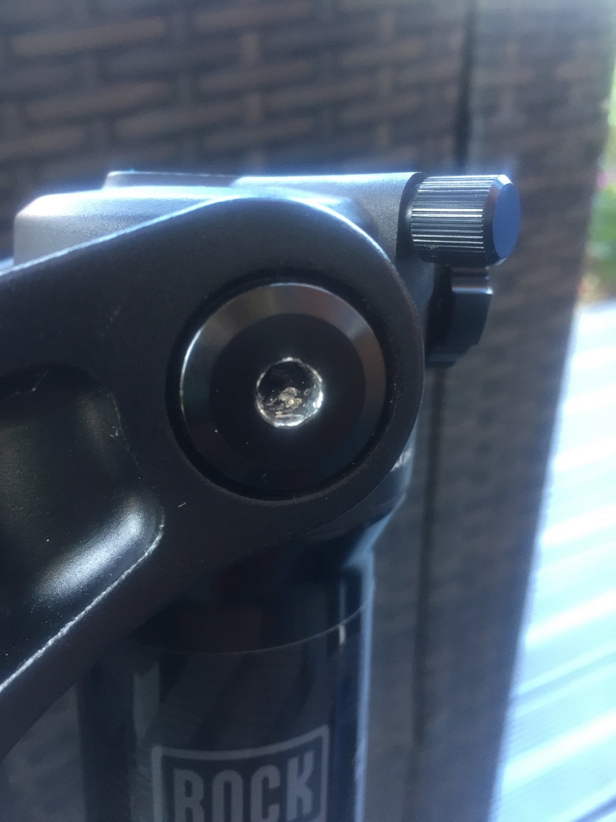

So today was rubbish with the Stilus, wanted to remove the bolts on the shock mount as they were too tight and the cheap oversized Alan bolt stripped, I used the correct Alan key but it just span because they did it so tight, so not only do I have a stuck bolt but how on earth can you get a replacement as it’s a weird countersink bolt ?

Ouch. If it were mine, I'd consider tapping a slightly oversized Torx into it and hope it grips enough to start or maybe dremel a slot & use a flat head screwdriver or similar. As for a replacement, just google Rockshox mounting kits & you'll get a result. TF Tuned also a good shout.

Do you think TFTuned will do bolts for this frame? I’ve used them before for the fixings but I assumed this countersink bolt is specific to this frame ?

I wondered if you may have any ideas how I can get out riding, the bolt in my Stilus holding the rear shock on has stripped Alan fixing and now it’s just a round hole, it’s not going to fall out but if I ever want to remove the bolt or shock I’m stuck as is the bolt, do you have any idea with your contacts how you can get replacement bolts? I’ve purchased a bolt extraction kit but the ally is soooo soft I don’t think even that will work. However if I do get it out can I or anyone else buy new bolts for our Decathlon frames ?

You hammer a torx 30 or 25 into the bolt, and screw it off, that bolt is done anyway. done it a few times on a bike, and loads of times on cars.

You can still ride it if it's secure? I can't see an issue until you need to remove the shock..I haven't had to do that in 1.5 years of riding. Your LBS will be able to get it out an no doubt find something that will fit if your desperate..?
